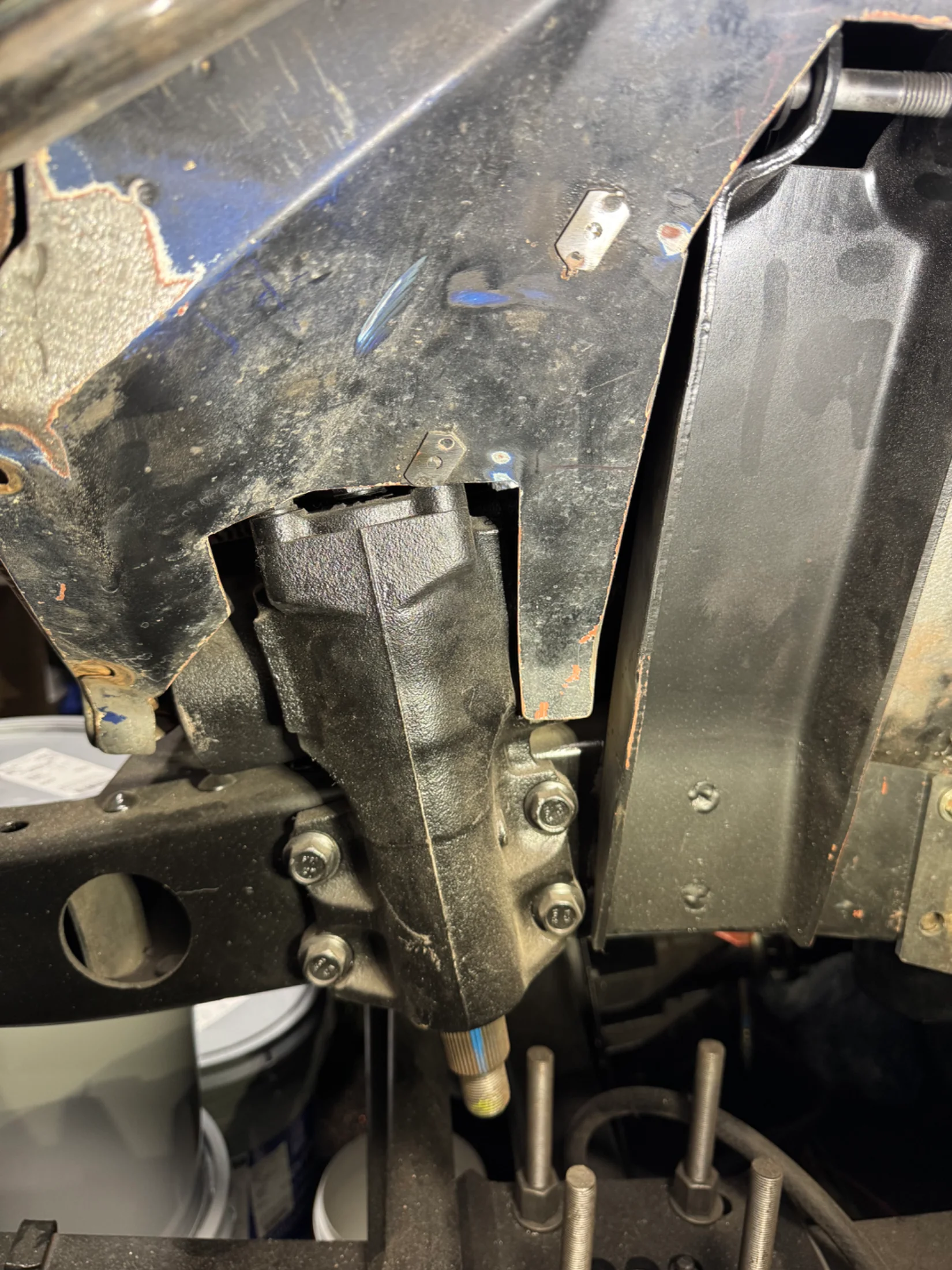

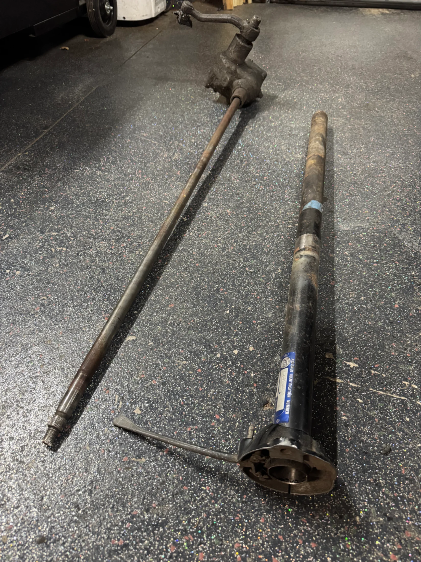

Can anyone help steer me in the direction of the parts needed to adapt my fj40 shaft/column to an 80 P/S box? I can weld/fab. It’s much appreciated.
I hacked an early column to do my PS. For your 60, i’d anchor the outer column to the firewall plate with a continuous bead and then weld the upper column mount to the outer column as well. Run a 3/4”(iirc) to DD and then use the DD to spline at the 60 box with steering shaft between. You’ll also need to find a way to support the inner shaft to make sure the steering wheel is happy with the turn signal.

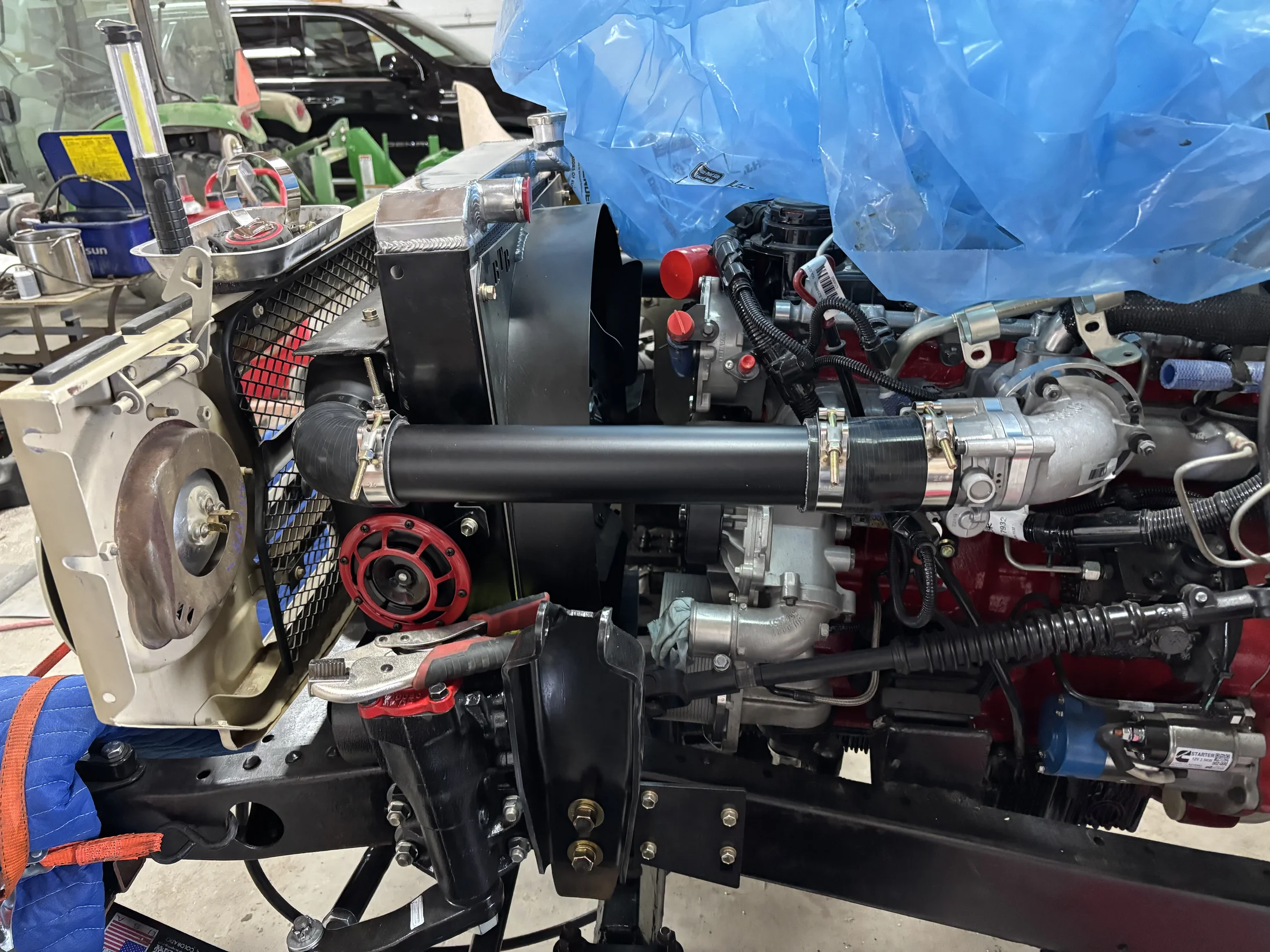

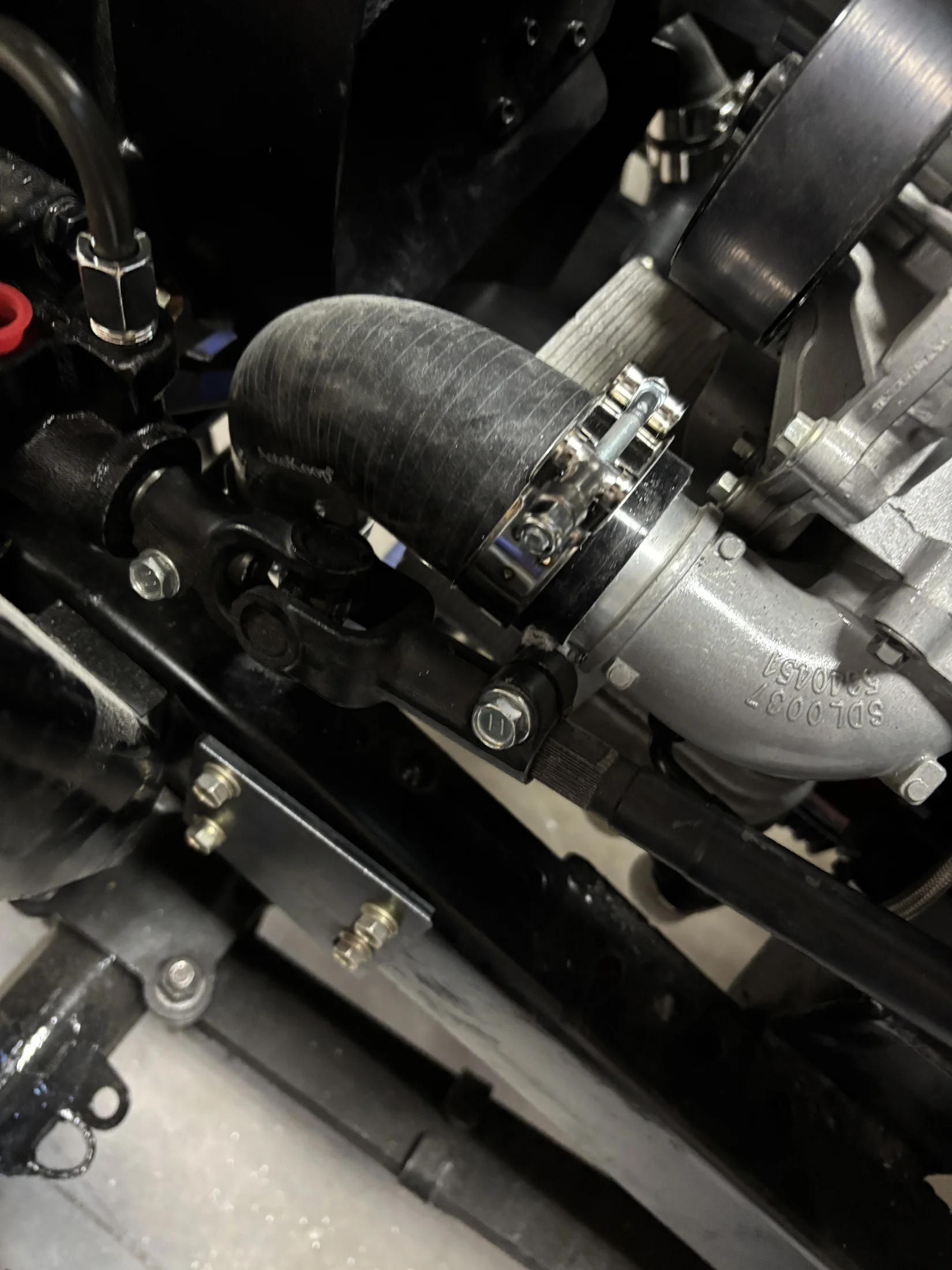

I used FJ80 intermediate shaft and U-Joints to connect the FJ40 column shaft to the FJ105 steering box. The U-Joints are rather large.

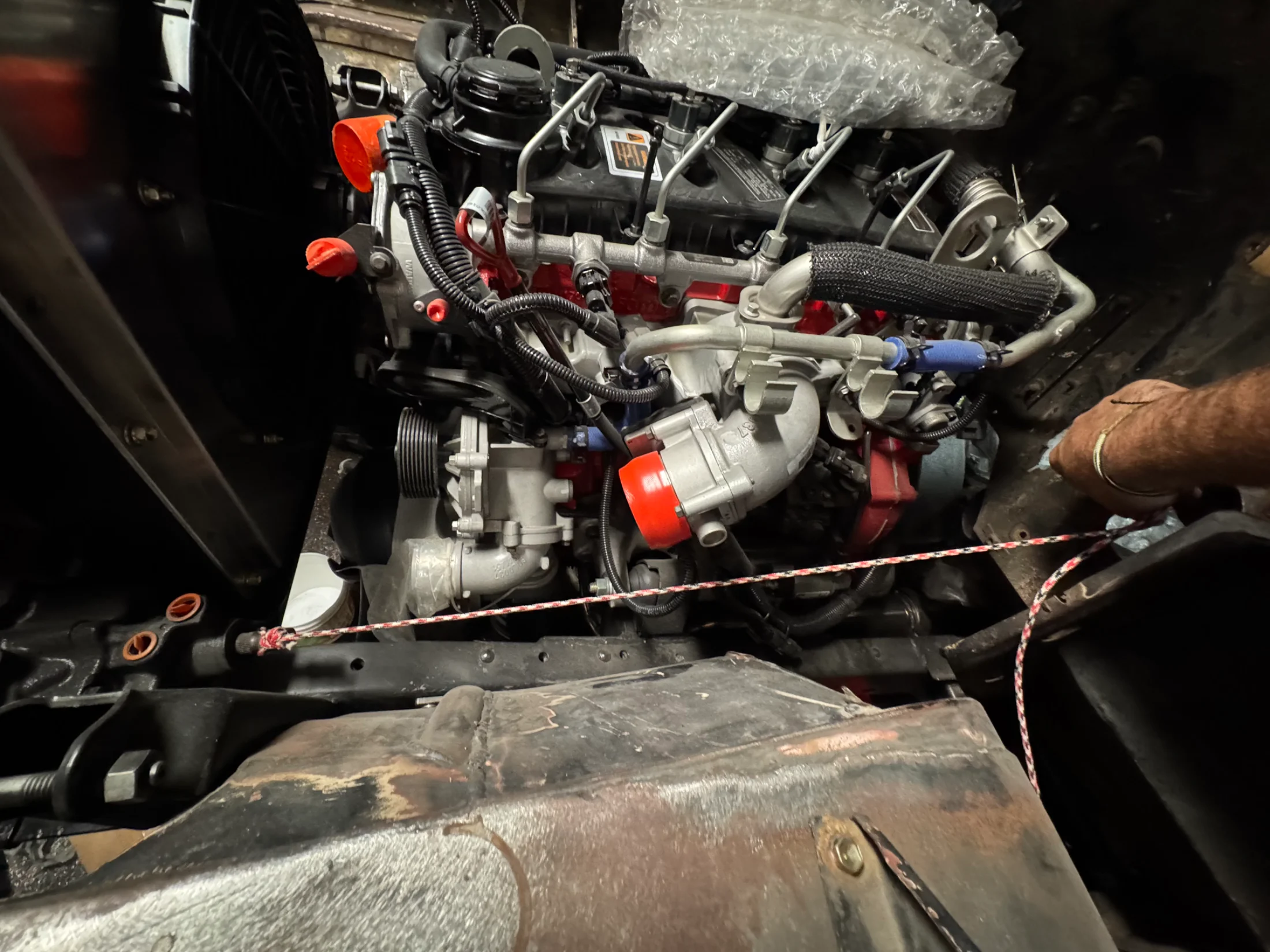

I also have the Cummins R2.8 and using the 2F bell housing and motor mounts the motor is sitting close to the DS like the F series drive train and I had to space the steering box and the F250 shock tower out from the frame a 1/2" so the bolt on the lower U-joint would clear the water pump elbow.
You have to shorten the steering column and add a bearing to the lower end of the tube at the fire wall to support the shaft. I had to cut the FJ80 intermediate shaft and weld back together to fit between the column shaft the the steering box.
Page 14 of my build thread has the details.

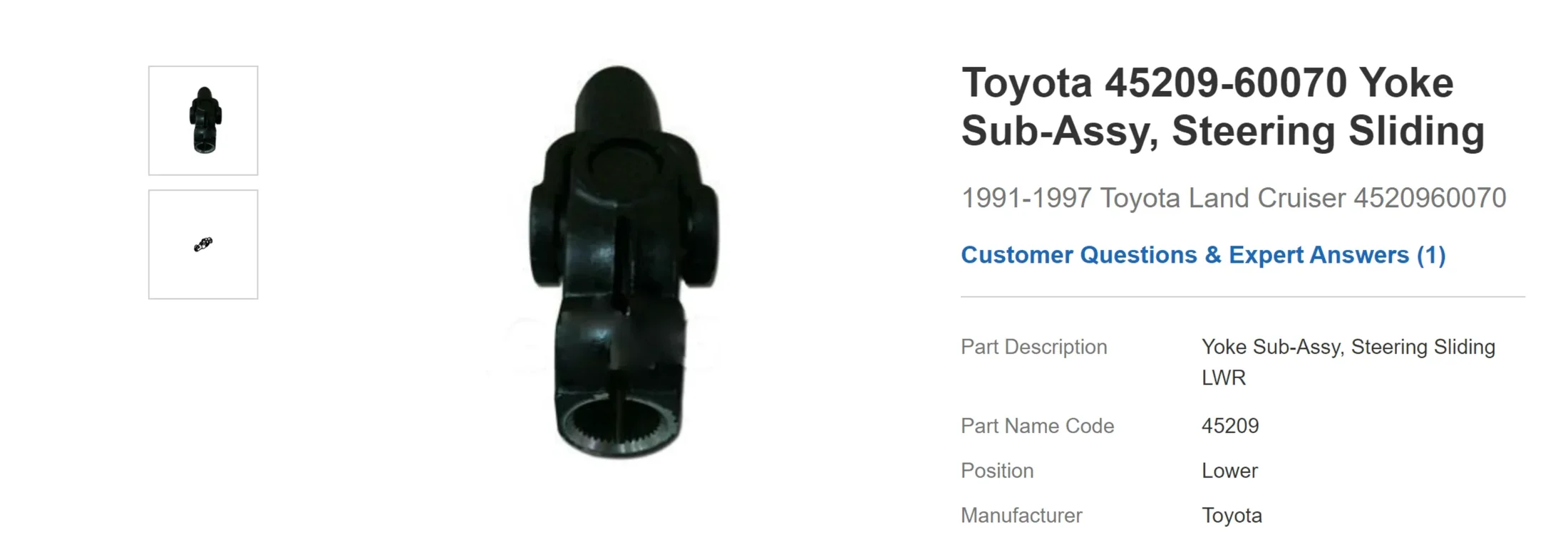

Part numbers for my intermediate shaft
Part number for the 2 U-joints I used, they are large and the clearance is tight on the steering box end with the water pump elbow.
