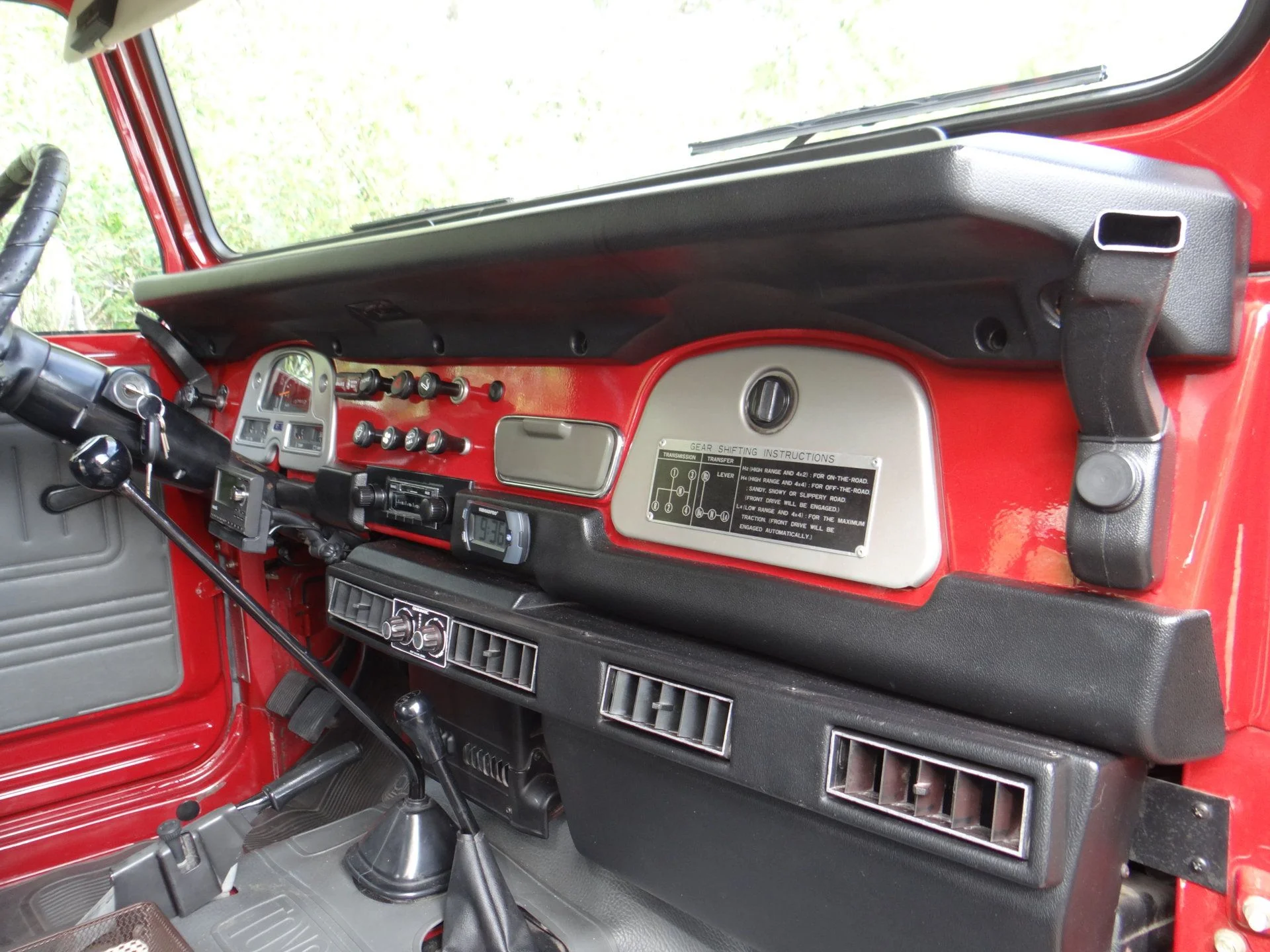

Our 1982 has a dealer add on A/C that was installed by the original owner in 1983. It is a Customatic made in Ft. Worth, TX. It is also the same A/C that our 1978 that we bought new. Yours looks very similar, but I think the fan box may be a bit bigger. It had a York compressor that was shot when we bought it.
That looks like the one!
We took Miss Scarlet to an old time A/C and radiator shop in our small town. It is a one person, one bay shop attached to his house. Syd had to replace the compressor and dryer along with the hoses. It cost us a few hundred less than a new unit. We live at 8200 feet and a really hot day is in the low 90s, but we only have a few of those. Most summer days are mid to upper 80s. The old A/C does a good job of keeping us cool.
Good to know!
