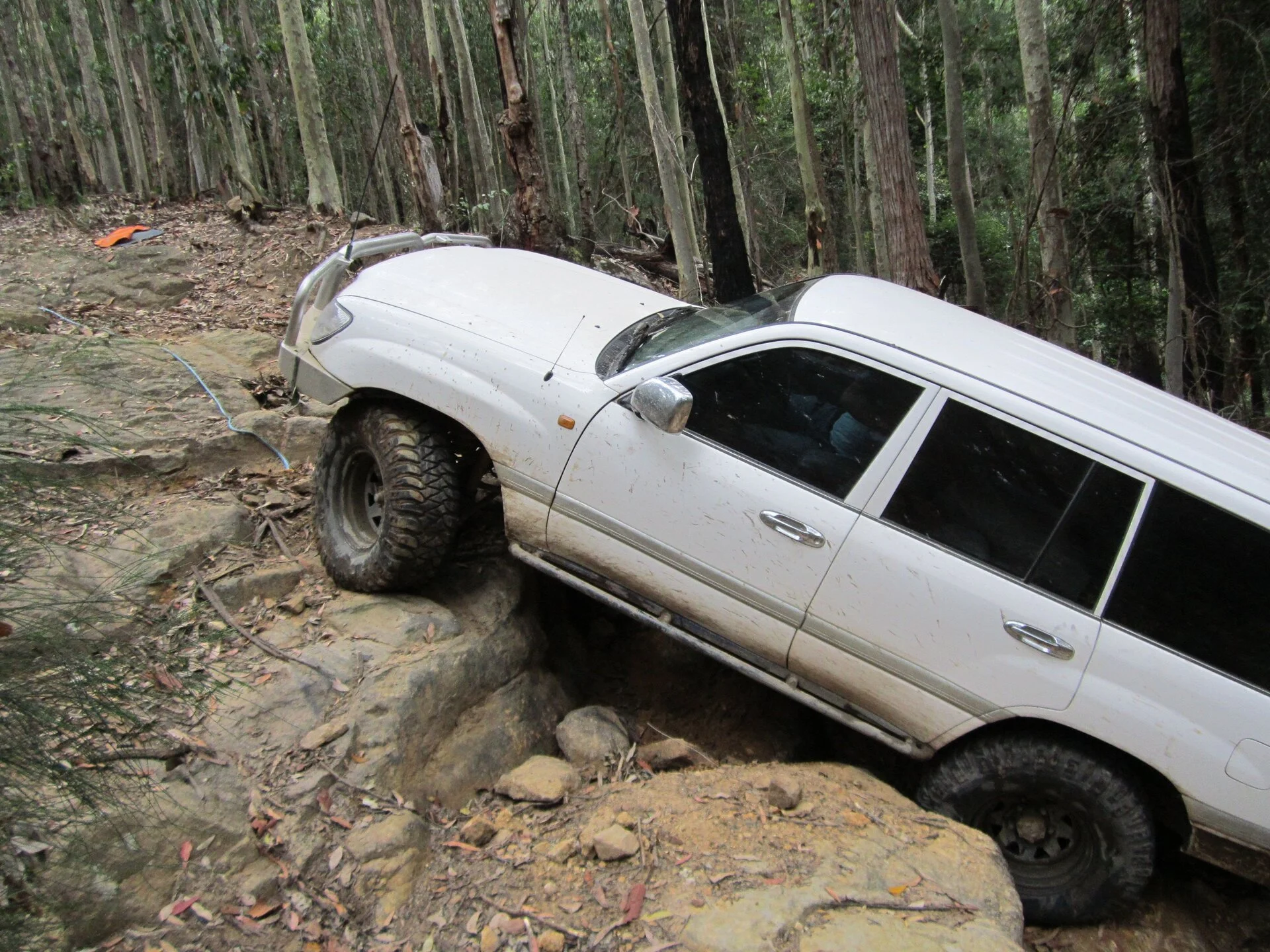

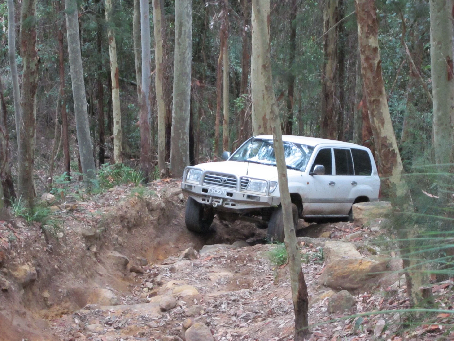

my daily driver 105 series, 2" lift, 35s, lockers, slders.
Mostly stock with a few inconspicuous mods.
Photos taken on a trip with a buddy in a much more modified cruiser on 37s.
he winched at the same points I did on this trail
