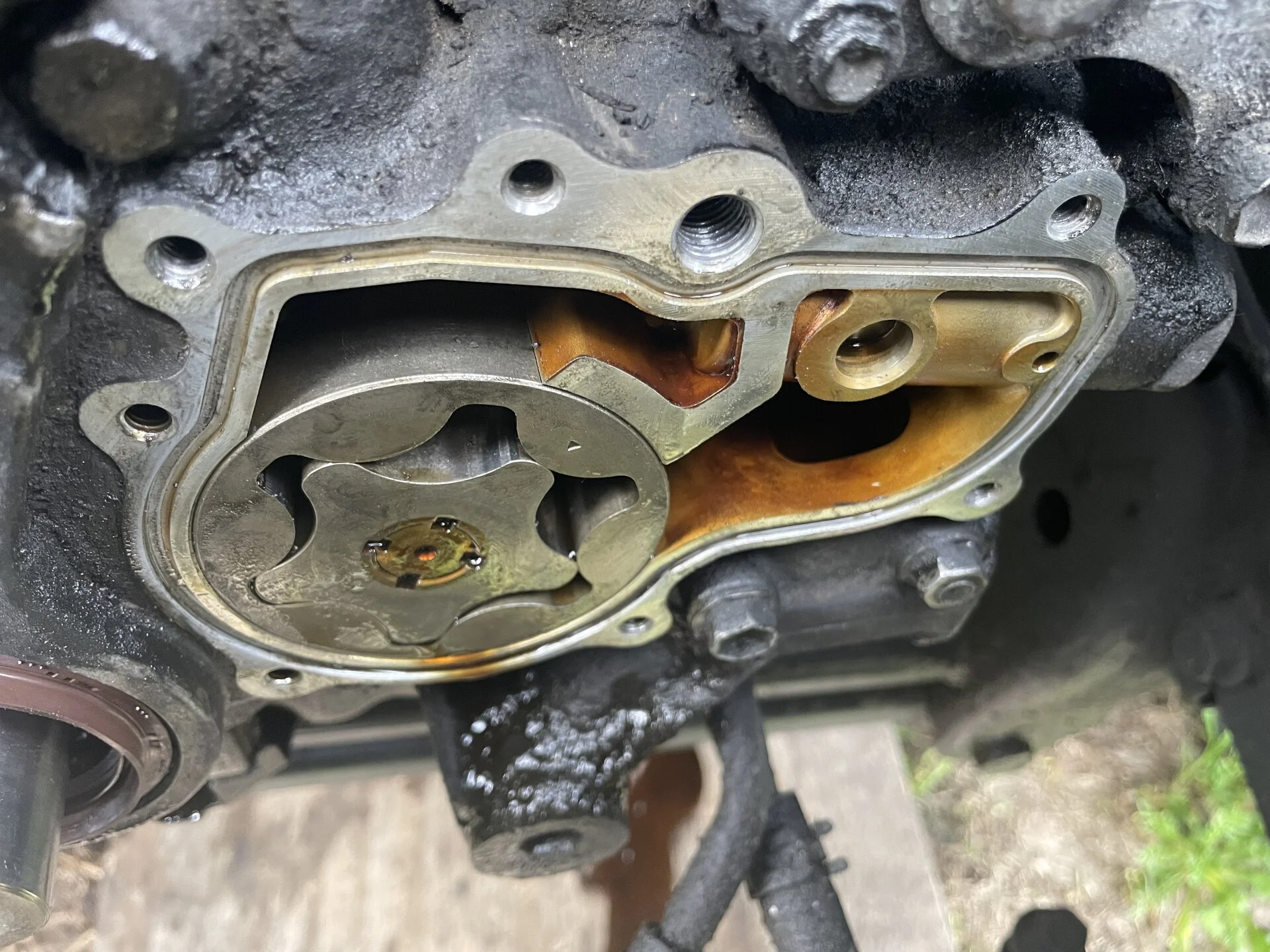

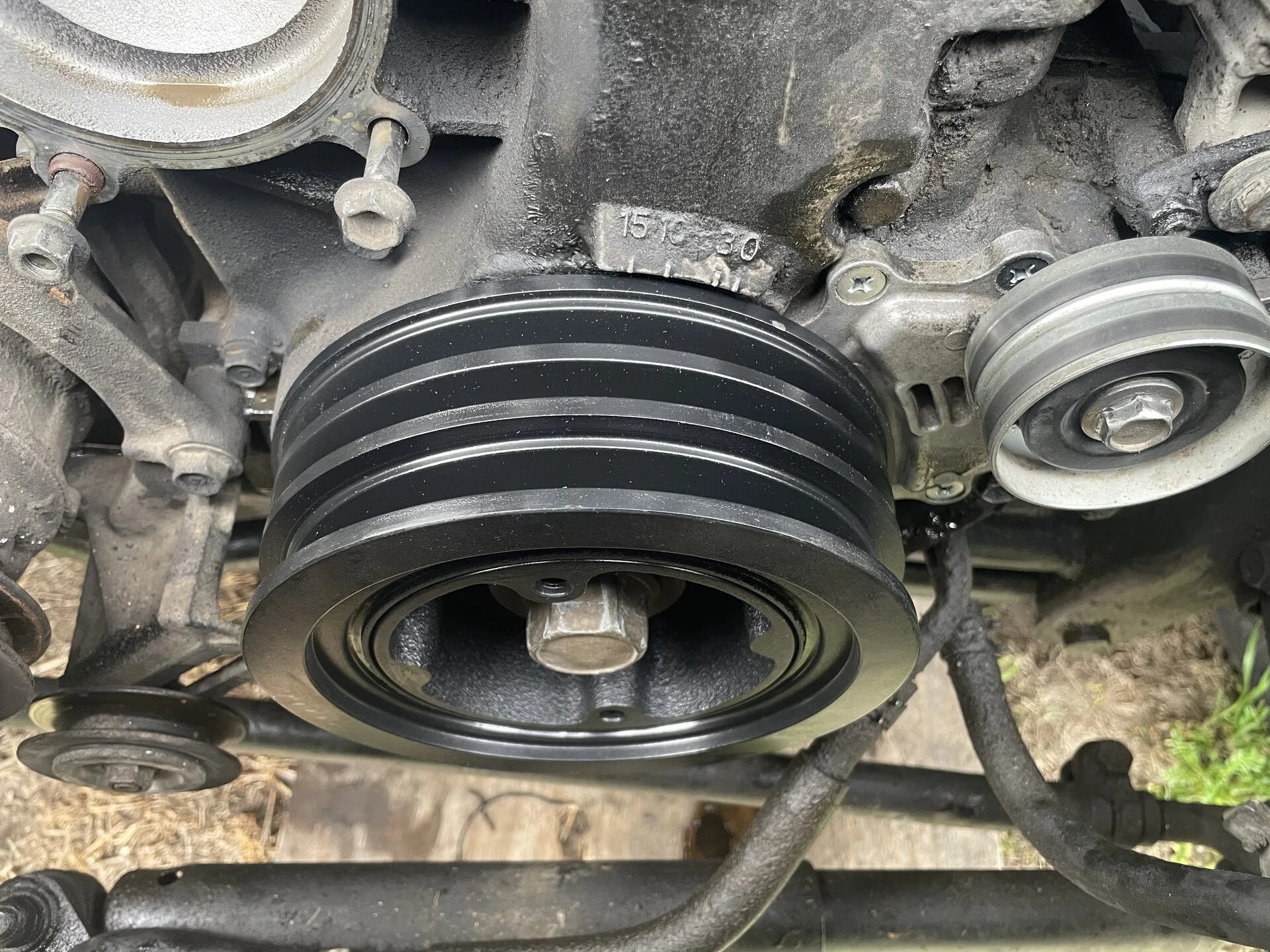

I was able to make some good progress this evening, but the rest of the weekend might be rained out. I was able to replace the front main seal and new crankshaft pulley. got the oil pump cover off without stripping those JIS bolts and replaced the oil pump cover gasket. Removed the old radiator, replaced the water pump. Got the timing chain and rotor for the distributor lined up to spec (I mean you never really know until you go to crank it but I took some pix and if anyone sees anything off please let me know). New distributor o-ring in place with new distributor cap and rotor. New plug wires in place and valve cover replaced with screws tightened down to about 15 inch pounds. New radiator set in place and on the last screw it fell into oblivion. Searched for about 15 minutes in the engine bay and on the ground, but could not find it so I called it a night. Pretty good progress for about 4 hours of work.
Oil pump with cover off, you can new new main seal in the background. Wasn't sure about placement and asked if it looked good and got feedback it did indeed appear in place.

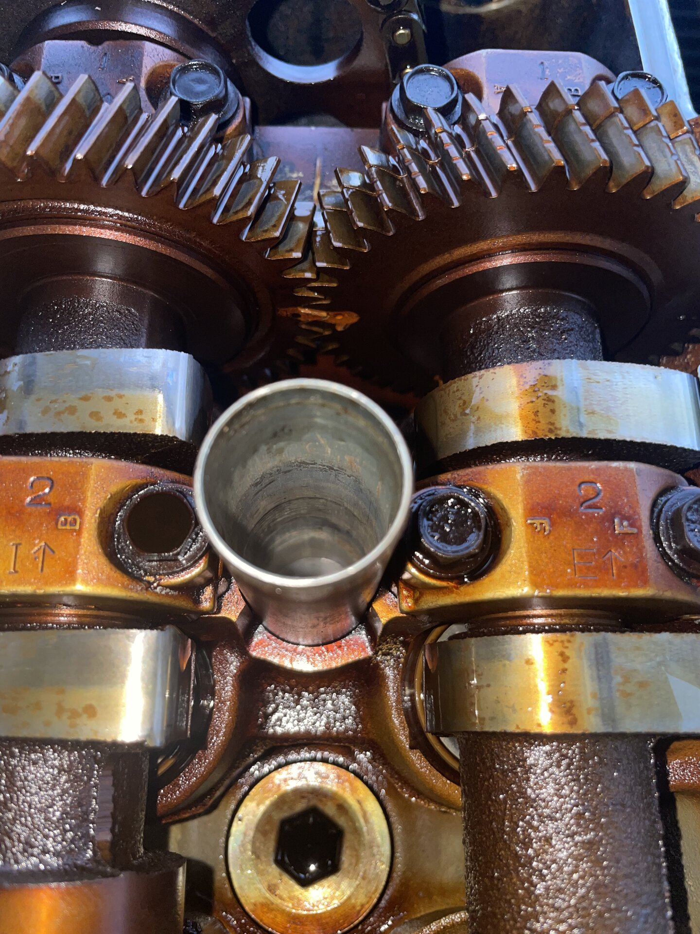

Marks on the back of the gears denoting I am at TDC, pretty sure.
Brand new crank pulley. Bolt in place and torqued to 304ft/lbs

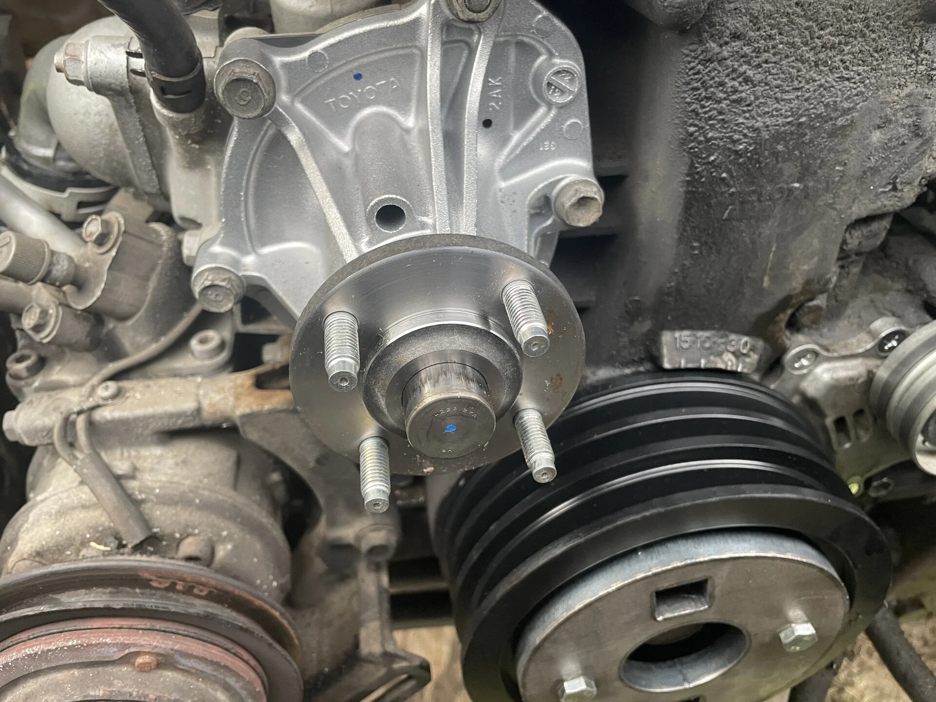

Water pump in place, just begging for belts and fan clutch.

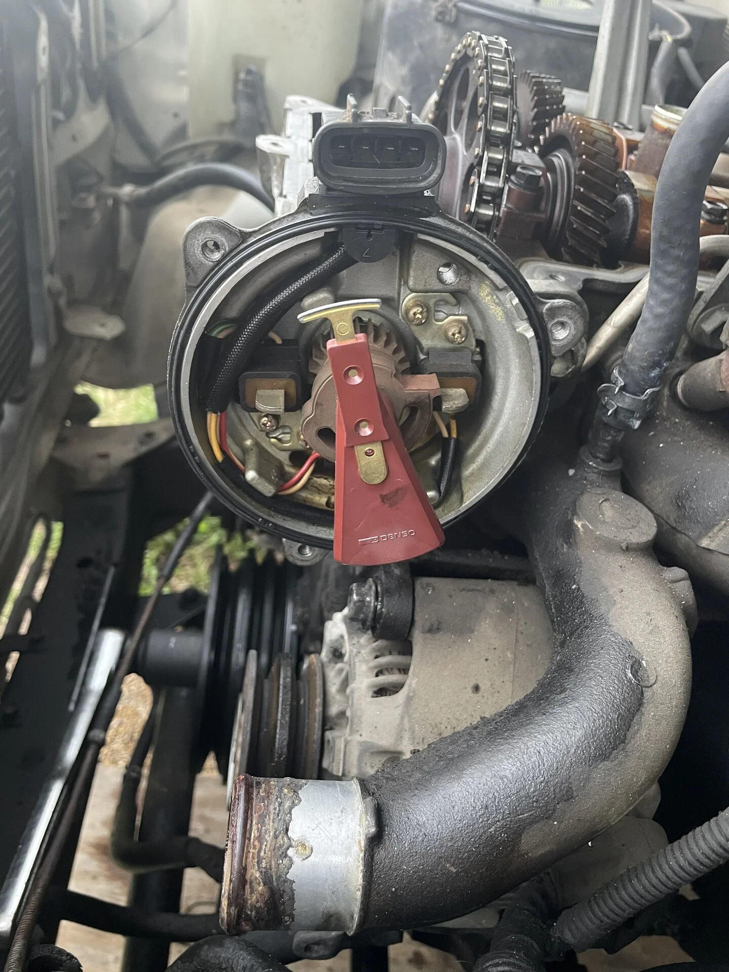

Rotor pointing to #1, or where it will be once the cap is placed back on.

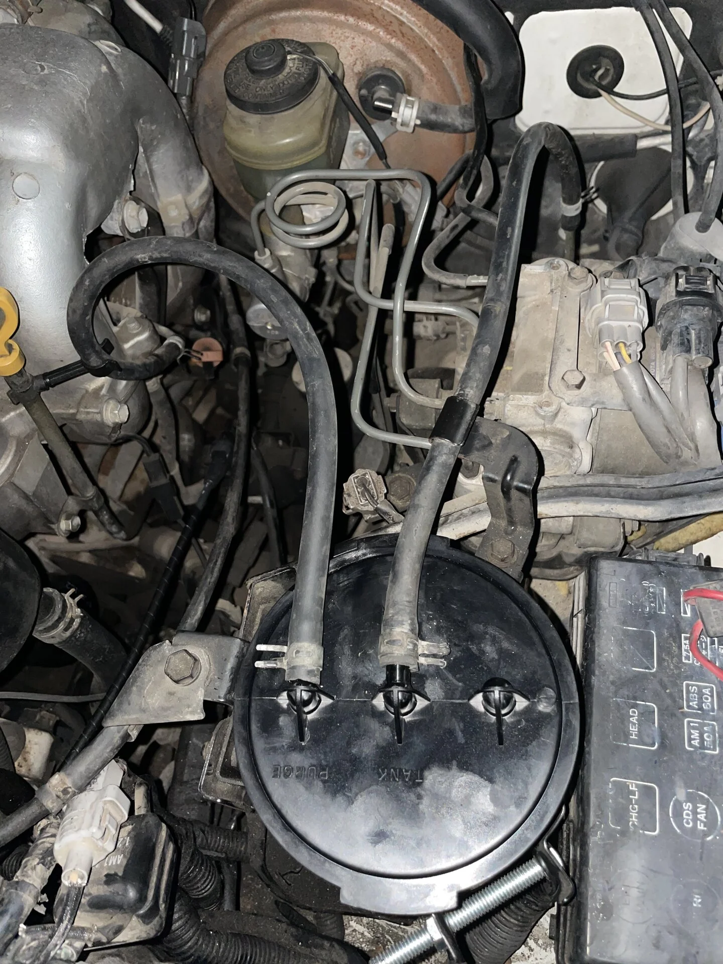

I also installed one of the autozone charcoal canisters that has been reported to work well. I had a little trouble finding the tank and purge lines since the tank line was attached to a metal filter of some kind and zip tied. But find them I did and put everything in place. I was not having any specific issues while filling up, but PM is PM and I wanted to replace it.

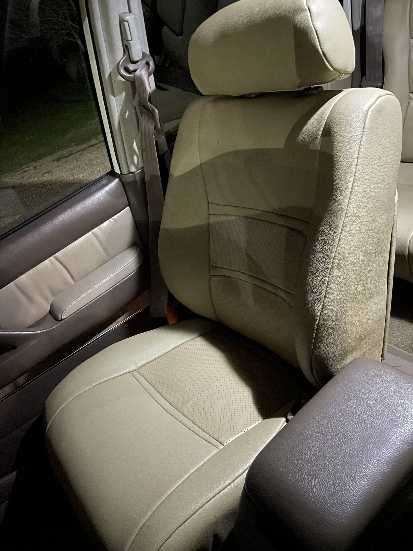

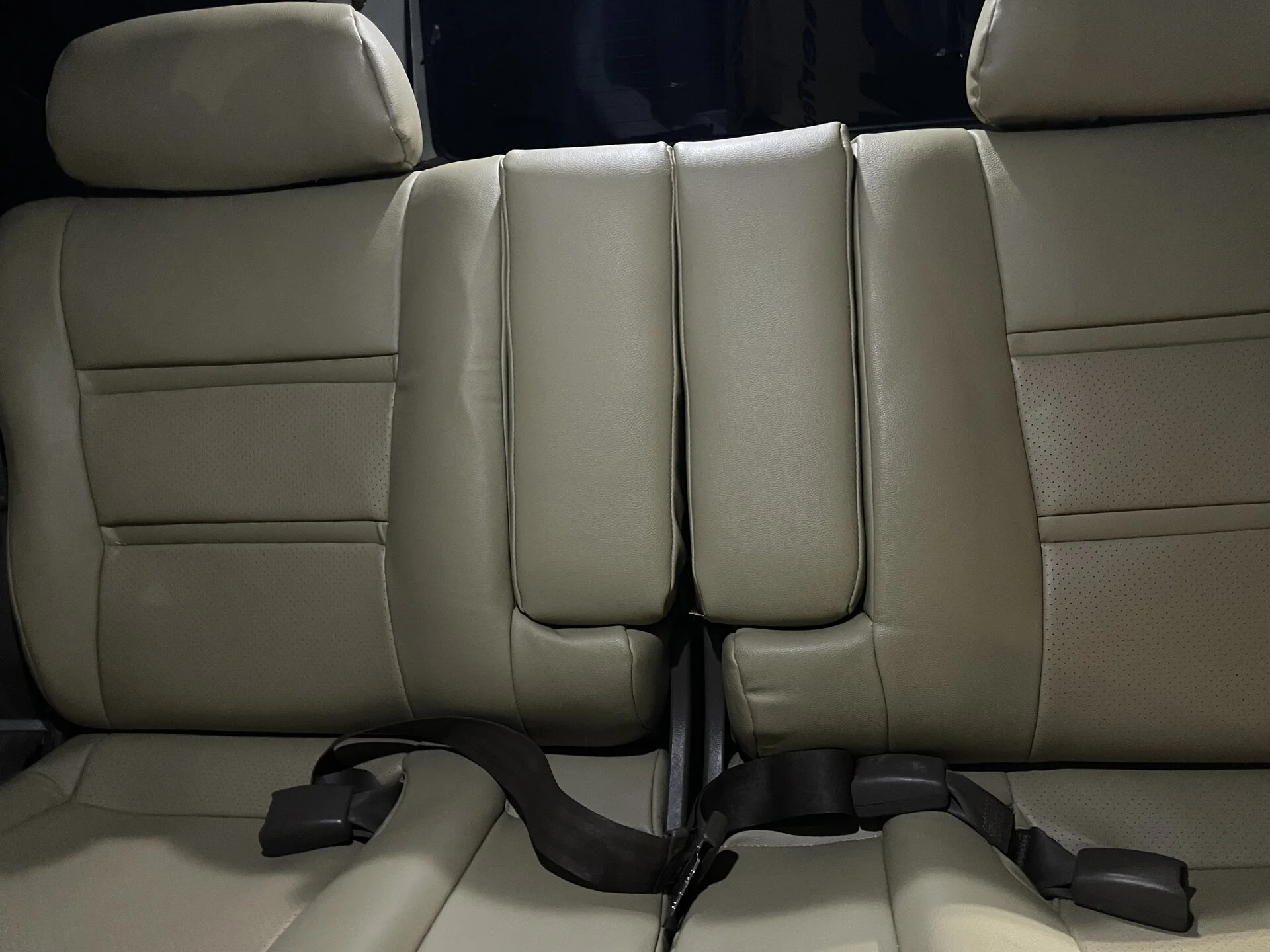

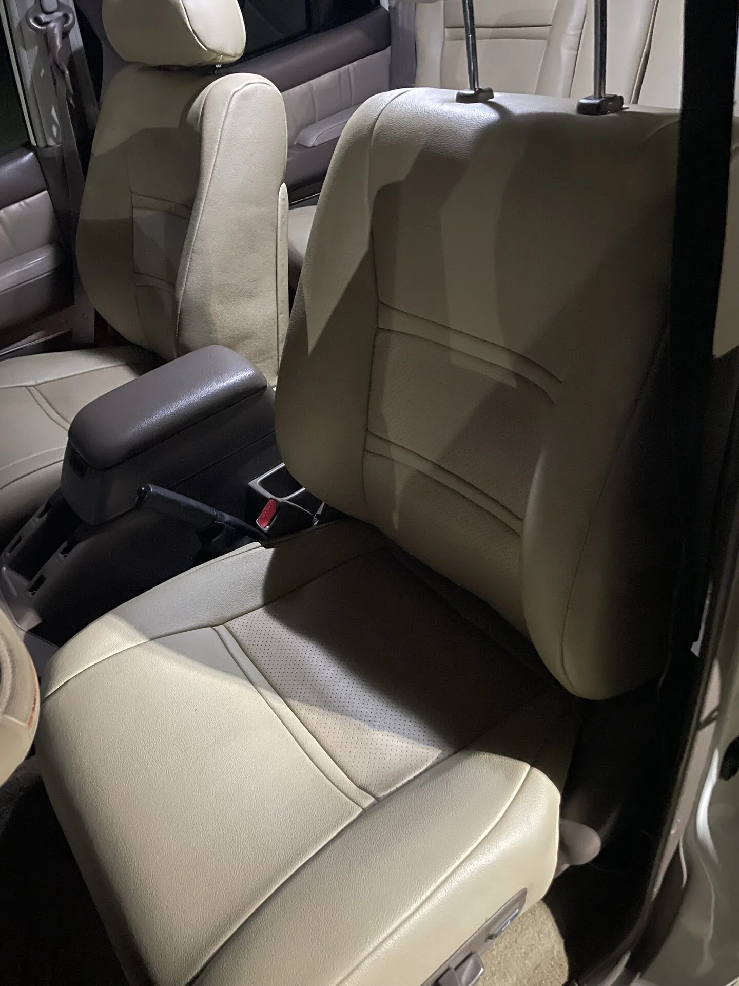

These are custom made covers with seat foam repair. It was a little bit of a journey and I would not say it looks perfect, though in the pix you can hardly tell. I did not do the work and the gentleman I worked with was slow, but he was nice and relatively inexpensive. The material is 100% genuine vinyl, probably the best option for an overlanding vehicle. He could not source leather. All in all I am happy and quite frankly in my area I did not have many options. I will say it is lightyears of an improvement from where I was and I am not ashamed to have my wife ride with me now.
I also repaired the seat gears with the new plastic gear. Out of all the things I have "fixed" for whatever reason I really enjoyed that fix. It seemed elegant, call me crazy.

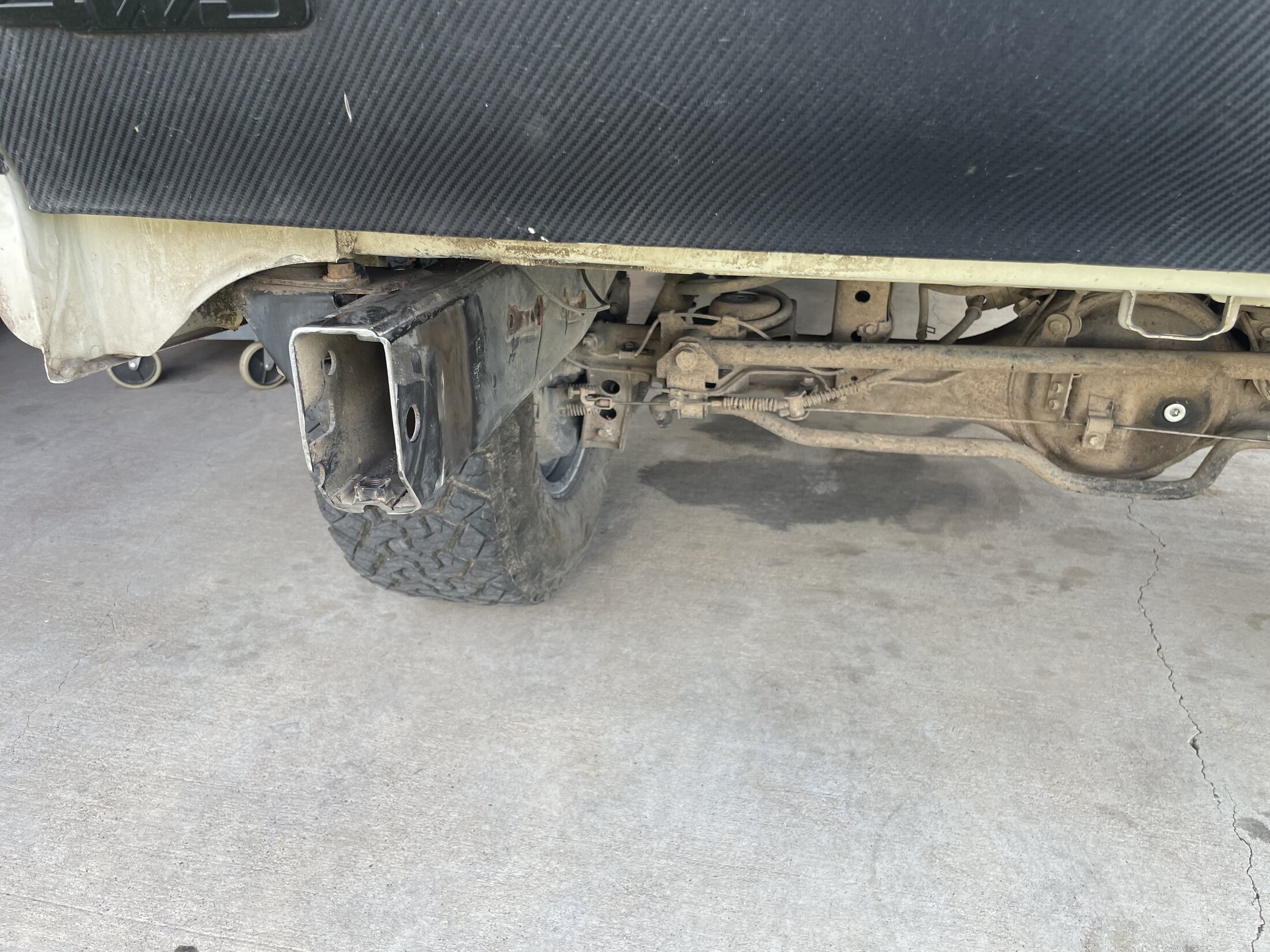

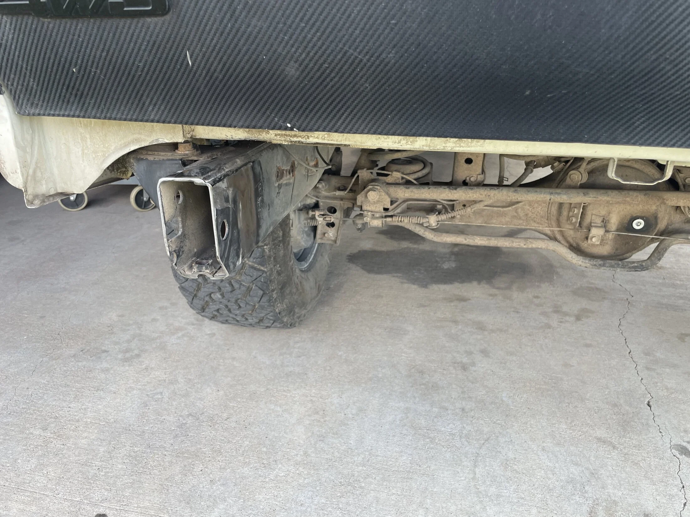

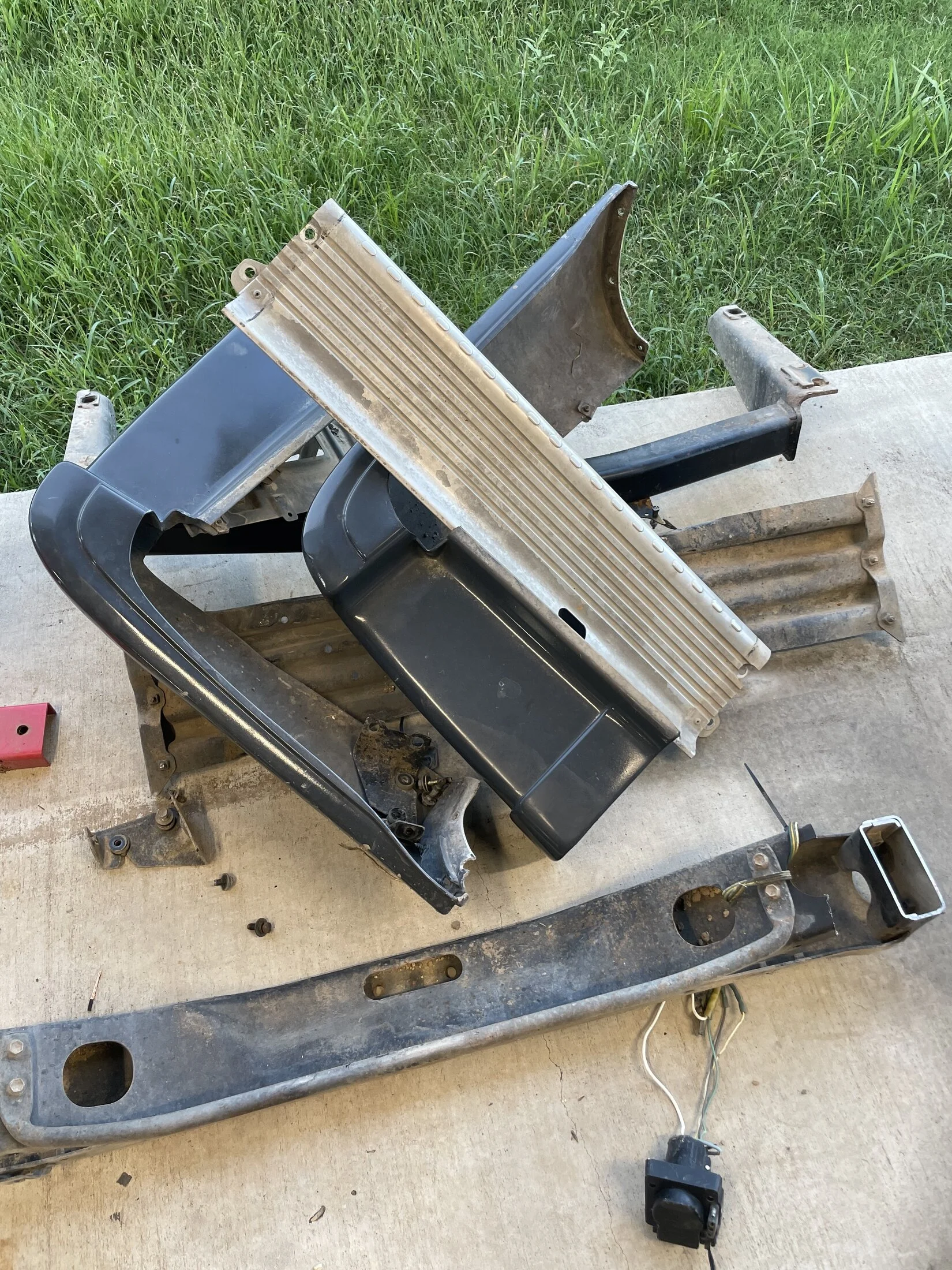

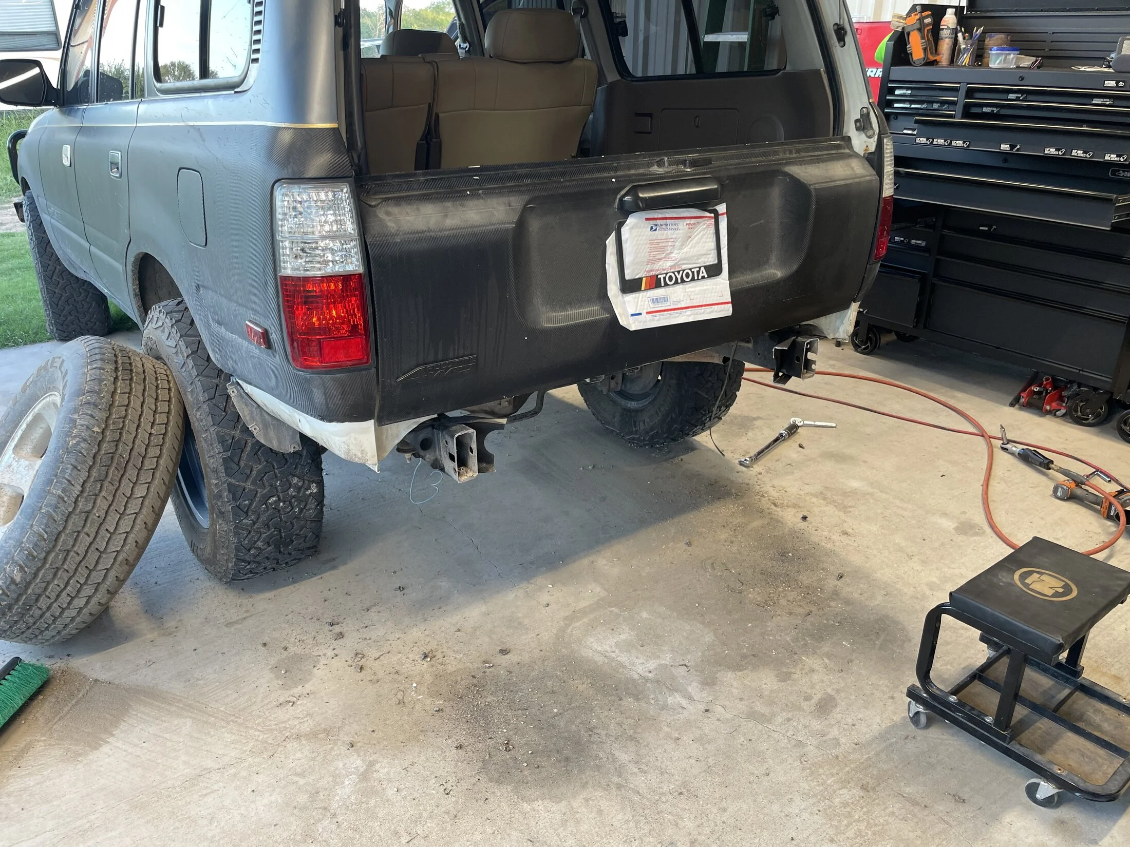

This afternoon I was able to finish grinding down the rear frame so it is ready for the bumper when it arrives. All I will need to do is put it on and install with 10 bolts. I also installed the blinker interrupt for LED lights and it worked without any trouble.
Notice the spare with original wheel and tire!
Inside frame rails ground down and ready for install.

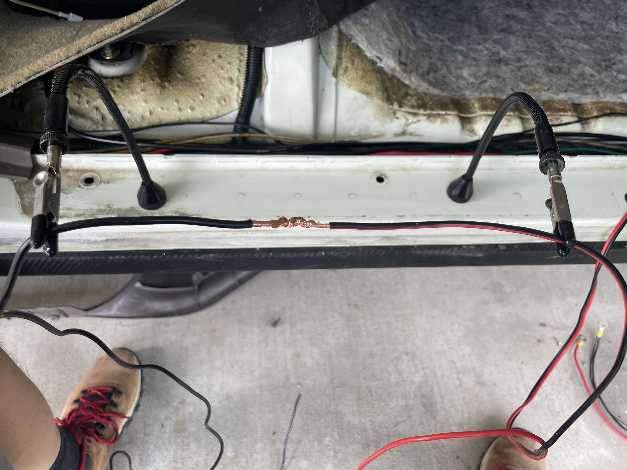

Just a pic of my solder set up for the electrical wires for my midland gmrs radio.

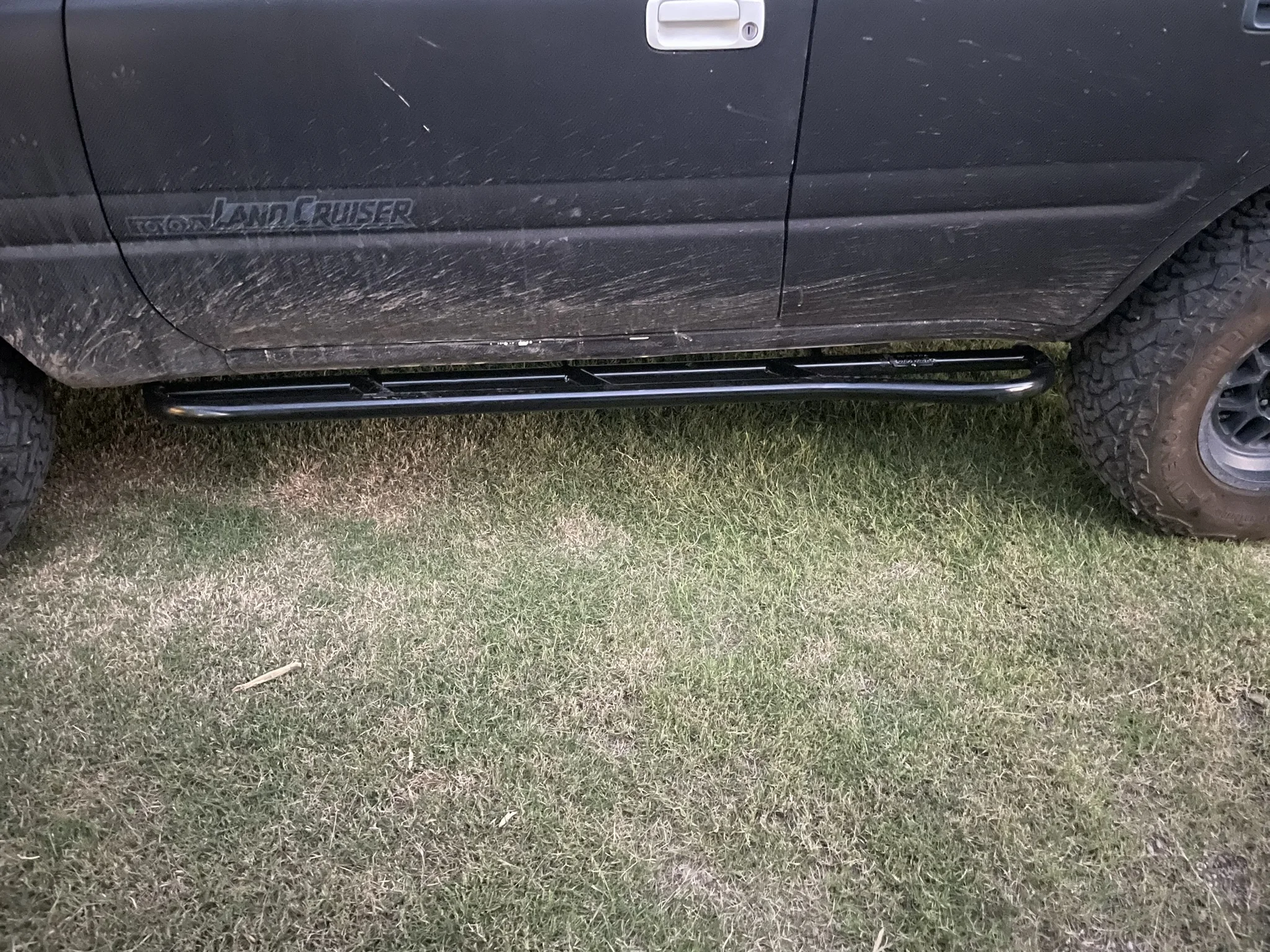

  • install sliders DONE

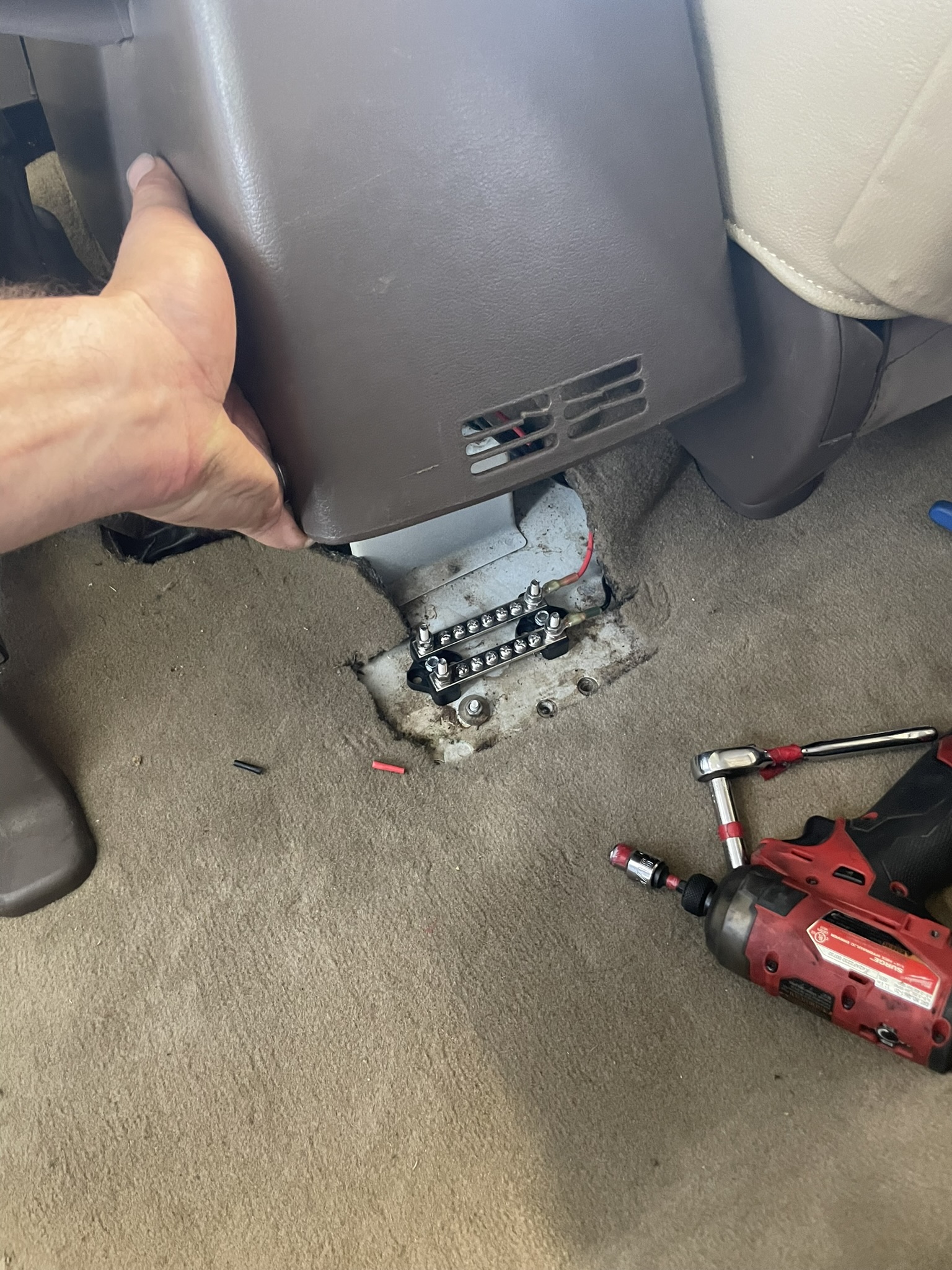

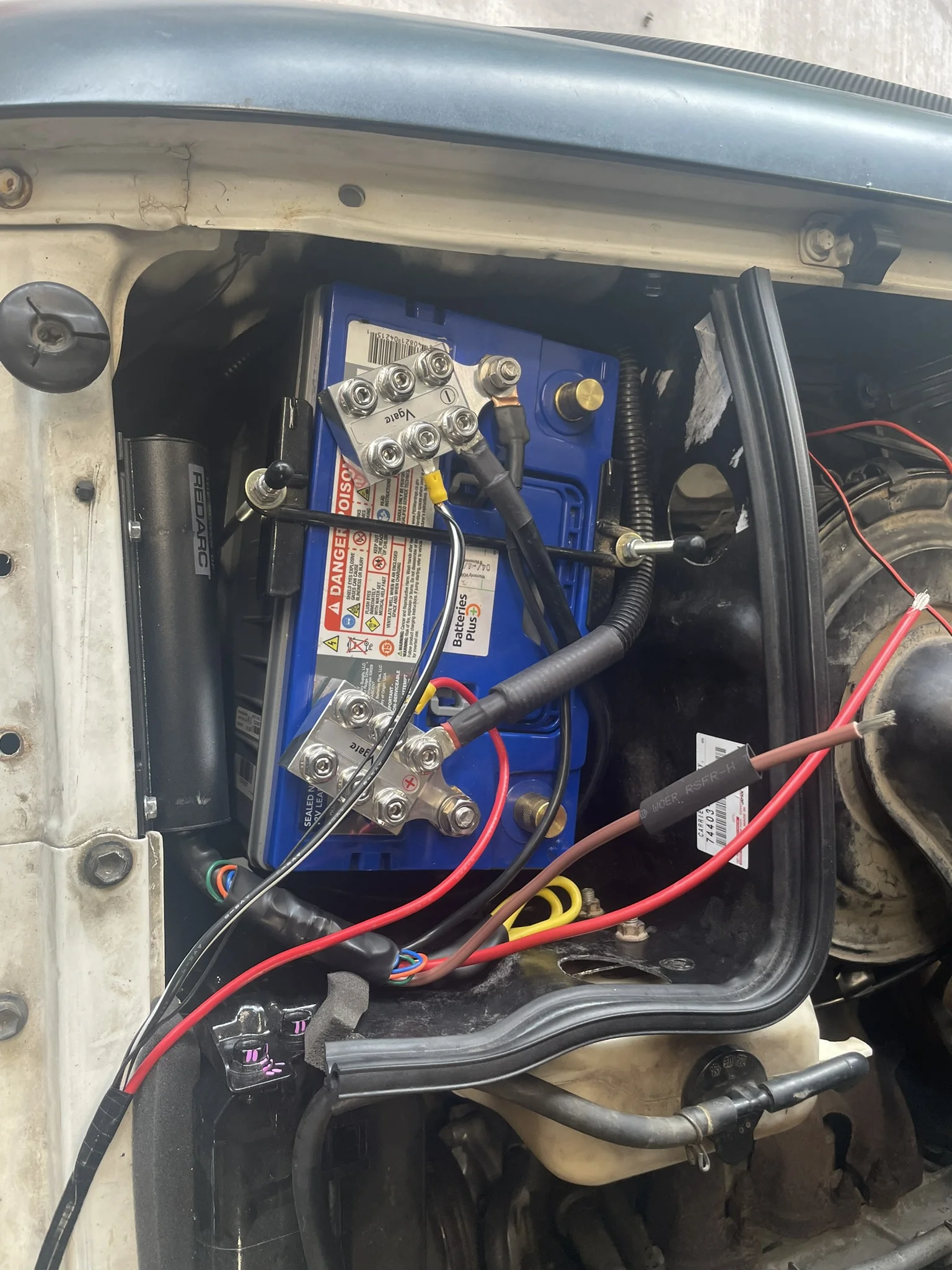

You can see here the Vgate terminal Bus bars. I like these for many reasons, but they are a little pricey.

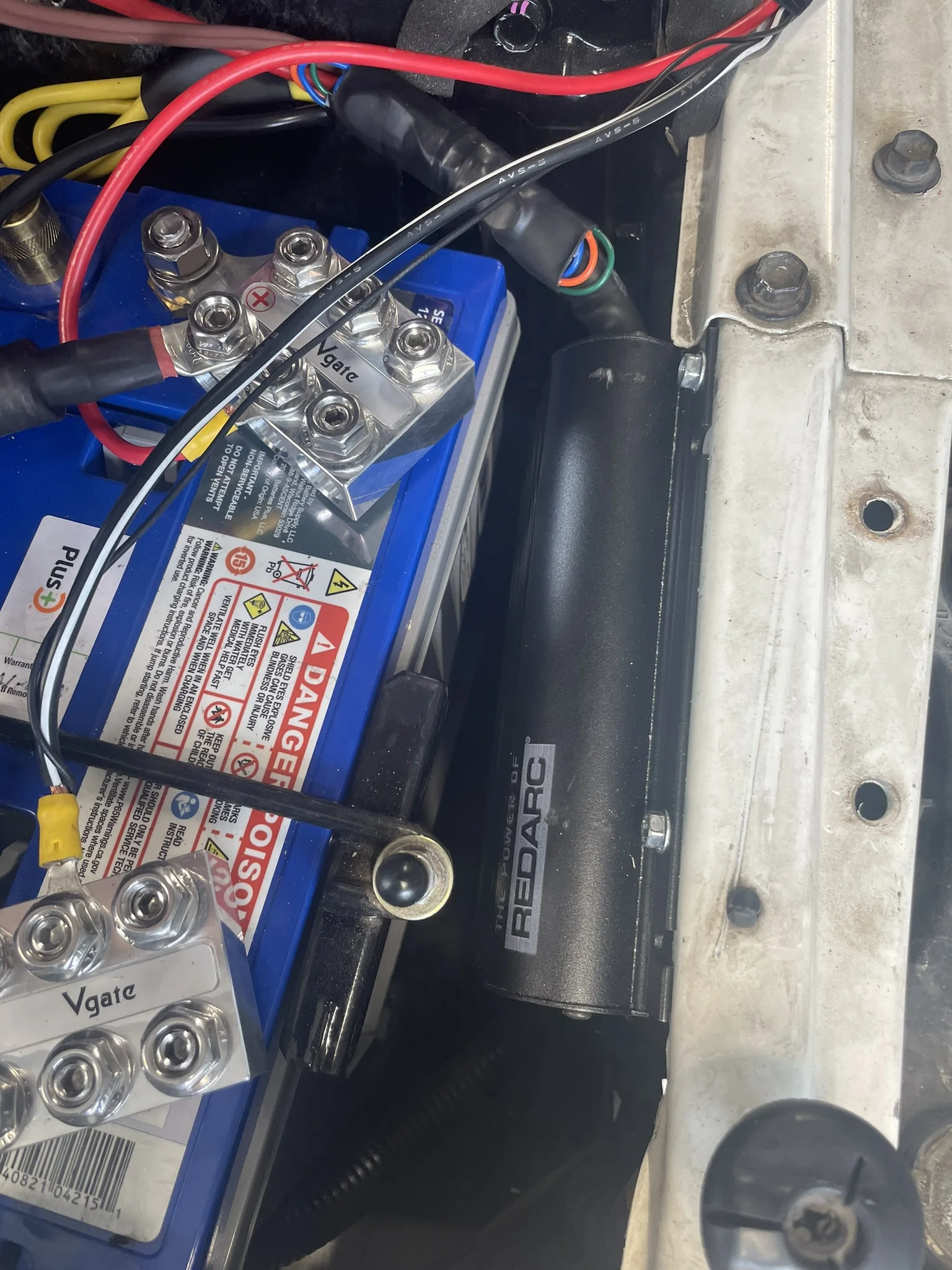

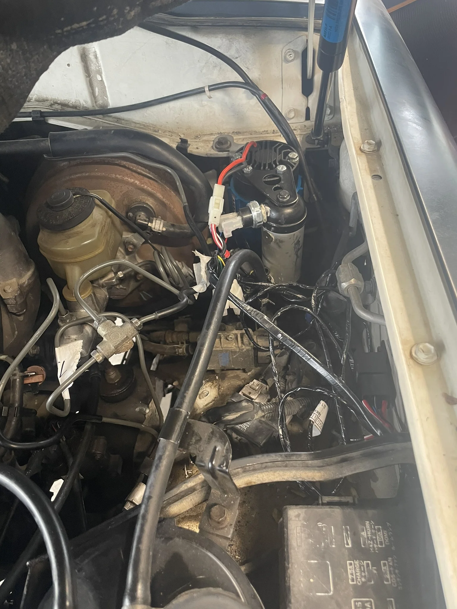

You can see the Redarc charger here. It is in the place where the radiator reservoir used to be. I did straighten out the lip so it would sit flush. The instrument has cut out holes which would not work so I drilled directly into the lip, but only at the top. It appears to be very sturdy.

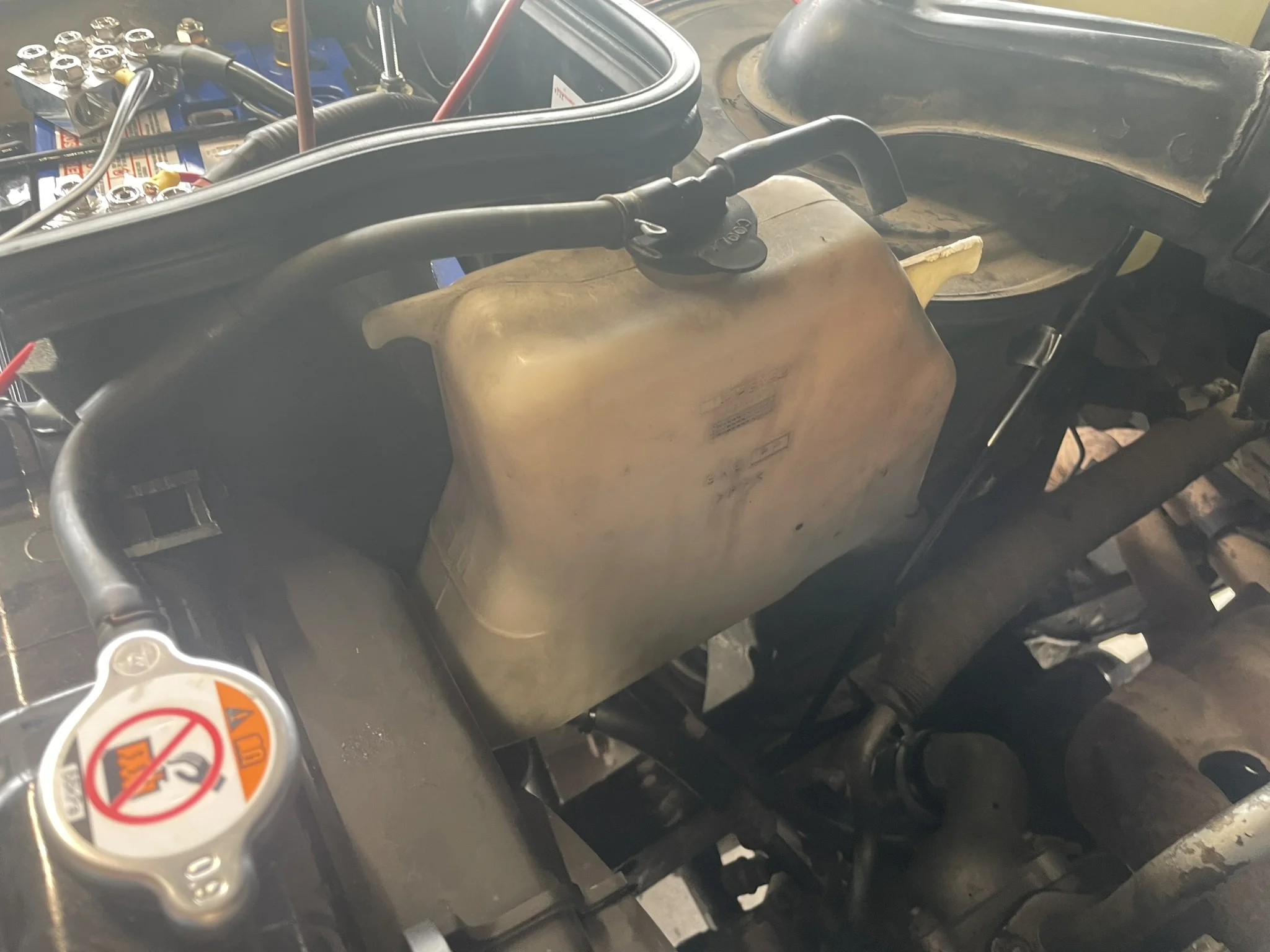

I relocated the reservoir. I removed the bracket, trimmed it and bolted it directly to the second battery tray. If you do this make sure the top does not hit the hood when it closes. Ask me how I know.
The slee mounting bracket for single compressor works very well here. One issue is that it somewhat occludes the firewall grommet which makes running wires to the cab slightly more difficult. You can also see here the ABS is removed and front and rear brake lines have been rewired.
Finally I ran some 12awg wire to the in cab bus bar with ignition relay switch. I wired my new chargers off of this along with the 12v DC charger in the back for my Wagan Tech battery.

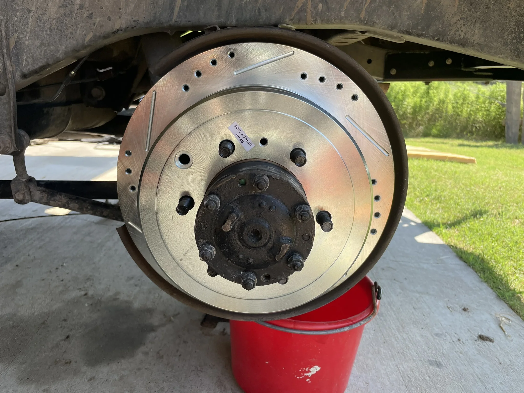

New rotor installed. Calipers I bought already had the bracket installed which made the passenger side much quicker once I knew that, LOL.
4X4 labs sliders. Look beefy, pretty straightforward install.

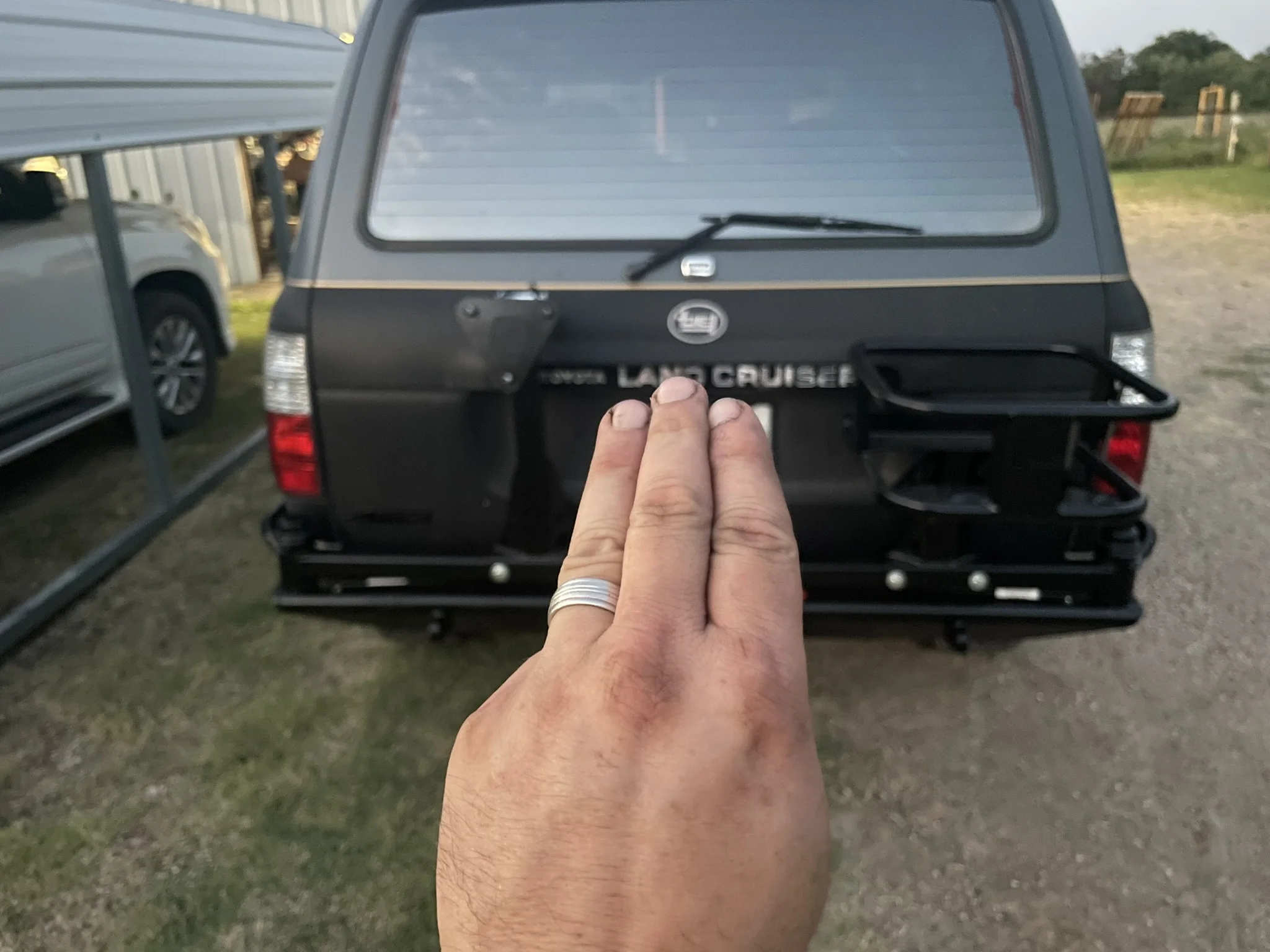

Ugh, my hand is not the important thing here but it is the part in focus. Sorry. Here is the 4X4 Labs rear bumper installed. It slid right on and only took about 15 mins to install, once I had the frame prepped. VERY sturdy, no squeaks and the hydraulics are top notch. Minimal but functional!
