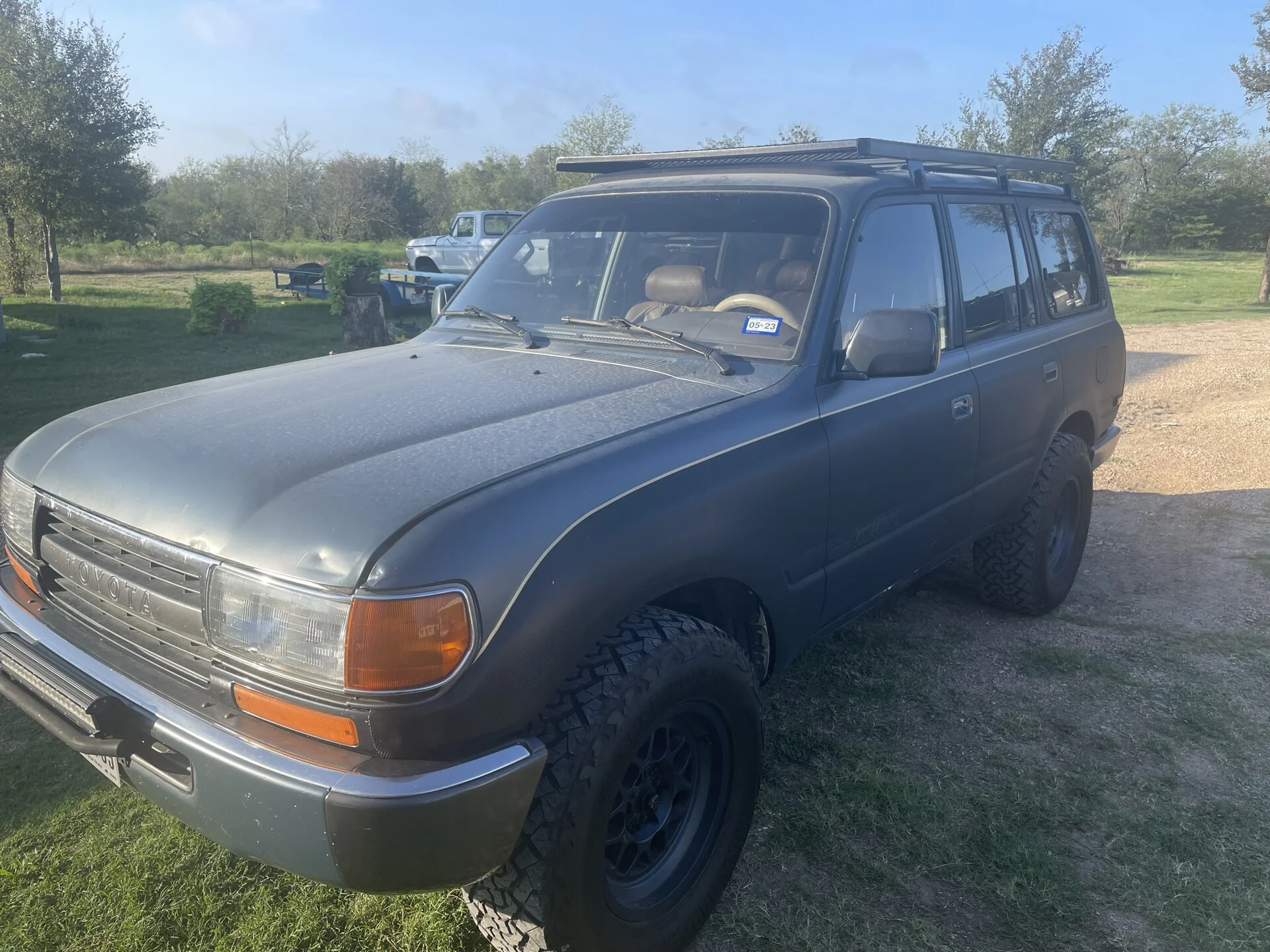

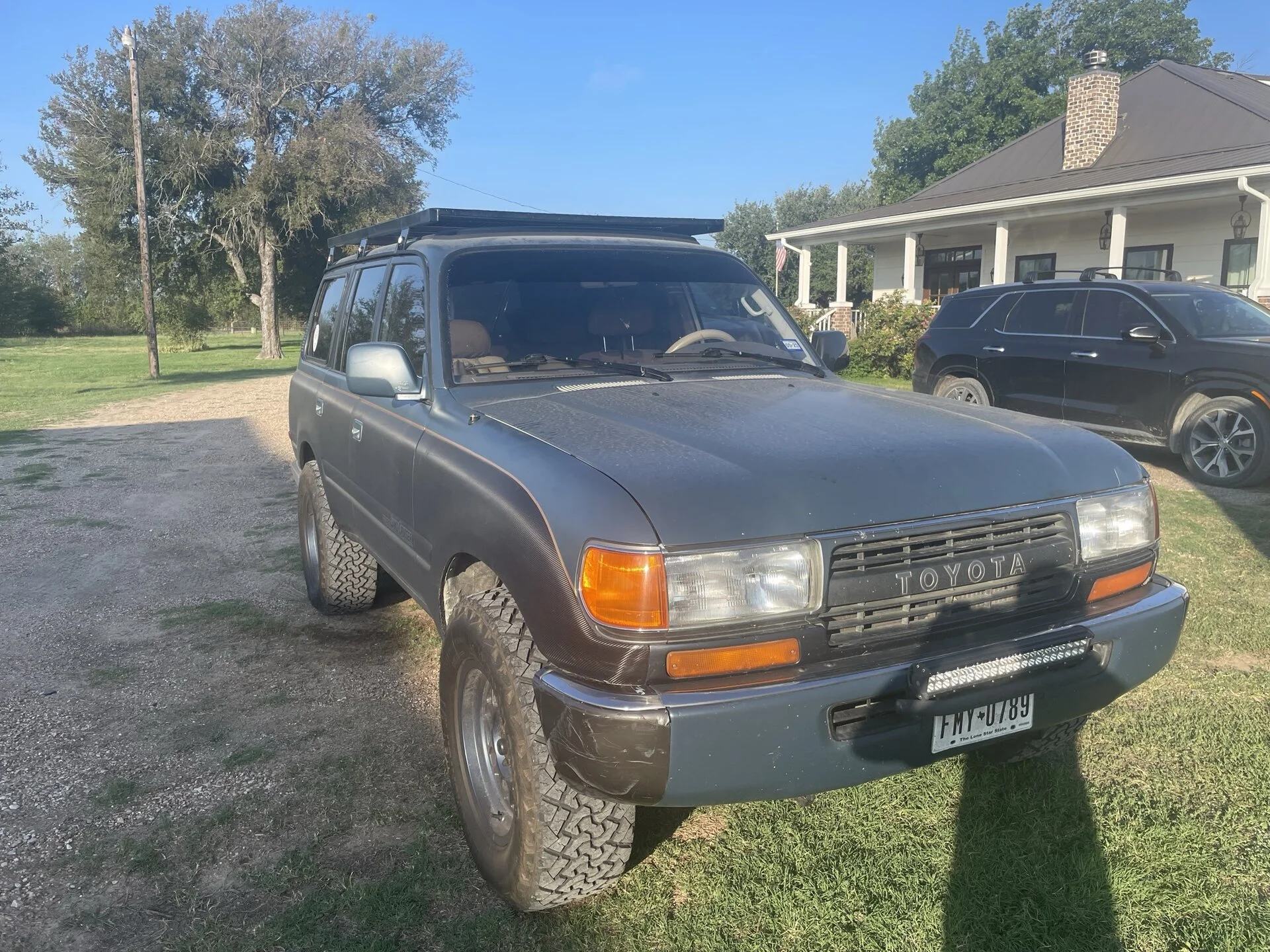

I introduced myself a little earlier in the week, but I was able to pick up our "new" Land Cruiser yesterday evening. It is a 1995 with sunroof and leather, not sure what trim that makes it. Has 179K miles, which was about as low as I could find without resorting to highway robbery. Paid $10K for it. There was one near me with a little over 70K and I won't lie, it was in pretty good shape, but they were wanting close to $40K and I just could not find the value in that.
It was originally white and it is currently wrapped. I do not absolutely love the wrap, but for now it will protect it and it is in decent shape. My 20yo son does not love it the wrap, but it is not his truck so there you go. Has aftermarket wheels and some cheap all terrains. Tires are a consumable and I will run these until they show themselves to be dangerous (unlikely) or I need new ones. That is a custom roof rack, looks good for now. Will likely use it and see how it fairs. It drives good, transmission seems to shift well, smooth acceleration, though as many have opined, not peppy. My initial impression is that it has a solid foundation, but there are "cosmetic" issues that will need to be addressed. My plan of attack will be to address the "cosmetic" issues based on my own personal needs and how much they cost. I put "cosmetic" in quotations because that catch all includes items that are not important to the working of the vehicle but may not be actually a body or interior issue. For example the leather on the shifter knob wearing is literally and figuratively cosmetic, cruise control not working to me is "cosmetic". And of course cosmetic may be a place for debate. At any rate a list of "cosmetic" issues so far:

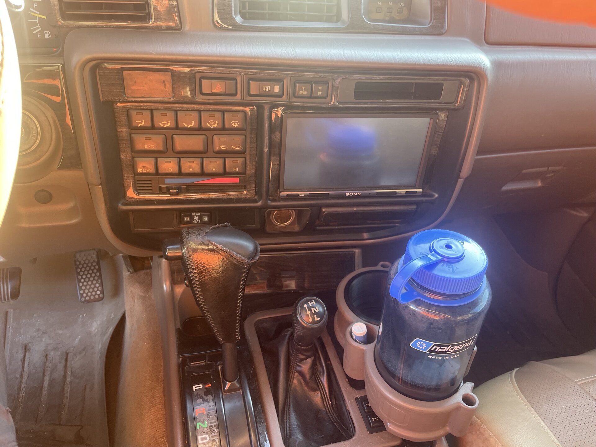

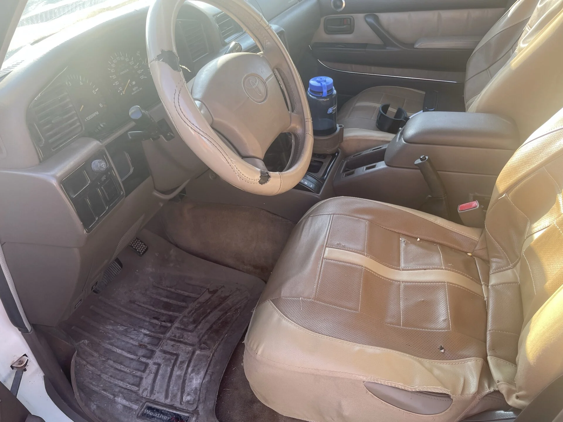

steering wheel cover worn
shifter knob worn

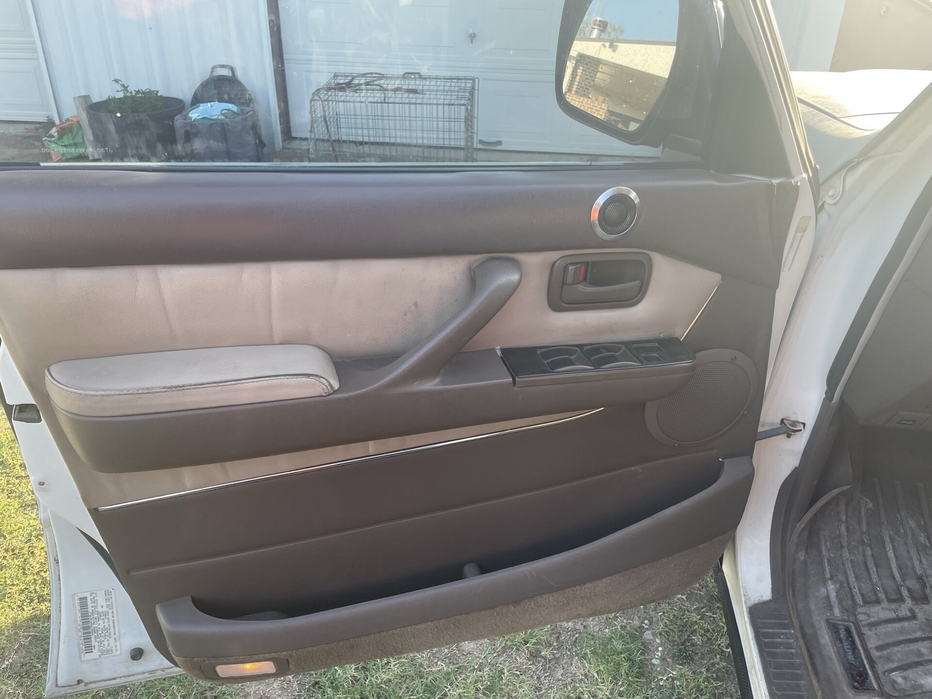

drive side door panel loose

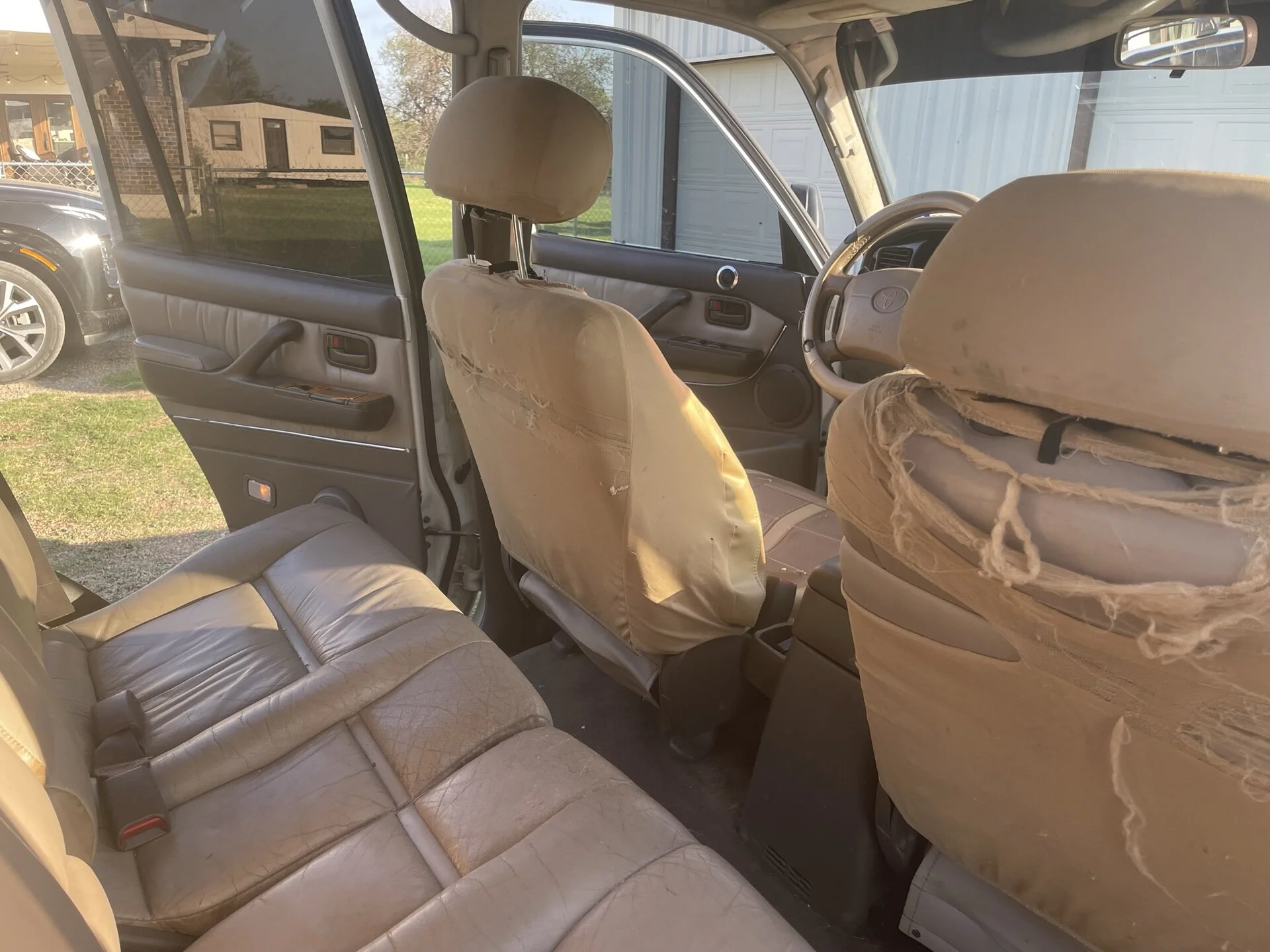

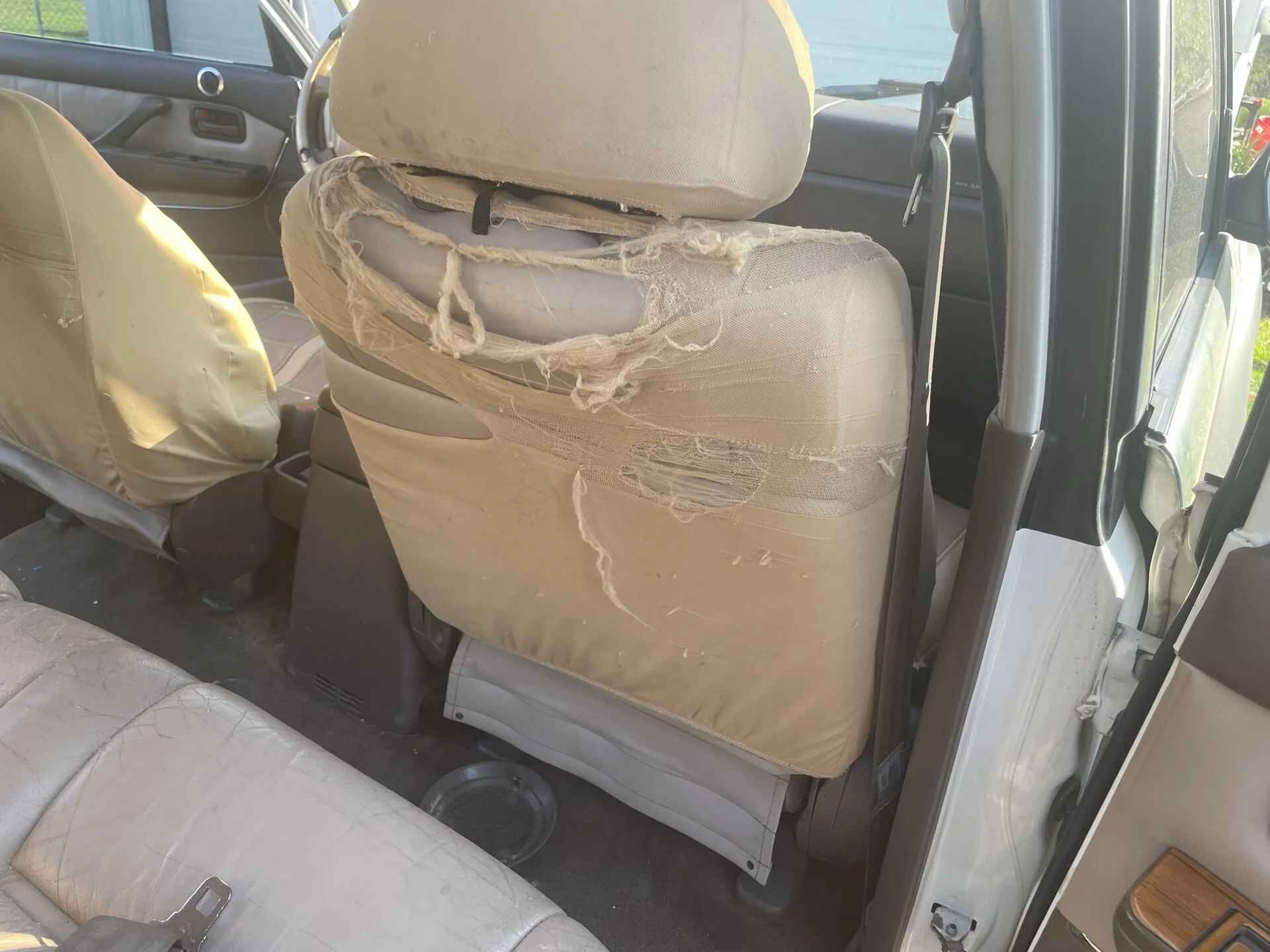

driver and passenger seats need reupholstering

cracks in the dash
Transmission shifter icons worn
cruise control no working
climate control buttons finicky

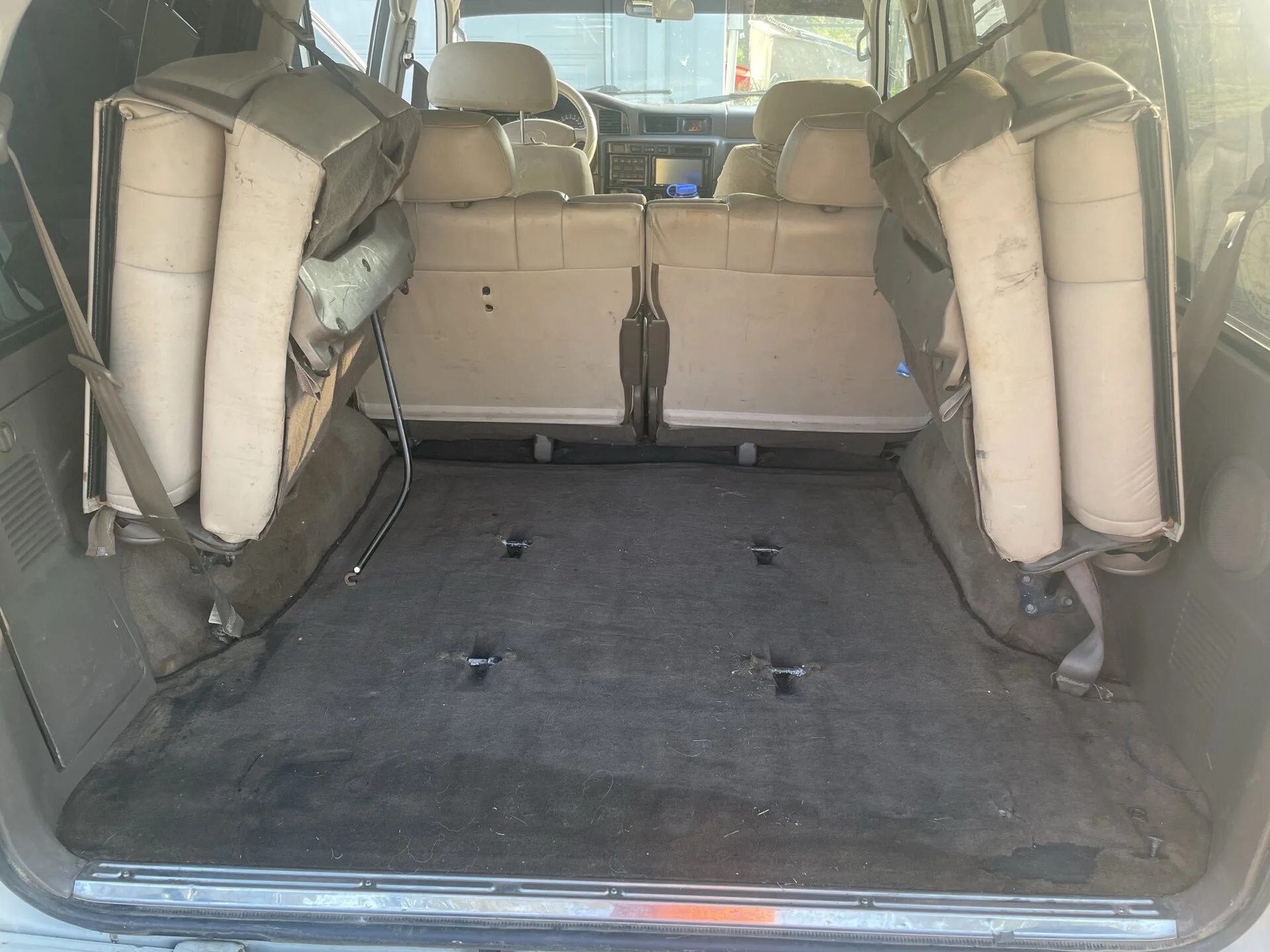

carpet needs deep cleaning

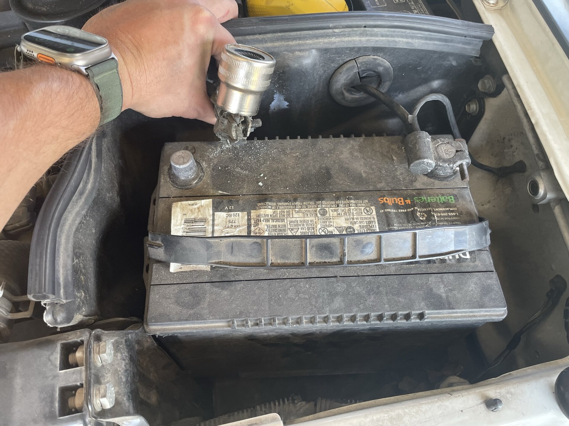

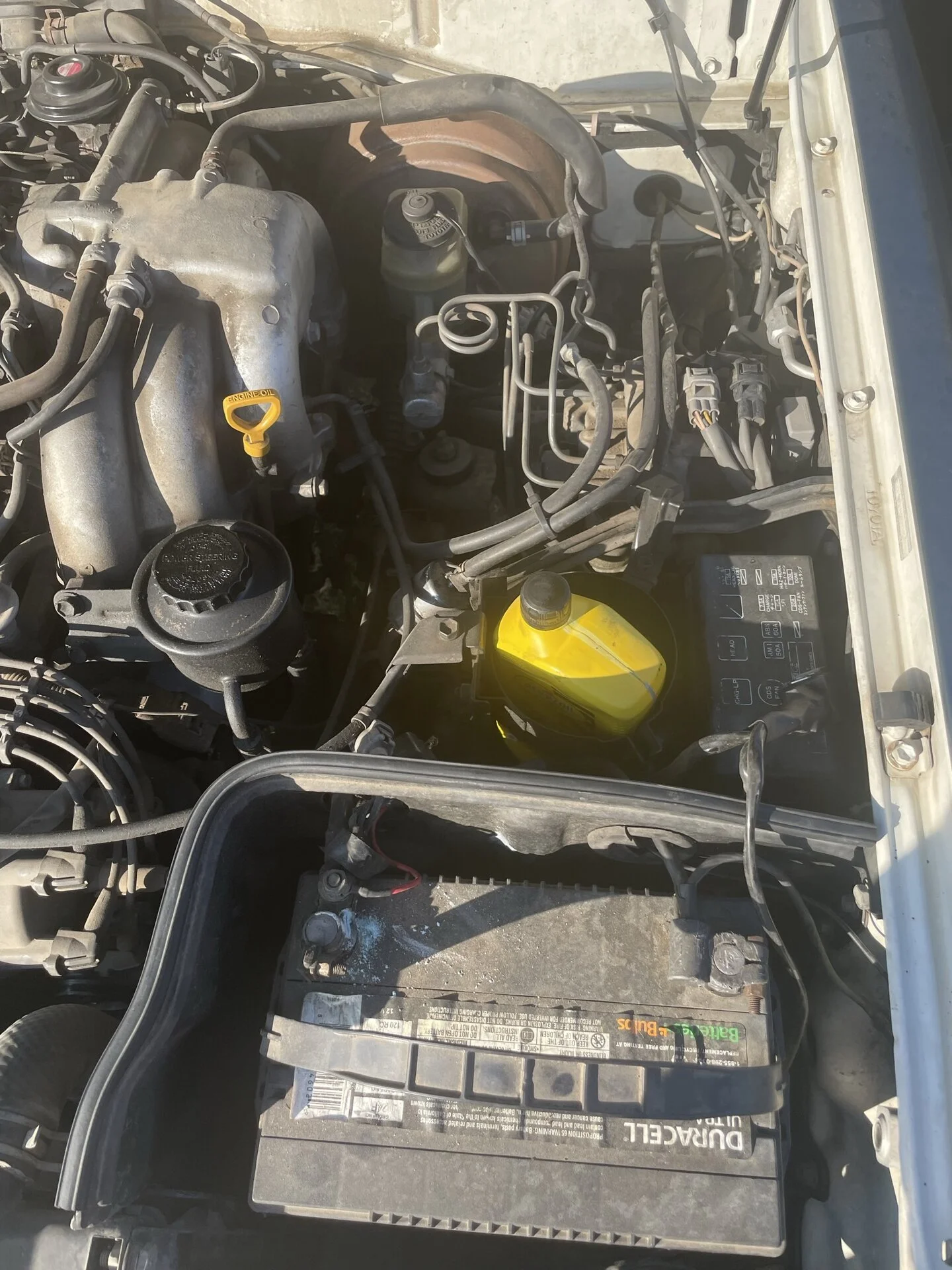

First order of business was to clean the battery. There was some corrosion on the terminals.
As you can see here
I utilized my post cleaning tool
Worked it around for several minutes and made sure the contacts were good and replaced the wires.

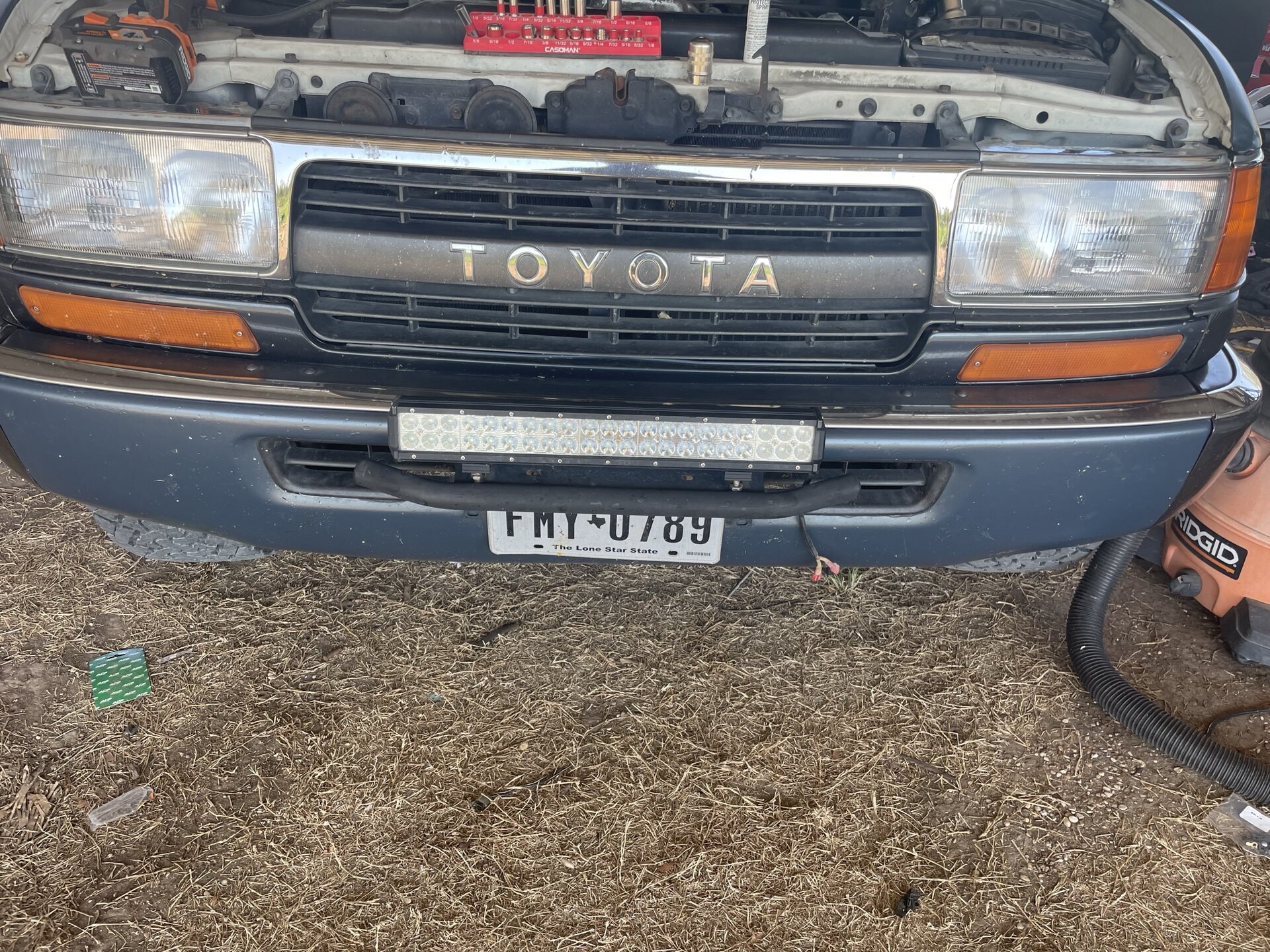

At this point I noticed an accessory pos and neg to the battery and I followed the wires to see what it was to.
The front light bar. The light bar had a switch to the dash that appeared to work (lights went off and on) but the light bar did not work. So I uninstalled the light bar. I would have likely uninstalled the light bar anyway as I am more of a fan of amber pods here.
Probably a good thing I uninstalled, the nuts were not even finger tight.

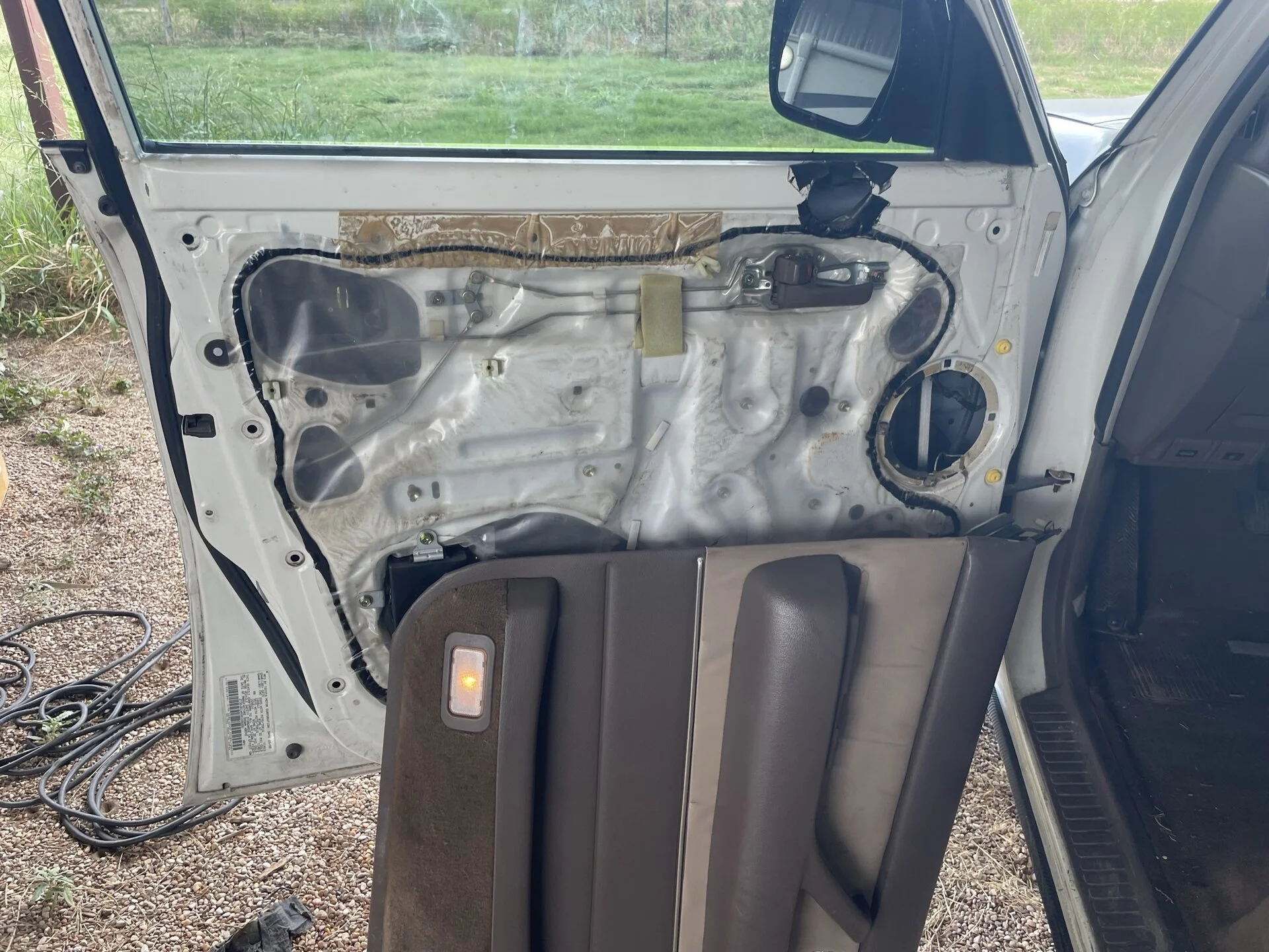

The driver side door panel was loose. A pic above of the door panel can be seen though not that it was loose. At any rate I removed the door panel and tightened a few of the screws on the reinforced paper door panel and then ultimately just had to drill through the inside door pull as the bolt hole had broken off. It is most unsightly, but now the door panel does not rattle and there is little chance of pulling the panel off even more. The door pull will need to be replaced and I am toying with just replacing both door panels, but that seems a little excessive and they are more or less in good shape.

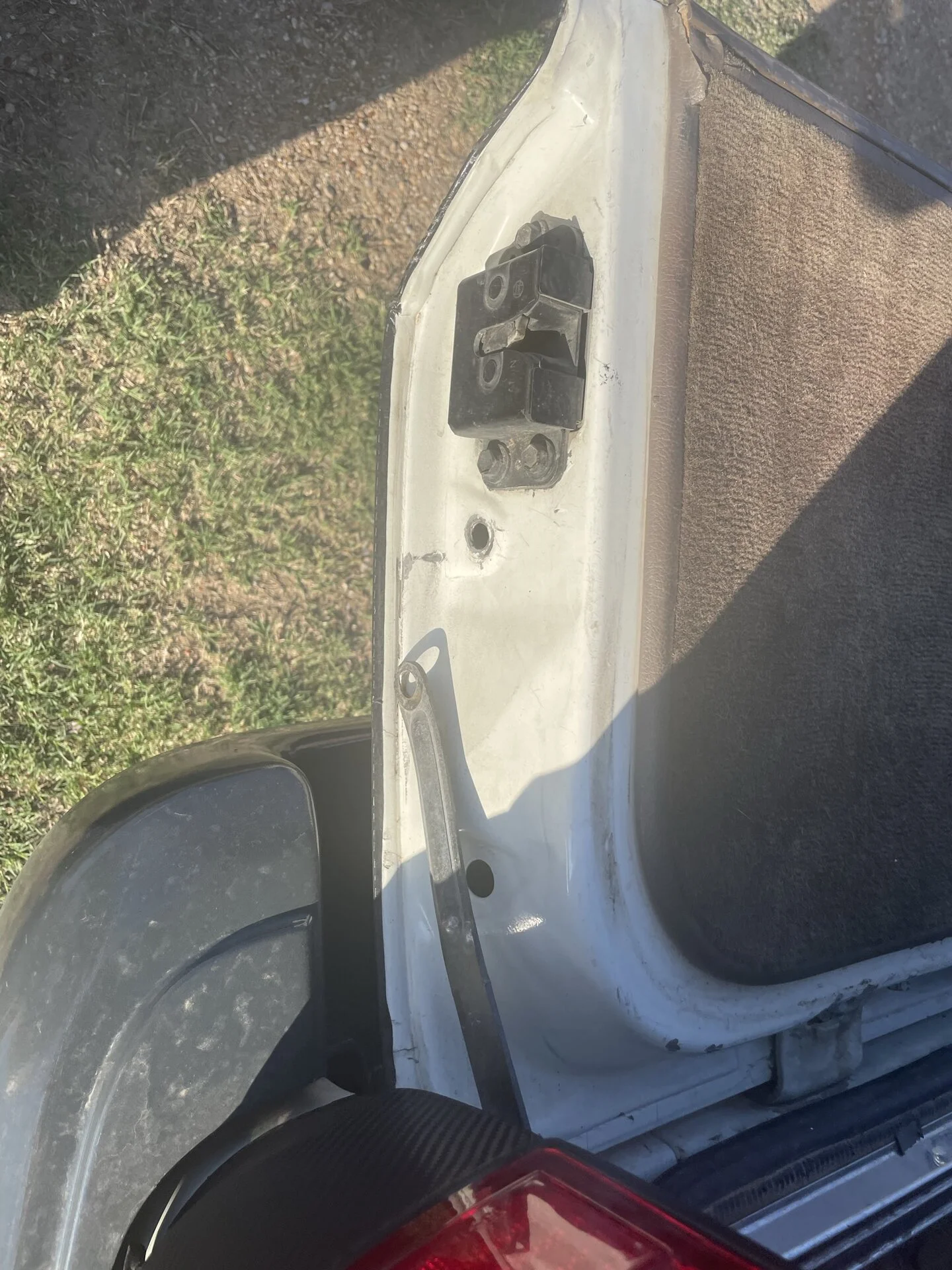

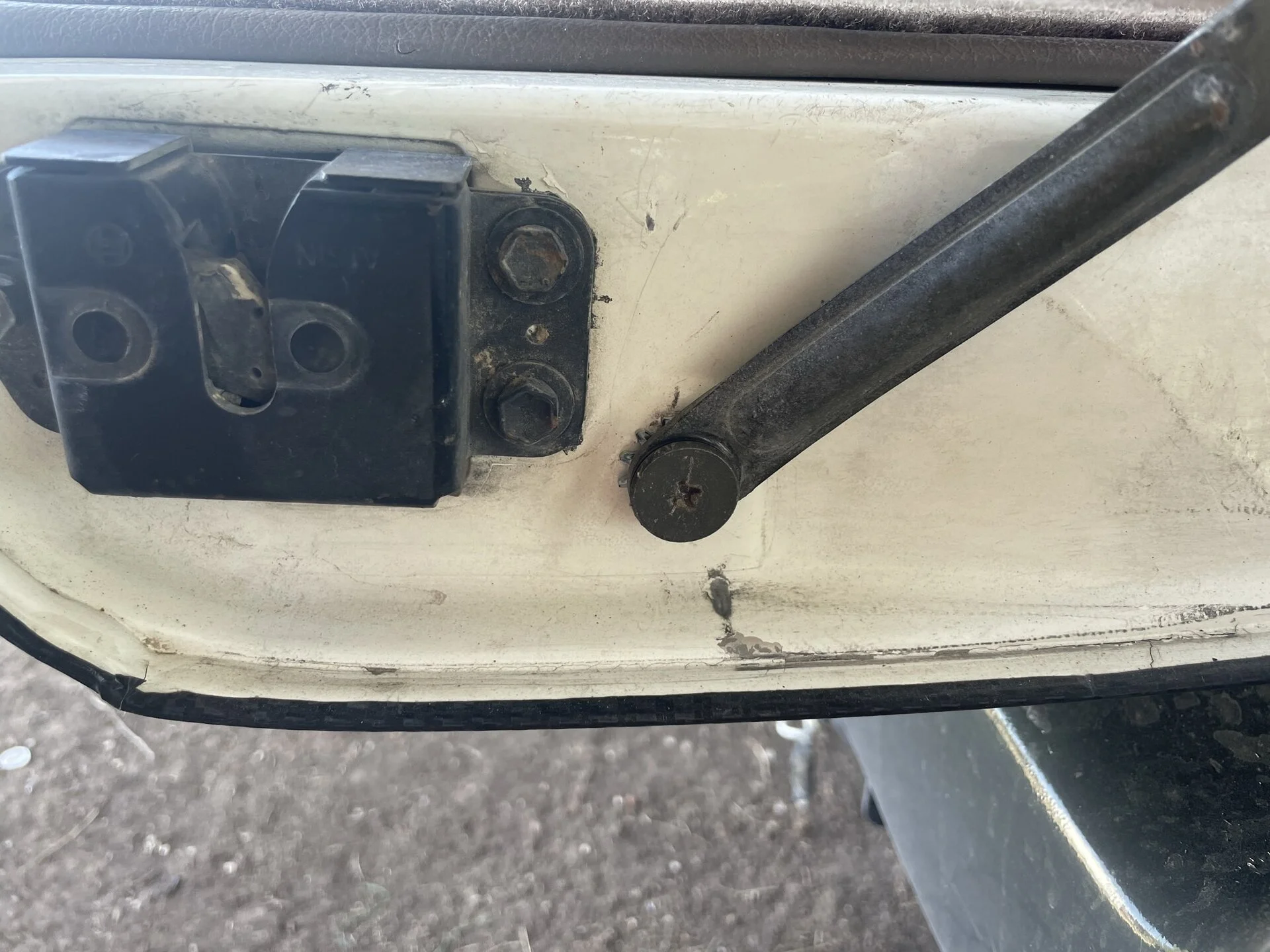

Finally the passenger side lift gate bolt had been stripped out.
So I installed a rivnut and put the plastic washers and original bolt back in place.
Along with that I shampooed the carpets, conditioned the leather and stripped some aftermarket wood grain decals off the dash. The decals are definitely not as nice as the original and the original are a little suspect in my opinion. I will likely stay with the black under trim for now.

Apparently there is some clear coat break down on one of the side panels. The drive side seat is in pretty good shape, the passenger is in terrible shape and will need reupholstered.

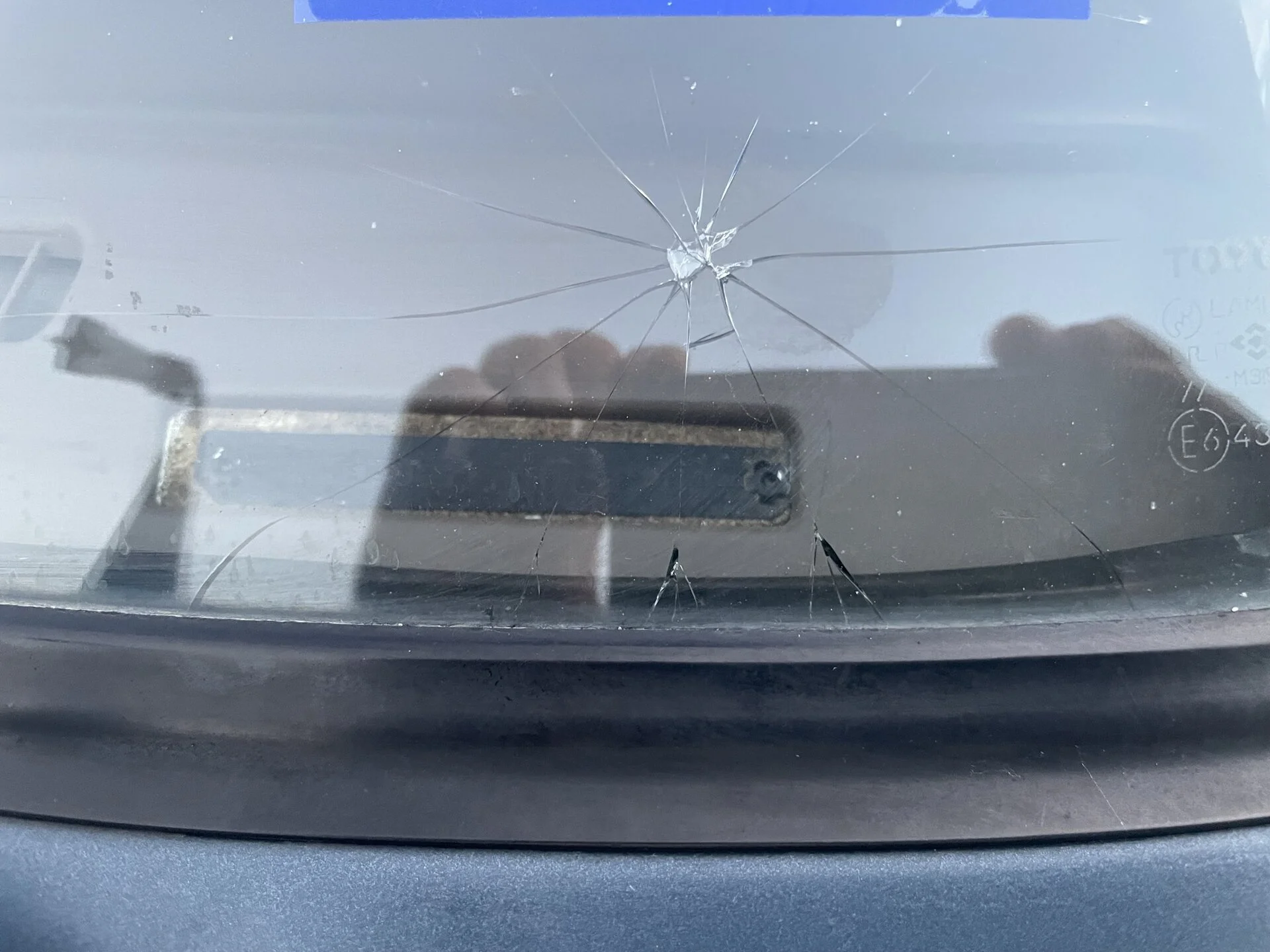

So I broke the front windshield last night. I was replacing the wipers and pulled too hard and the wiper gave and my elbow hit the windshield and well here you go:
I mean there were a couple chips in the glass already so I had planned to eventually replace it, but this may move the timeline up a bit if I decide to drive it around. In related news my elbow hurts today.
