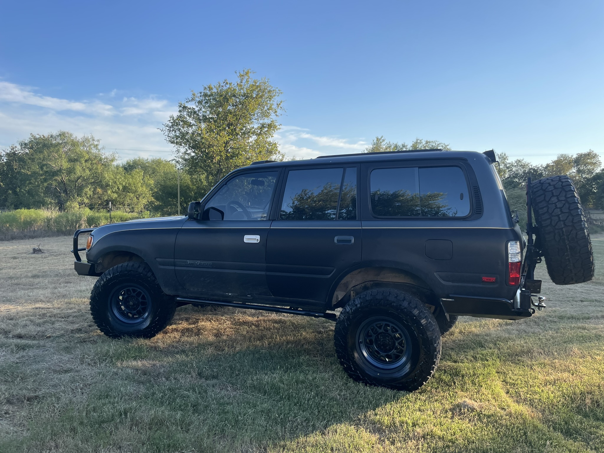

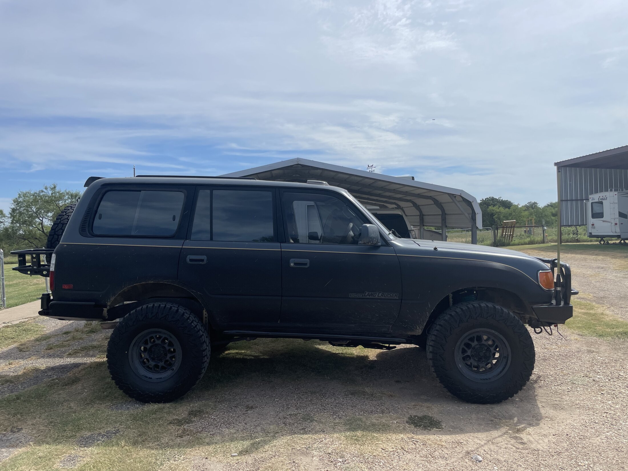

The new suspension has been installed!! I ordered the Dobinson MRA shocks with the dual rate coils front and back. I have been working with the local distributor and they have been fantastic. I ended up ordering a Dobinson adjustable front panhard and a 3" panhard lift in the rear from DVS. I also got front and rear swaybar drop brackets and ended up going with durostop bump stops. I also went with the 3" radius arms from DVS for front castor correction. We did need longer brake lines as well. I grabbed it so I could work on it a little this weekend and my tires came in as well so I went to Discount Tire this morning to get those installed. I will need to take it back next week some time for front brake installation (I did not want to mess with the hubs) and final inspection and alignment. The back is definitely higher than the front and although I do want a little rake, I don't want quite this much. They will need to see if an inch or two of spacer in the front will level things out a bit. We also need to see if I will need limiting straps of some kind with the flex it has now. I had originally ordered air bags but there was just too much lift so we ended up holding off and we can always add them later. I ended up going with the new Falken Wildpeak R/T's. I wanted something more durable the A/T for off-road but not as loud as a mud tire. Here are some pix of the new lift and new tires.

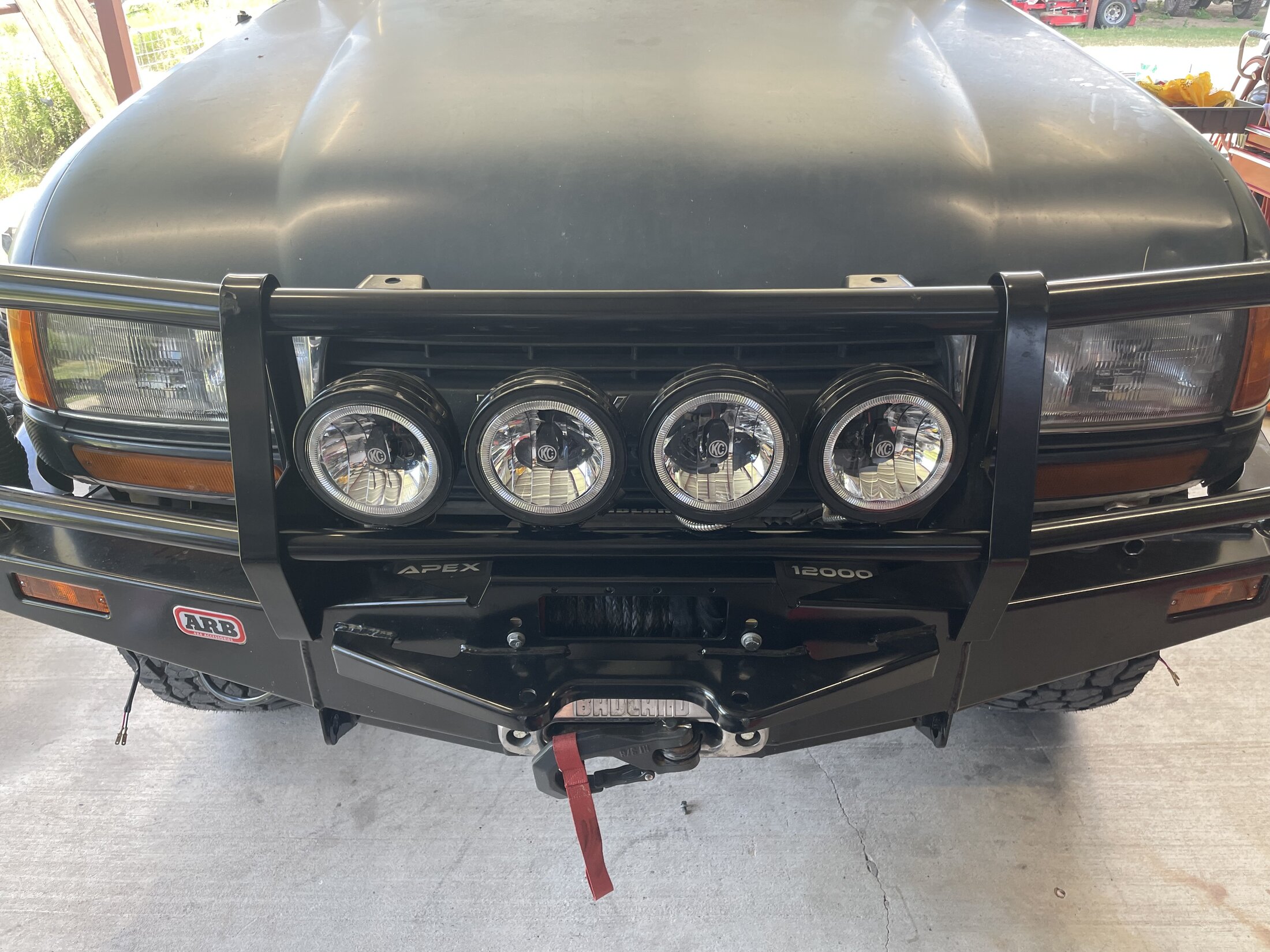

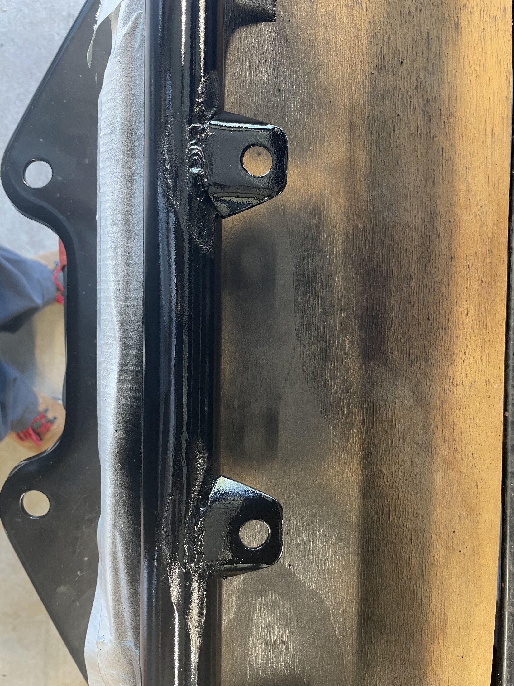

With the suspension getting wrapped up I also had some opportunities to wrap up a couple other little projects. I had relocated my ARB compressor and had to run new lines. The old lines were not long enough so I had to buy a new line and used the rear line from before on the front and the new longer line on the rear. Made sure to zip tie loosely and give plenty of slack for axle travel. Once that was dialed in we welded two new light tabs to the ARB bumper so I had room for all 4 KC lights. The outer two are wide beam, the inner two are spot light. I was also able to drop a fuse tap for my ACC bus bar that powers my inside usb-c chargers. I also went ahead and wired up a Blue Sea fused circuit block to ACC switched relay on a 150a manual fuse as I mentioned I might do in a previous post. I have some hydraulic large gauge wire crimpers which come in handy for those kinds of jobs. I also finished up the washer fluid relocation project by splicing in longer wire for the electrical harness and cutting off excess rubber tubing for the washer fluid.
