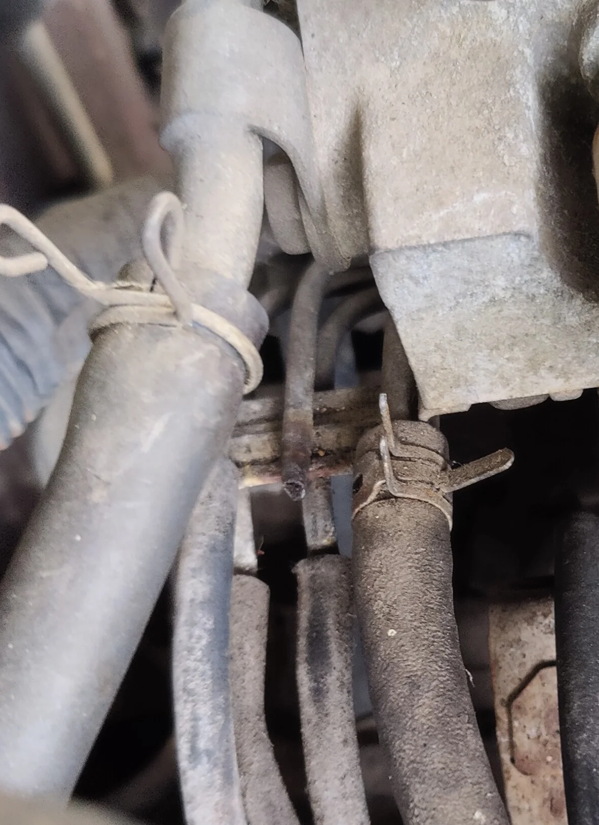

I while I was putting the intake back together, I found a broken vacuum line that I can barely get the hose to stay on. If anyone has any ideas on fixing it, I'm open to suggestions. I may just cut it loose from the bracket that holds it, so I can push the hose on further.

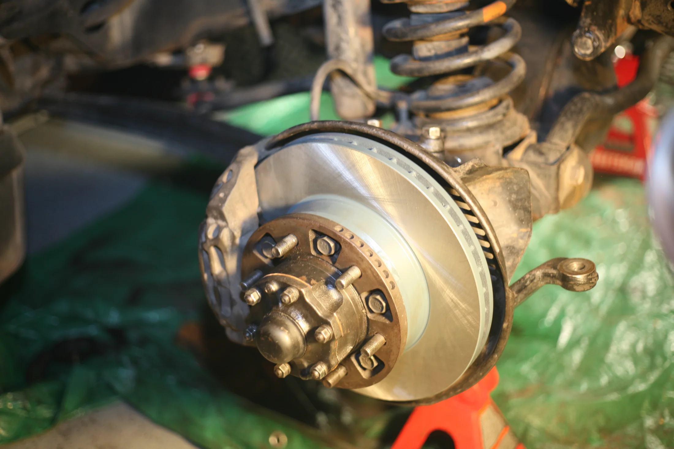

I started rebuilding my knuckles and realized I was not fully prepared. After making several trips to the Toyota Dealership, Harbor Freight, Napa, and Tractor Supply, I have the passenger's side knuckle torn down and I replaced the axle seal and top and bottom bearing races. I am waiting on tie rod ends and brake pads/rotors before I continue with the other side. The front diff was filled with forbidden pudding instead of gear oil. A lot of surprises, but I'm hoping to have it all put back together this weekend.
Finally got everything put back together Monday night. I kinda lost motivation when waiting for parts and powered through this weekend.
When taking the passenger's side apart, I noticed that one of the studs on the hub had been replaced by a bolt, so I ordered a couple of the correct studs from the Toyota Dealership on the south side of Indy. I also got some crush washers for the differential, since I am going to change the fluid after 500-1000 miles until the Birf pudding is out of gear oil. They charged me twice the MSRP for everything, so I ordered things online the next time I ended up needing things. I got brakes and tie rod ends from Napa. The Altrom tie rod ends were 555 brand, so that worked out well. They didn't have the drag link ends, so I ended up getting Suspensia brand from Rock Auto, which we will see how those hold up. The steering damper probably should have been replaced as well, but I had already bought more than I expected to and I decided to do that later. The tie rod ends were very seized. I applied PB Blaster and let them soak overnight a couple times. Finally, I bought an 18 inch pipe wrench, dowsed them in WD40 and they broke loose. Once I got the tie rods replaced, I continued rebuilding the front axle and I ended up breaking one of the 10mm on the back of the knuckle. I ended up buying those for Ourisman Toyota in Richmond, since I needed to order some parts for my FR-S and Toyota Direct doesn't ship Subaru parts. I bought a screw extraction kit from Menards and broke the drill bit trying to drill the bolt out. I took everything that I had put back together apart again, so I could drill at a better angle and got some titanium coated bits. I had better luck with those. I got the broken screw out and decided not to use my cordless ratchet on smaller bolts. Once the order from Ourisman came in, I put everything back together and started on the driver's side. Friday night, I got everything tore down to the knuckle. Everything was dirtier, caked in mud, and someone had used rtv sealant on the hub assembly, but everything went smoother because I knew what I was doing. I worked on cleaning everything and getting the new races installed on Saturday. Sunday, I got everything but the brakes put back together. Monday I finished up the brakes and cleaned the inside of the wheels and put those back on. I took it on a shakedown run to the carwash a mile or so from my house and got the grease off of the fenders and wherever else I had touched while working on it.

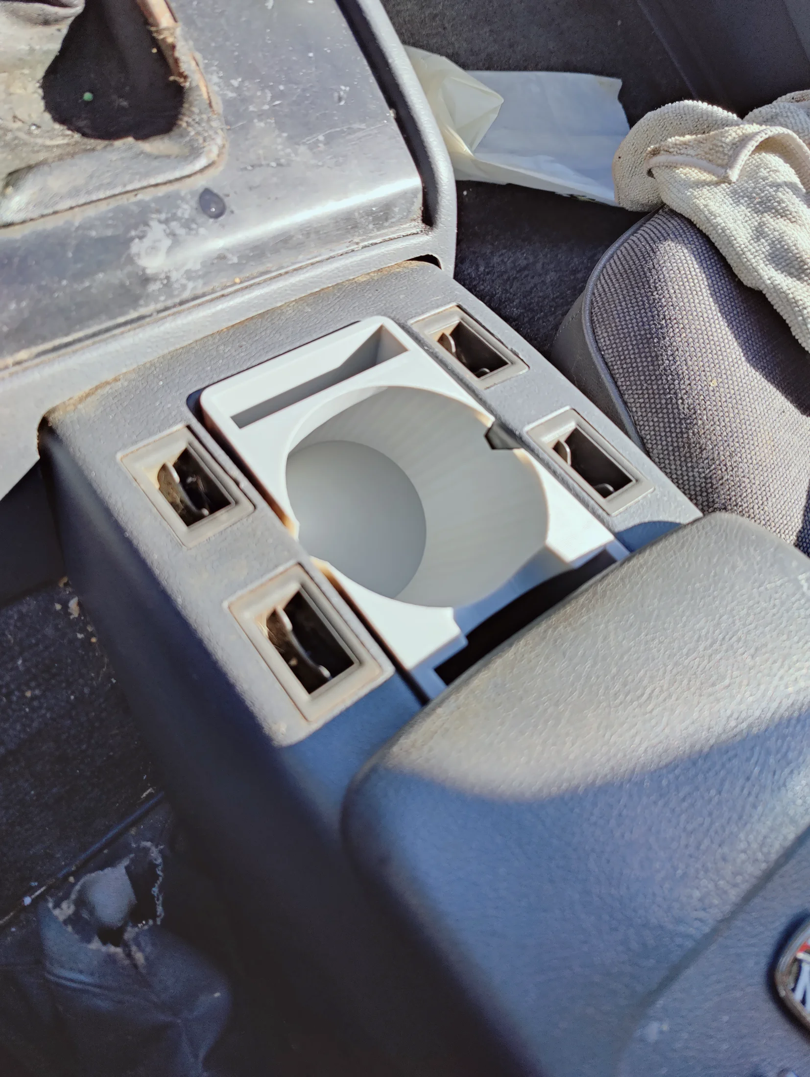

I also forgot to mention that I printed a new cupholder.
