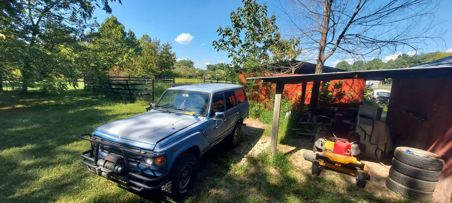

Today I decided to try and keep my roof from getting any rustier, while trying to keep the patina look that so many people have told me is this rig's best quality lol.
What do you guys think?
Looks way better than rust! I have always liked the white roof color body type of thing.
We have the same roof though mine hasn't gotten too rusty yet...just all the brown paint cooked off an some of the primer. I've just had it parked out of the elements. But considering just getting some epoxy cans in the correct color and trying that..along with redoing the seam seals

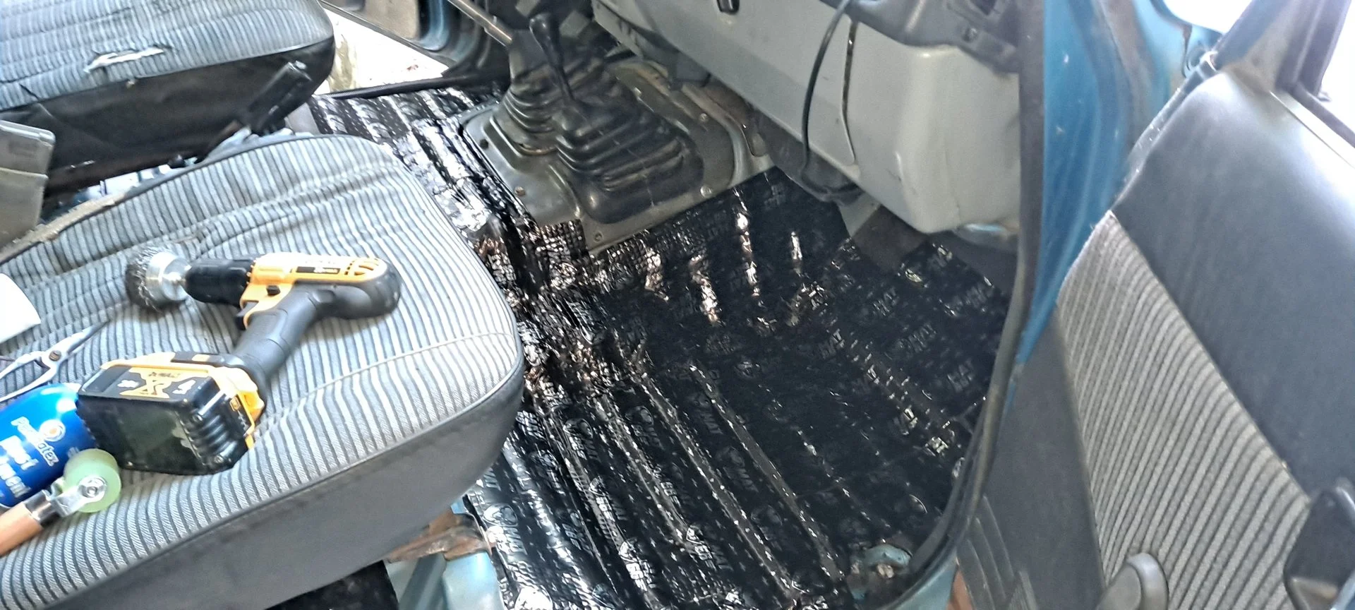

The last few days I've worked on cleaning and rust repair/treatment in the few little crusty spots I had. Yesterday and today I installed my sound deadening mat and ordered my carpet kit.

Which sound mat did you go with?

The mat I got is from Noico, called Mat 66. Got a whole bunch of it cheap on Amazon.
It definitely tames the noise down a lot! I was amazed with how smooth and quiet the 2F was, but the Cummins is pretty loud, with an open 3" exhaust on top of all the other turbo diesel noises, and 33" mud tires. I needed to do a little extra to keep it bearable for long trips, especially if my wife wanted to ride along.
