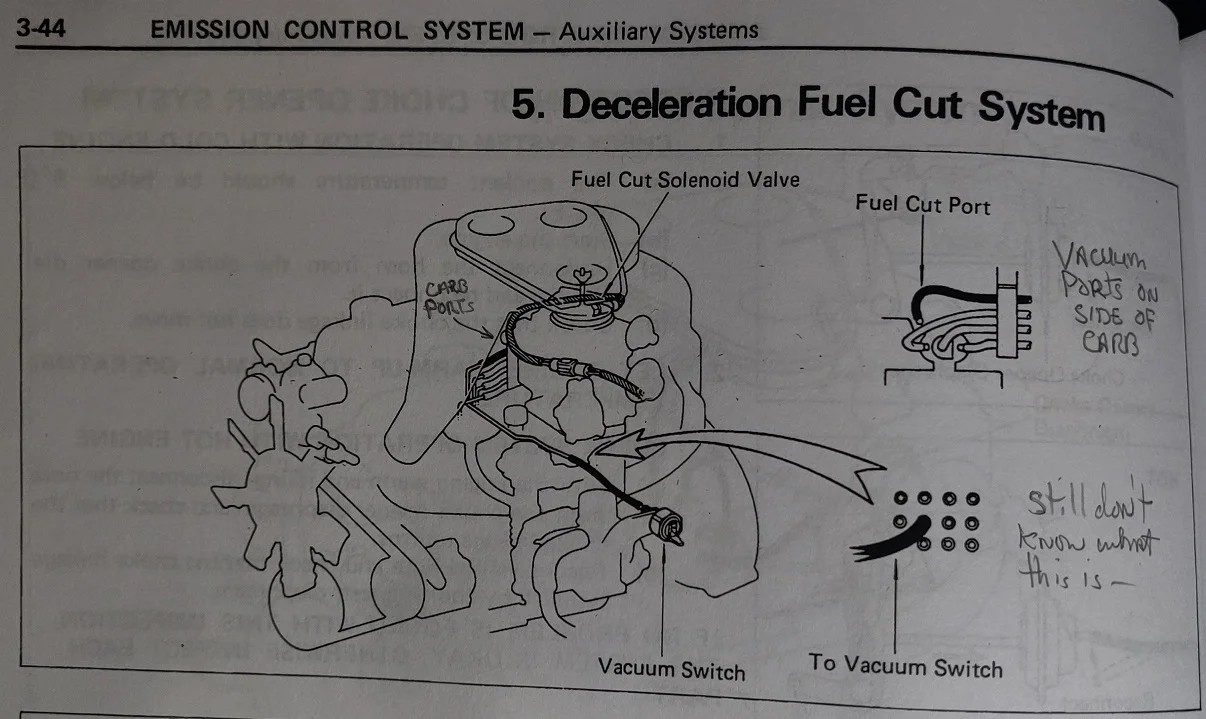

I don’t have the CR carb but some folks have had issues with the fuel cut/decel solenoid/vacuum switch system on installation of the Fuji carb (which CruiserTrash asked about).
Not sure if that would be full explanation though for what you have. I don’t know why some folks seem to have issues and others don’t - at least from my limited knowledge.
Did you plug that hose you circled in red?

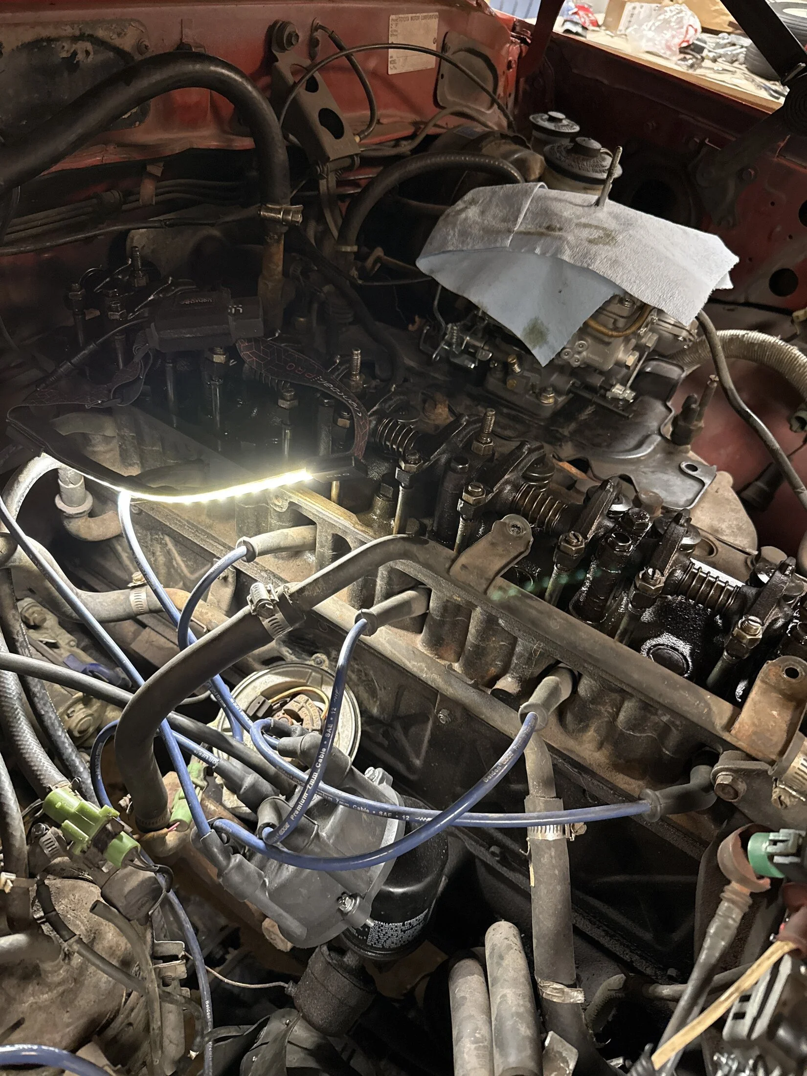

I finally had some time this evening and adjusted the valves, pained the timing marks, and added the vacuum advance I got from @4Cruisers, thanks man! The valves were all tight and out of spec. When replacing the vacuum advance the advance springs/rotor was pretty rust and barely moved. After cleaning everything up the advance was moving freely. I’m sure that’s been an issue with the truck. Buttoned everything up and the engine fired right up and didn’t die. Normally I have to run it on choke for a mins for it to idle and not die. The timing is set at 7* BTDC. I did not adjust timing this evening, ran out of time. At idle in the shop, it still stumbles in the low rpm’s. I was hoping everything I did made a difference, nope.
I truly think it’s the city racer carb.
My plan is to send my OG carb in and have it rebuilt. As I have said before, it ran way better with the worn out original carb. I did get a new toyota fuel pump and spacer and will replace that tomorrow. What are folks advancing their timing to, desmogged at 265ft? I have headers as well not sure if that makes a difference…

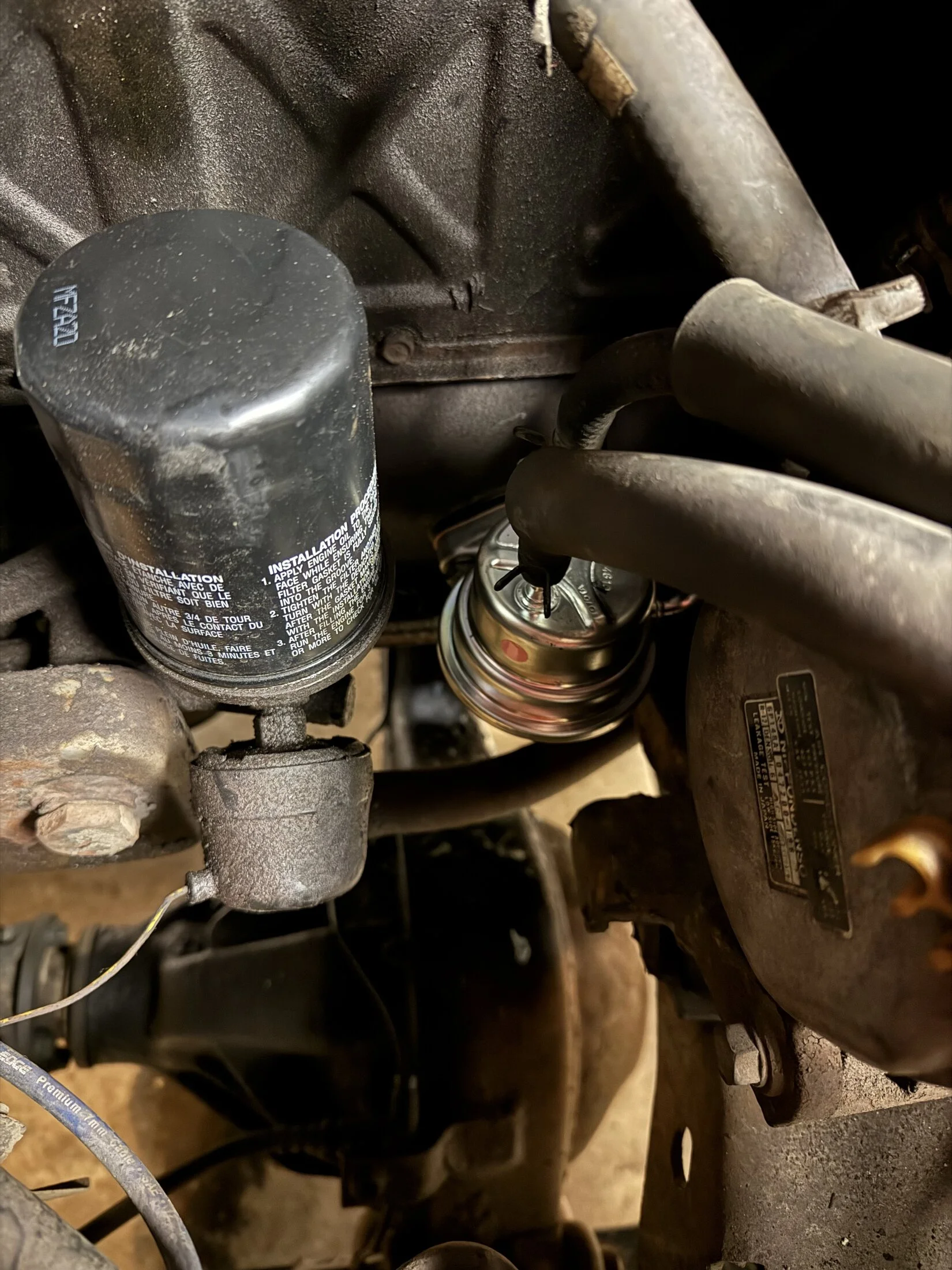

I decided to drive it before I changed the fuel pump. Seems like there’s less power…did adjusting the valves do that, they were very tight? And how can I tell if the vacuum advance is actually opening up? It seems like I need to run the rpm’s higher in between shifts. The carb is still a piece of s***…if let it warm up for 15 minutes, it does run a bit better…thoughts?
Check PCV valve. Does it rattle when shaken? It should. Clogged PCV can cause truck to die when off throttle or after a few minutes of idling.
The PCV does have a rattle, interestingly enough, the other end of the hose is just hanging in the engine bay. Should it be hooked up somewhere else in a desmog?
