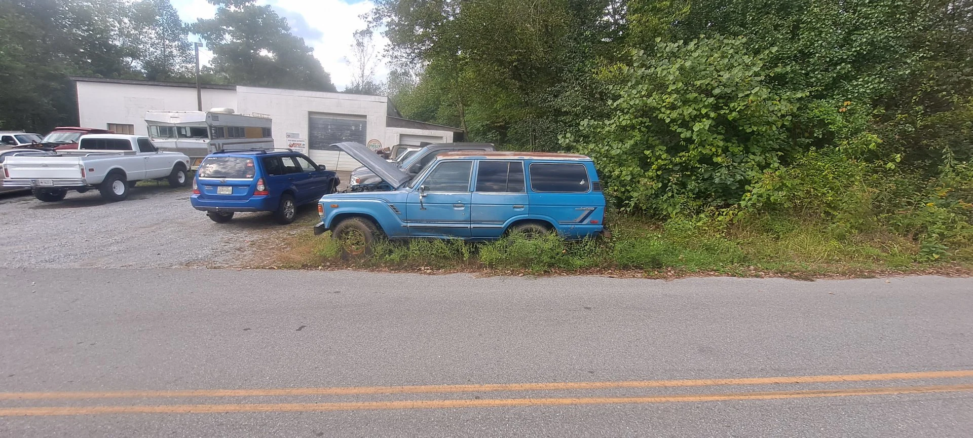

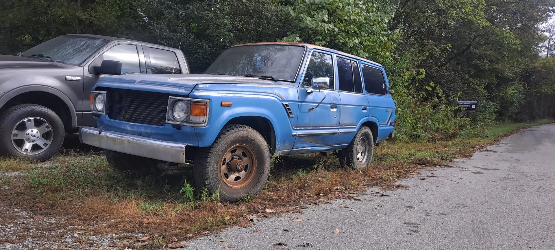

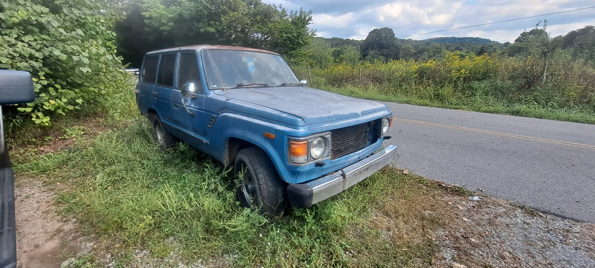

I'm currently trying to acquire my first Land Cruiser as a restoration project, an 84 FJ60 that was brought to my friend's mechanic shop for repairs a couple of years ago, and then the owner went totally MIA, possibly even died. (Was told he was battling cancer). My buddy, the shop owner, says he has been trying to contact the owner and/or his family about the car for over a year, with no success, so now he is working to get a title for the thing.
From what I've been told, the engine is stuck from sitting, and the starter is fried from trying to spin a stuck engine.

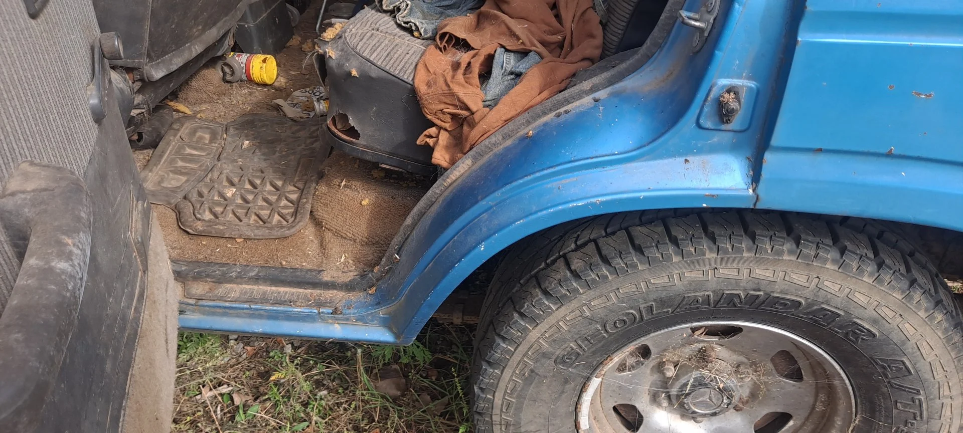

From my own brief inspection, the truck is VERY solid, considering the current "patina" and paint damage. There are no bad rust spots, other than some bubbles at the bottom of the tailgate, the rest is just surface rust that will easily sand off with a DA.

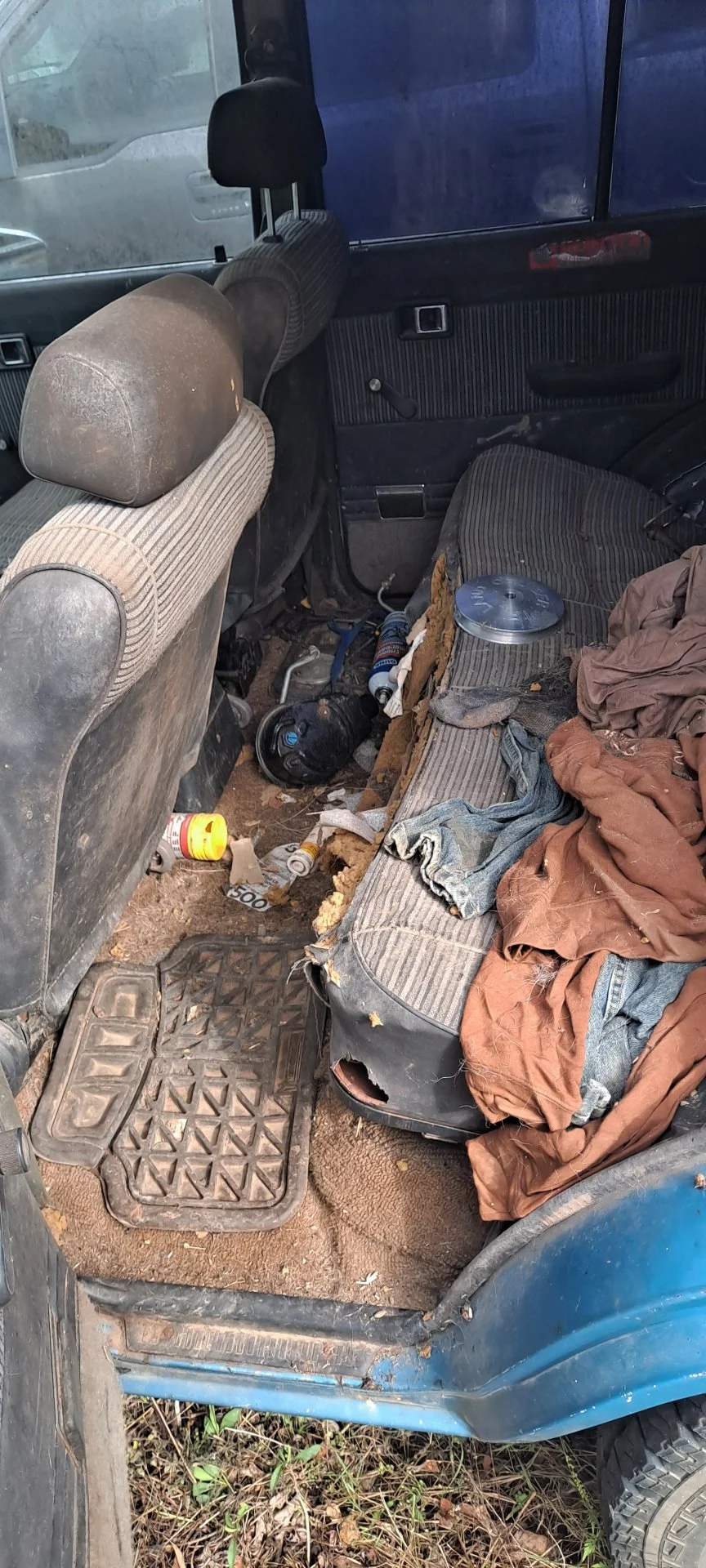

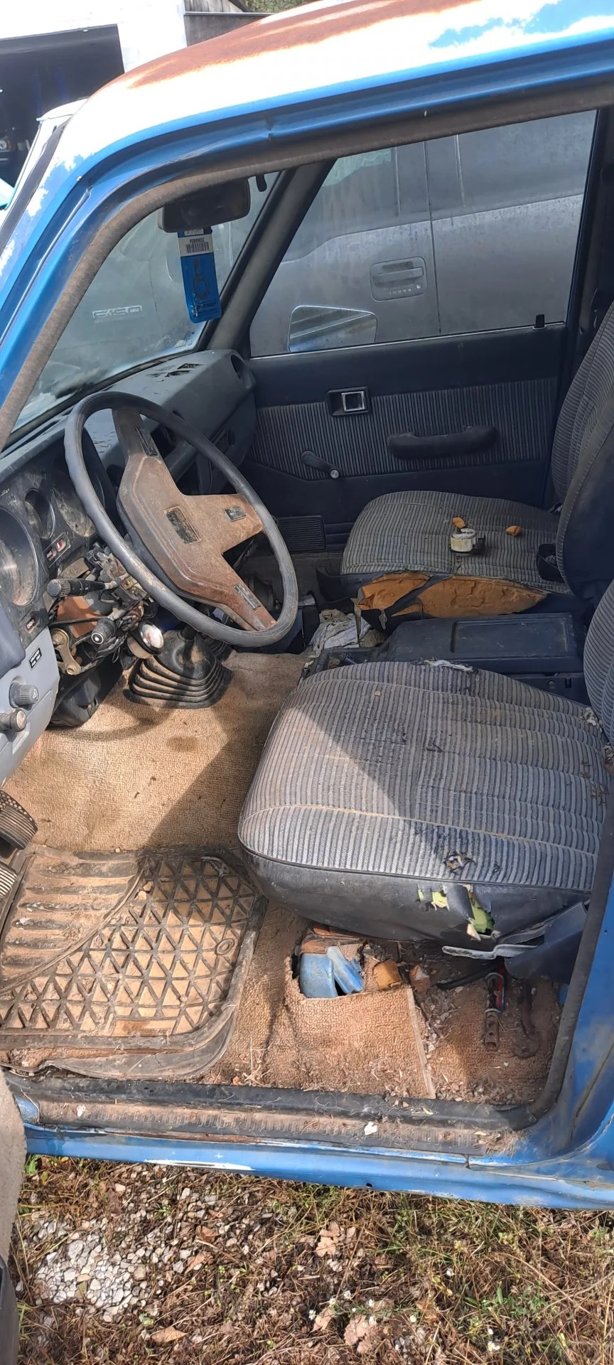

The interior is pretty well screwed, and there is about a 2" layer of raccoon crap in the floor, wall to wall, front to back, but the floors are solid.

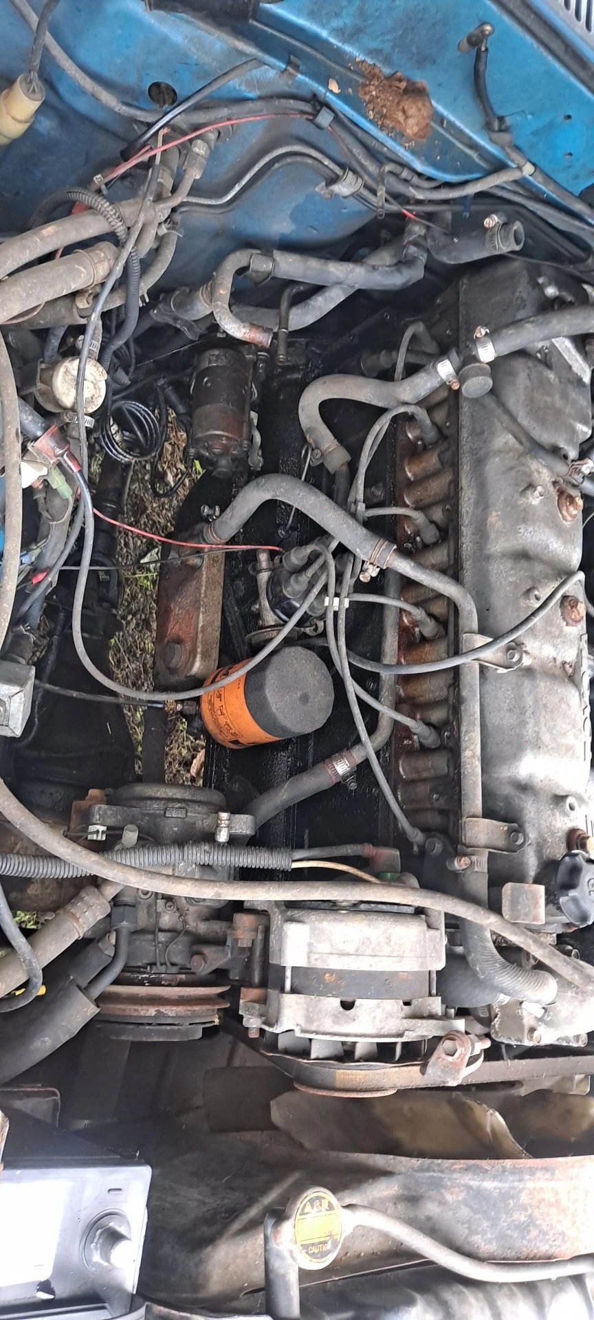

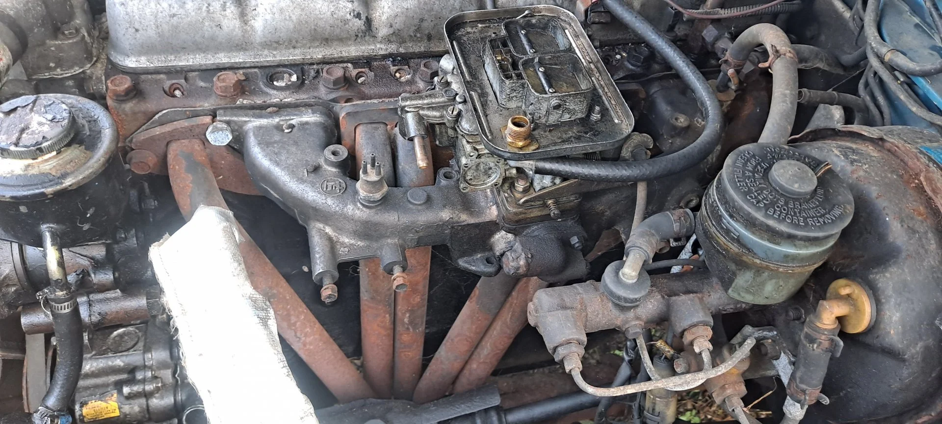

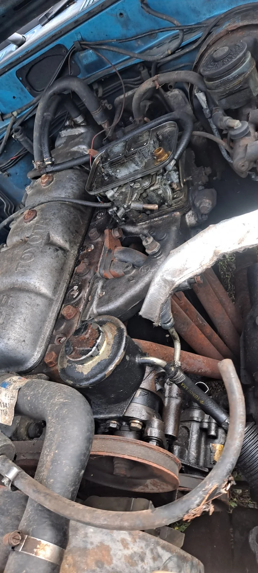

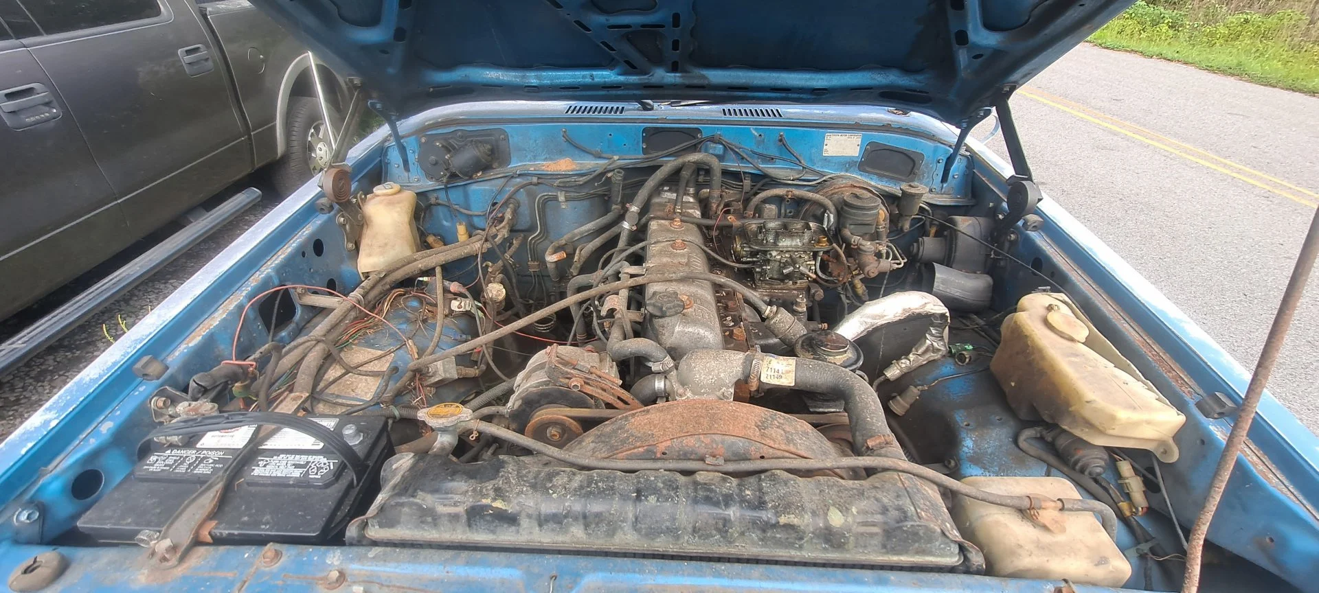

The engine wiring looks hacked up, but there is a weber carb (38/38), some kind of long tube header, what looks like a points distributor and some kind of universal ignition coil, and a Facet fuel pump bolted to the inner fender.
I'm guessing that the last time this thing ran, it wasn't very good. The odometer shows over 388k miles.
The 4 speed feels like it shifts solid and clean, as does the transfer case, but the clutch has no pressure and goes straight to the floor. The brakes seem to work.
Headliner actually isn't too bad, and the windows roll up and down, all doors and tailgate open and close solidly without any drama.
I can get this Cruiser for $1000 cash, or he seemed interested in trading for my old rusty Jeep XJ with some upgrades, but needs an engine swap. I'd also give him a good engine for it.
I've wanted an FJ60 for a very long time, but as you know, the prices have gotten a little out of hand for anything that doesn't need a ton of work. This one needs work, but at least it isn't rusty. I am a mechanic, but not a body guy.

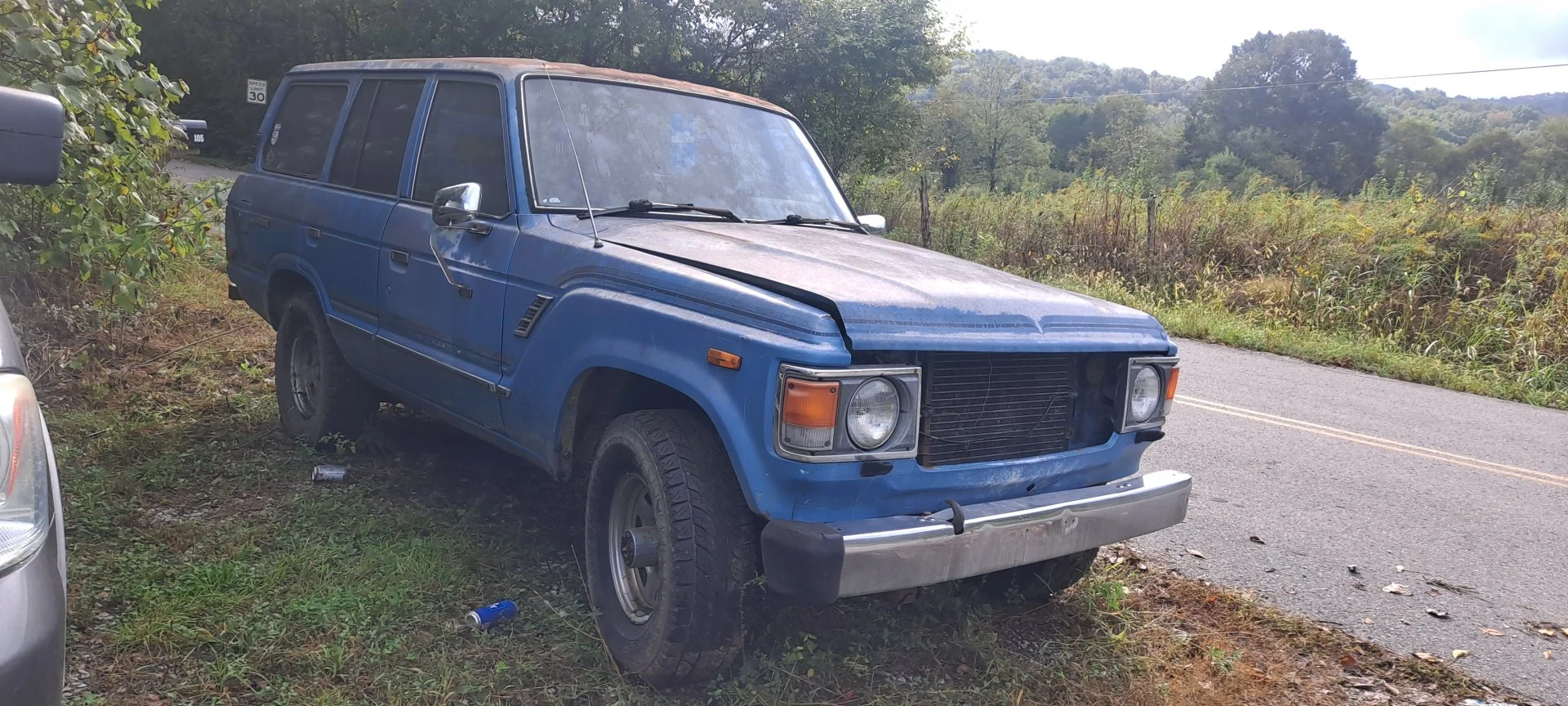

I stopped in and took a few more photos of this ride, and got some updates on the title process.

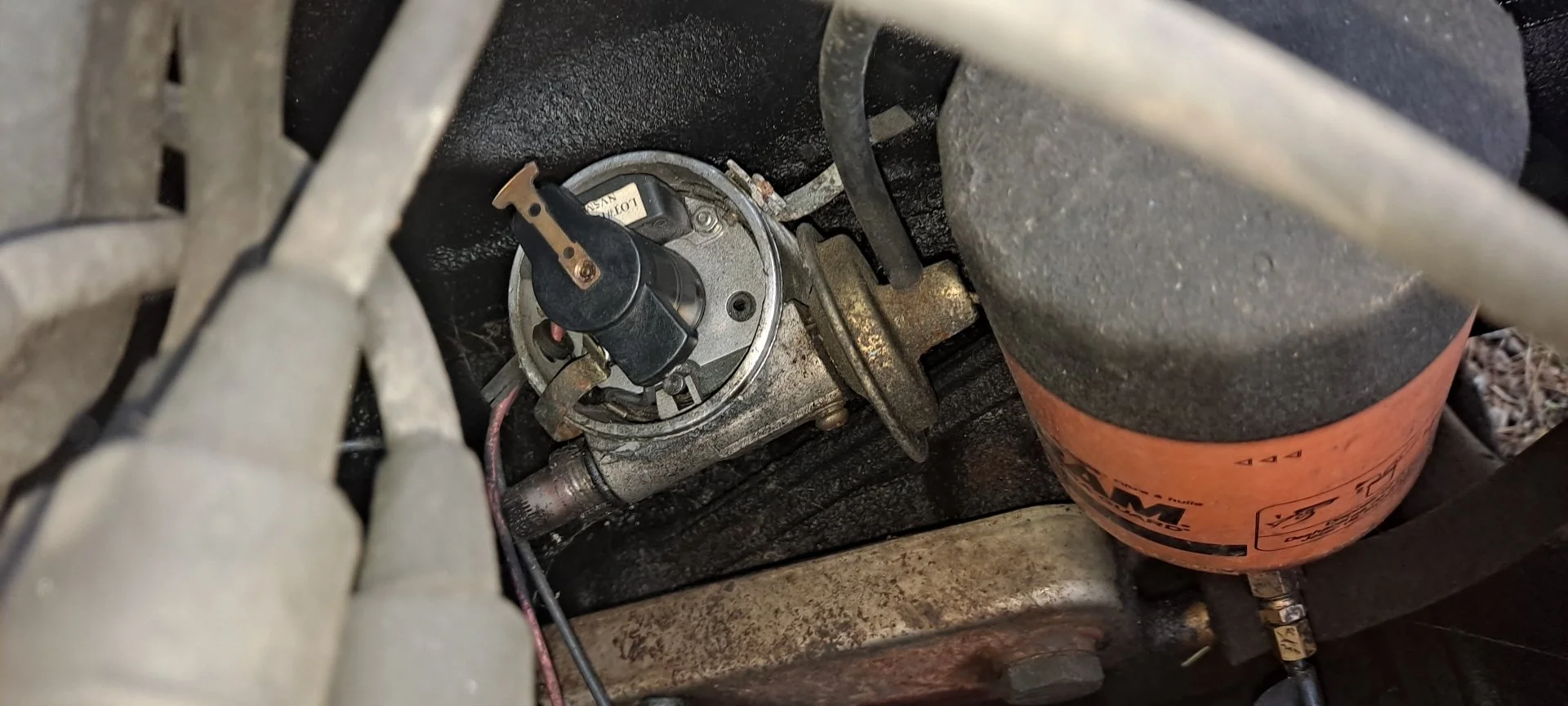

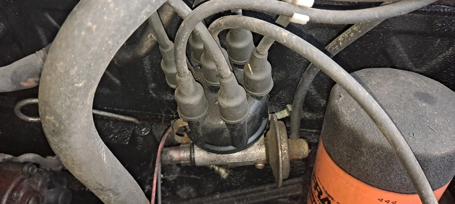

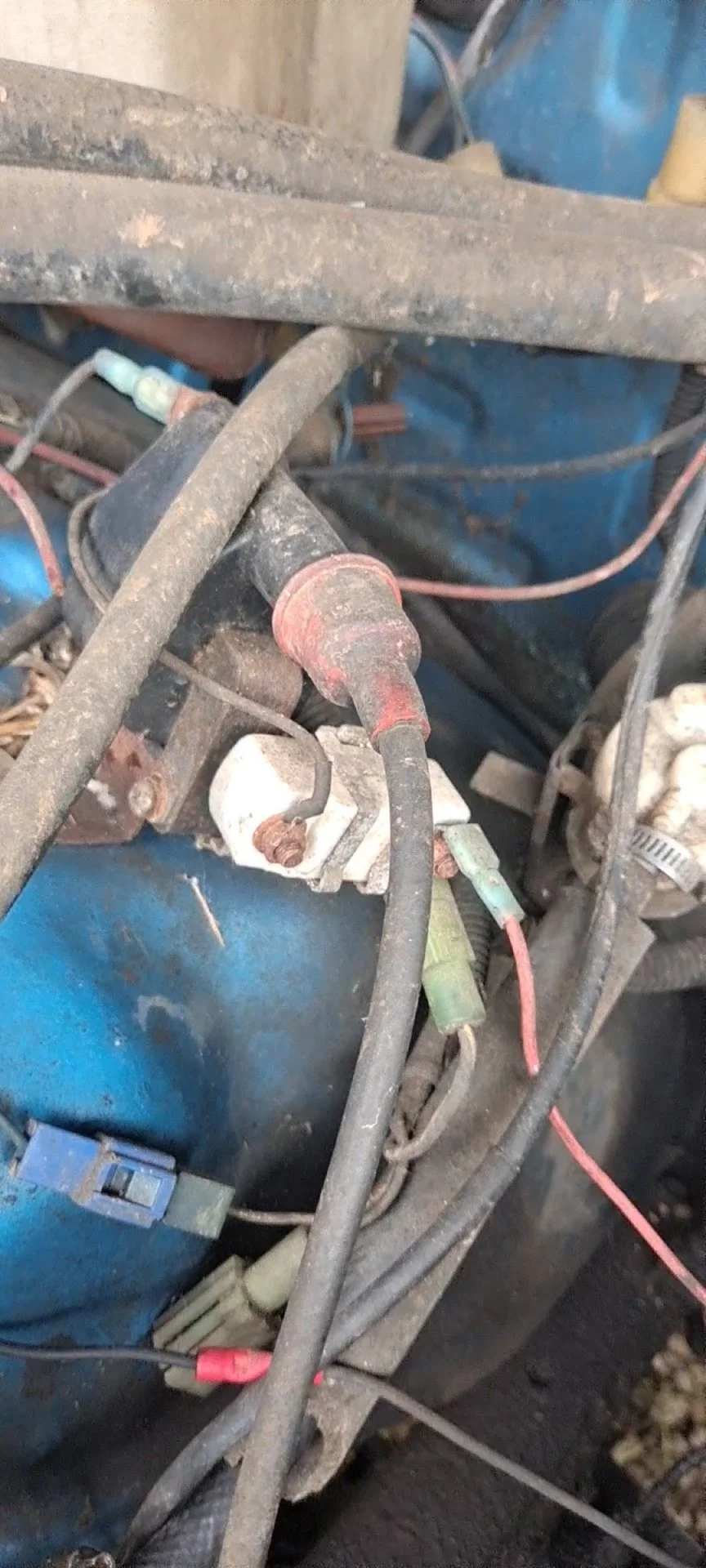

Some things of interest are the distributor, coil, and resistor/ignitor deal on top, as well as the pickup in the actual distributor. I have a strong feeling that I'll have to get creative with a way to make sparks happen if this junk doesn't work.

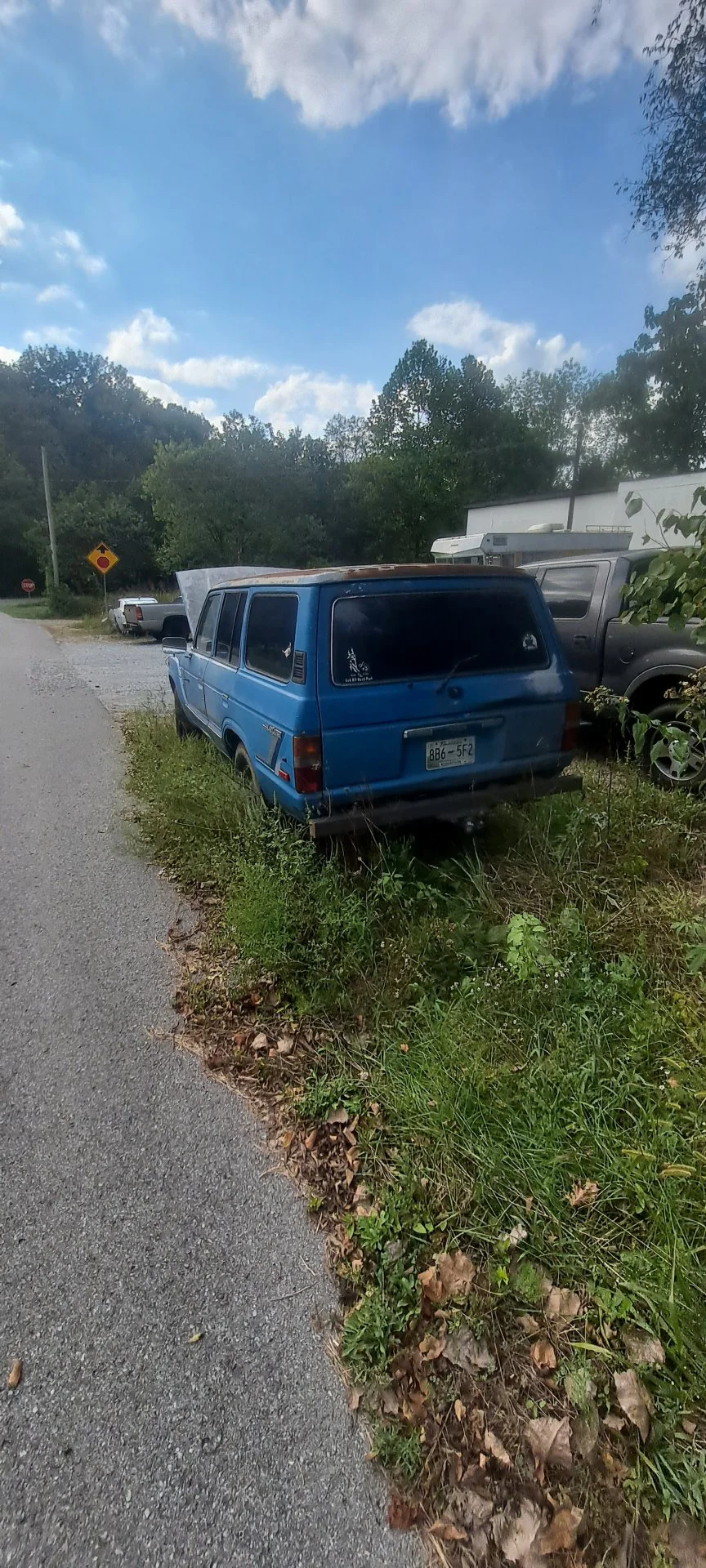

Also I looked harder into the rust situation, and again, I'm quote happy to see that this sucker is SOLID. Even in all the most common places to find rust, I'm not finding any, other than a couple of small blisters on the bottom of the tailgate.
Anyway, here are the latest photos. My buddy even broke out the weed whacker so it doesn't look quite as abandoned lol.

That ignition system should probably be replaced with stock parts. That’s probably the first thing I would do. No telling where all that stuff came from and what condition it’s in. If you can get spark with it and get the engine to fire that’s a good sign but I would try to get that stuff out of there. That Weber carb needs some attention. Since you’re not smogged you could get a non USA carb from cityracer.com and you’ll be running a factory style carb. There’s a debate about which is better. Webber seems to handle inclines better than the stock, but the stock is a solid unit and works well with the F engines.
