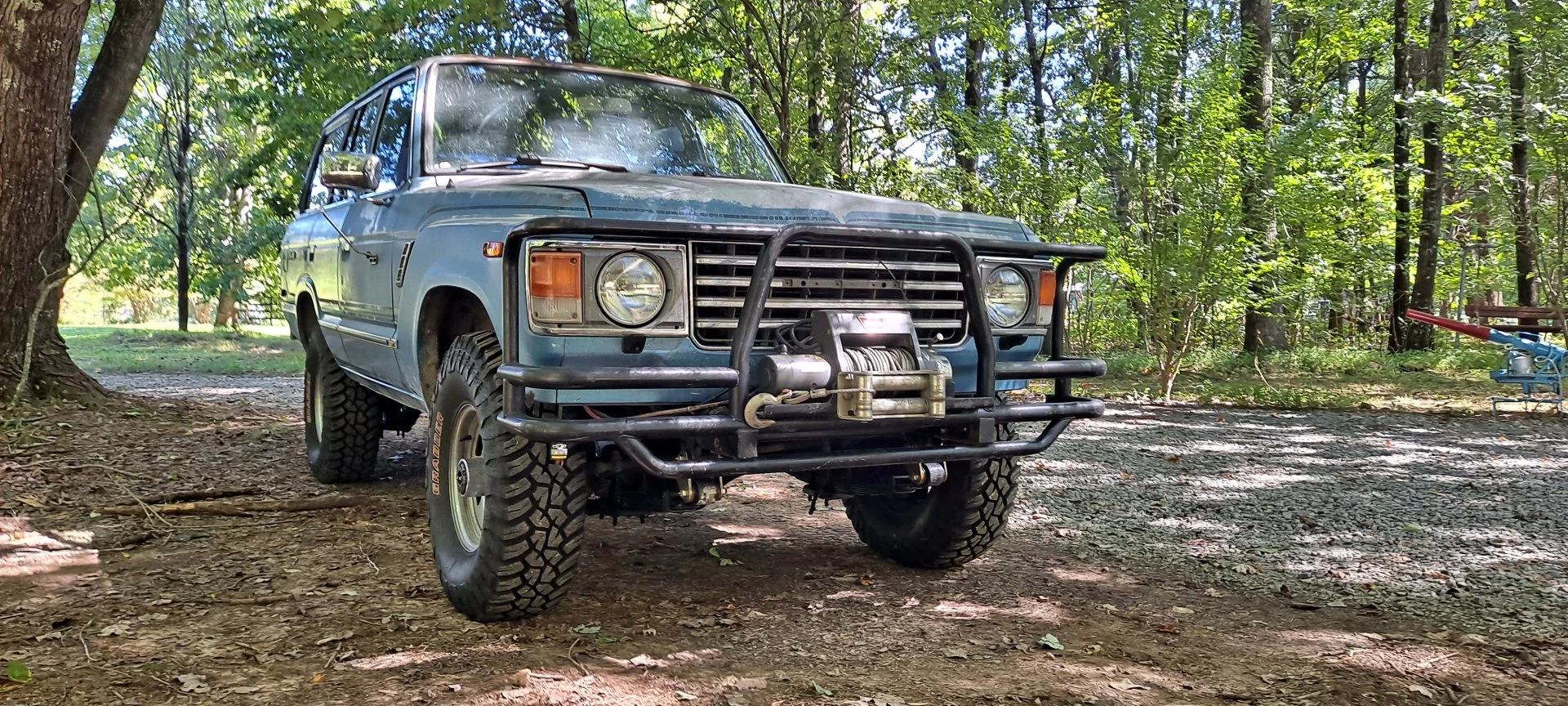

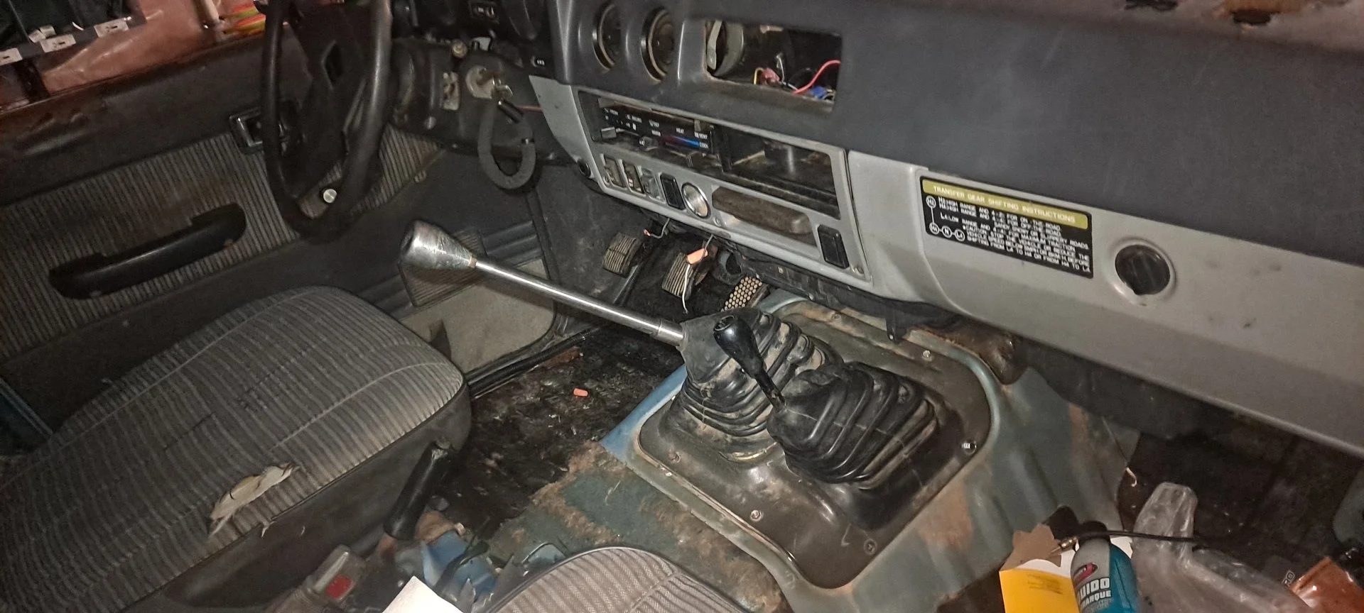

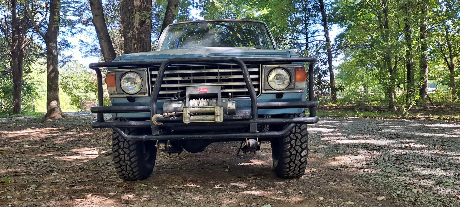

Last night at work I modified my shifter plate to fit with the new positions of the shifters, and got it bolted back in with the original shifter boots, which quieted down a ton of the engine and road noise, and I removed the front bumper and brackets in preparation for the big home made tube bumper I have. I also stuck the grille and headlight bezels on after replacing the headlight bulbs. It's getting a little better every day.
