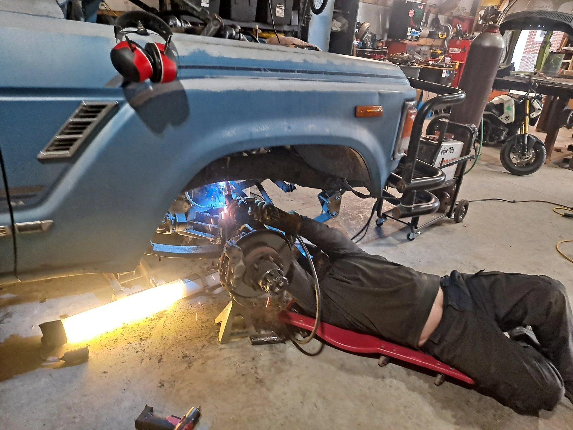

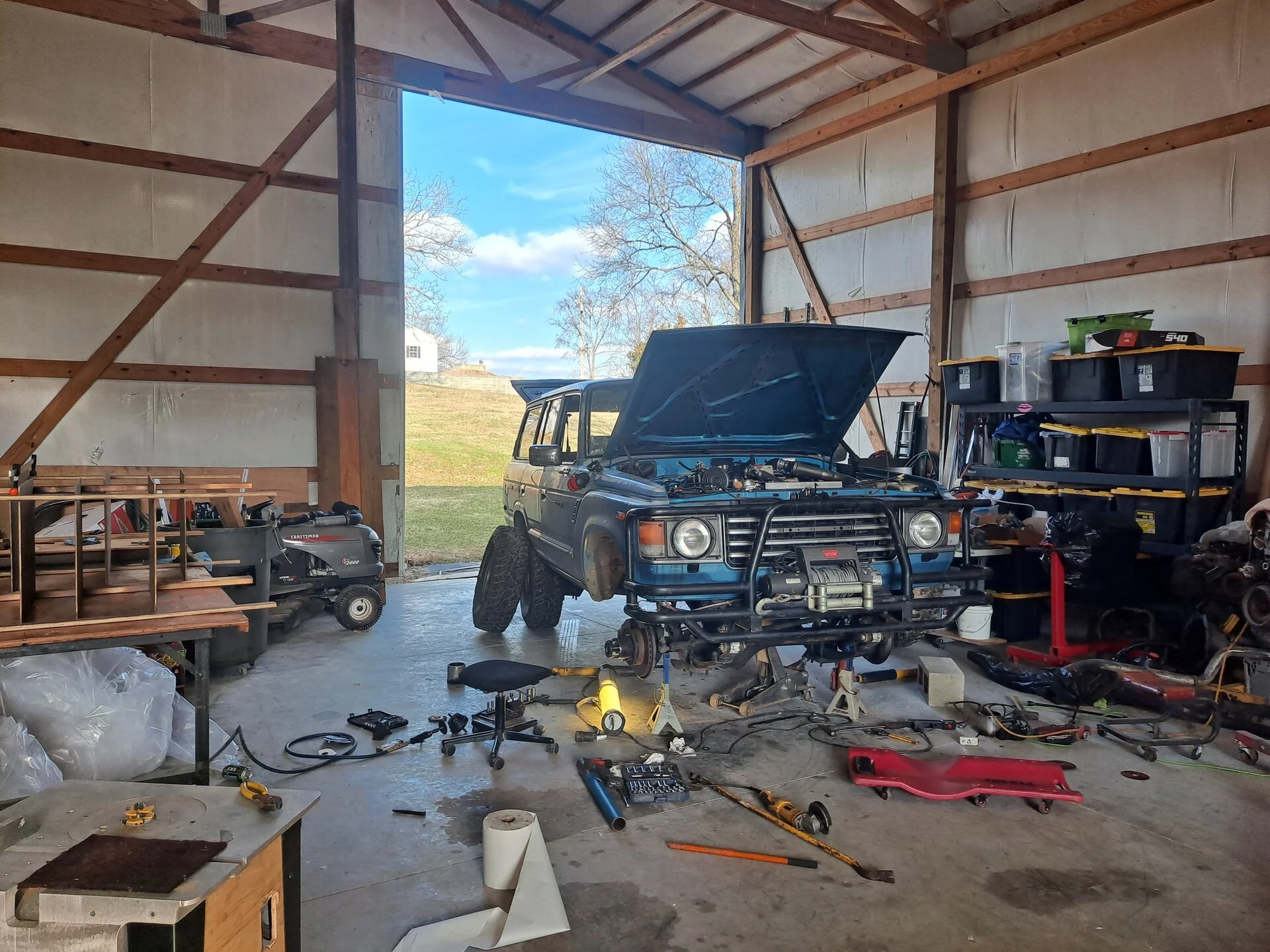

Today I went over to another shadetree buddy's house, and we cut off my motor mount brackets and raised them up about 4" from where they were. I now have plenty of axle uptravel clearance, but I'll have to modify my ac compressor mount to lower the compressor a bit when I'm ready to finish the hvac system.
Most importantly, I don't bottom out or hit my oil pan on big bumps in the road or when flexed out anymore. That is worth some extra engineering in the AC department later on, I think. This has been the thing holding me back from a lot of things I could have finished up on the truck, but I was afraid I was going to have to spend some real money on an SOA and cut/turn or at the very least, a shackle reversal. Now not only can I daily drive the thing without worry, but all that money I was planning to spend on the suspension can go towards making the thing nicer, and I can start traveling and camping in this rig instead of beating up my Subaru all the time. Today was a huge win for the old Trash Panda Hotel.

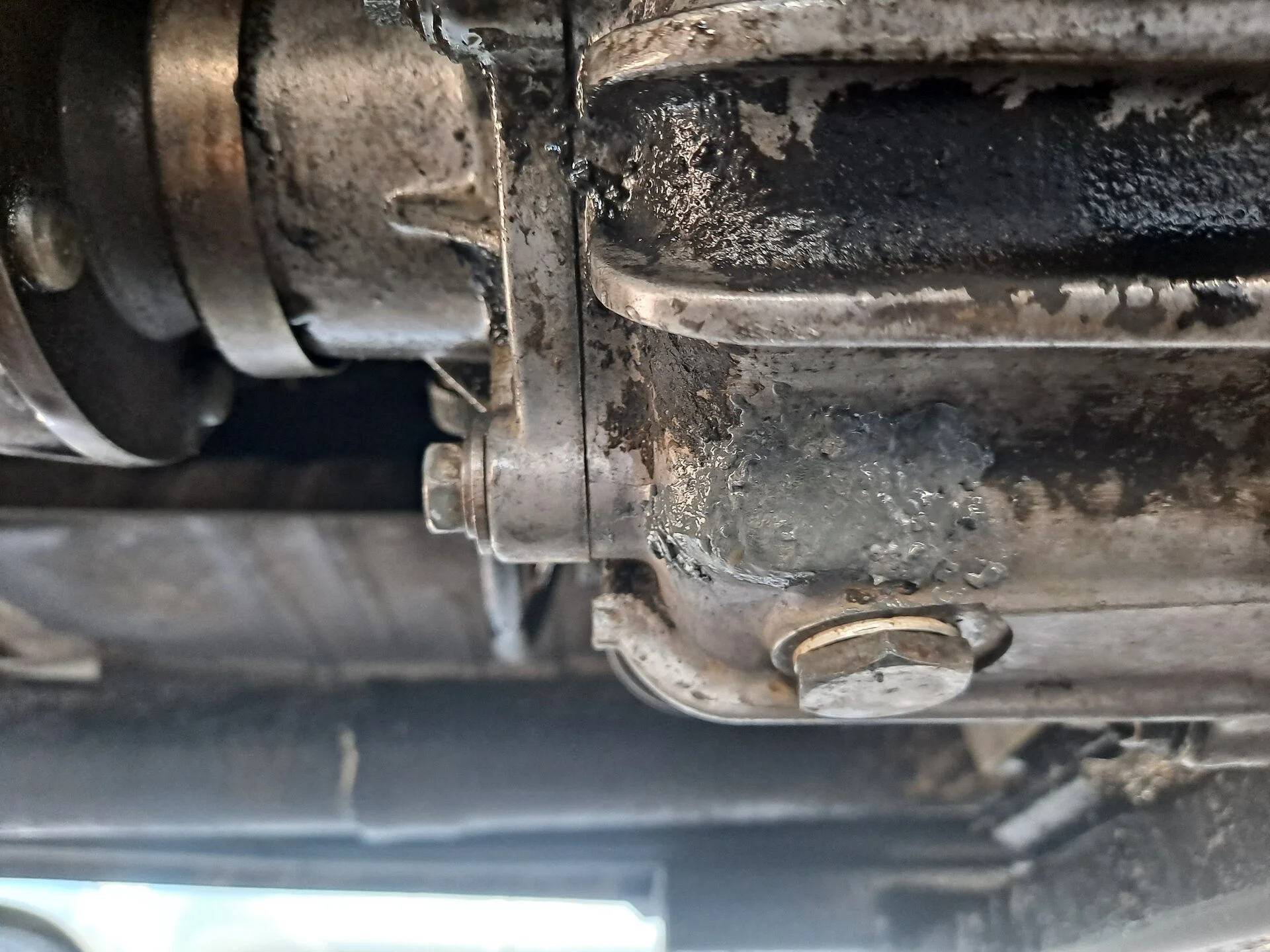

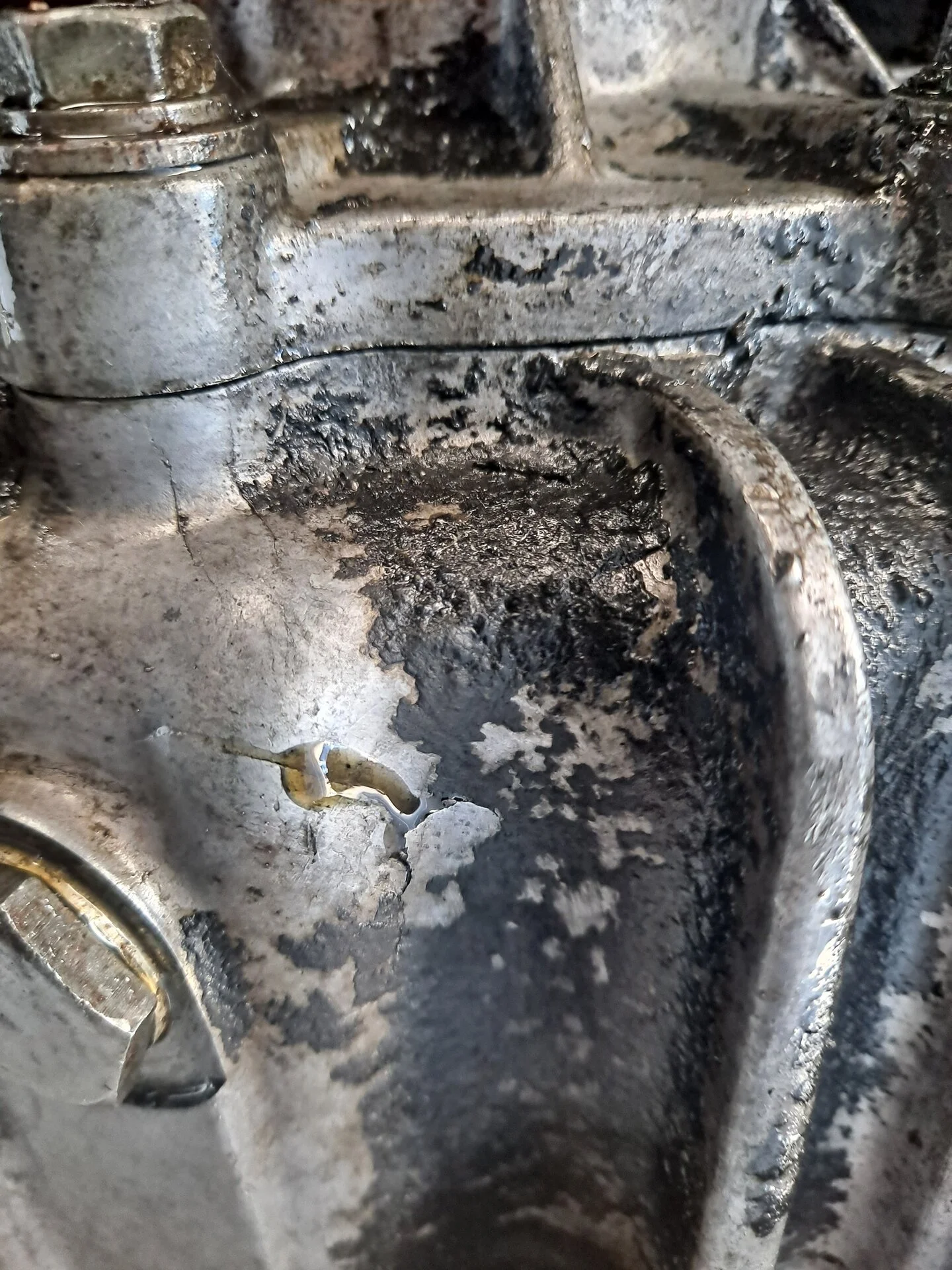

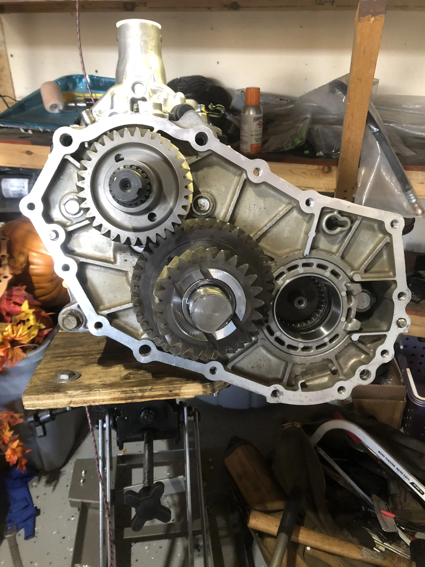

Well crap. Found my transfer case leak. Hoping to find another one before I result to having this one welded. 1 forward, 2 back....
JB weld for now to keep the oil in for now.
My first blue 84 had that exact same crack in the tcase. Exactly in the same spot. Someone had jb welded it and I didn’t notice it. Drove it for about 45 minutes back to the house after I bought it and it promptly puked all the gear oil down the driveway and into the street. I would be wary of trusting the jb weld to hold. That aluminum has so much oil soaked into it the epoxy doesn’t really form a nice bond. It would probably get you out of a pickle on the trail but I wouldn’t trust it long term.
Did you get a new case or have it welded? I'm afraid I can't afford another case right now, those suckers are expensive!
I bought a second land cruiser and stripped the 84 for parts. I ended up selling the 84 to a cruiser grave yard just to get it out of the driveway.
That crack doesn’t look too bad. You are capable of pulling that cover off while leaving the trans in the truck. Put a bag over the internals to keep them clean. Take that baby to a welder and have them fix it up. That’ll also give you a chance to inspect your t case health. You’ll have to replace the rear seal and gasket while you’re at it. Give cruiseroutfitters a call and they’ll get you the parts you need.

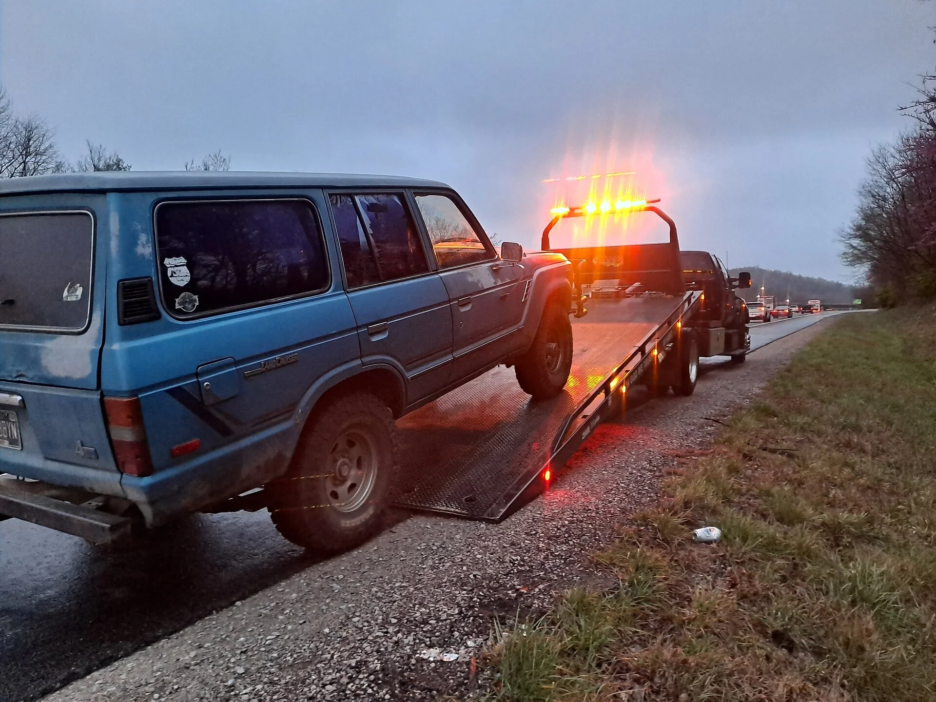

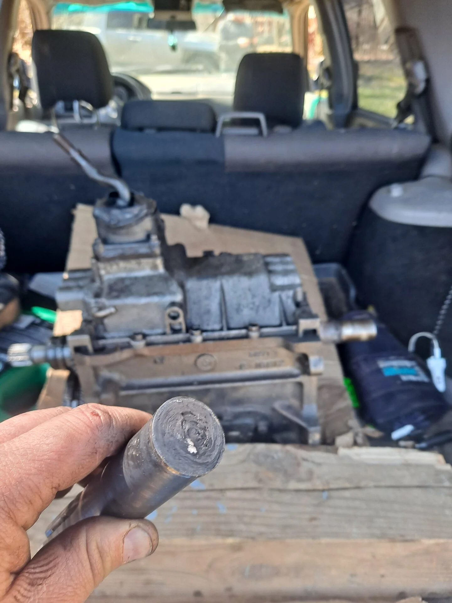

Over the weekend I piled the wife, kid, and dog into the 60 for a road trip into western North Carolina to get some parts for my Subaru, and made a couple of little detours for a nice hike in the mountains as well as some logging road exploration. On the way home, cruising along at 70mph or so, I heard a horrible crashing, grinding sound, and the engine died. While still coasting, I got the engine started back, and put the trans in 4th gear, and although louder than before, it still pulled fine, and shifted into 5th, and pulled, so I kept going. But after 10 minutes or so, it felt like the clutch failed all of a sudden, and would no longer pull. Once I got it stopped, I found that the truck wouldn't move in any gear, but the engine still runs fine.
$500 later, the tow truck drops us off at home, (75 miles) and I've been reading up on NV4500 failures.

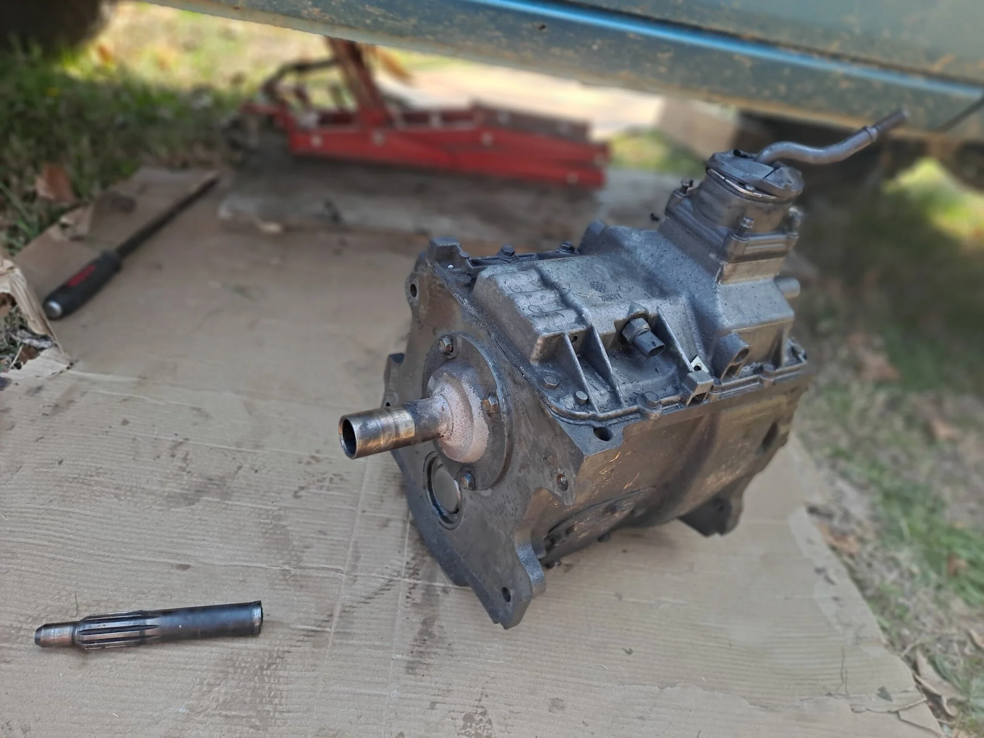

It sounds like at the very least, my input shaft bearing seized and the input shaft itself has sheared off. Now I'm back at work wishing I had time to yank the trans out and troubleshoot.

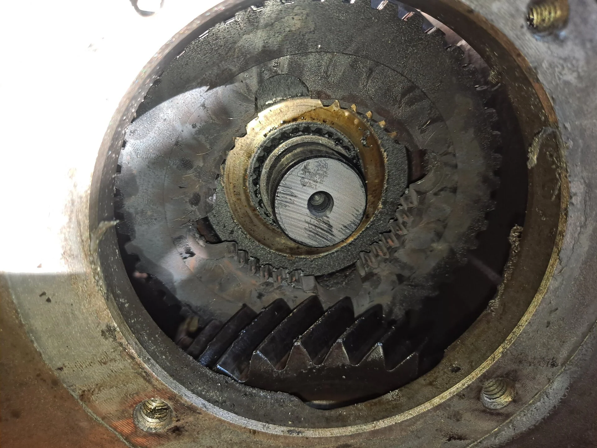

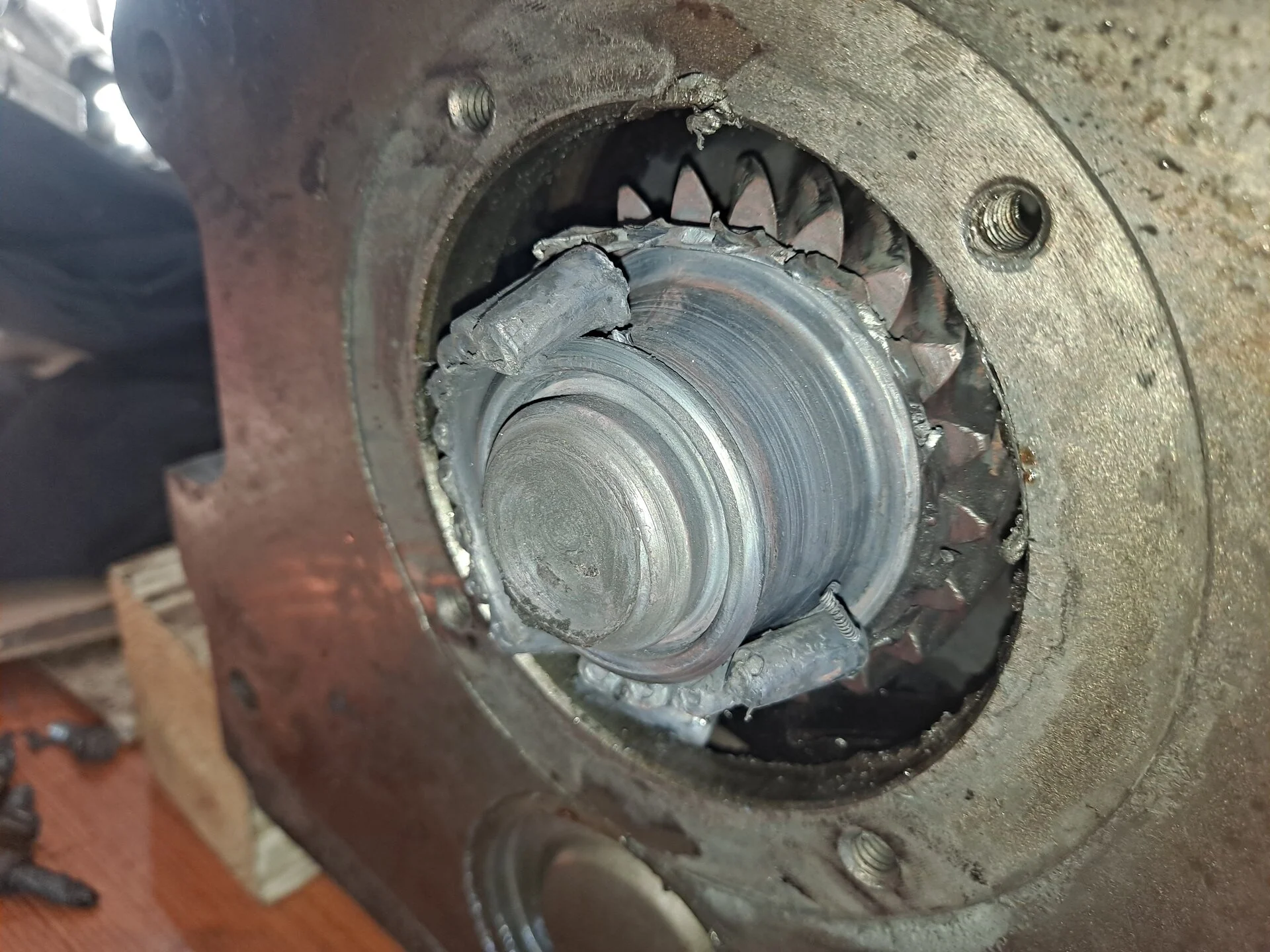

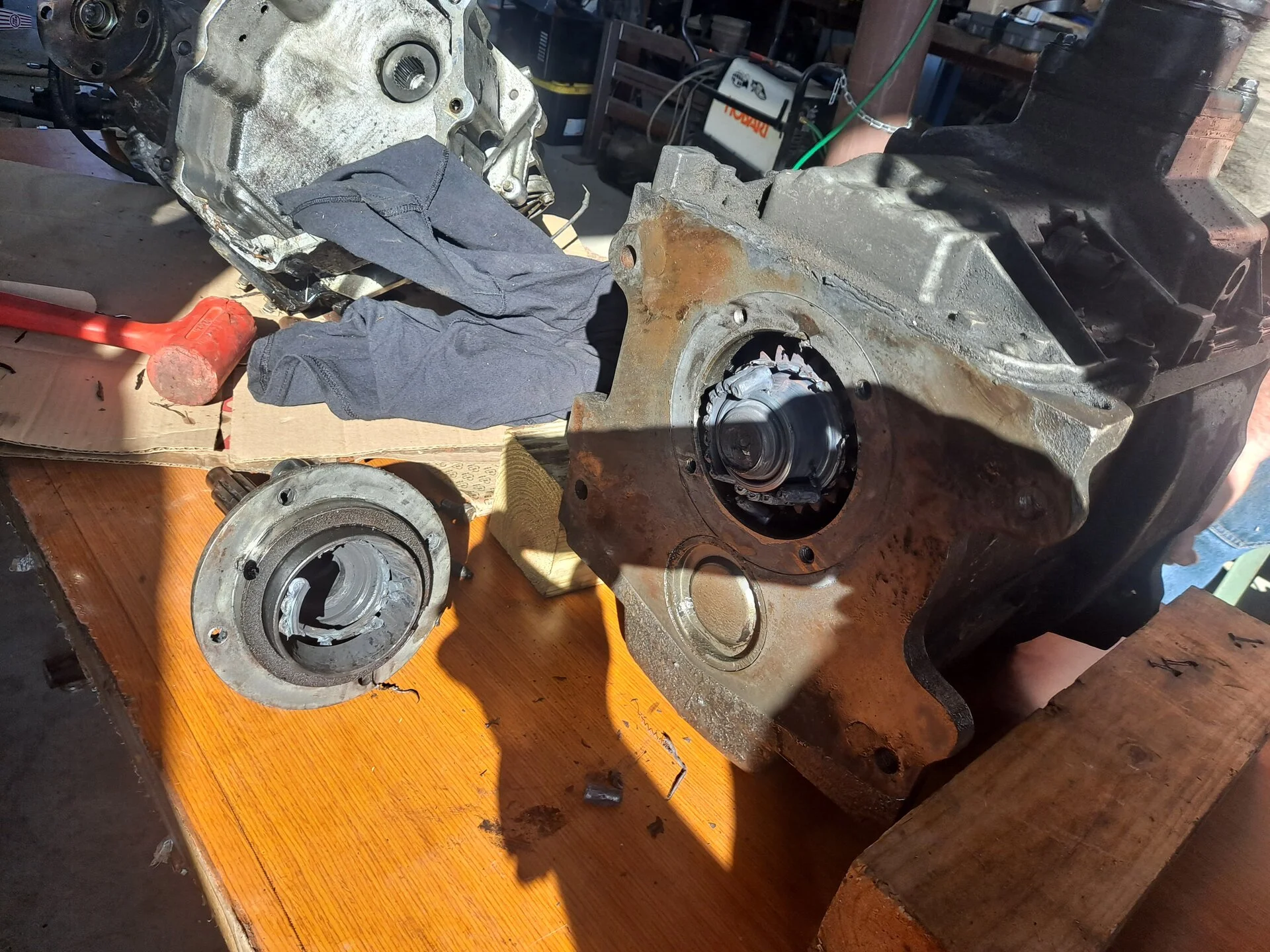

Last week I pulled my transmission and transfer case out of the 60 to see what broke, and found a sheared input shaft, a cooked bearing and retainer, and a galled mainshaft, and a pitted countershaft gear.
Through some research, I learned that my transmission is from a Dodge with a gas engine, and has the smaller 1.125" diameter input, but if I fix it, I can use the larger diesel input shaft which is 1.25", as long as I also swap the bearing retainer, and possibly the clutch disc. I'm not 100% sure if the disc will work for both or not. The splined section may be the same?
Anyway, I am working to find some good used parts, or a whole used transmission, as well as someone who knows enough about it to know what all needs to be replaced, and how to keep it from doing this again.
The trans had been run low on oil at some point, and made some noise, but shifted fine, so I didn't sweat it. I refilled it a couple of weeks before it failed, and it was still full when I took it apart.

Today I took my tranfser case apart, ordered new bearings and seals, and lined up a guy to TIG my cracked case half.
While taking it apart, I found a chewed up bolt and washer that had backed out of the nv4500 adapter. Apparently that one was the wrong size, as the holes in the adapter are all tapped standard.... dangit.
