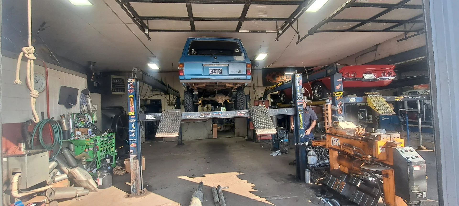

I just left the muffler shop after having my exhaust put together, and now the thing is nice and quietish going down the road, smooth and tolerable. This thing just keeps getting better!

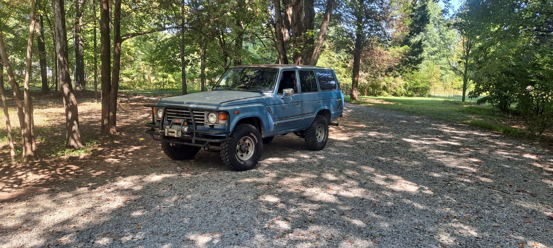

Drove it about 100 miles or so today on my route to drop my son off with my mother-in-law, and then on to work. It did great! Cruised 75 mph for about 40 miles on the interstate with no issues, and was happy to see my fuel gauge drop much more slowly than it did with the 2F.
This was a huge milestone in the build for me.
