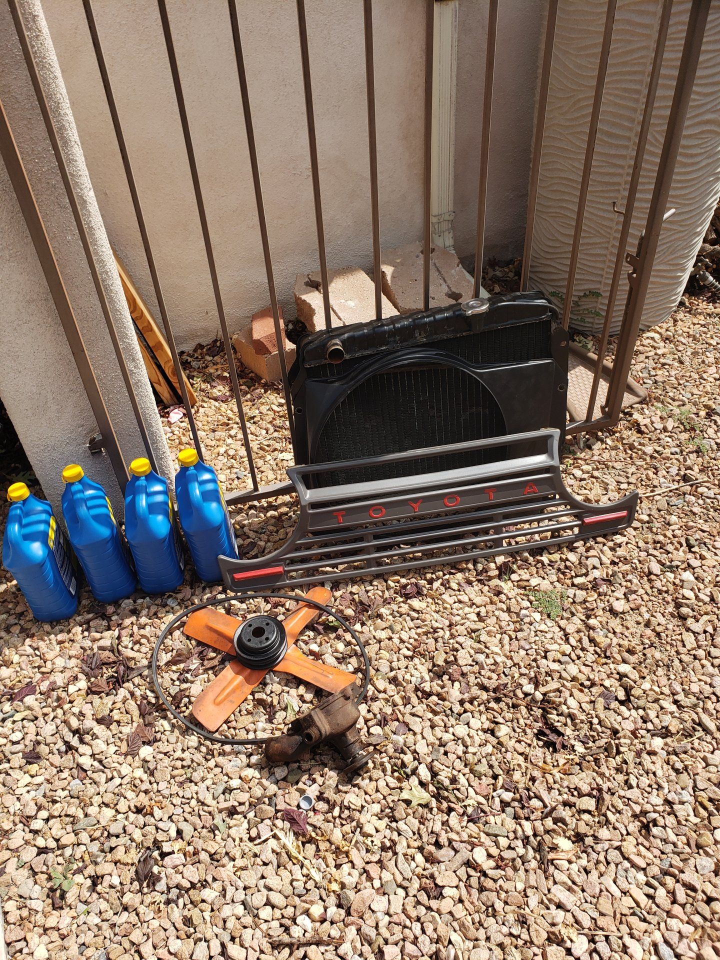

Back - left headlight wasn't working on the drive as well, so I wiggled the harness and it came back on. That's an easy fix, however I then noticed a little coolant getting splashed off of the fan blade. Didn't have time to figure it out last night, so I ran it idle for 15 min today and it started splashing again. Leaking at the water pump. see pics. I took the fan off last weekend to smooth out the pulleys, as they had a little rust and I figuered that probably led to the belt breaking. I wonder if somehow removing that pully caused the water pump issue becasue it looks like it's leaking at the front of the pully, although is that even possibble? I do recall the pully feeling like it could wiggle on the pump with the bolts loose, almost like the part it was seating to had some play. There was no leak before I pulled the fan so I must have doen something! Eitherway, the pump looks really rusted and old, so I ordered another one from Cruiser Corp. just now. Hopefully that solves that one!
Back??? - I'm really hoping not, but it looks like the coolant is a little oily. I'm no expert, but I read this could be and probably is a head gasket failure! Oh joy! getting into the deep end real quick with this thing! I guess a compression test is in order? The engine runs smooth, strong and doesn't smoke though, so I don't really know what to think.

Got the new water pump installed yesterday and fingers crossed, first long test drive, no leaks. Everything went back together and its running great! A little PB Blaster the night before made the old bolts break loose real easy, which had me worried! Bonus was with the radiator out, I could install the new plastic fan blade. Man that thing moves more air!
Never saw myself as a guy who was gonna be able do this job, but truth be told it wasn't that hard! Love the internet and this forum!
