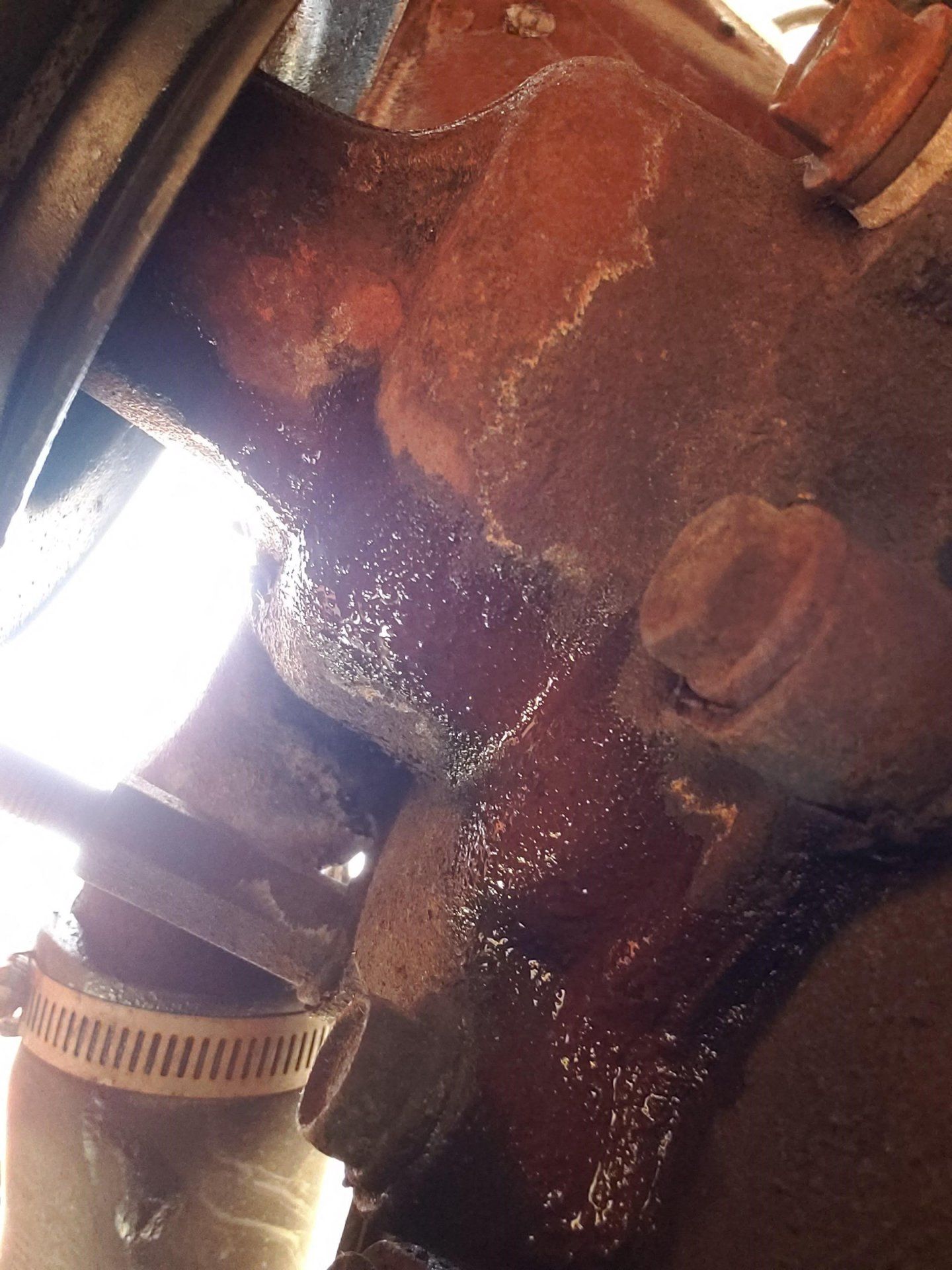

Back - left headlight wasn't working on the drive as well, so I wiggled the harness and it came back on. That's an easy fix, however I then noticed a little coolant getting splashed off of the fan blade. Didn't have time to figure it out last night, so I ran it idle for 15 min today and it started splashing again. Leaking at the water pump. see pics. I took the fan off last weekend to smooth out the pulleys, as they had a little rust and I figuered that probably led to the belt breaking. I wonder if somehow removing that pully caused the water pump issue becasue it looks like it's leaking at the front of the pully, although is that even possibble? I do recall the pully feeling like it could wiggle on the pump with the bolts loose, almost like the part it was seating to had some play. There was no leak before I pulled the fan so I must have doen something! Eitherway, the pump looks really rusted and old, so I ordered another one from Cruiser Corp. just now. Hopefully that solves that one!
Back??? - I'm really hoping not, but it looks like the coolant is a little oily. I'm no expert, but I read this could be and probably is a head gasket failure! Oh joy! getting into the deep end real quick with this thing! I guess a compression test is in order? The engine runs smooth, strong and doesn't smoke though, so I don't really know what to think.

I'm a little scared to post this, but all 4 backward steps have been reveresed! Blinker/running light issue fixed by running it's own ground wire, water pump repalced with no leaks (so far anyway), no oil in the coolant so no head gasket issue, and driving with the rear window closed sovled the fumes issue in the cab! All in all a pretty sucessful weekend! Bring on the carb and new dizzy (GULP!)

It was probably time for that water pump. this will be a great time to flush the cooling system and fill with fresh coolant.
Can you smell anti-freeze in the exhaust? It is the kind of smell you don't forget if you have ever blown a head gasket.
