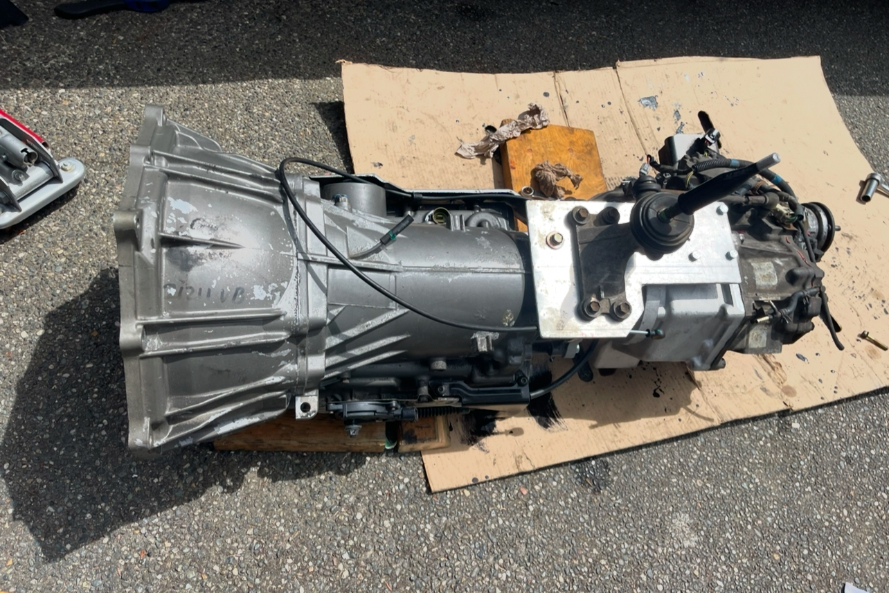

Evening Troops,
Below is a picture of the bracket for the hi/lo shifter I had with my marks adapter for my ls swap, and below that is a picture of the hi/lo shifter and as you can see there is no way its bolting up!
Anyone else have this problem? Obviously I will have to fab up or modify the bracket included, I was just wondering if the original bracket holes line up where the shifter mounts in the cab, so it would be a case of just cut the bracket and and add new material with holes to suit my hi/lo shifter!

The Mark's 4WD adapter plate is designed for the earlier 4WD shifter.

I ran into the same problematic issue as you. I had to be creative and fabricated an aluminum plate to make it work.
Easier to cut AL than steel plates with a power saw. Wish I had access to a water jet cutter.

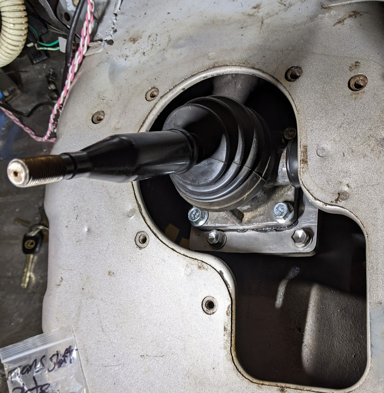

I made a little bracket to move the mount point further away. I also used flat head #8-32 1/2 screws underneath to attach it to the transmission shift plate. Drilled into the plate with a bigger drill bit to recess the screw heads to allow them to sit flush.
