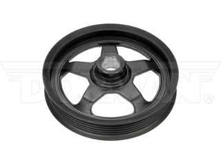

I have the one we spoke about on the phone and told me to buy which was gm part 12605677, the dorman equivalent to that is 300-200, i think we are finding the issue here. You said I may have to bend the line.

I was installing my L96/4l80e today and ran into the same issue with the pulley. What size serpentine belt do you use with it?

As for the belt. I’m using the stock belt for a 2001 Silverado 2500 with a 6.0, according to rock auto. 12637204 ACDelco part #.
So far I've slotted the cross member about 1/2" to gain some firewall clearance. I'll need to use the SST 5lb hammer and box tube to clear the cylinder head and dipstick tube.
Whatever the belt that goes with that 300-202 pulley application - I think 08-2014ish Silverado/tahoe/yukon etc

You know what, you’re right, I’ve been using that pulley for long enough I forgot that it’s not just the regular 08-2014 pulley. :lol:
From what I've ready, people are using button head bolts to clear the pulley and potentially having to space the pump to get the belt to align correctly.
If going this route, is the serpentine belt 2" smaller than the factory one? Or do you have a part number for the belt you use with that pulley.
I used the gm part # pulley but they gave me the alternate part number for the full disc pulley without the gaps. And the belt I listed worked fine for my engine set up. EDITED, I USED THE GM PART NUMBER FOR A 2010 SILVERADO 1500, SO ITS THE STOCK SIZE PULLEY THATS LIKE 6 INCH DIAMETER
