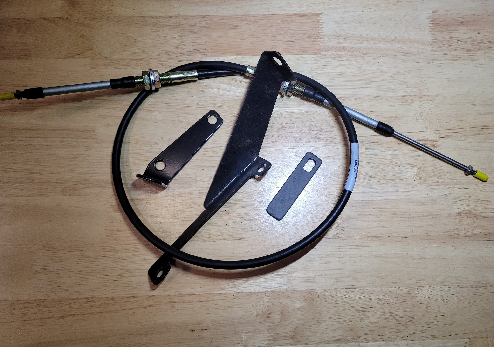

What cable did you use for the 6L80 shifter?
You didn't ask me, but I am answering. 😉
I used Dorman 905-612 but I could have used a shorter version as I routed the cable towards the back from the shifter and then back to the transmission shifter. I did modify the shifter arm on the toyota shifter. This is required to get the right distance throw at each gear position.
Most others route the cable forward and then back to the 6l80e in a S configuration. This requires a longer cable and the cable is in a push configuration, rather than a pull configuration.
Used a cable from a Trailblazer and routed it in an "S" configuration as described by others. It required a bracket to be fabbed up at the shifter end and the linkage arm needed to be flipped upside down on the trans. Took a bit of sorting out to get the throws close and it still wasn't perfect. Had my eye on the Zero Gavity push button set up before I sold the truck, but they sure are spendy.
The OG dude of LS swaps is selling a full mechanical linkage for shifting the 6L80. He is in Australia.
My install, with a cut and angled Toyota Transmission lever, works great. The angle, relative to where you mount the cable, is critical because it changes the throw for each gear position. P->R is much longer than R-> N, N ->D, etc. Remember, the transmission cable end is adjustable on the Trailblazer SS cable.

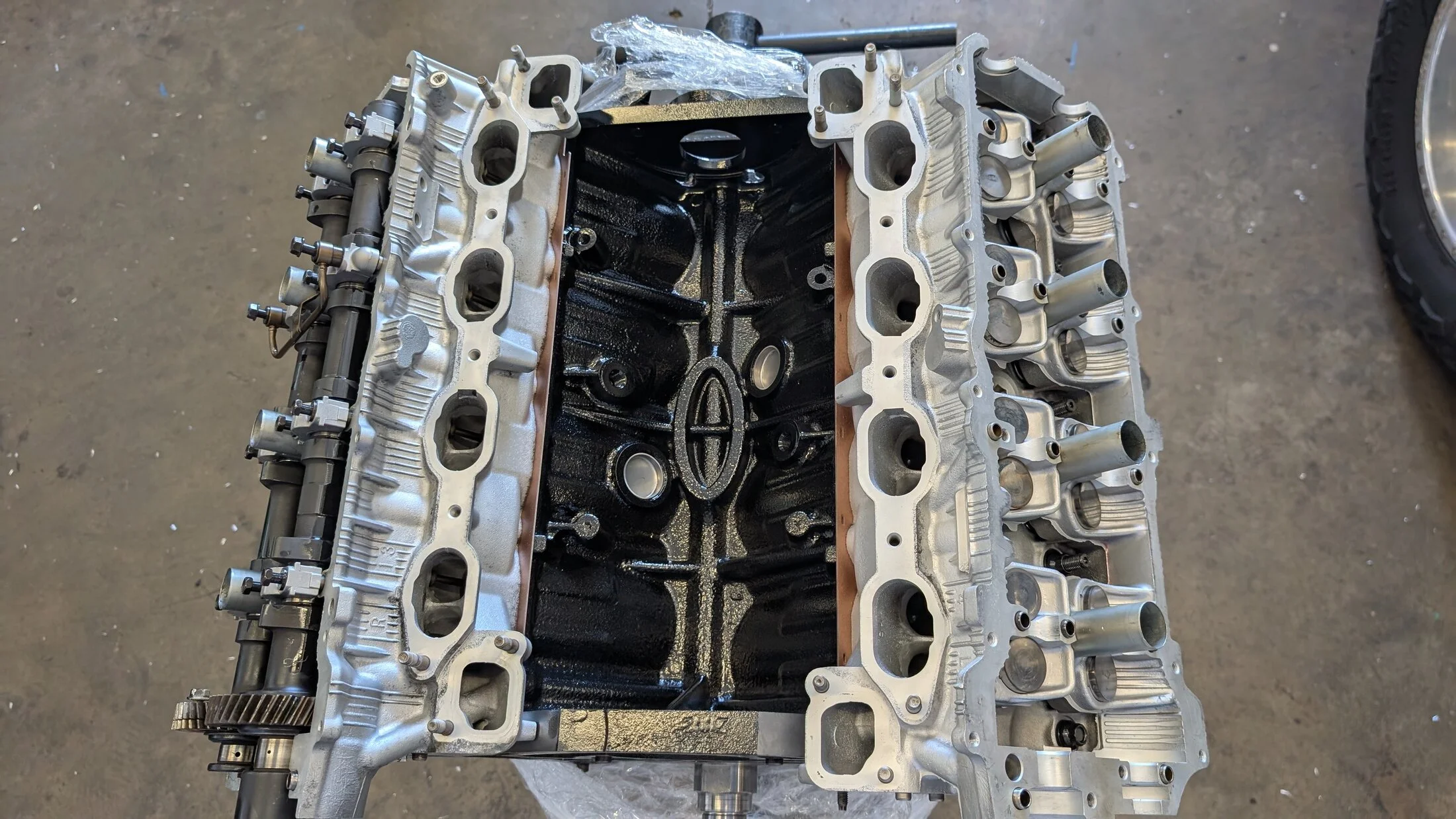

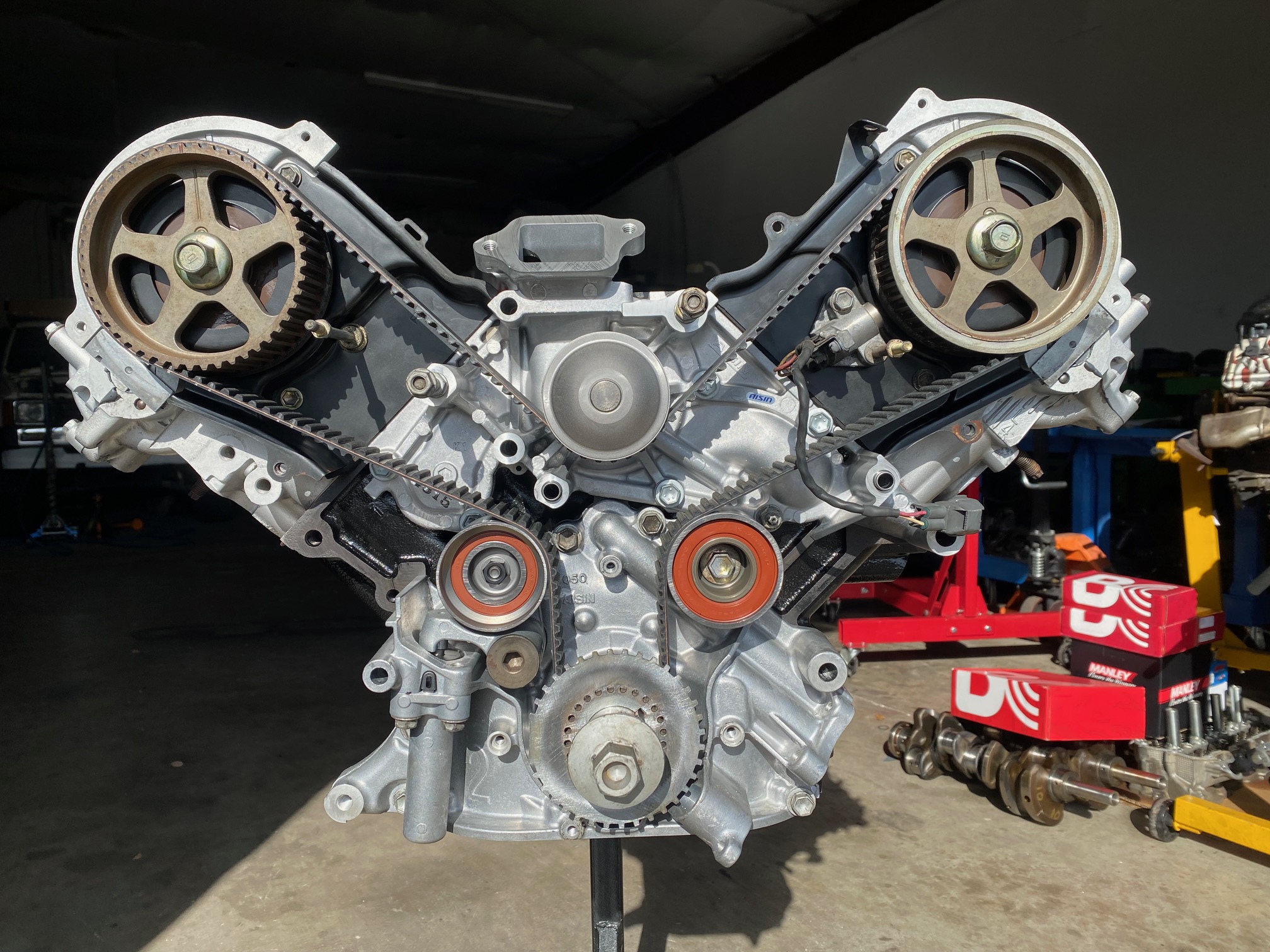

Header Question
My newly built 2UZ is shipping tomorrow from XAT Racing and I would love to run headers. Anyone in this group with a 2UZ swap running headers? I know there are a few companies who make headers for the 2UZ but will they work in the 80 engine bay?
