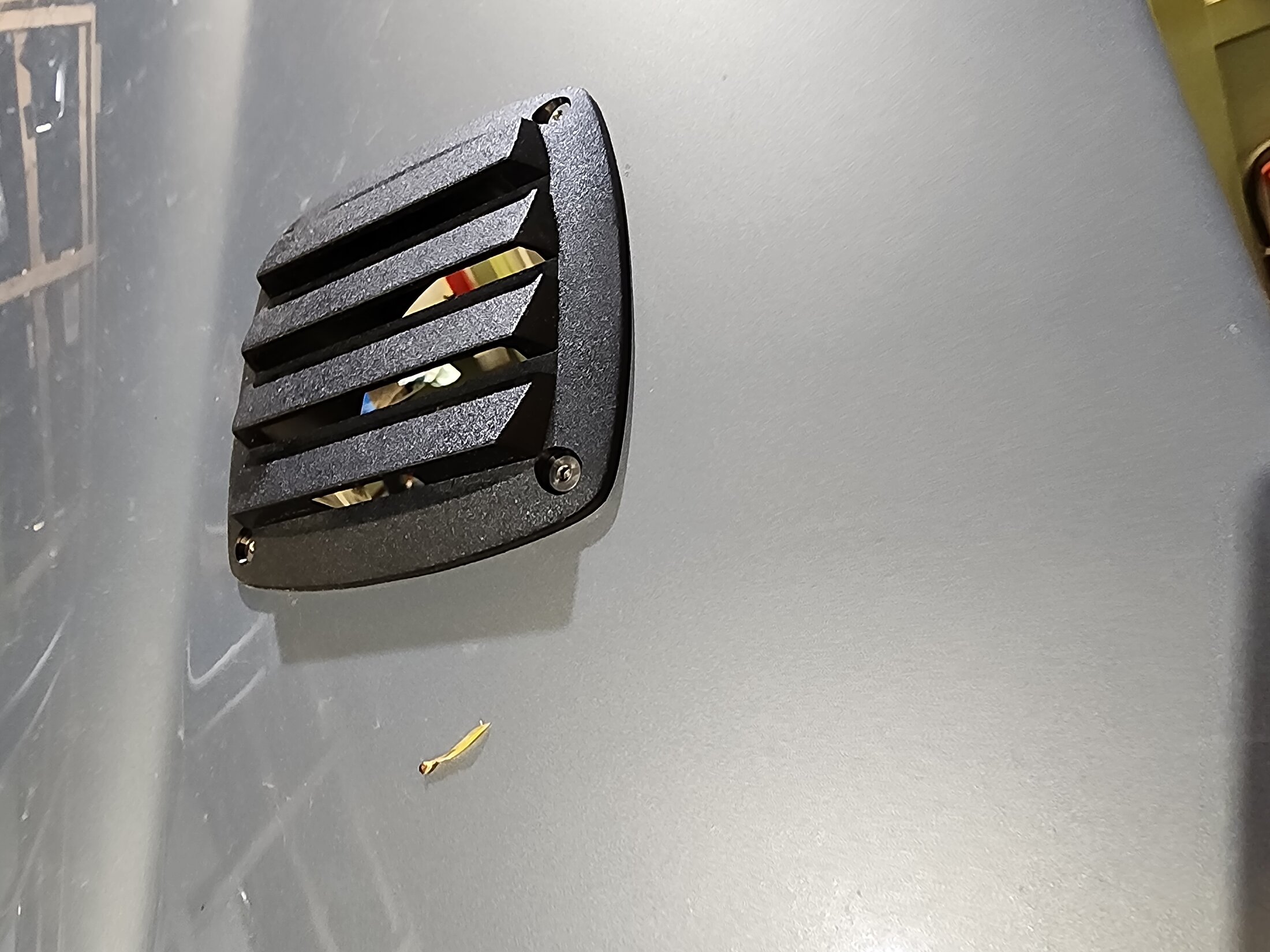

Pretty much but what I have is old but made the same. Where are you pulling air into the box from? I don't see an inlet
From the oem fender hole an a 4" vent in the hood.
