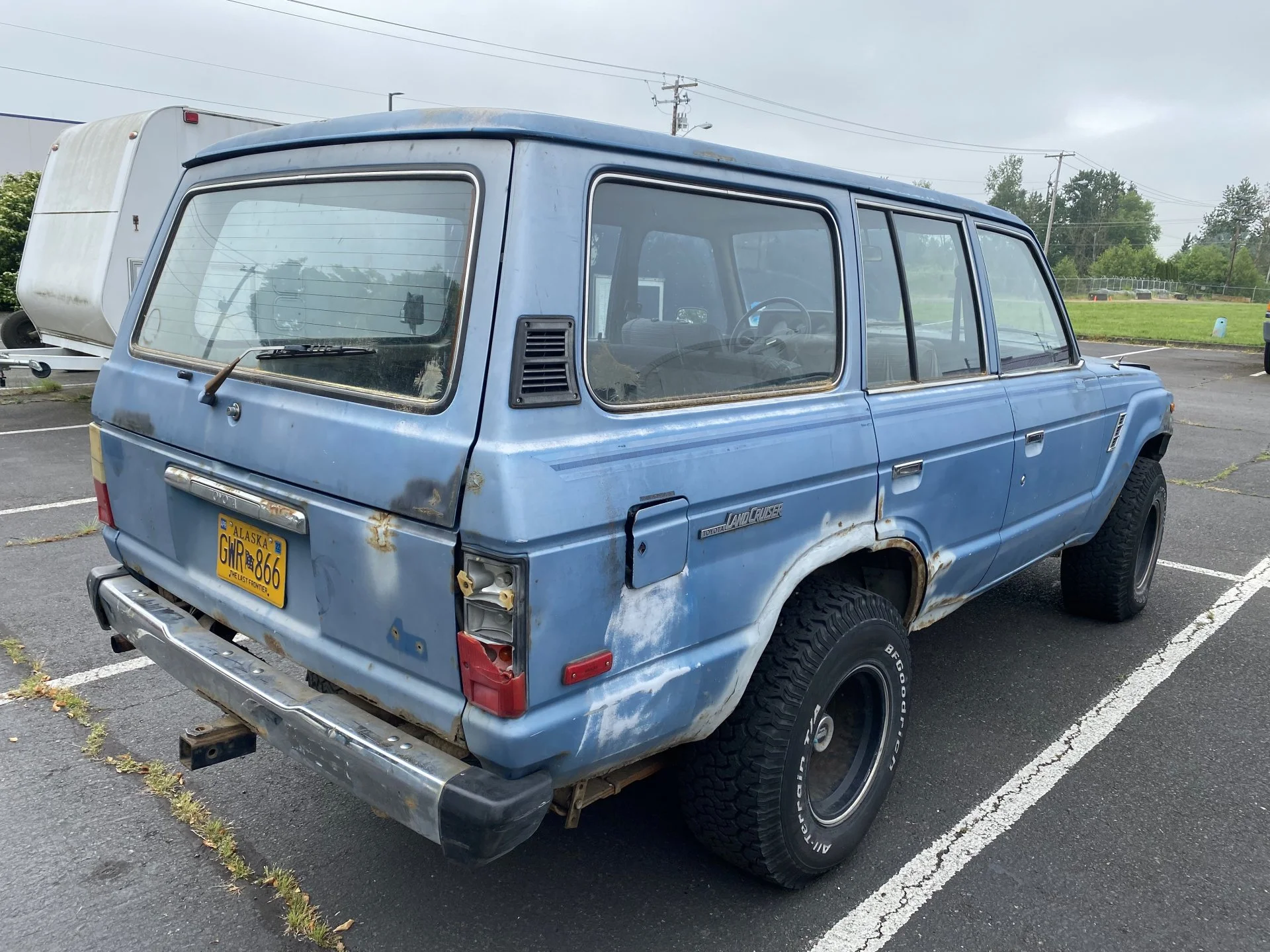

Hello all!
Figured I would create a build thread for my 1983 FJ60. I found this rig days before deployment. The PO was very less than honest about the condition and a master of deceit. I did end up purchasing the rig even though there was a bit of rust that wasn't described. The day before I deployed I had it towed to Land Cruiser Specialties in Oregon City, Or.

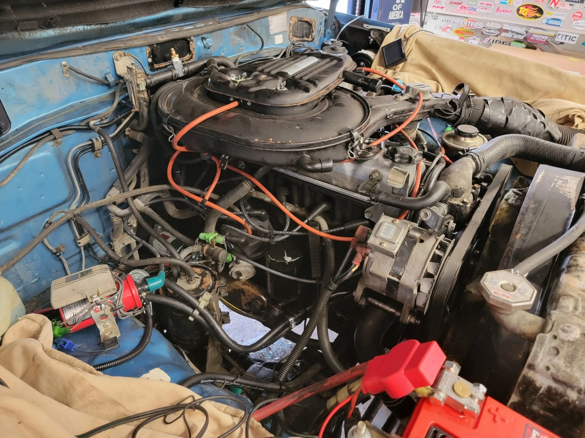

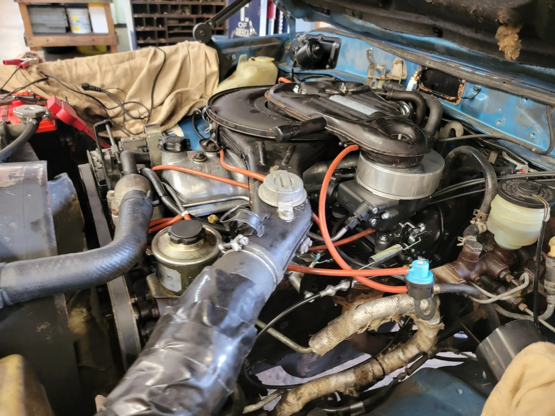

  • Holley Sniper

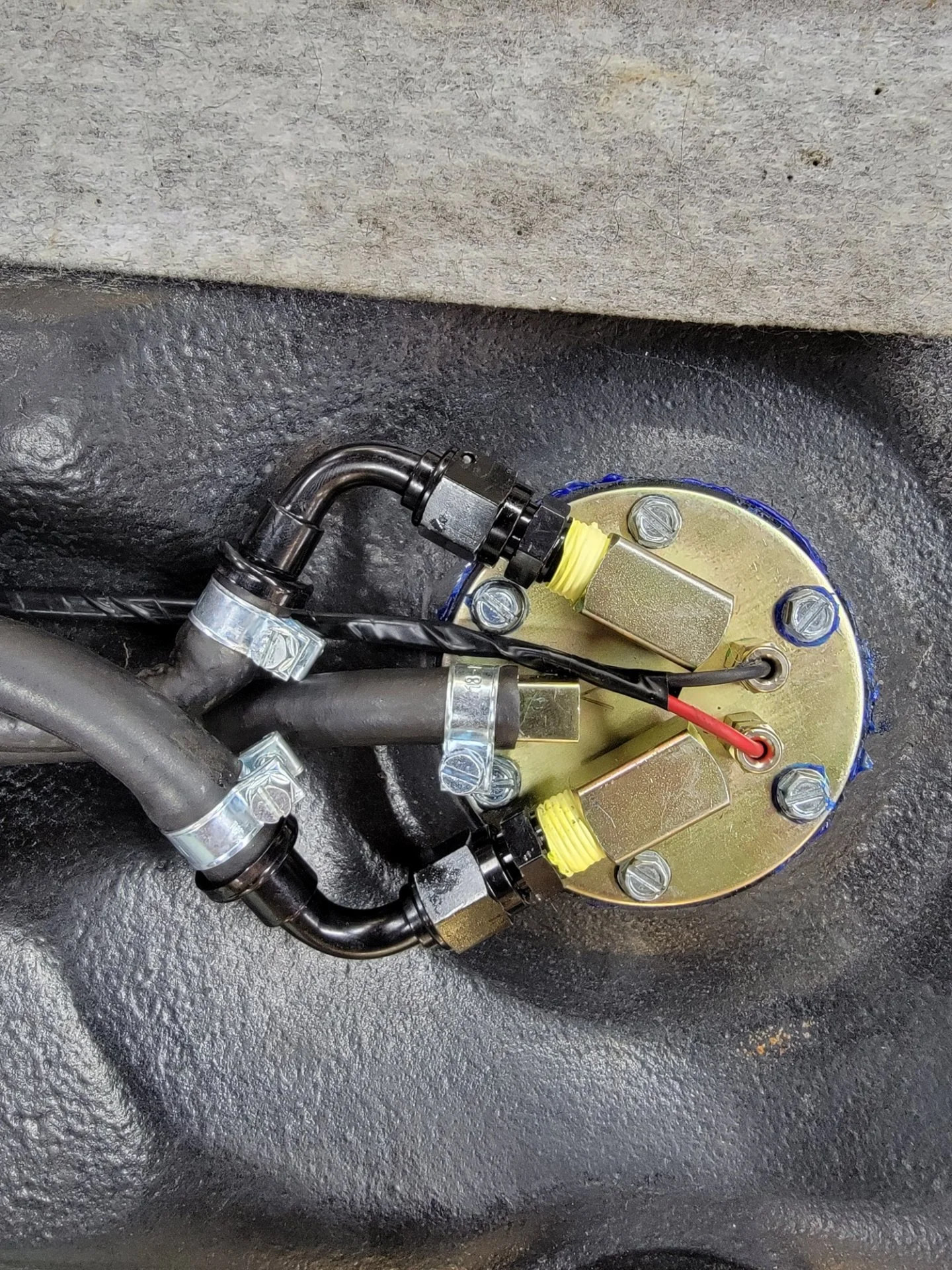

  • New fuel tank with in tank EFI pump

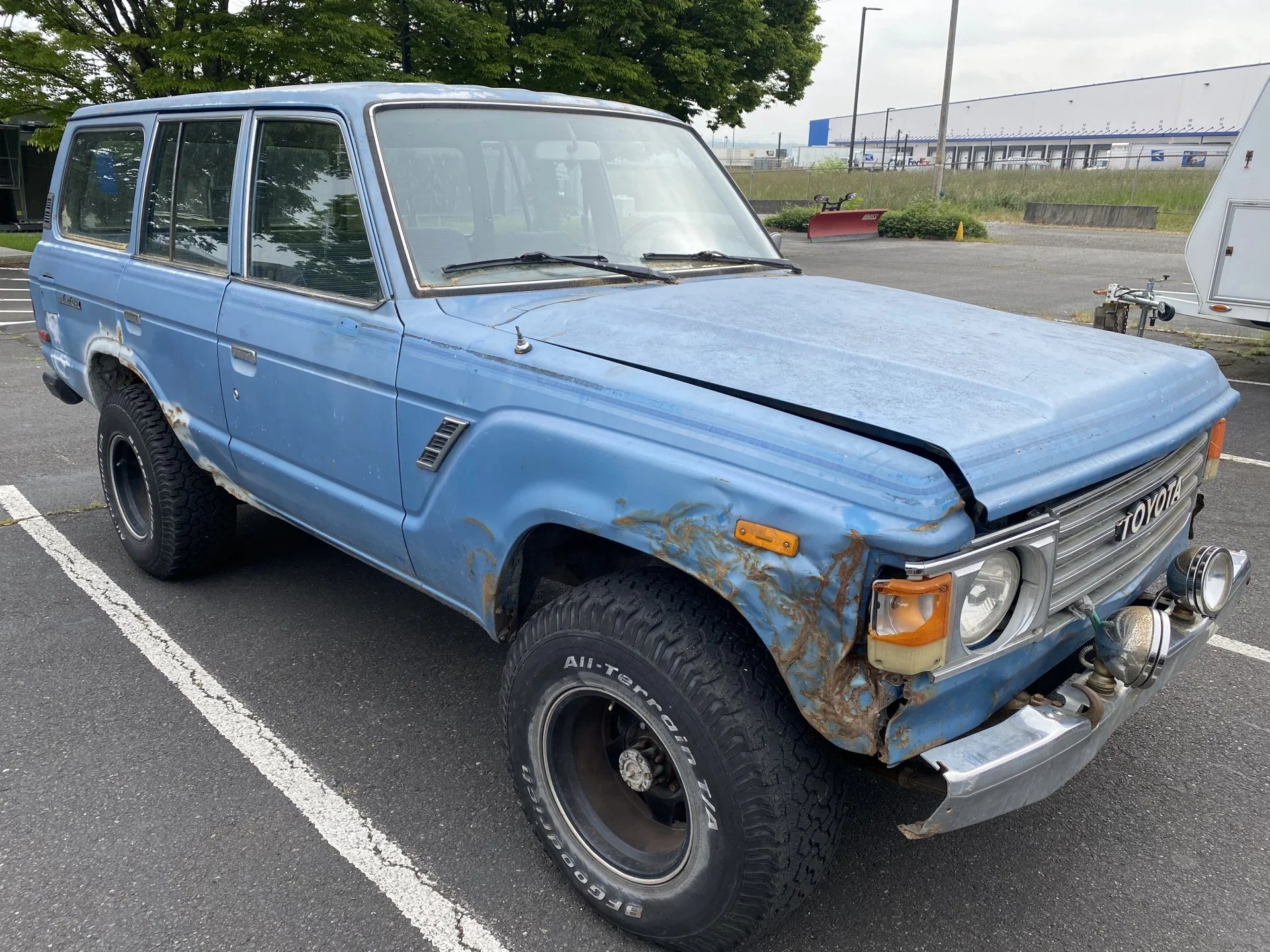

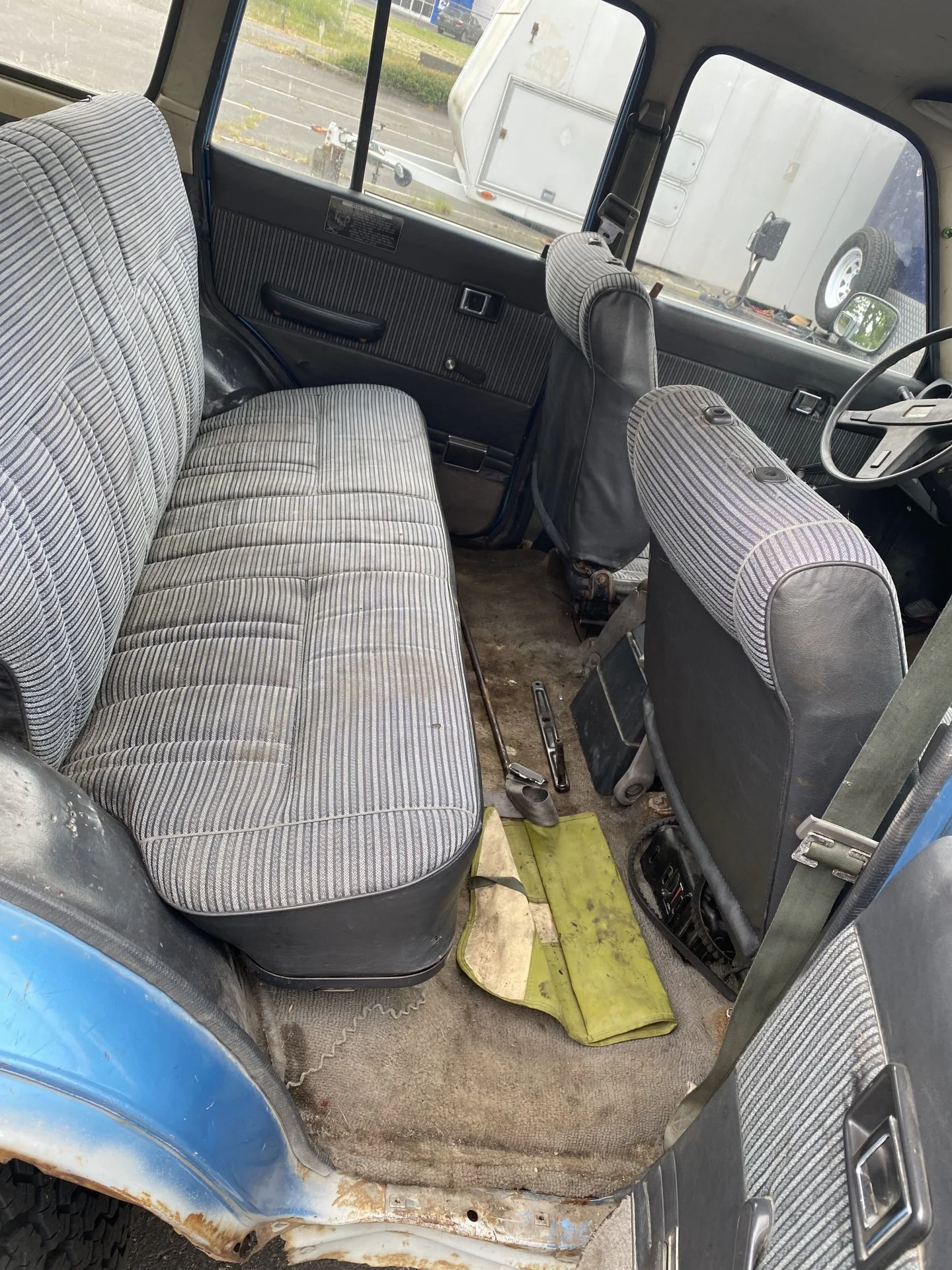

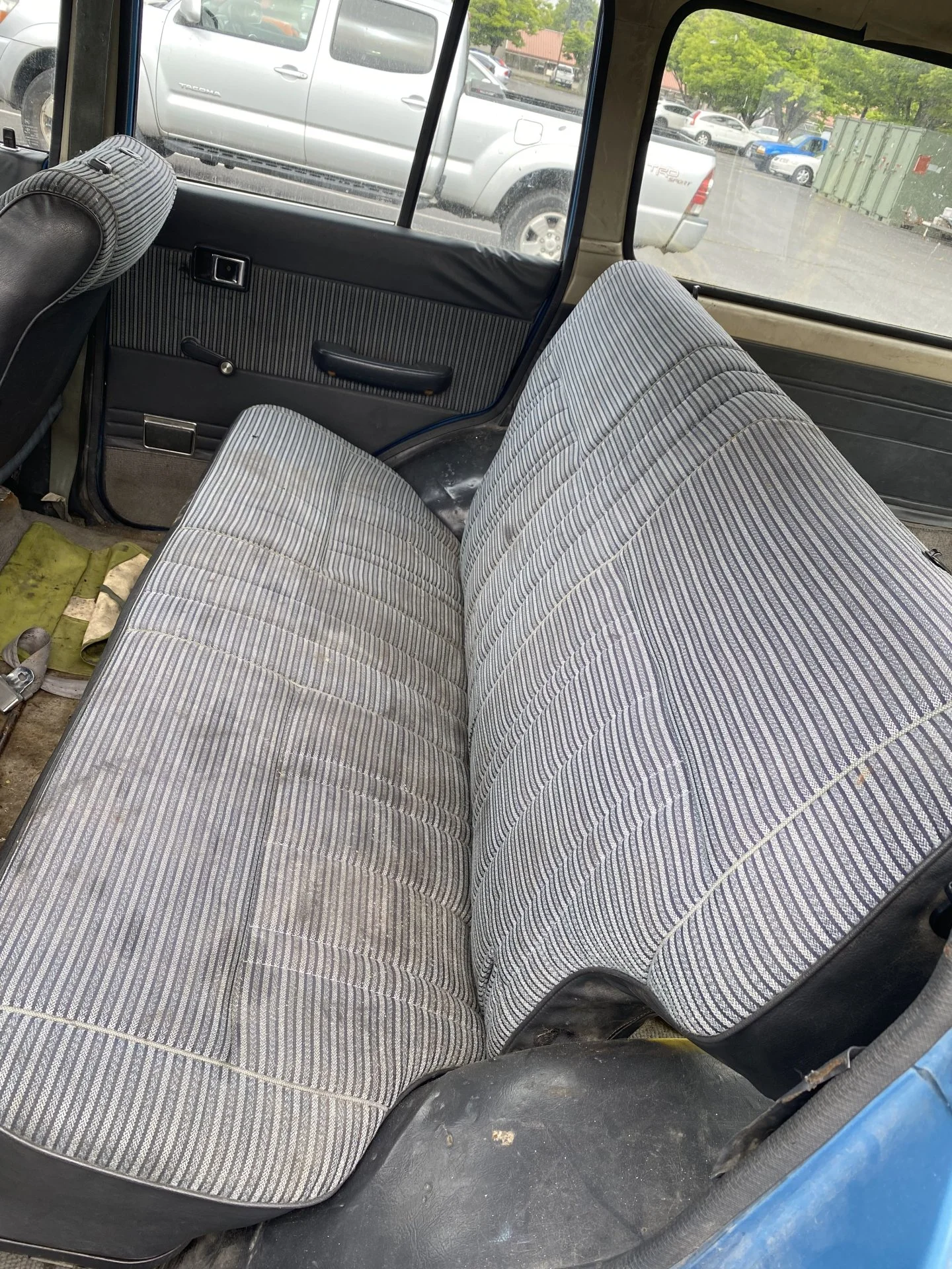

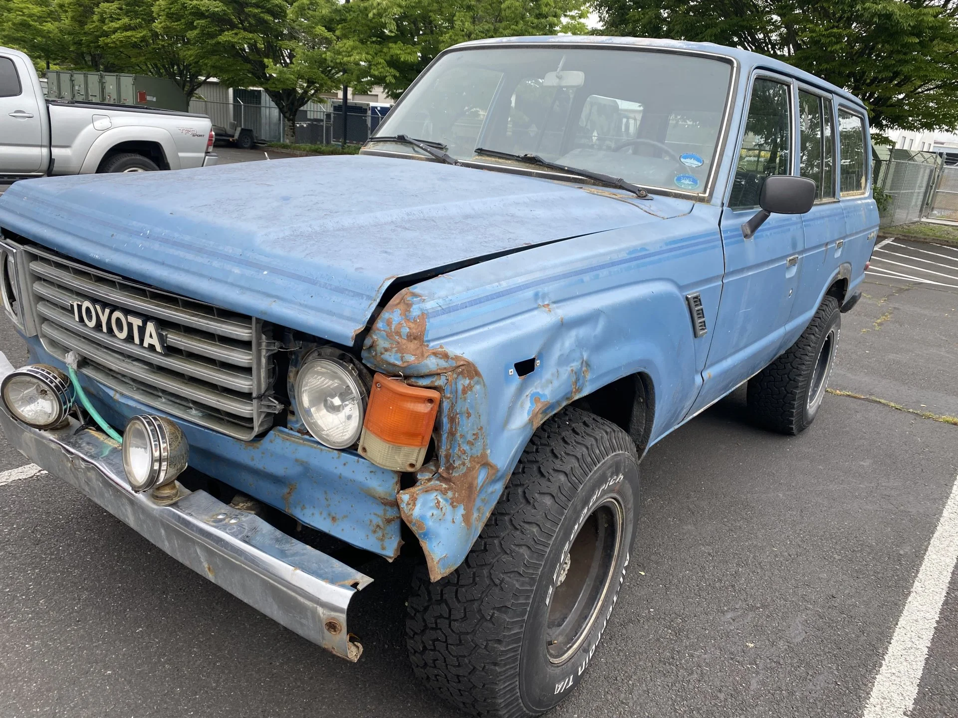

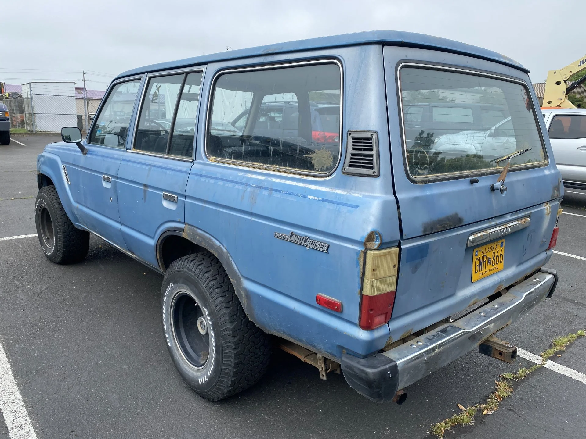

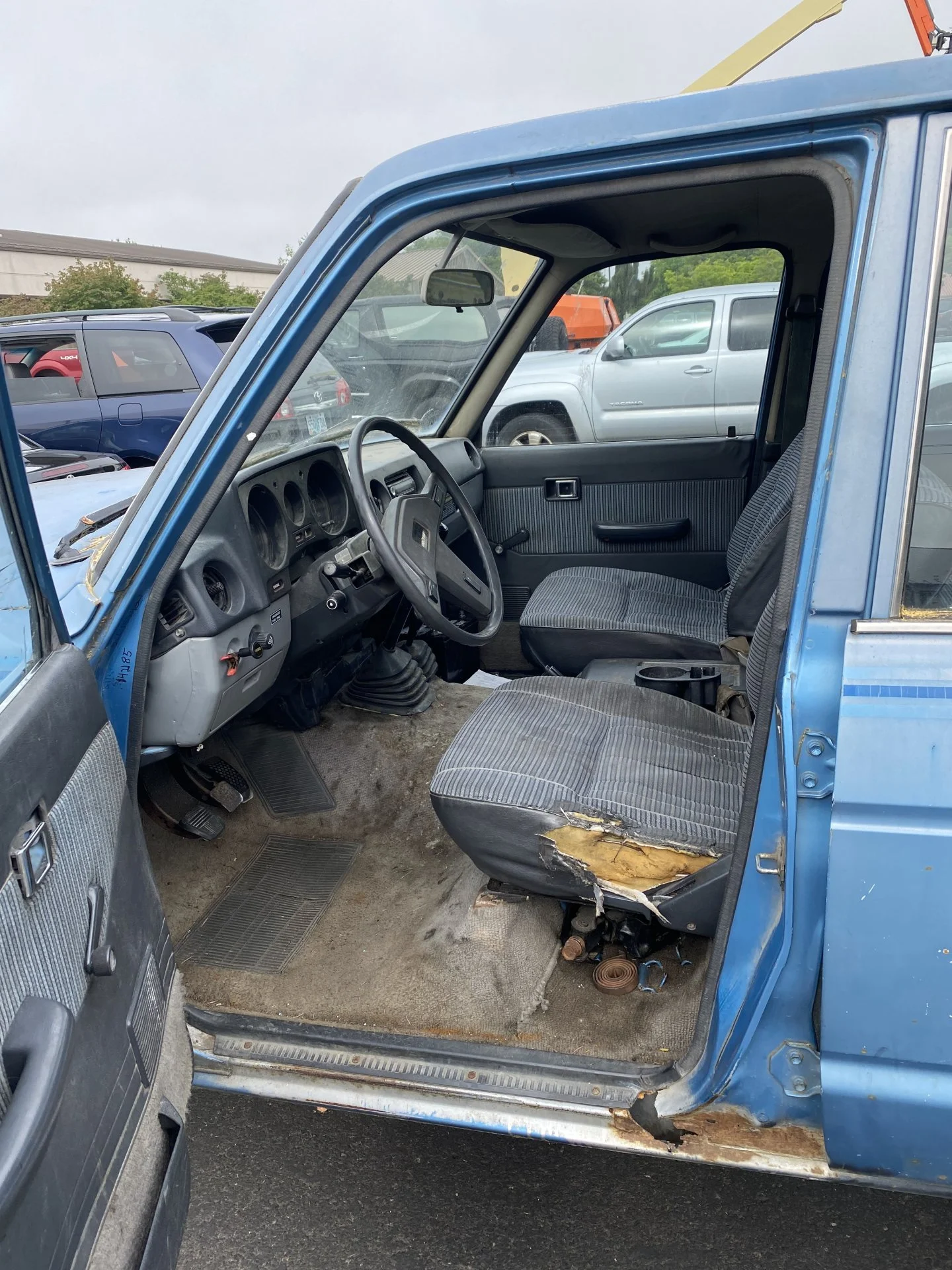

This beauty is pretty dang rough. But I have big plans for her.

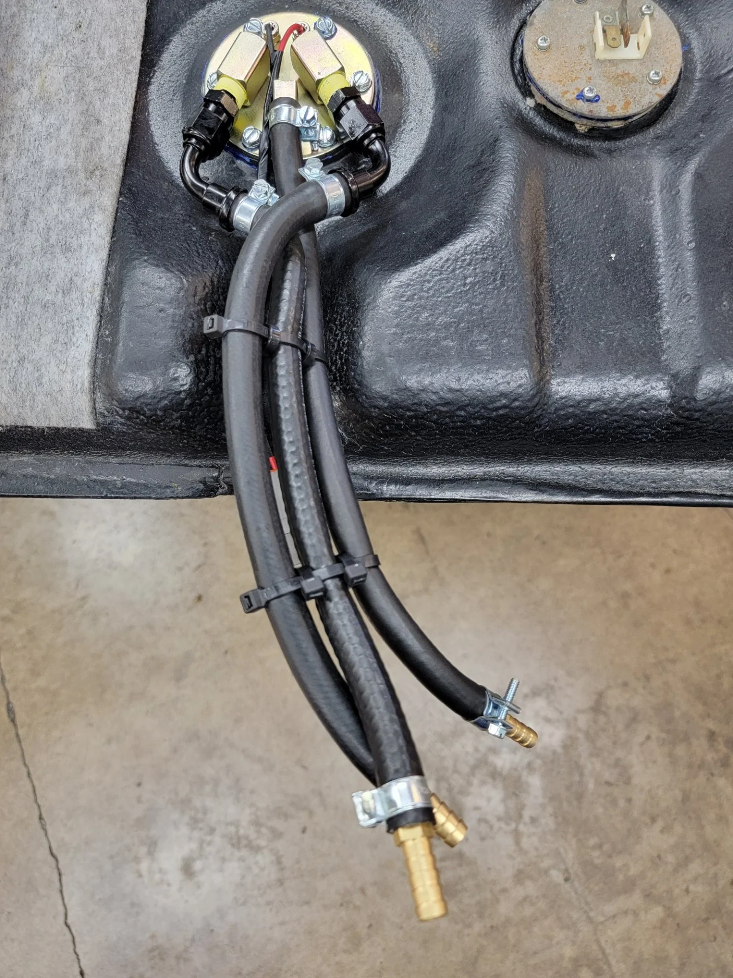

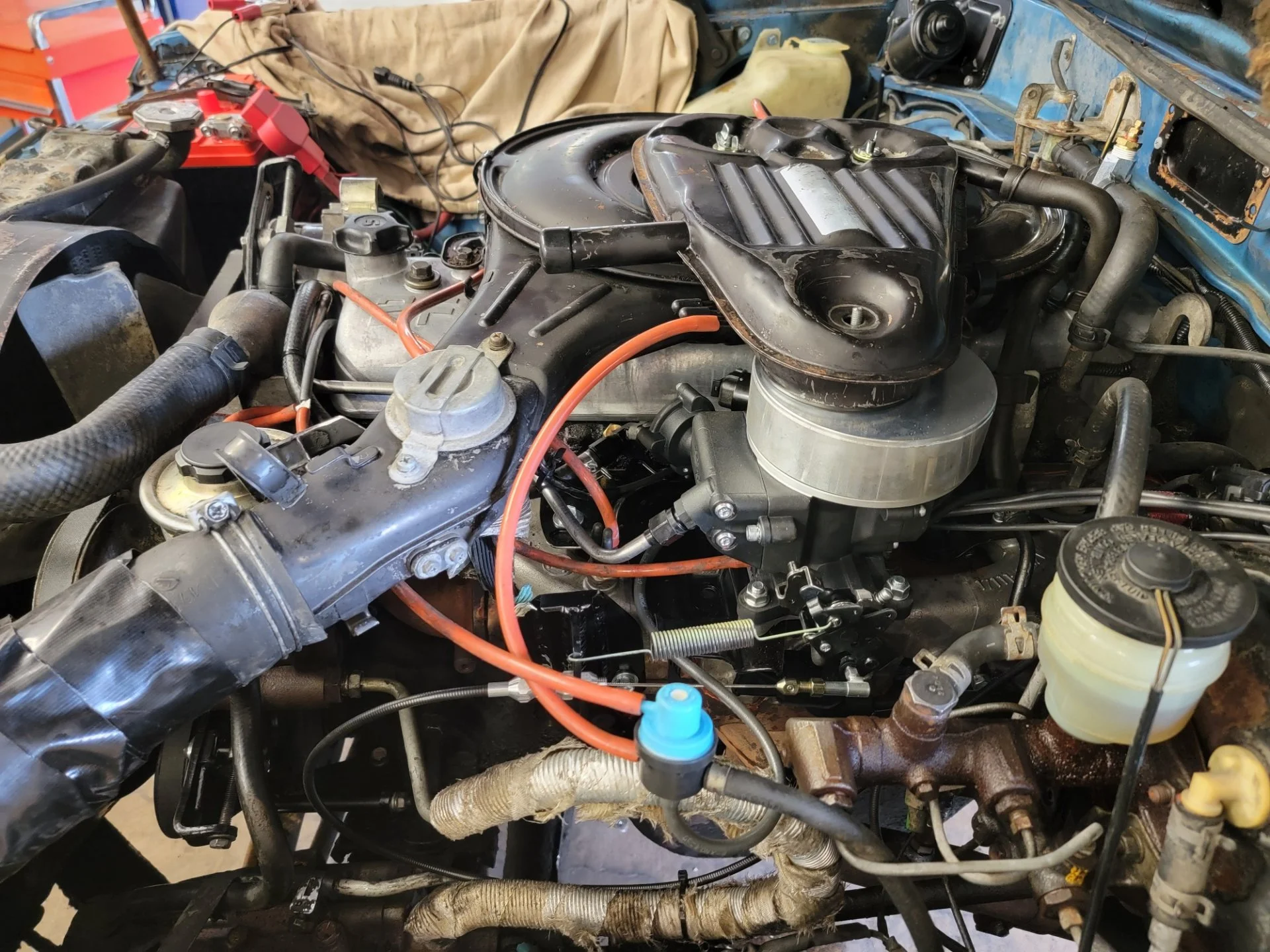

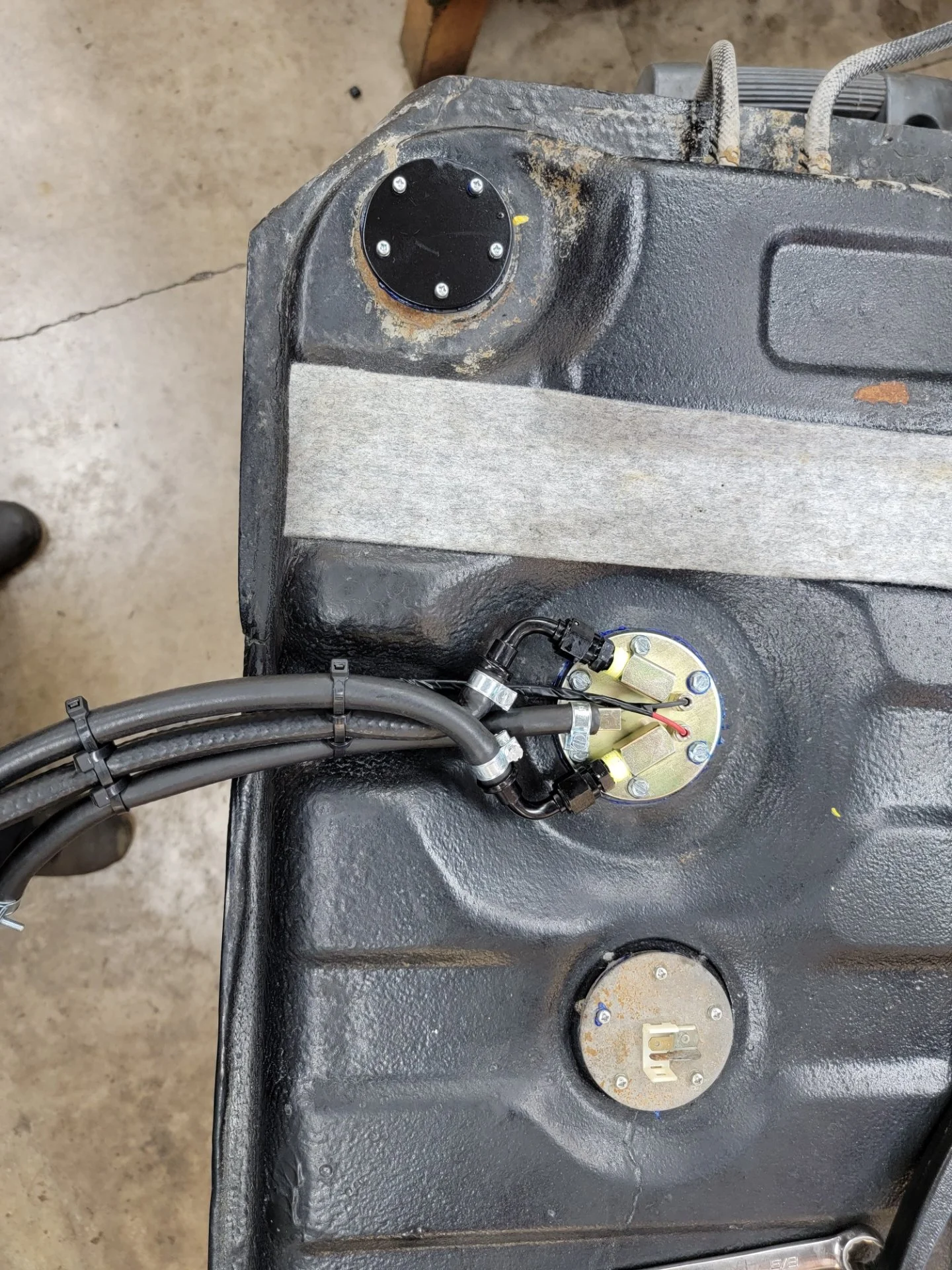

Fuel tank and in tank EFI pump. Figured less heat and noise. Plus it would need to happen for the LS swap in the future.
