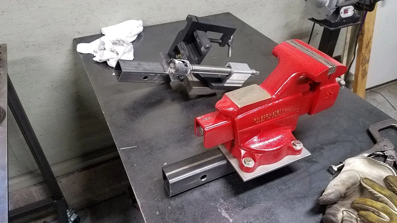

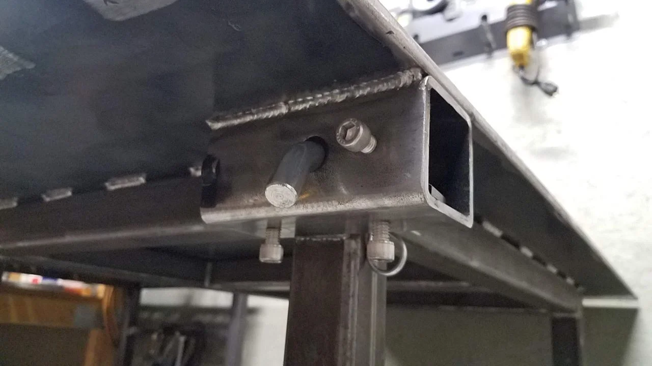

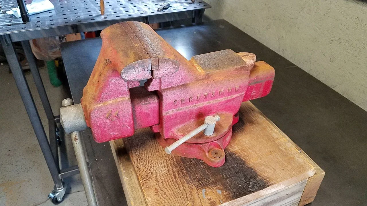

And what's with the hitch receiver tube at the front corner you ask? Great question! Most of the time it holds an early 70's Craftsman 5-inch anvil vise. This one was made by Columbian. A little grinding, filing and paint to clean it up.
2001362
2001363
The vise mount has worked out so well that I ended up doing the same for the JD2 tubing notcher
2001364
The tools are held in place with a standard hitch pin and 3 socket head cap screws.

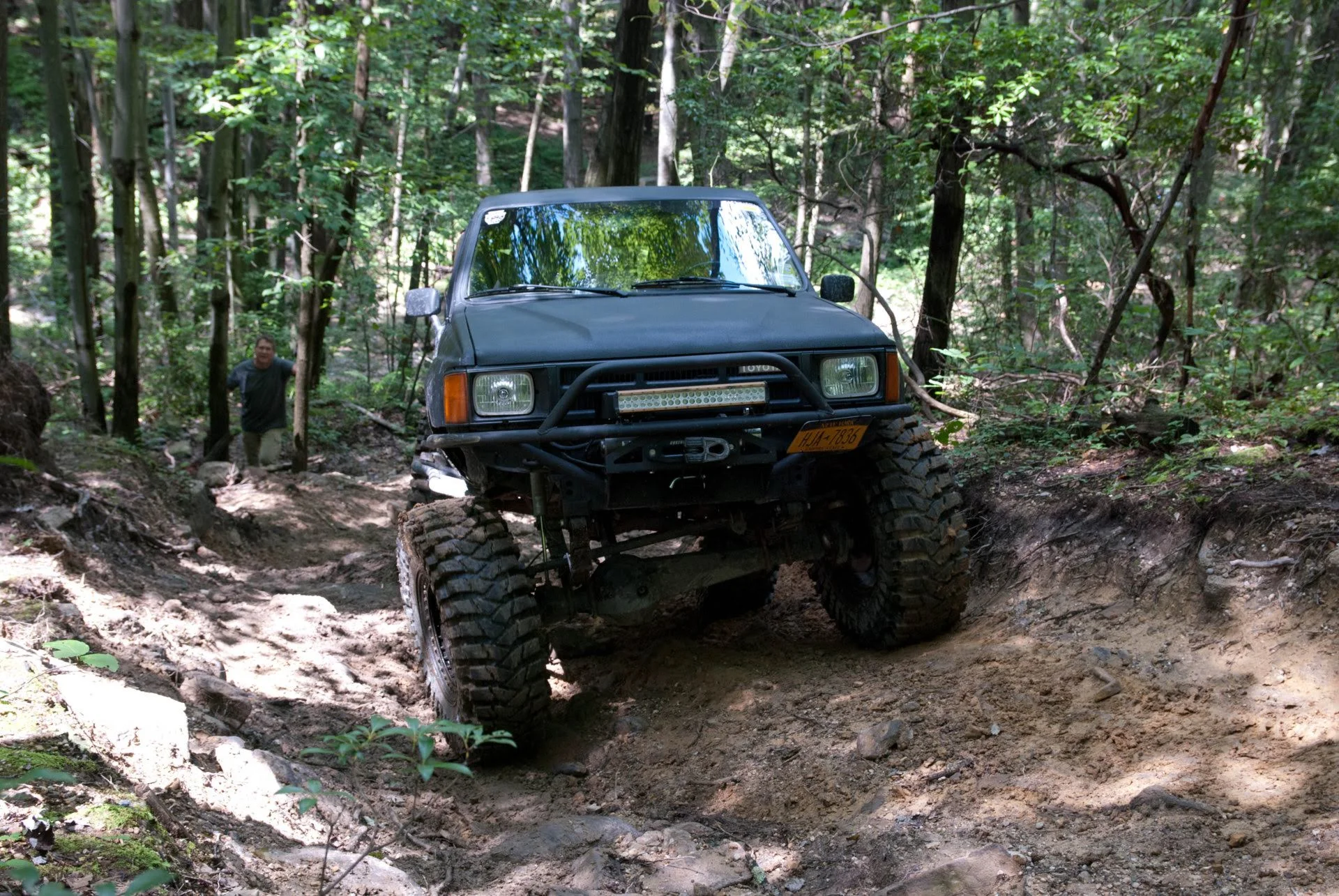

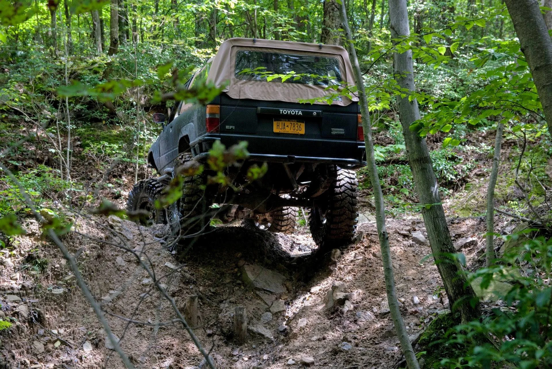

The pics of this section truly don't do the incline justice. Difficult to walk up, loose/slick dirt and rock which generally means a good time. As I approached the climb I was lovingly told it's not something you can crawl, but I was going to give that a shot before other means. Turned out the tires dug in and a healthy combination of gearing and lockers got me up without trouble. Lotsa fun.

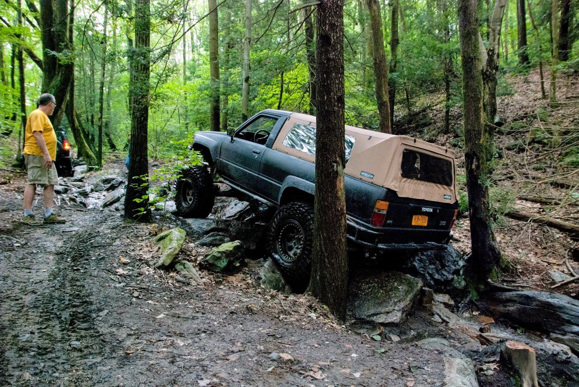

This notch ended up putting a rock outcropping into my rear driver's fender and would eventually pop my taillight. Meh. I think having the bedlined exterior helped prevent some dents and that's really its only redeeming quality.

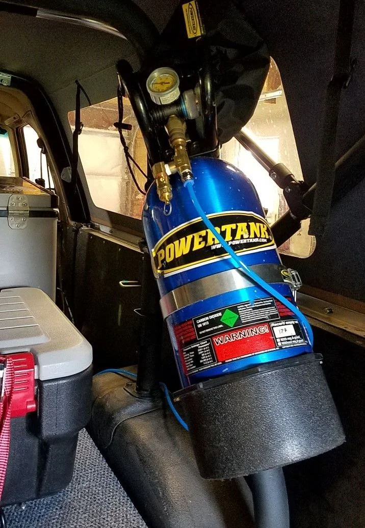

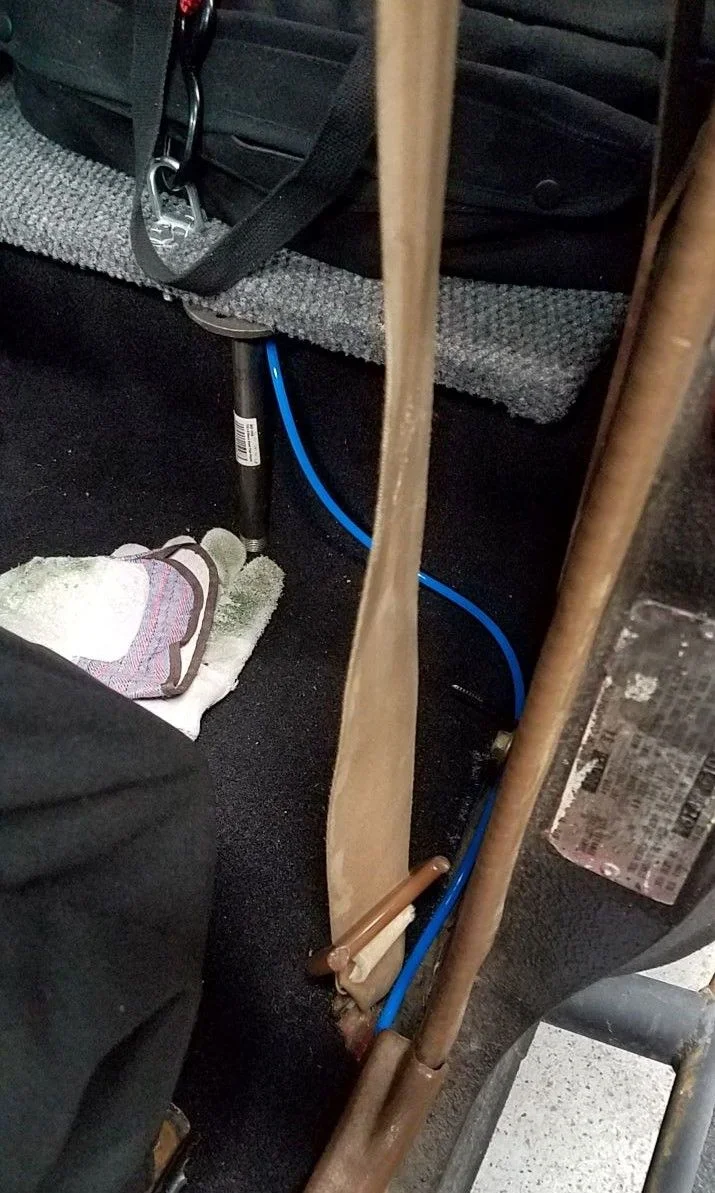

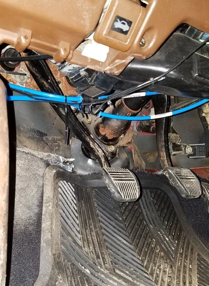

Shortly after that trip I started the daunting task of cleaning things up in the engine bay (which I'm still slowly working on). The most obvious starting point was getting rid of the air compressor used for the rear locker. It never gave me problems but just running the locker off the Powertank simplified things a lot, saved some weight, avoided the noise of the compressor, etc.
I already had the hose on hand, so the shopping list was small - 1/4" NPT male brass plug, 1/4" tee, 1/4" ell, push-lock fitting and a 1/4" 125# safety valve...should I forget to the turn tank valve down from tire pressure. This assembly can be purchased via PT's website, but this DIY version using identical parts cost me about $14.
2005745
The line snakes along beneath the rear platform, under the door trim and up through the kick panel...
2005749
...to be tucked up under the dash where the locker switch resides.
2005752

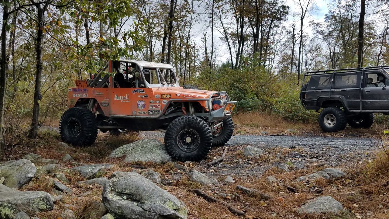

@matzell ‘s impressive 4500 class buggy

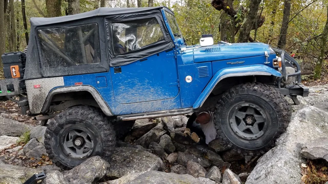

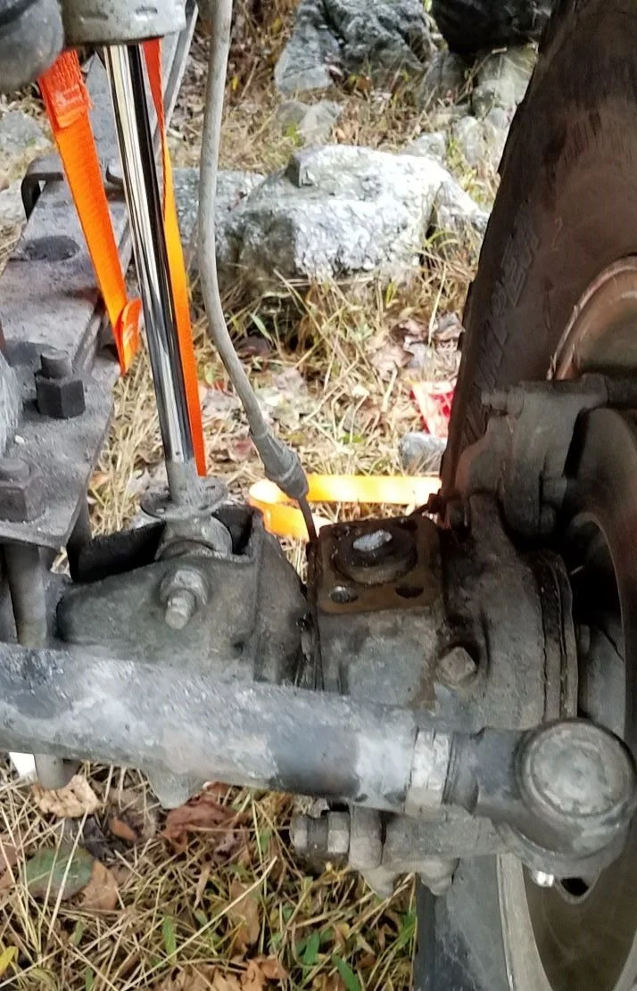

Wrist bone no longer connected to the arm bone. It was at this point I became super thankful for having the FROR keyed steering arms.

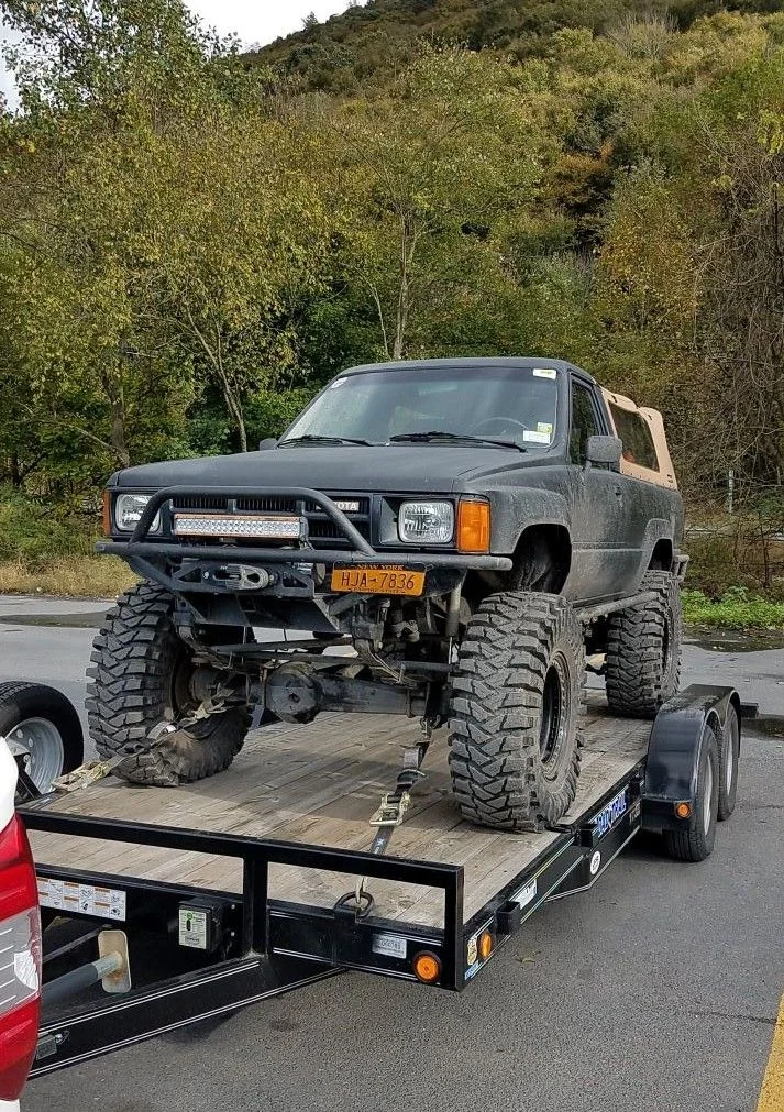

Loaded up for the trip home after a mediocre dinner stop

No huge issues for the group. I lost a couple inner beads, a 40 had a loose front pinion nut and unseated outer bead, @Stumpalama had sparks and smoke when high-centered and of course the sheered steering studs on the other 4Runner. Between all of us we had the tools and parts and snacks to get them fixed enough and back out without issue.

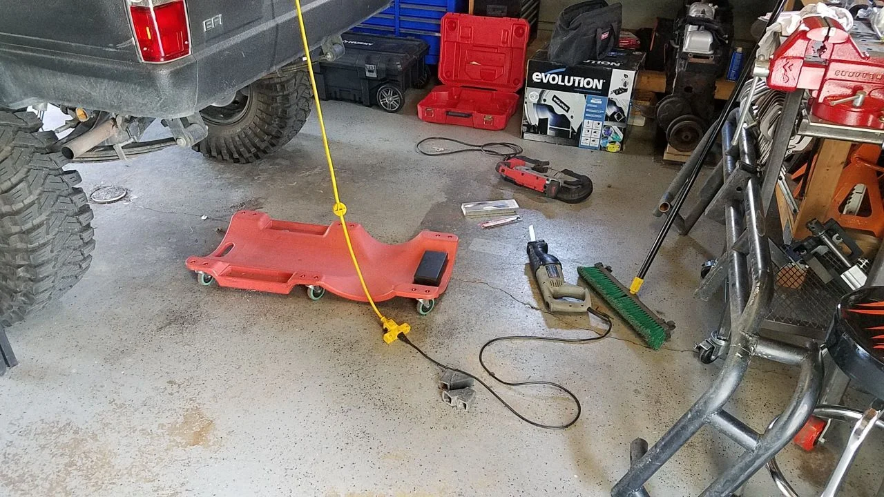

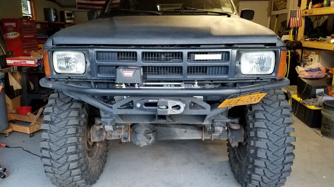

And this brings us up to today. I was never too much of a fan of the hoop on the bumper or the LED bar. So off they both went. Ground down the welds and DA'd the areas so you'd never really know there was anything there. Gives the front end a cleaner look imo.
2006663
2006664
...really need to get the garage straightened up.

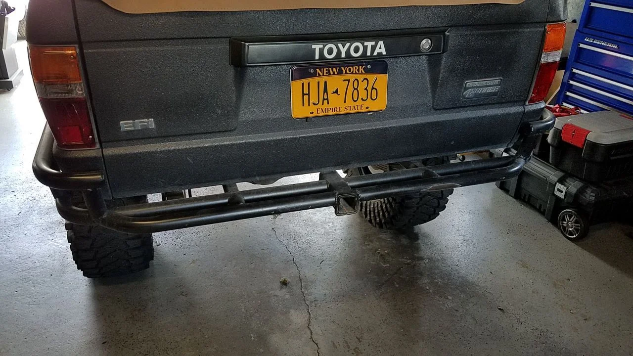

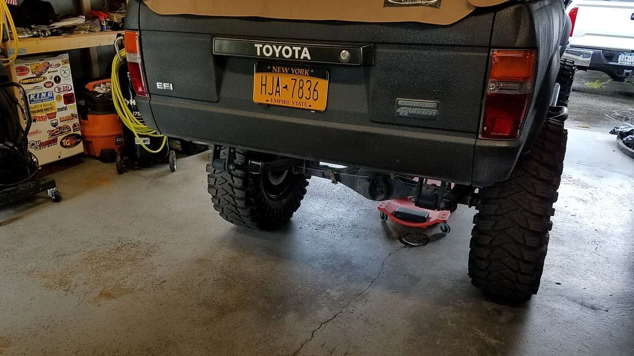

In much better news I removed the rear tube bumper on what was probably the hottest day so far with astronomical humidity.
Before
2023438
During
2023433
After
2023439
I like the style of the [old] bumper but its execution could have been better. Clean looking without anything hanging off the back end but protection is obviously needed. I started mocking up for the new bumper this afternoon. Stay tuned.

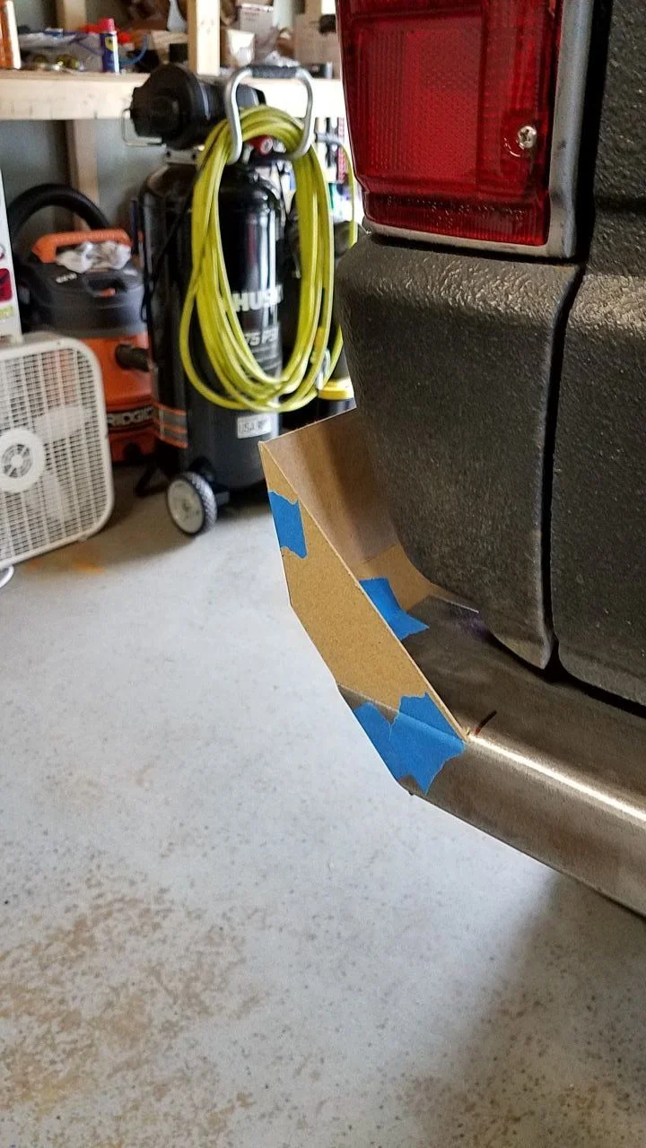

Took this past Friday off work to take care of some things at home and made some time to get started on the bumper. The main structure of it will be 2"x4"x.25" rectangular tube, with 3/16" plate for rear quarter protection. The current plan is to mount to the outside of the frame rails like most other first gen bumpers.
Ends are cut at 45* for the quarter protection -
2031437
2031438

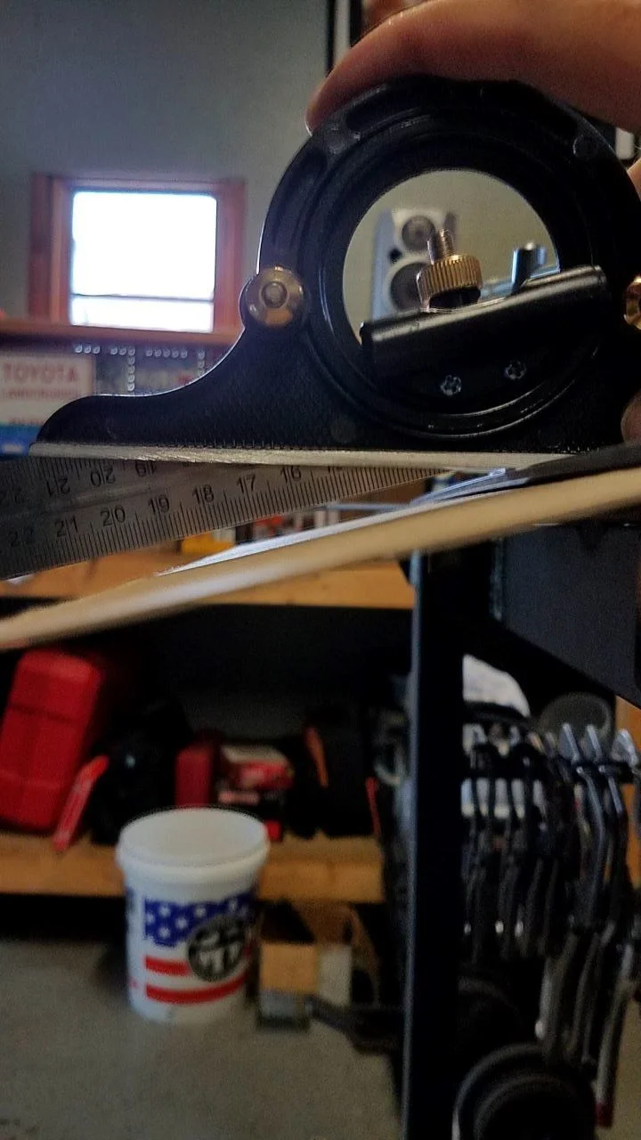

Cut with the Evolution chop saw are super clean and cool to the touch right after, much unlike abrasive saws. Burrs were basically non-existent as well.
2031447

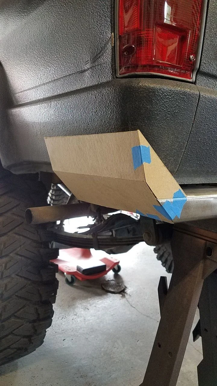

With the main tube cut down and in place it was time for some CAD work for the rear quarter protection. Out came the press brake and got to work -
2031449
Close enough for mock-up
2031450
2031451
2031452
2031454
The plate, as mocked up, is 10.75" from the rear of the bumper. Why 10.75" you ask? Because that's what I had on hand for 3/16. It was decided shortly thereafter to extend it 3-4" due to the unprotected gap between that 10.75" and the wheel well. A little later in the afternoon I stopped by the steel supplier for a piece of 12"x7'x3/16 plate. I always seem to want 3/16 when all I have is 1/8 or 1/4 so some extra never hurts.
The rect. tube is located 3/8" below the tailgate when closed. When dropping/closing the tailgate, that gap is about 3/16" at its narrowest. I'm planning for 1/2" gap between the plate and rear fenders. The plate will be braced along the bottom edge to the bumper mounts (on the frame) to prevent deflection.
