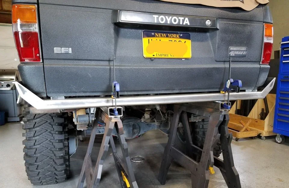

A lot of "Oh look at the bird!" moments apparently. Well 3 months after I first started mocking up the rear bumper, it's welded up. Not stuck to the frame yet, but I at least finally made progress.
...the DA really is the cherry on top.

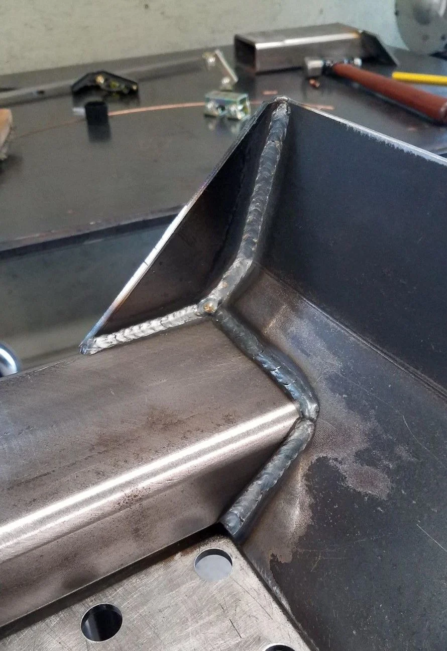

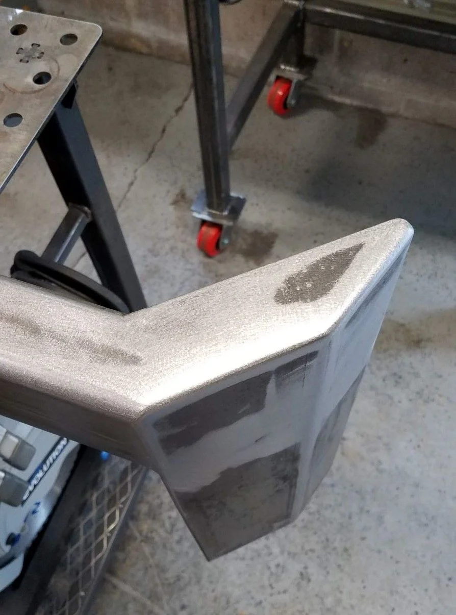

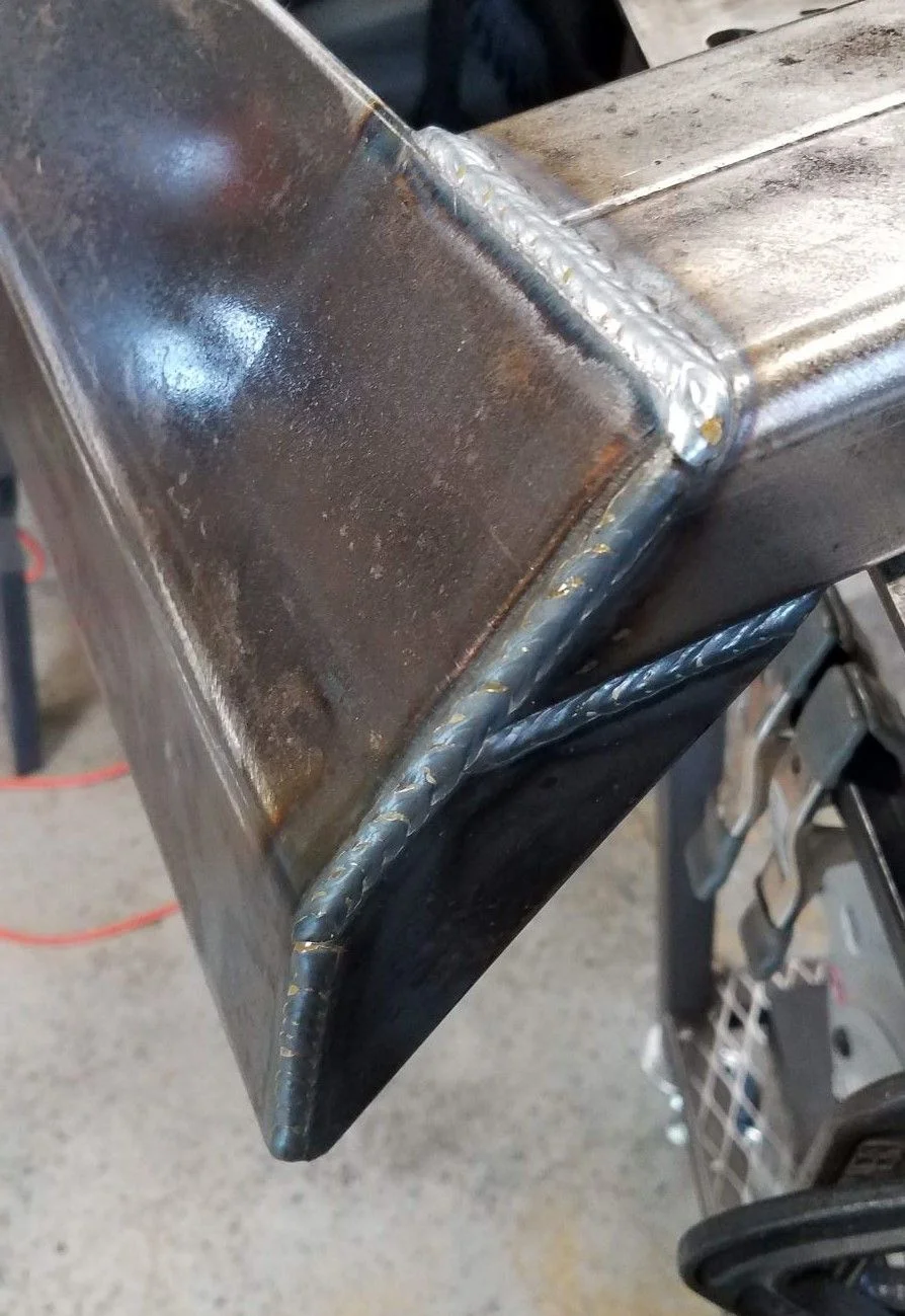

I farmed out the forming of the bumper wing thingys to a buddy. 5 minutes of work for him on a hefty 50+ year old break, was a lot better than me making a relief cut, check, tack, check, weld. I did plenty of that on the 'ol FJ40. Originally I had spaced the bumper 3/8" below the tailgate, but ended up kicking that up to 1/2". Gives a bit more clearance between the rear quarters.
As far as mounting to the frame, I'm torn between welding it directly to the frame (simple) or using similar brackets to all other first gen rears to bolt to the frame. Either way, the side wing things will be braced to the frame, either welded directly or using tube flanges, to prevent them from becoming one with the sheet metal.

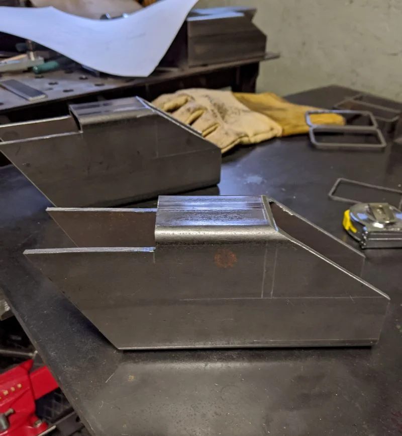

With everything being shut down and still owning the truck, I've gotten started on mounting the bumper. I cut up some 2x4x3/16 box tube for the main supports. The reliefs on the left side will accept the 3x3 rear frame crossmember. The ends will be capped and tie up into said crossmember. The right 2" end will be welded directly to the bumper, top side capped and tied into the top of the bumper. There will also be another scab plate on the bottom tying the two together. Just need to cut a couple more scabs and it'll be time to tack everything up for final check.
