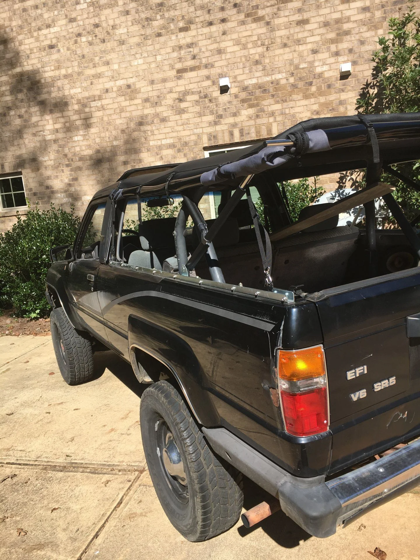

Soft tops are worth the spend.
Yes, but not super high on the list right now. I’ll get a bikini setup or get my upholstery guy to sew a full roof only type safari top first. When funds allow, I will revisit the soft topper. I sense a 3.4 swap will be first...

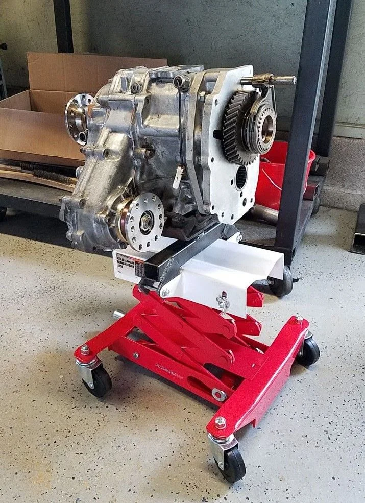

Rewind to July 4 of last and in the spirit of freedom the transfer case split from the truck and landed on the workbench. It was finally time to install that set of Sumo 4.7 gears I've had on the shelf over a year and a half. The dual 2.28s were decent, but there were times I wanted something not as deep and also something deeper.

Also installed in there is an RCV chromo mainshaft. May have been a silly expense, but some extra beef is [usually] never a bad thing. I really appreciate how simple these cases are to work on.

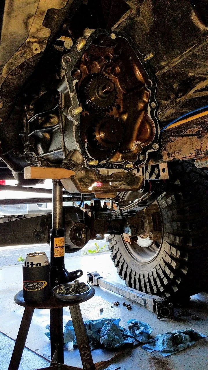

Re-installation was an adventure. Dual cases aren't all that heavy but when you're sitting under the truck balancing the cases on your shoulder with one hand and the other hand is trying to align shafts and shift rails...there's gotta be a better way. So I took a fairly useless HF trans jack, a worn out t-case mount and some scrap steel...and made happiness.
2000828
Buttoned everything back up and eagerly set out for the first test drive. Needless to say I was bummed and panicked when I couldn't shift the rear case into low. Test shifting on the bench went well, so my mind immediately went to "I f'd something during reinstall". Turns out things just need to get settled in and it shifts like a dream. Like every other mini with dual cases and 4.7s...it's been a game changer.

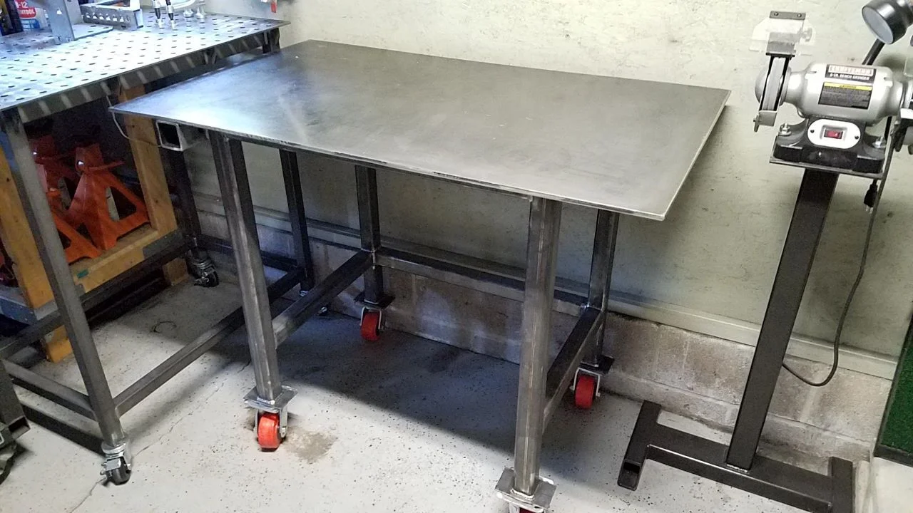

Shortly after the gears were done I was finally able to tackle the long-awaited rebuild of my do-all table. It was my first actual welding project way back when, and with time and use I found how it could be improved upon. Clamping anything to the top was generally a pain as I only had a 2" overhang on three sides, and having the shelf on the bottom didn't help my flat space syndrome.
All framework is 2"x2"x3/16" sq tube and the top is reused 1/2" from the previous version. Tube was stacked and cut in a bandsaw so lengths were identical. The 3-way corner jig from weldtables.com was a huge advantage.

And done. Tabletop height is ~36" and would be very level if my garage floor wasn't cracked and sloped as much as it is.
