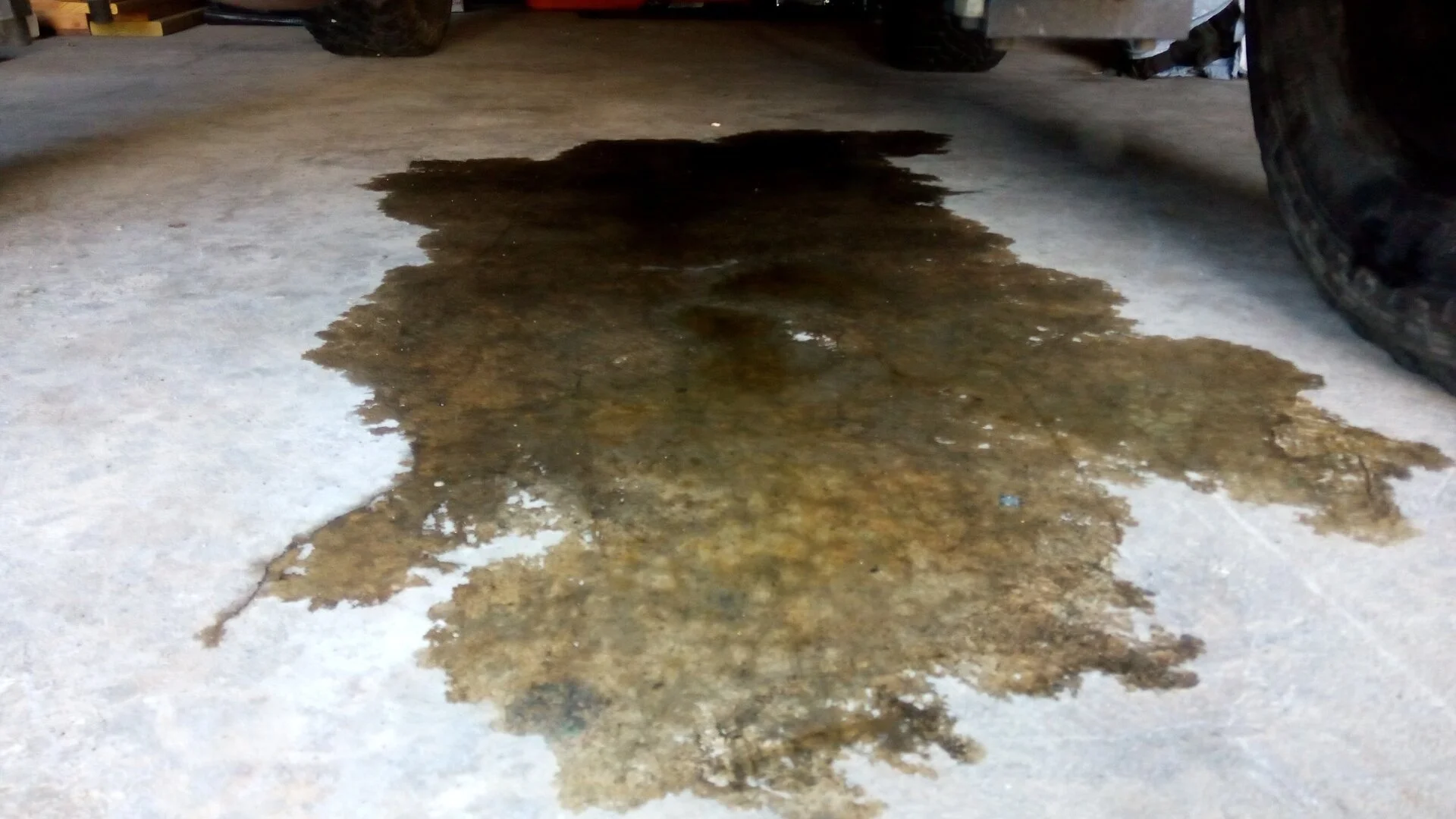

Reinstalled the oil pan last spring and basically parked the truck. Been driving it a bit and it started to leak. replaced the crush washer and leaks just sitting there. Im talking puddles not a drop or two. Would O-rings help? Double up the washer?? Looking for ideas..
Thanks, Jim
