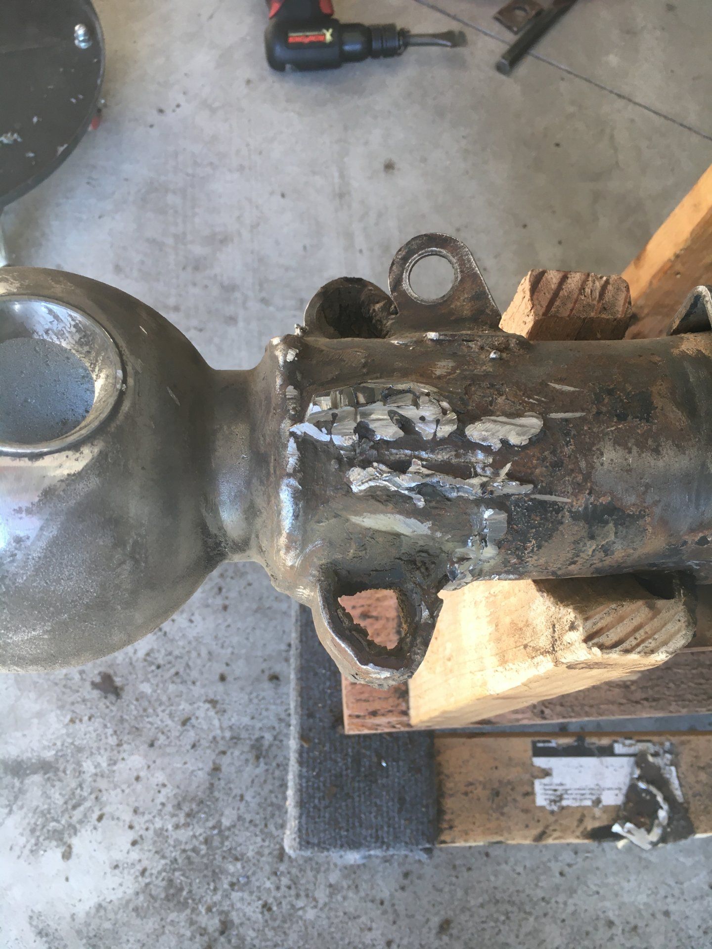

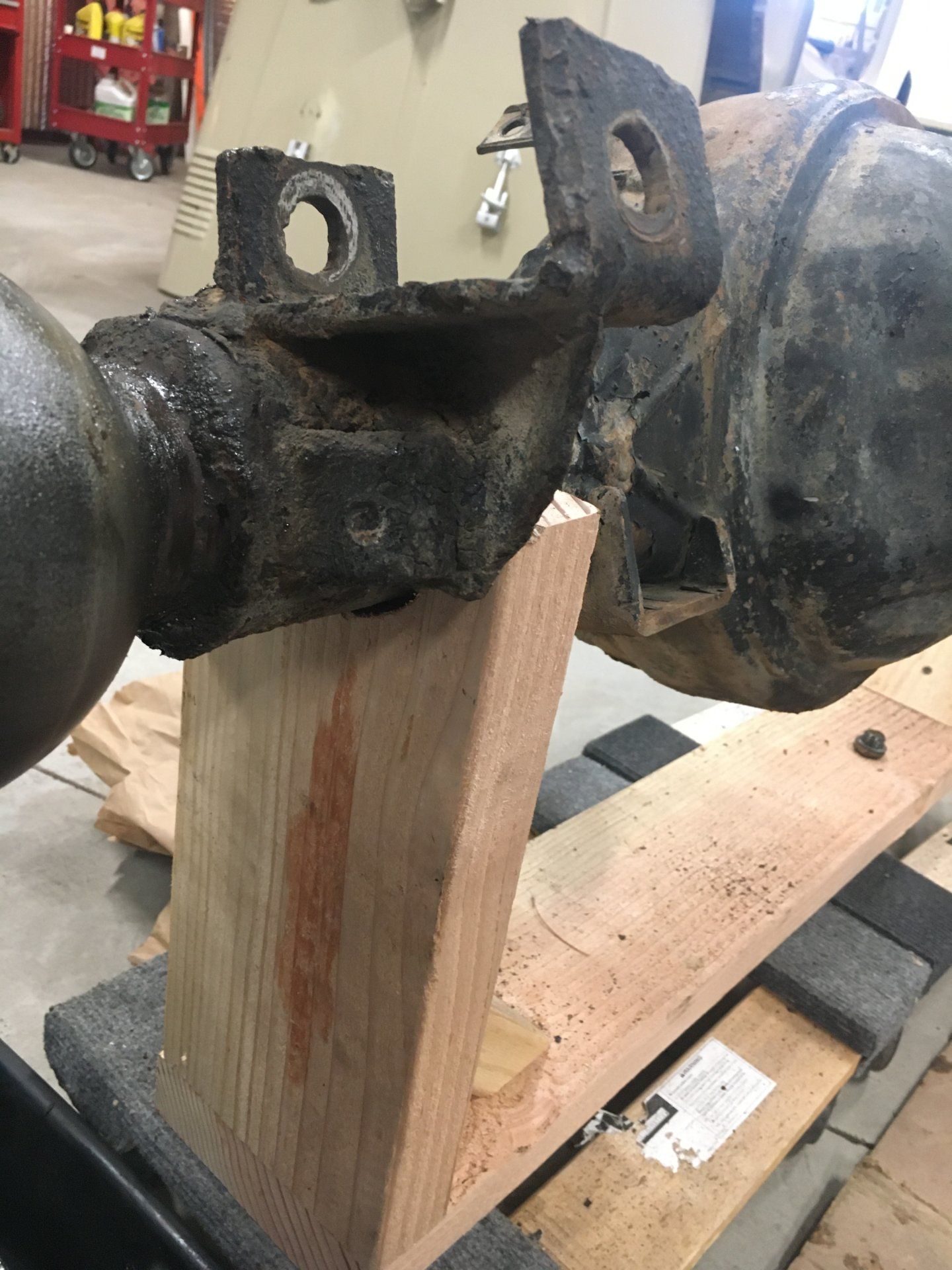

Rear axel is ready for seals and assembly. The front axel will need some work. These bush mod shock supports must go

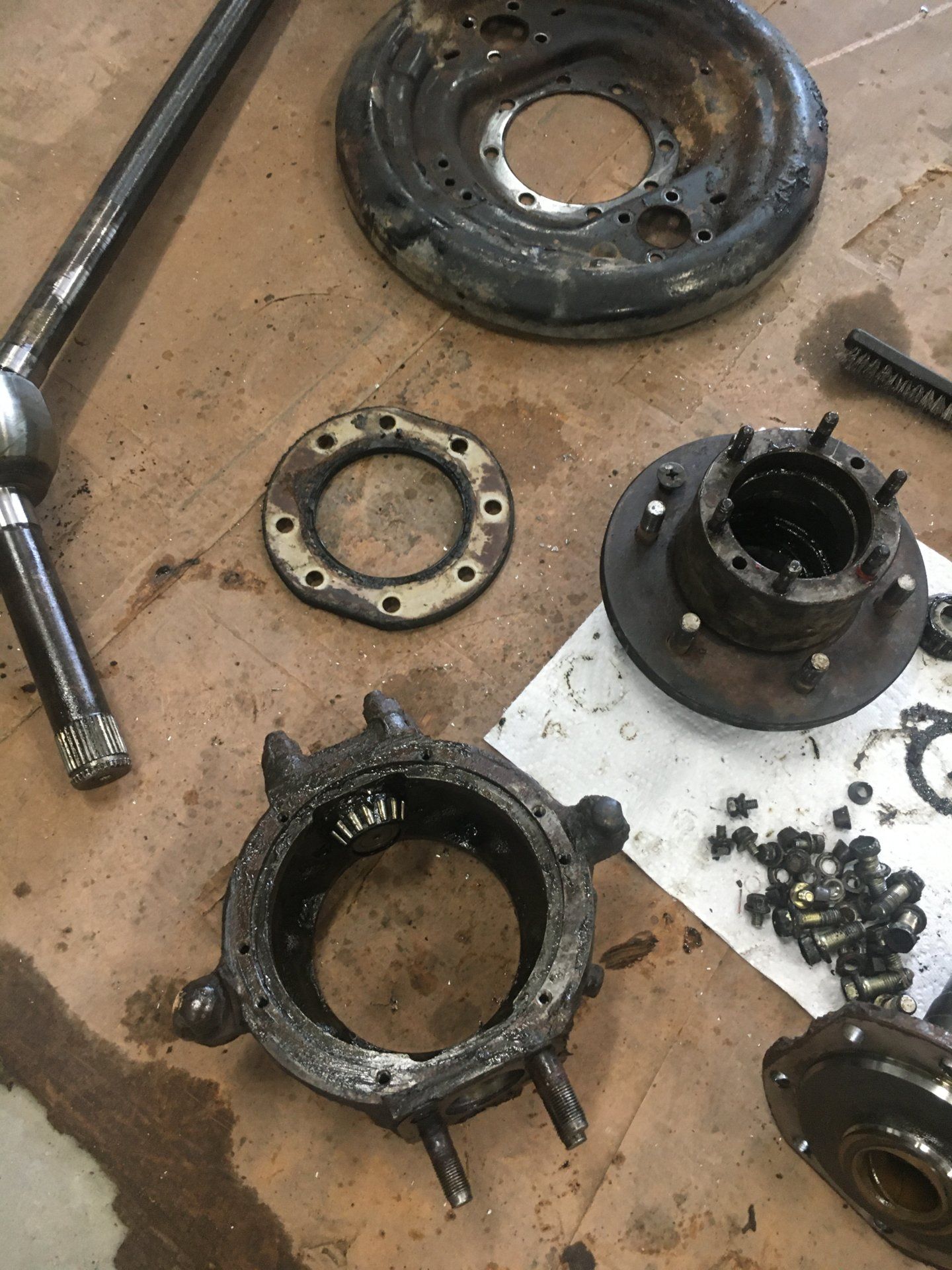

So I finally figured out a better way to remove those pesky cone washers in the hub. Mine was full of RTV and gunk.
cleaned with wire hand brush and WD 40.
Then tapped the studs with brass drift at the tip of the stud to max leverage.
Then tapped the hub casing with a two hammers on opposite sides and worked my way around ( much like removing tie rod ends)
results -first one took 60 minutes, last one took 15 minute......

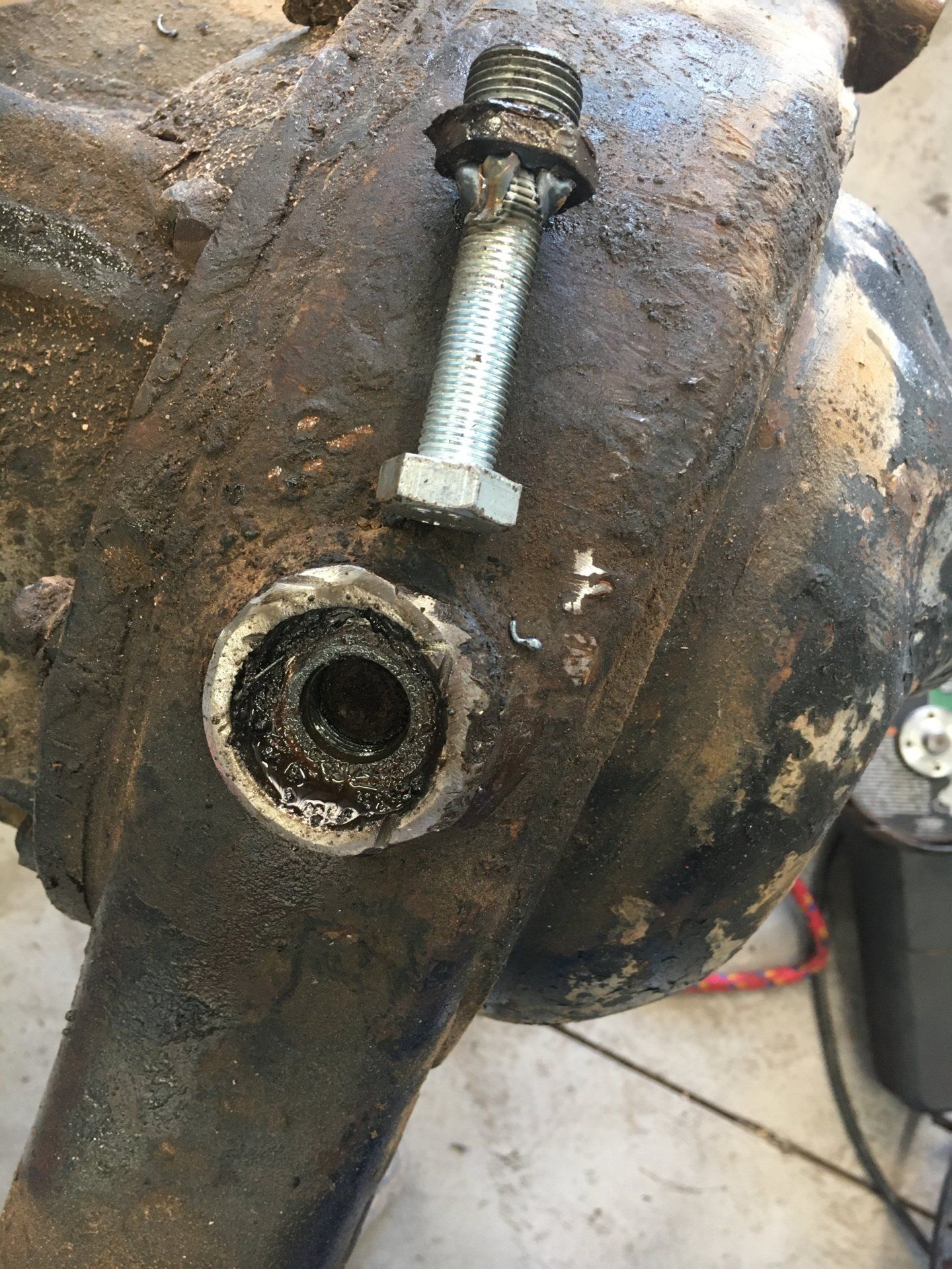

There goes 90 minutes I didn’t plan on. For some reason all of the drain and fill plugs for the axles and transfer case we’re completely chewed up this is the last one to get out and it did not want to go.
Time for a break.....

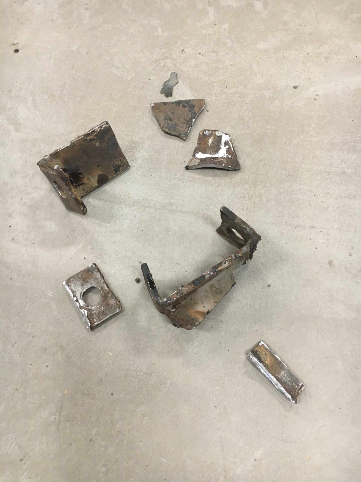

Finished removing and cleaning up the aftermarket shock mounts. Those things sure weren’t going to fall off by themselves!
When I remove cone washers I leave the nut on just in from the edge of the stud. Then I use a brass punch on the end of the stud. I do not tap the end of the stud but hit it hard. It's the shock that causes the cone washer to pop loose. Keeping the nut on will clean the thread on the tip of the stud when the nut is removed.

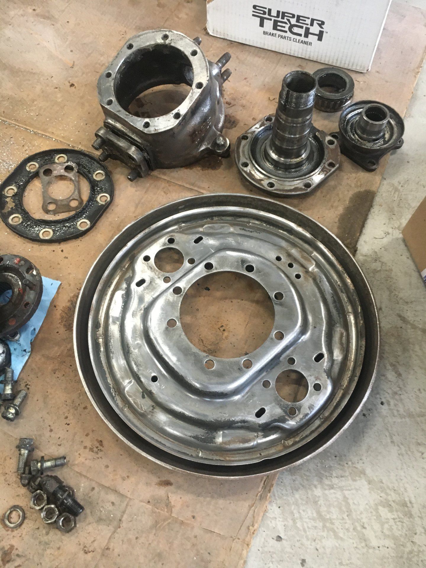

Sometimes I feel like an archaeologist, Lots of digging but finally got the last of the really dirty parts scraped clean. A little final cleanup then I’ll be ready for paint. New parts are starting to trickle in which is always exciting,

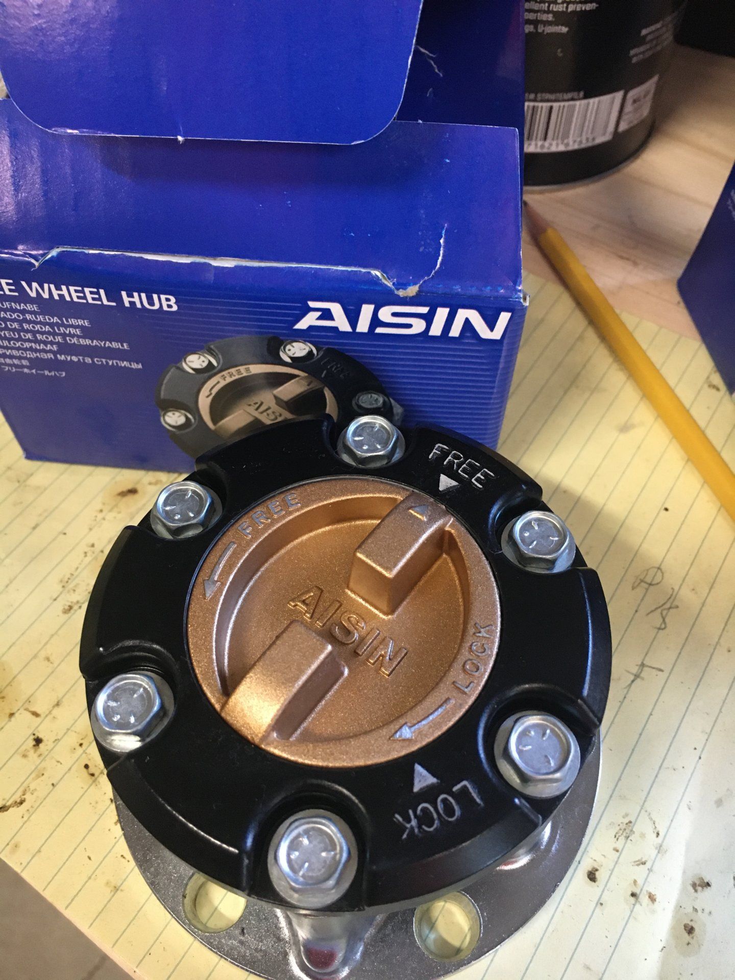

I’m not sure if I should stay with the stock hubs or install some Warn free wheelers, any thoughts?

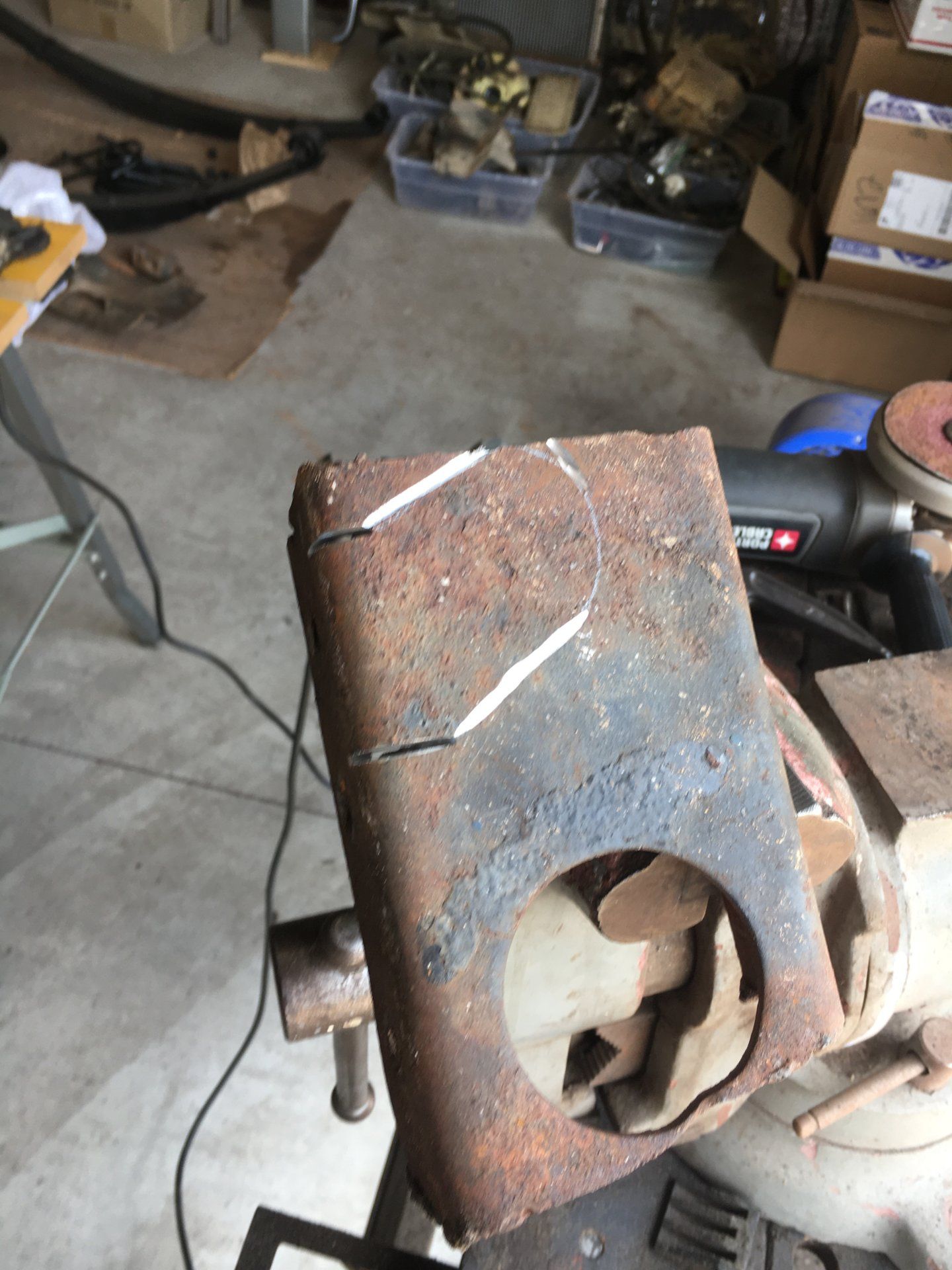

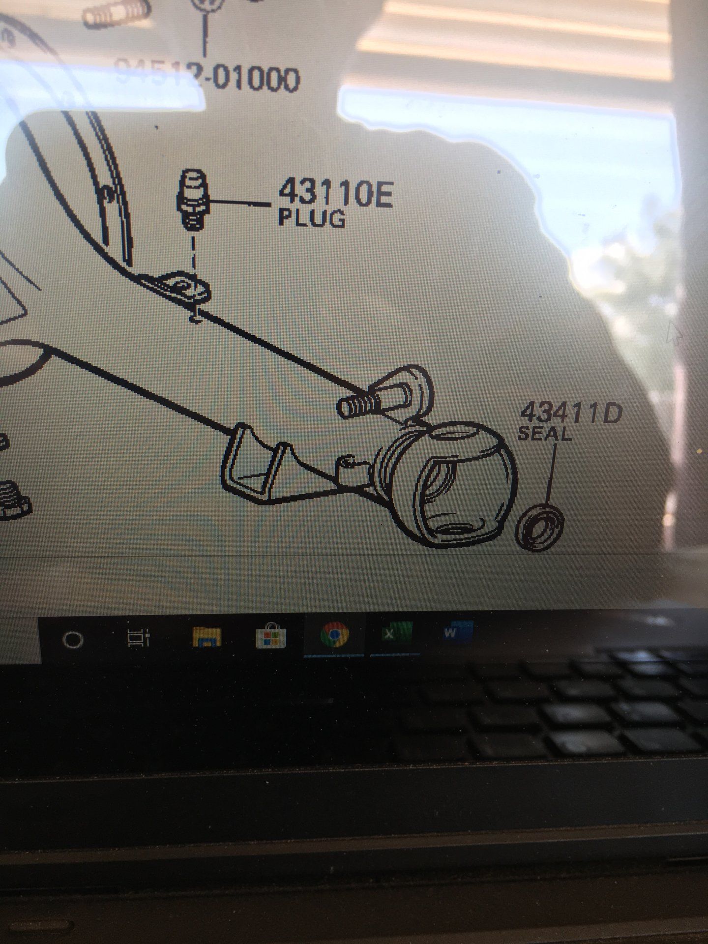

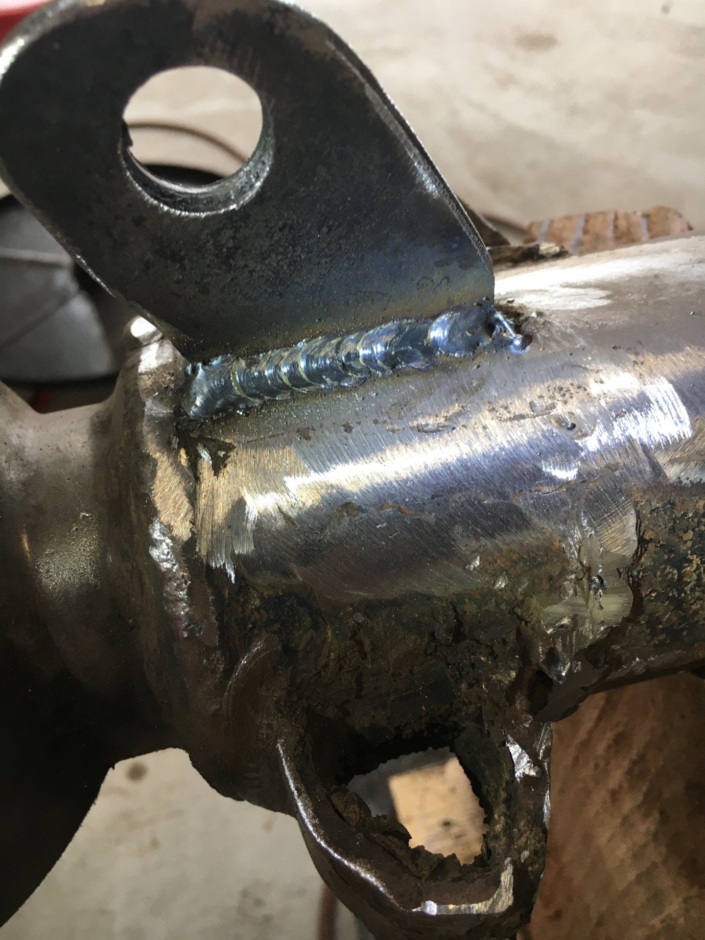

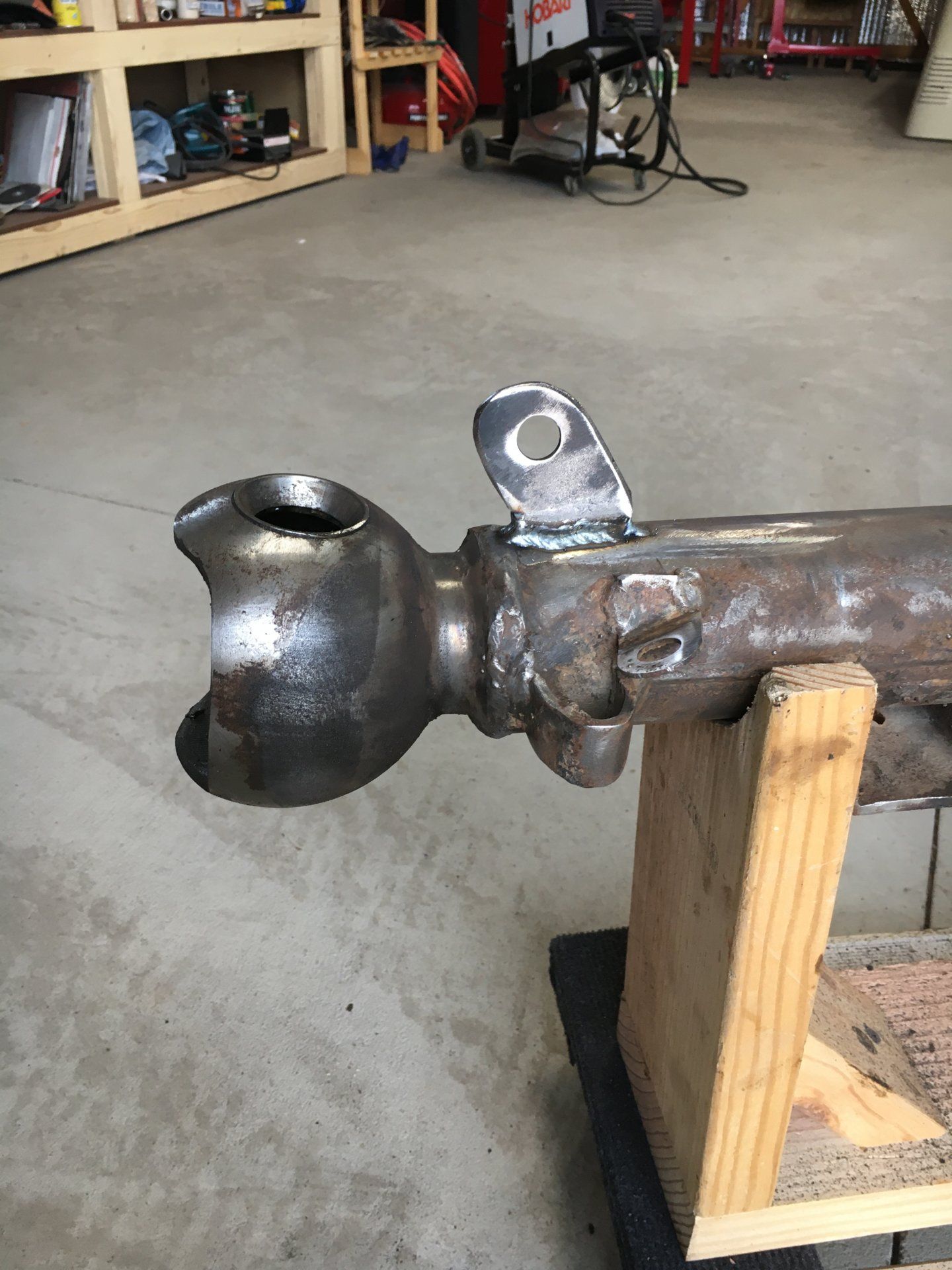

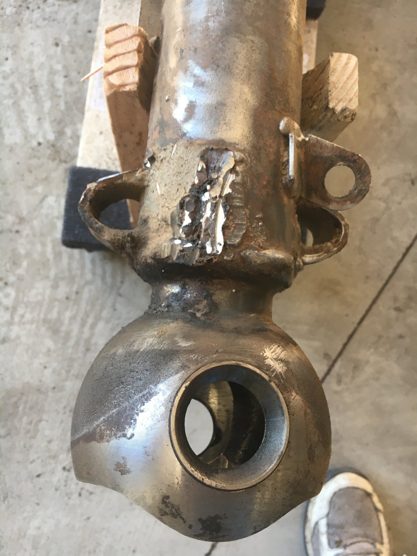

Finished cleaning up the front axle, and made my best stab at fabricating factory style lower shock mounting tabs. From the drawings and photos I saw this is how the axle should’ve been configured.
The donor front crossmember I received still had some chunks of the frame attached, I was able to cut my tabs out of that steel since it’s about the same thickness and came from the same factory, I know score
Parts are starting to come together and hopefully I’ll be able to start some real reassembly on the frame and suspension next week.

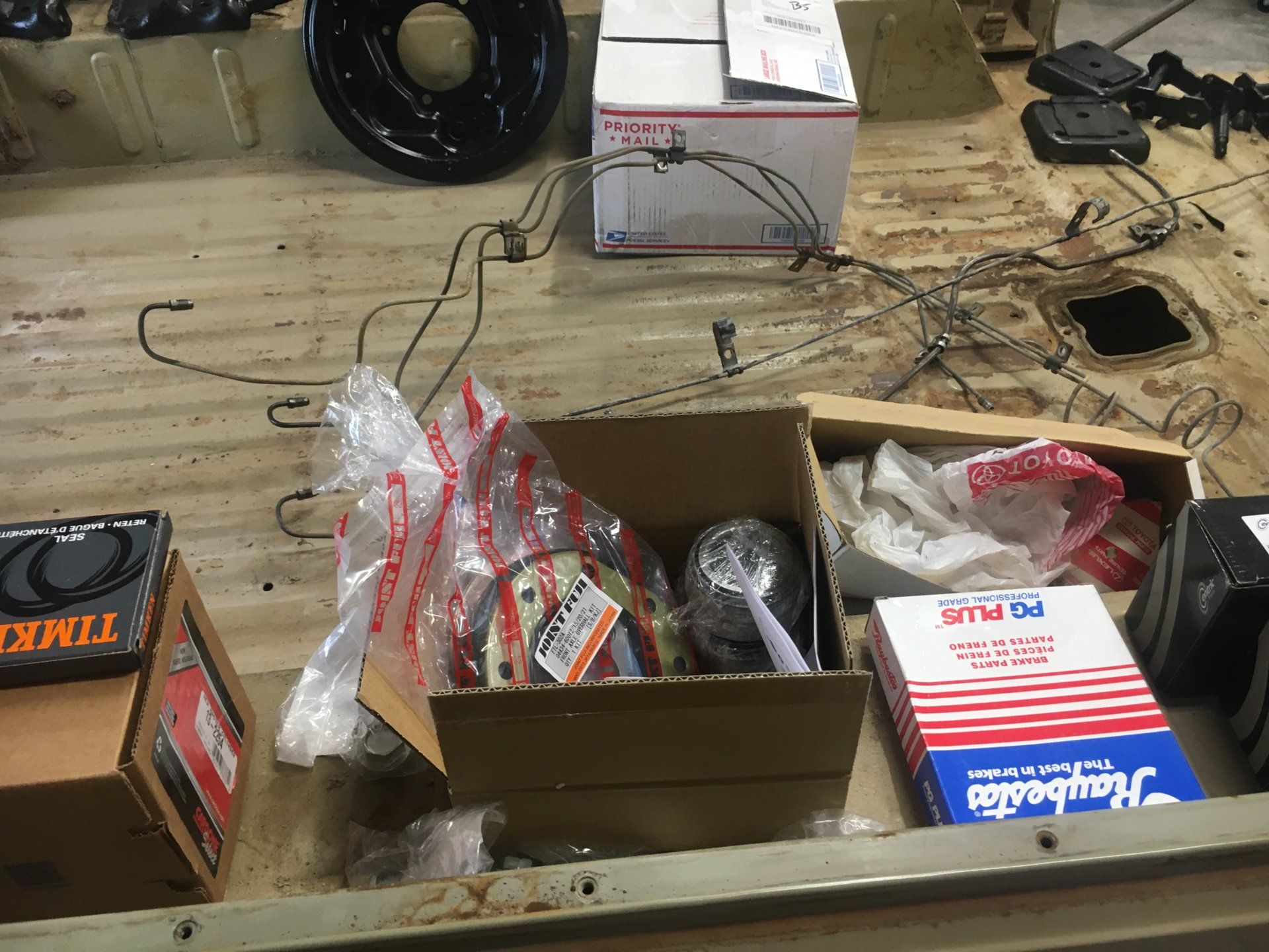

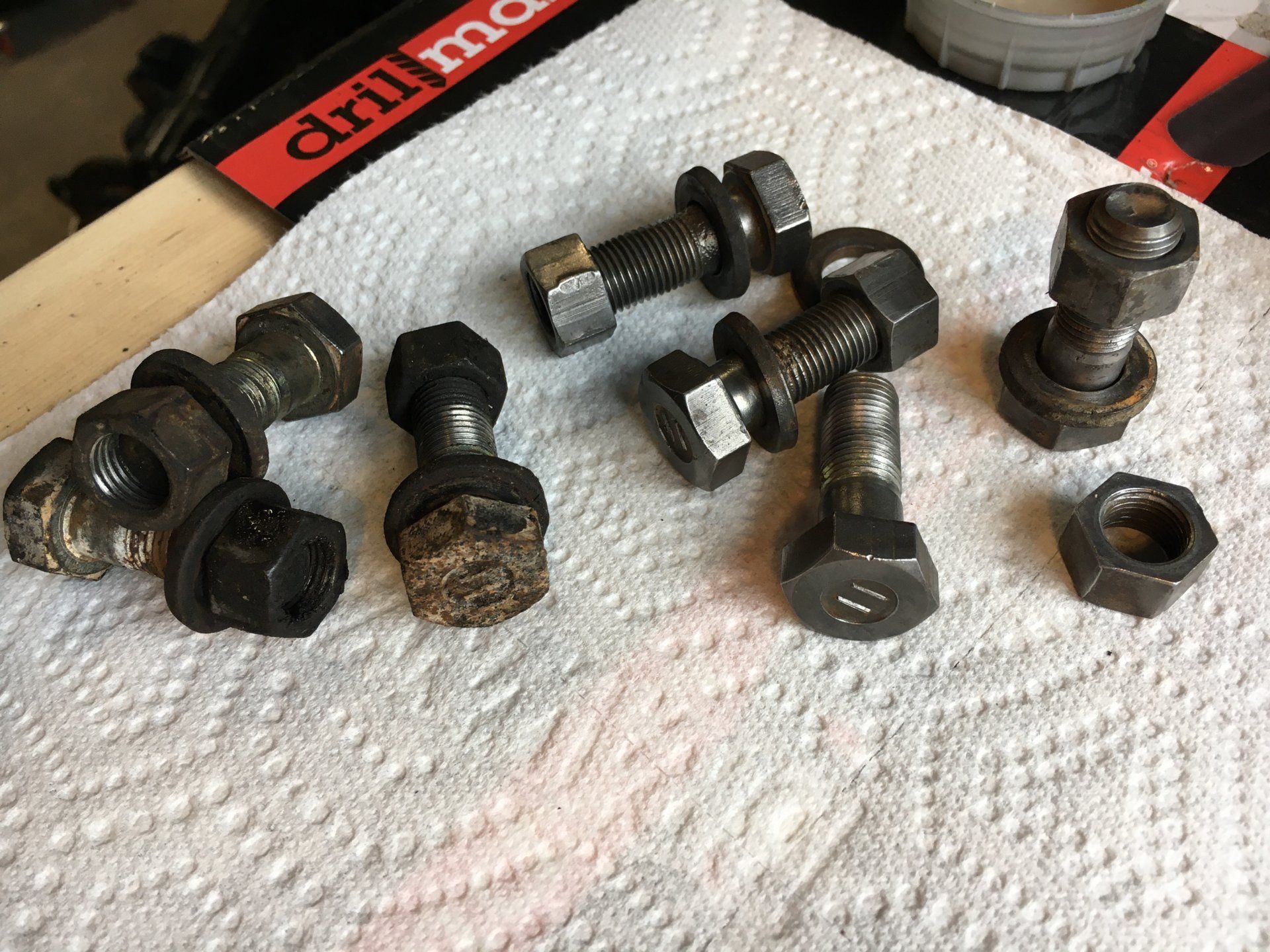

So many of the factory nuts and bolts were damaged and I didn’t really want to spend the Time and money and piece meal replacement and then having them all plated so I splurged and got a big box from Overland metric, nice set up really look like factory and it really finishes it off to have that bling
I also picked up a pilot bearing removal tool to take out the inner seals, a real lifesaver two minutes aside and they pop right out

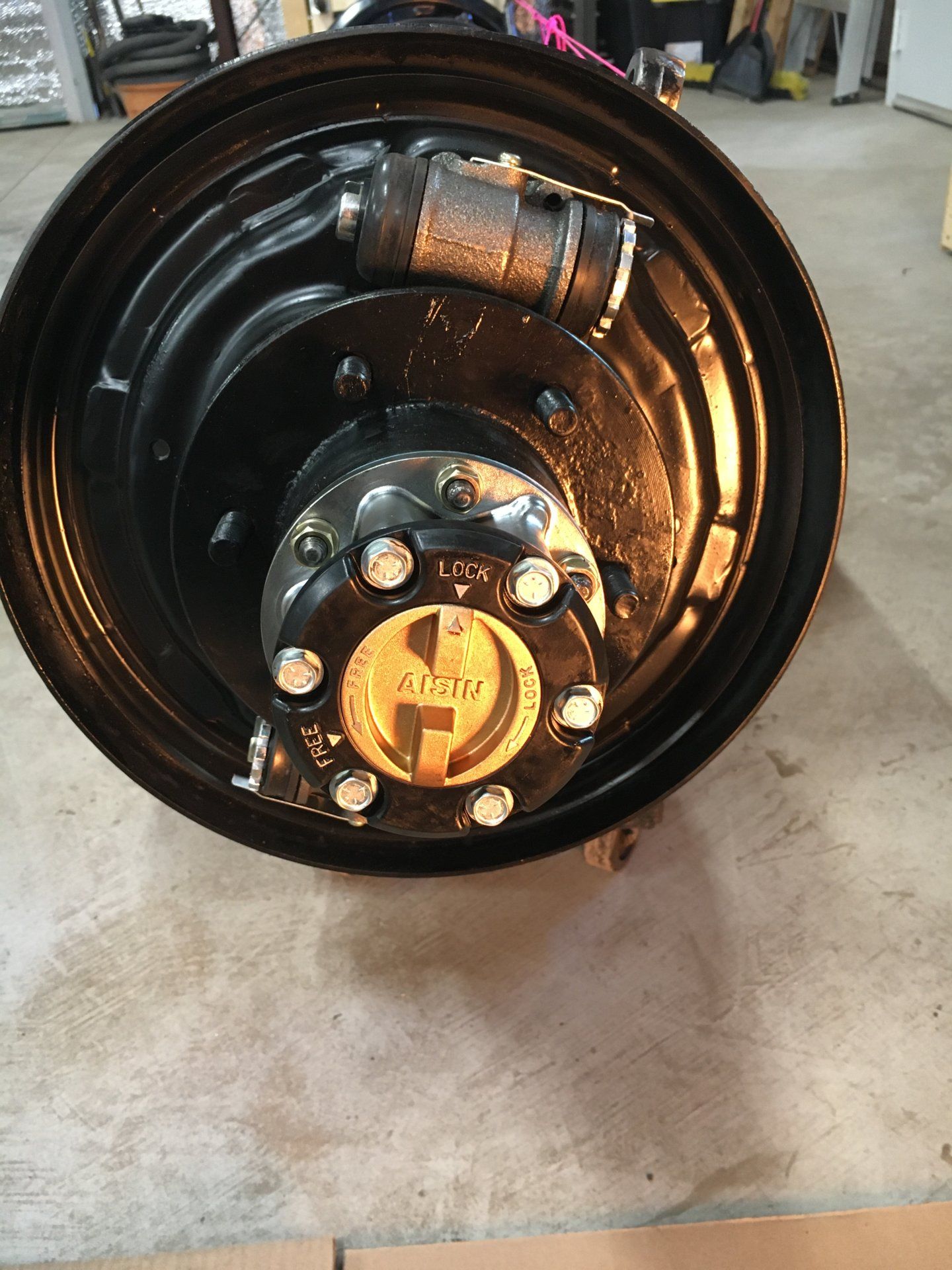

A very nice surprise I was not expecting so quick, my new hubs arrived in the mail really love the look and so glad I’m replacing the full-time hubs

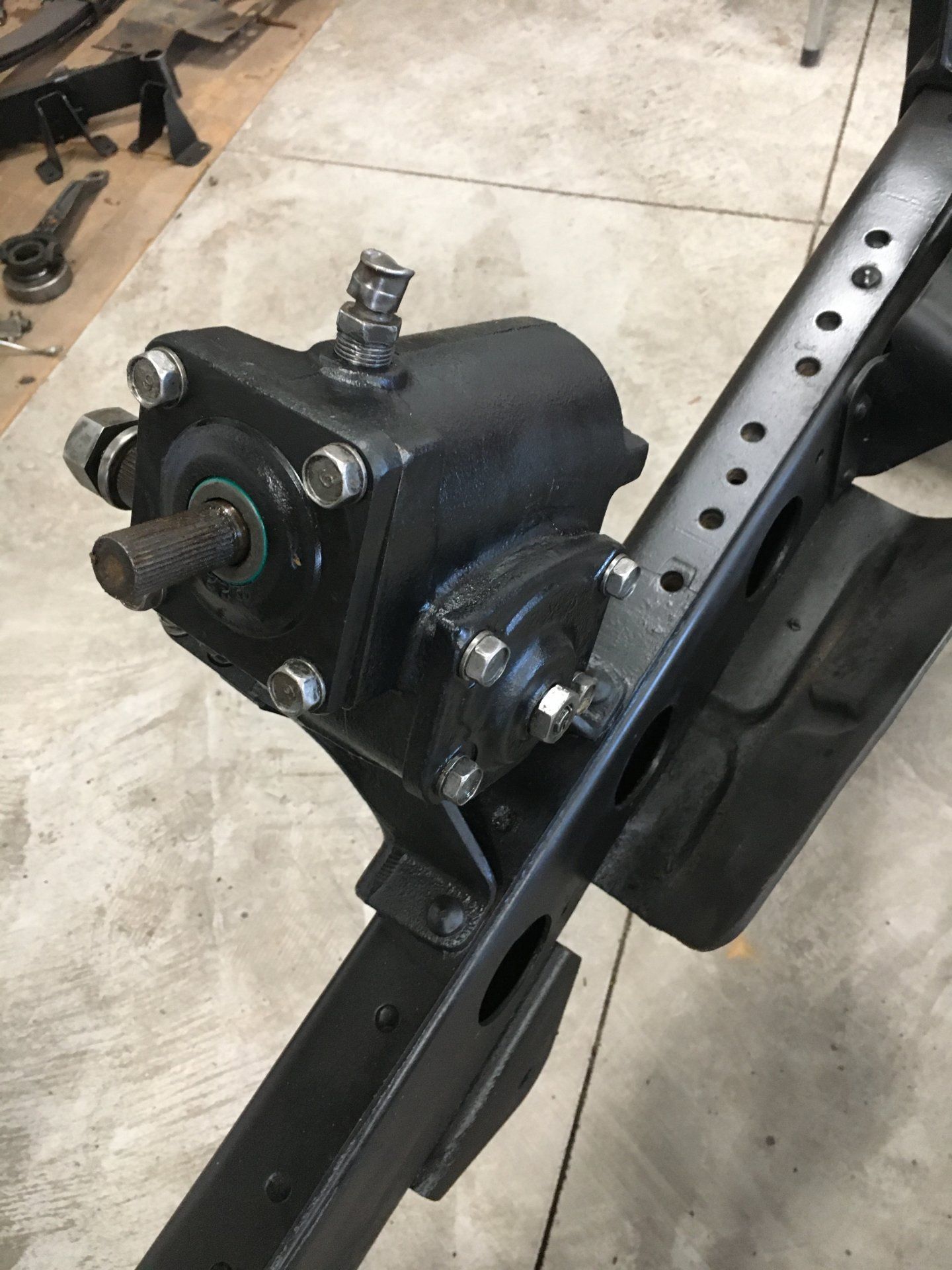

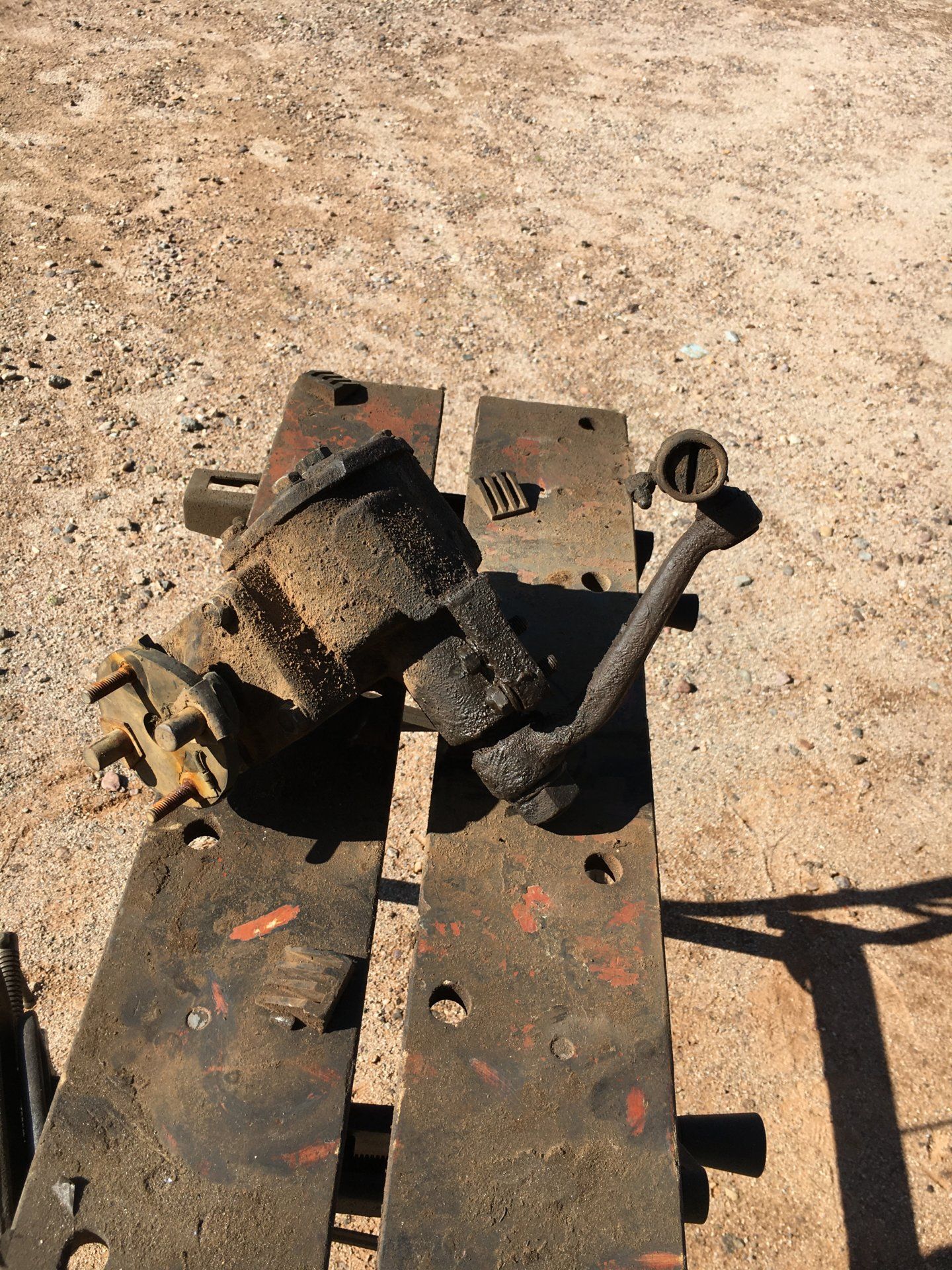

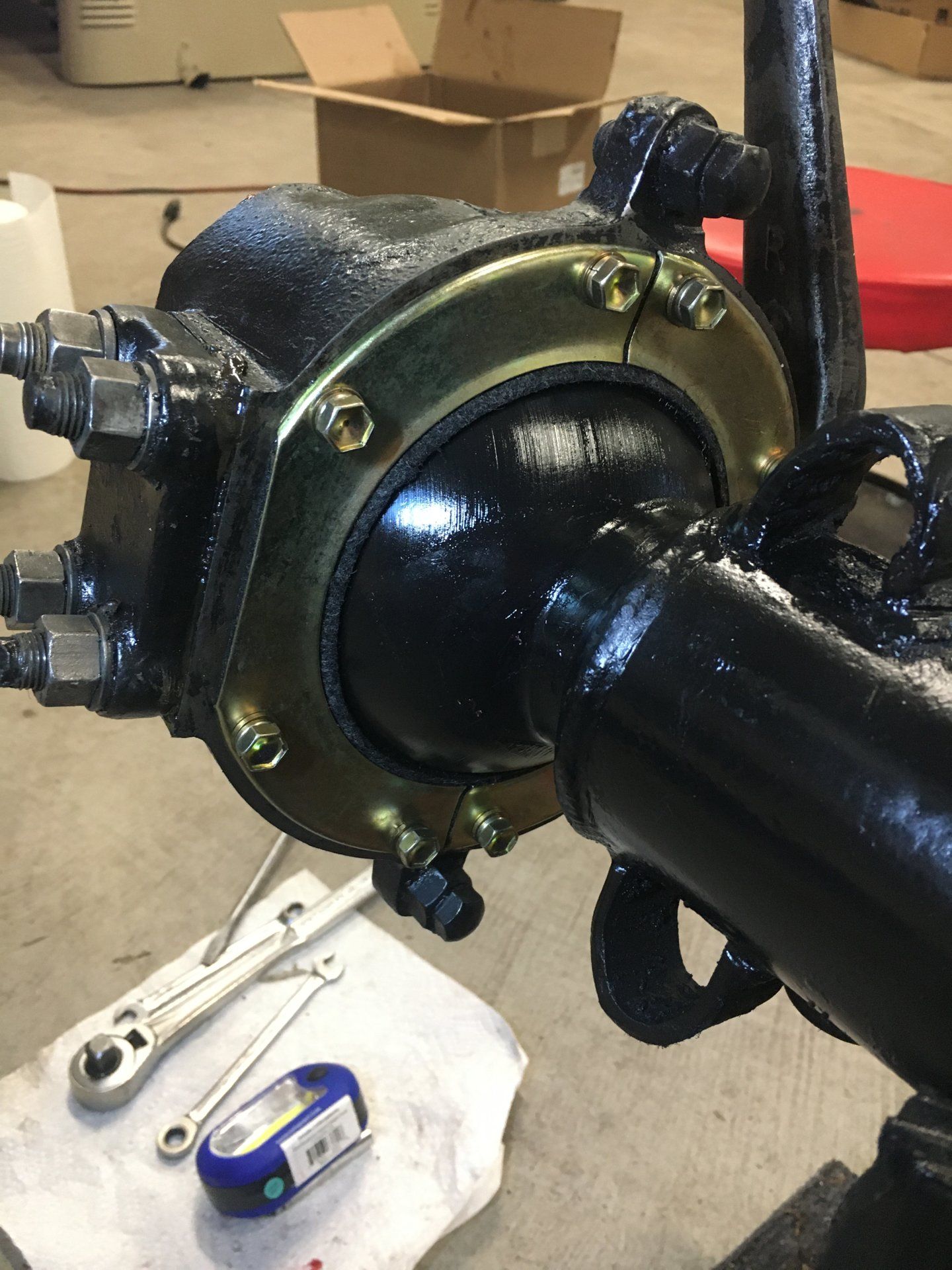

The steering gearbox is all cleaned up and ready for reassembly just waiting for the seals.

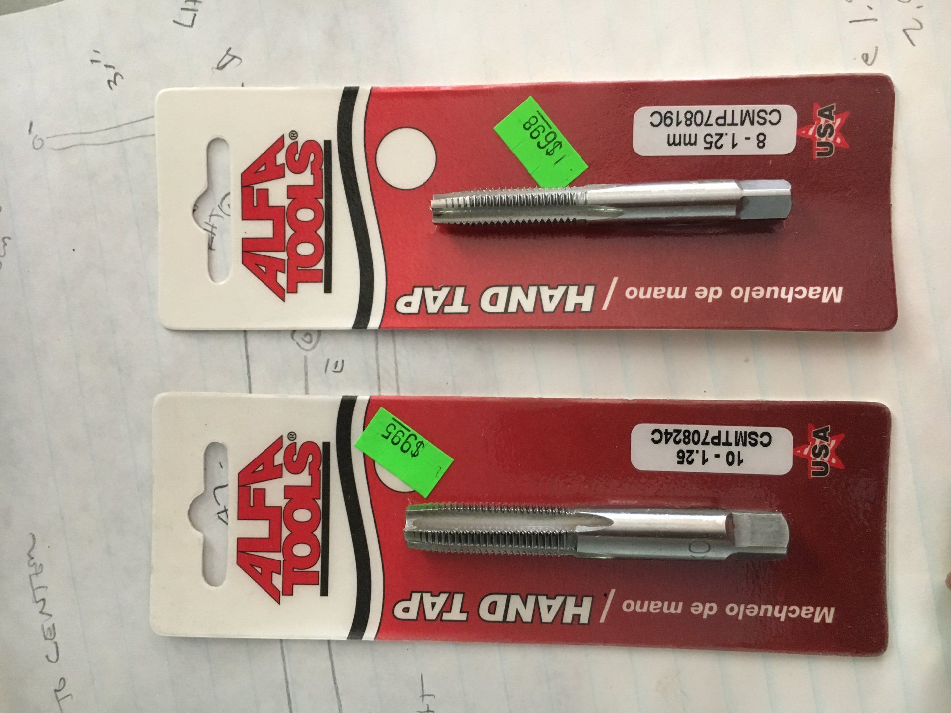

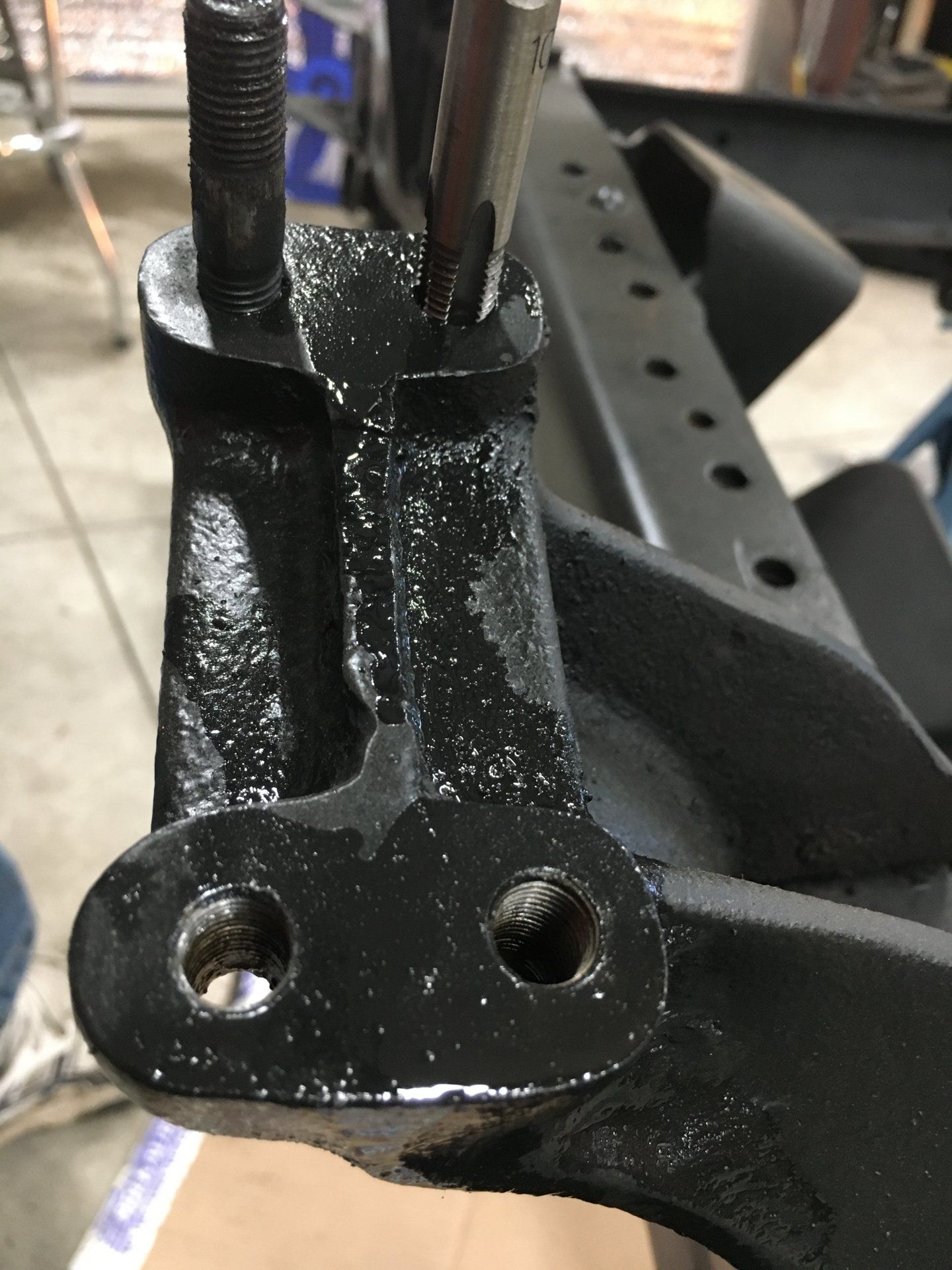

Luckily I was able to find the correct tap at a nice little local shop so I can chase the threads in the chassis.
I absolutely love the new hubs what is satisfying installation

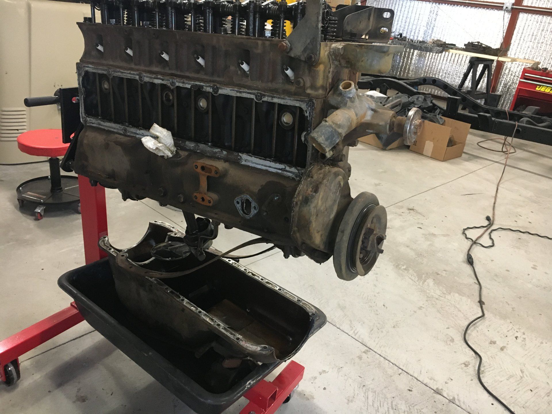

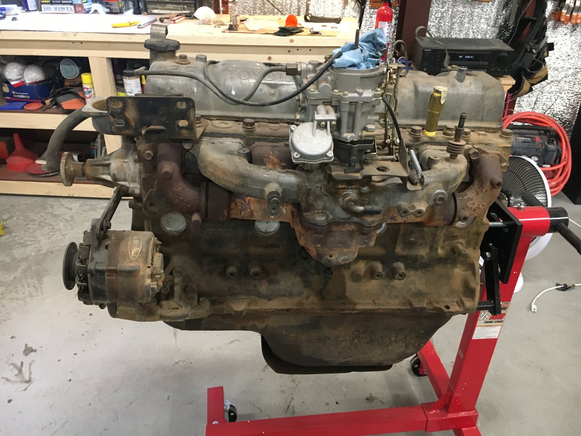

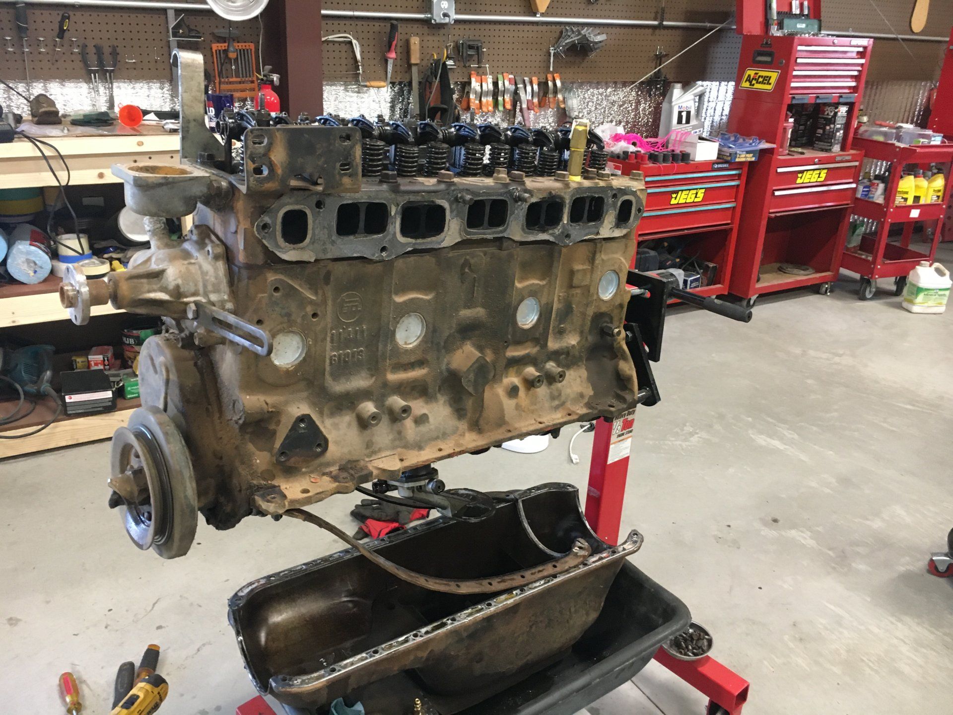

I was hoping to get the leaf springs and axles back in place but hit a snag getting the necessary bushings in time while I’m waiting for that to get sorted out with the vendor cleaned some threads and started installing the parts that were ready. Plus I resealed and inspected the transmission and transfer case. I’m looking at the engine and not sure how much I want to tear into it definitely replace the seals I can and the freeze plugs. Since it’s running strong I don’t think I’ll take the head off
So far so good, no script or busted bolts just some pretty thick gasket sealer in a few spots. Luckily the oil pan dropped right off I’m taking a break before I tackle the water pump that’s the one I’m a little bit worried about
