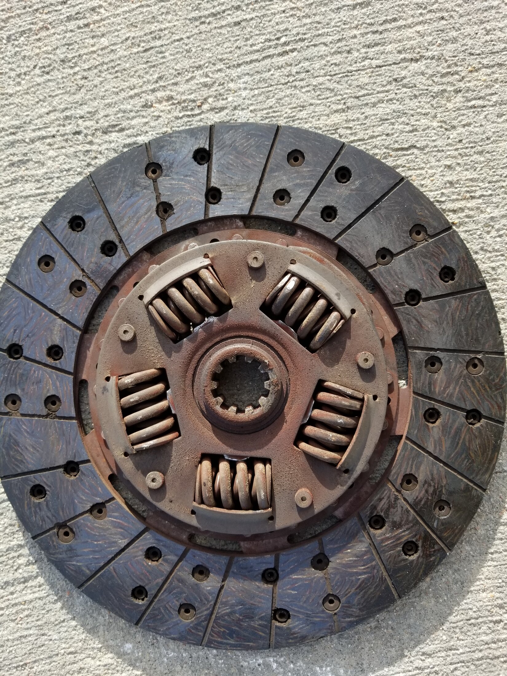

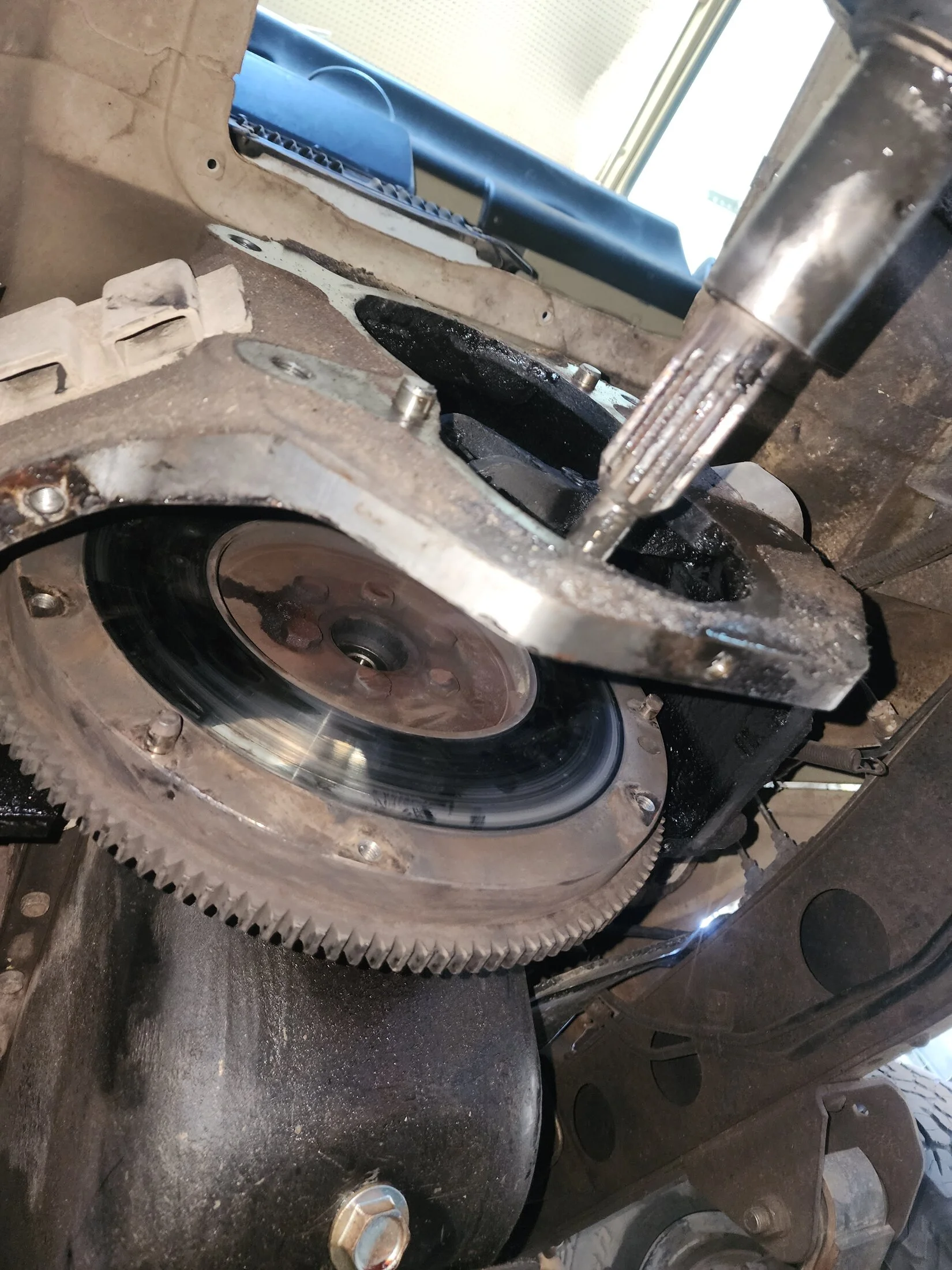

Pic of clutch pressed and depressed.
Apparently trans input shaft has been leaking for a while.
Fluid is full and fairly clean. the backside of the clutch plate from what I can see is also completely dry.
Any thoughts?
Clutch pedal up:
Clutch pedal down:
Ok so now the engine runs great - idle to full rpm's. So there is clutch adjustment at slave cylinder and its correct. You bleed the system, yes. Well I think the clutch disk is shot. Look into pilot and throw out bearing, clutch disk, pressure plate, maybe rear engine main seal. You might have a bad seal between tranny/transfer, there is a by pass hose that lets the pumped up to tranny fluid return to transfer. But if you are taking the T/T out put in the seals.
I have seen input shafts to tranny broken, it might had enough interference to transmit power for a while due to uneven break.
Is there slack in the clutch pedal, or is it completely tight when you press it? There should be inch-ish of slop in the pedal.
Is the transfer case in neutral?

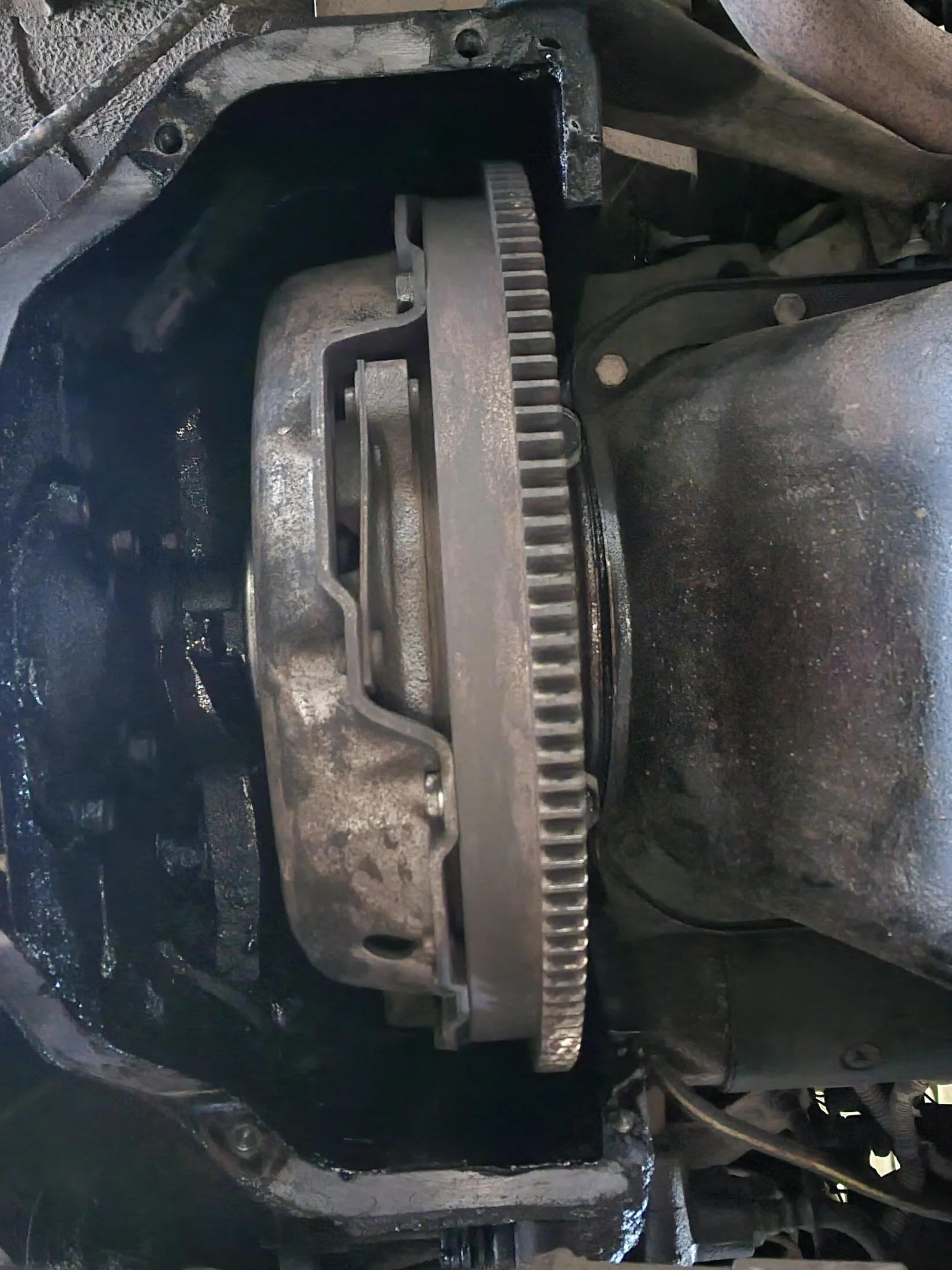

My son destroyed the clutch in my 68 some how. Only thing I could think of is he held pressure on the clutch pedal that allowed it to slip a little and glazed the flywheel and pressure plate until it couldn't grab the disc. I would set a mirror under the inspection cover opening in the bell housing. Then with a person at the steering wheel and another off to the side while running, foot off the clutch pedal and in gear verify the pressure plate is spinning. If so if the pressure plate spinning you either have a clutch disc that's slipping or issue with the transmission input shaft. Either way you are going to have to pull the transmission and transfer case. If the pressure plate isn't spinning you have a major problem with the crankshaft. Less likely for the crankshaft to have a problem.
Thanks, Yea the pressure plate appears to be spinning

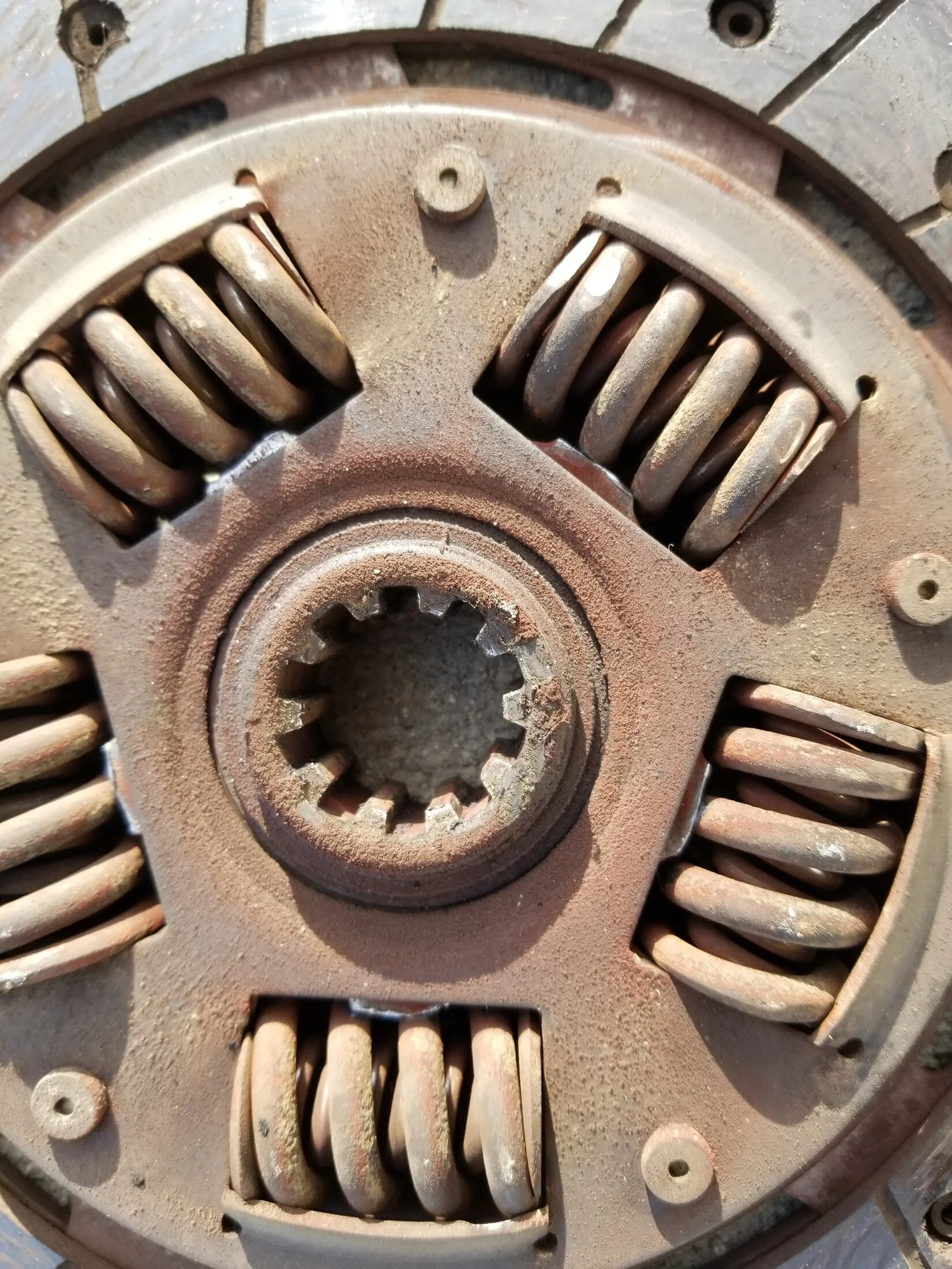

I have had a clutch disc fail between the splined center hub and the springs. Tough to diagnose until I held it in my hands and found that I could rotate the splined bit with pliers

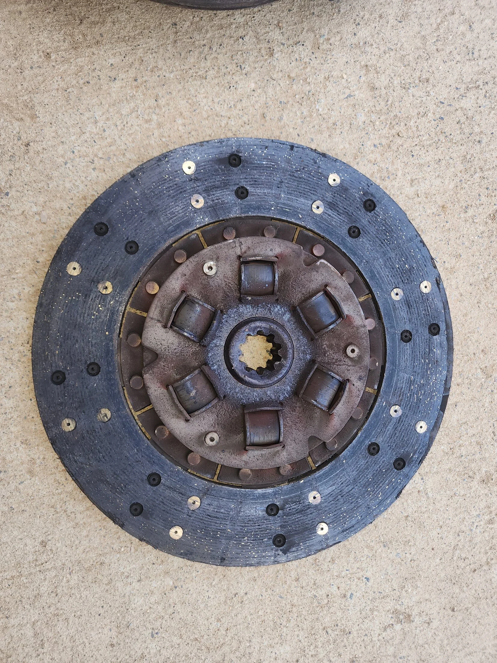

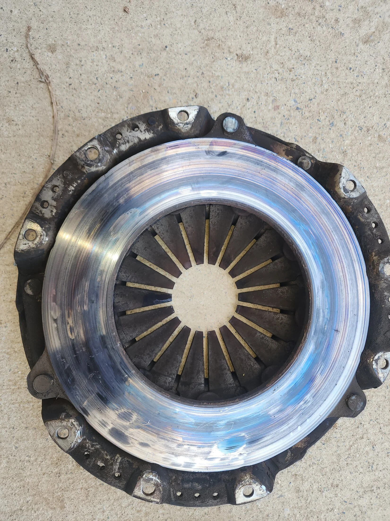

Clutch disk is worn down to the rivets in many places. Input shaft splines look a little chewed, pilot bearing area looks corroded too. Pressure plate has some hot spots and some damage.
