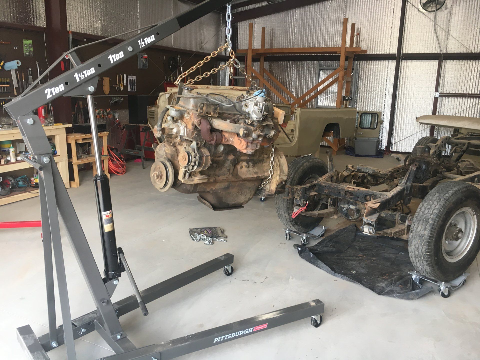

Well I got the old girl out, nothing broke or fell, but she got so excited when she got out she had a little accident

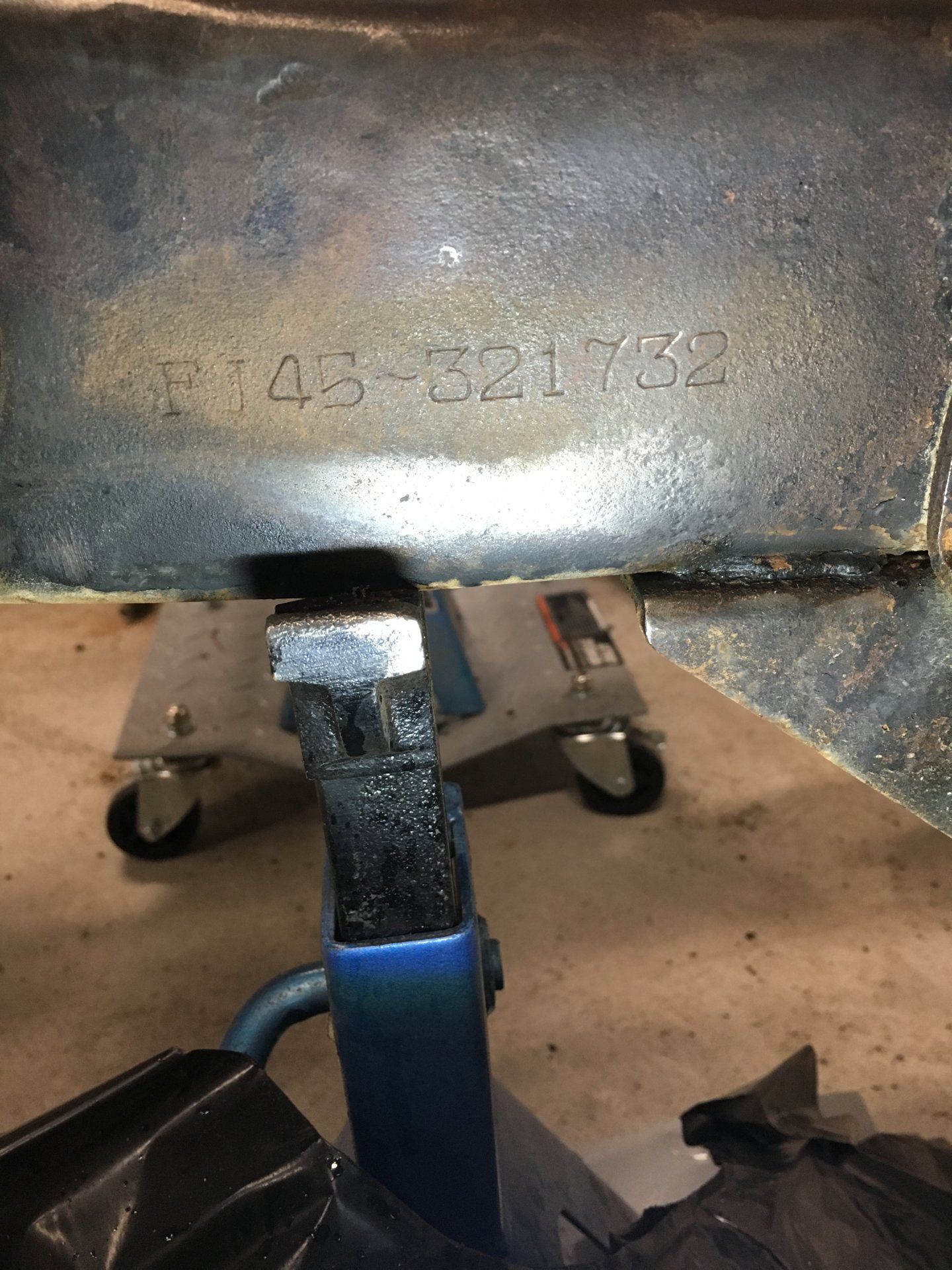

On a lighter note I decided to go with paint stripper over the frame VIN. It look like it had been painted before and I didn’t want it to get all muddied up.

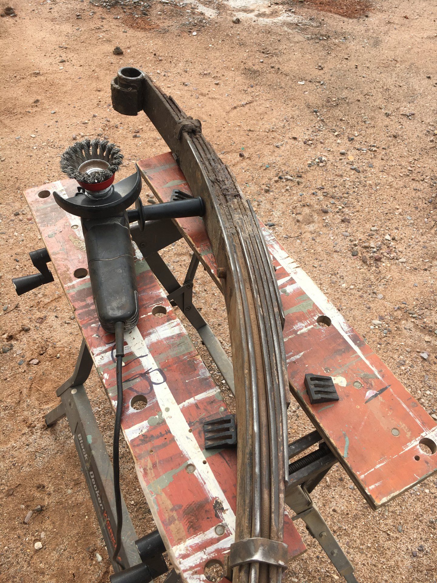

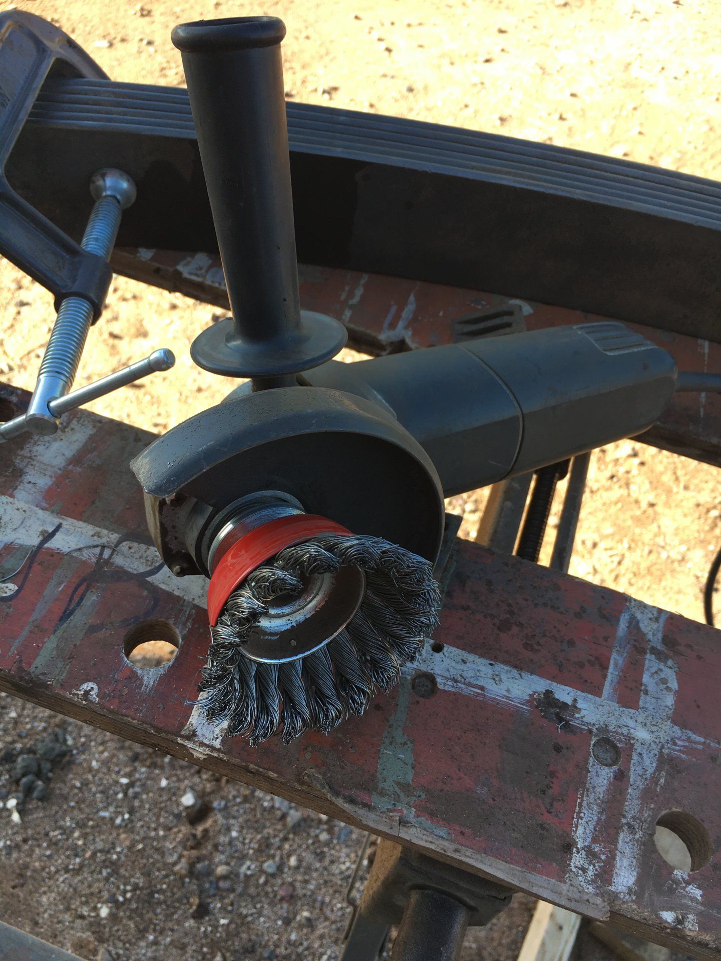

Found a good combo for gross clean up. I use a cheap HF grinder ( save those for filthy work ) and a twisted wire head. A little stiff at first but go slow and it will soften up.

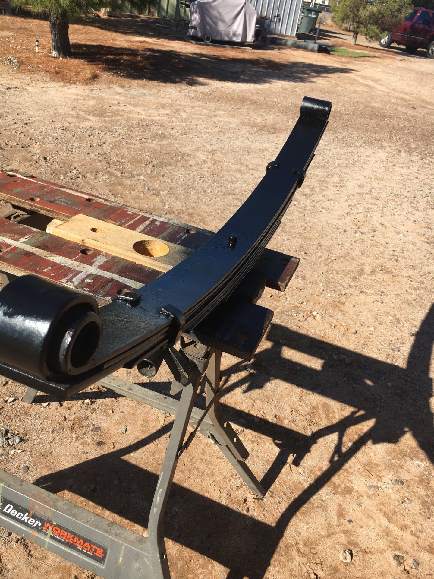

I am only rebuilding the leaf packs with “ strained” parts.

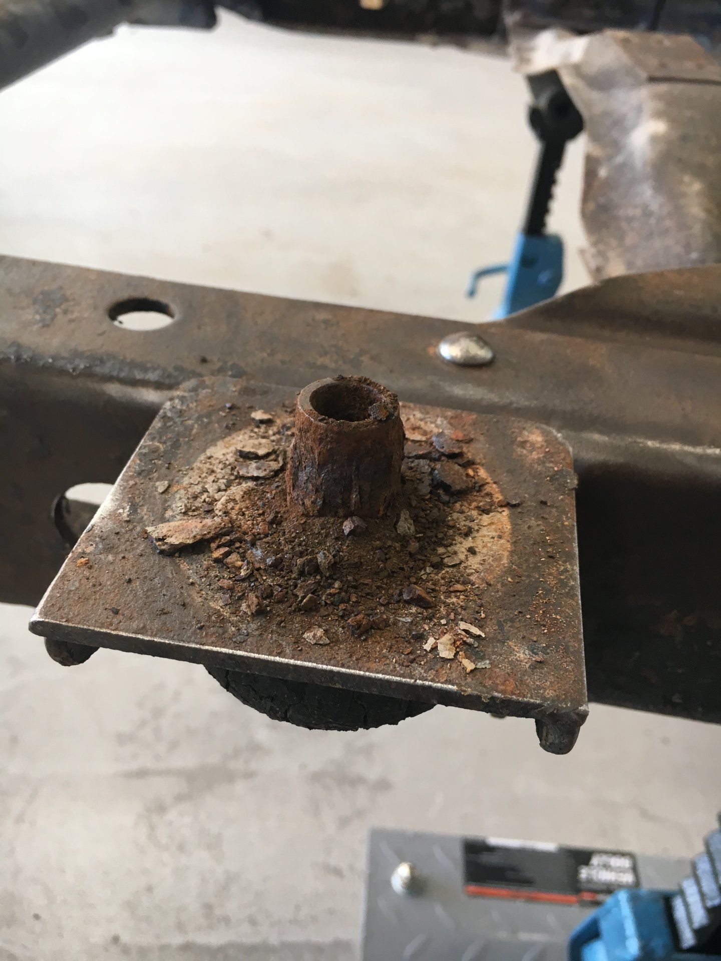

Also cut off the bush repair duplicate shock mounts...... I think that welder was paid by the pound! They we not gonna fall off😉

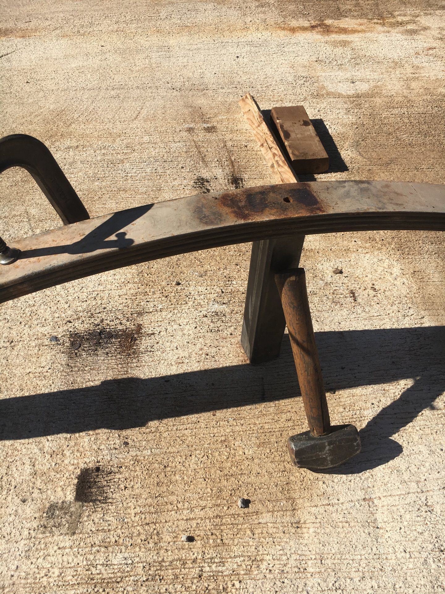

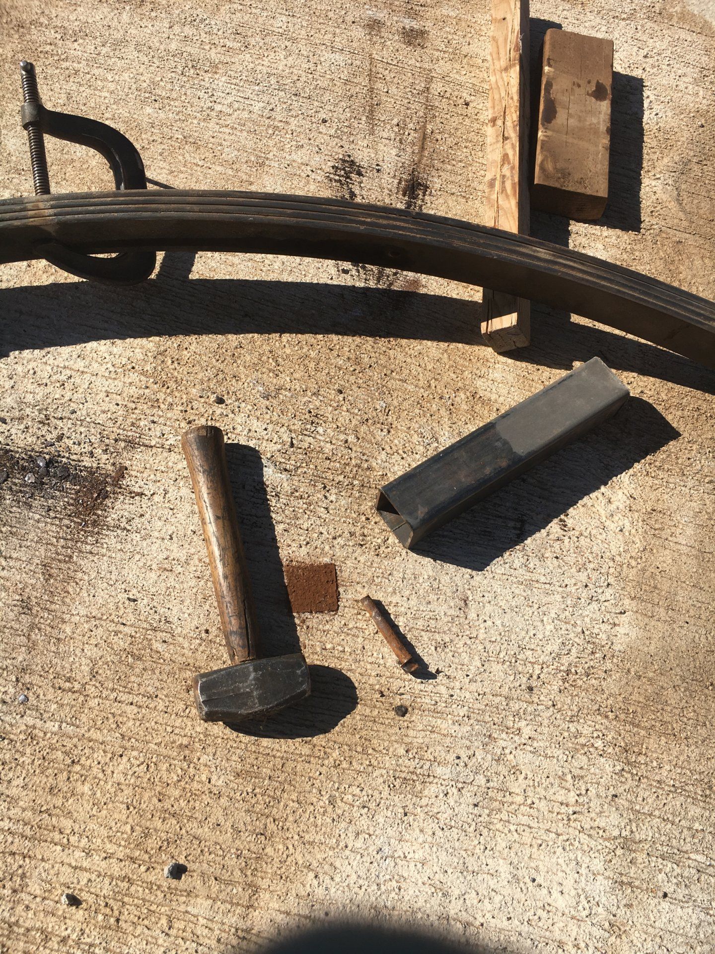

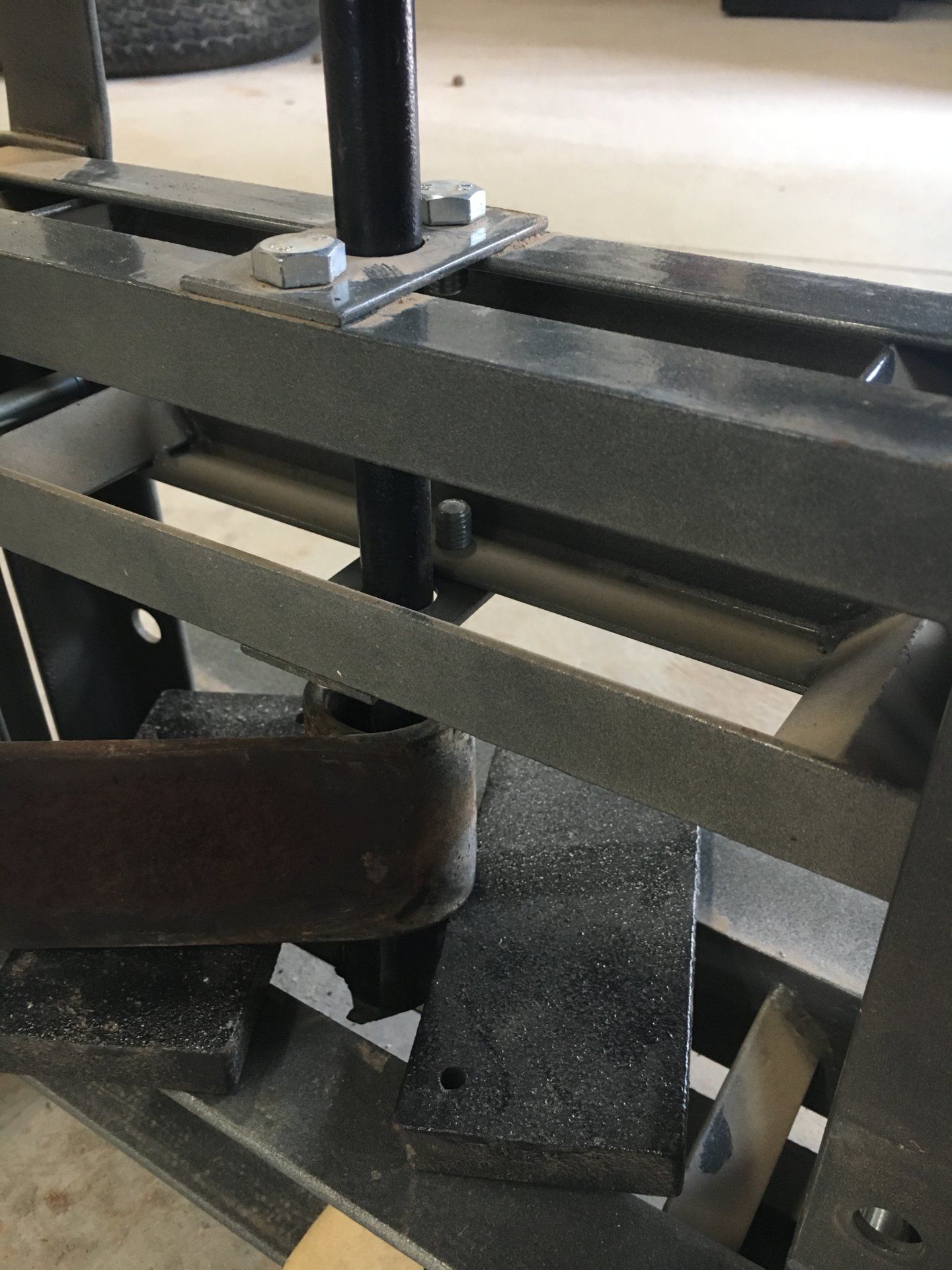

I don’t particularly like working with steel under tension like the Springs but there’s no way around it to get those Rusty pins out. I did find a good way to pound the pin remnant using some square tubing in a little

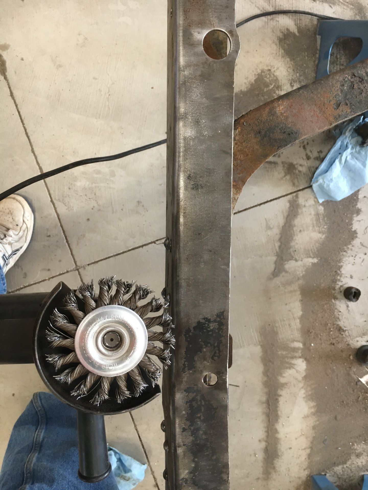

I had planned to spend the day working on the frame prep and scraping but the springs got me sidetracked I did at least spend a little time with the grinder and wire wheel and it went pretty slick. The rear crossmember is pretty beat up but I can’t find an FJ 45 replacement so I think I’m gonna have to find a way to pound his thing back into shape

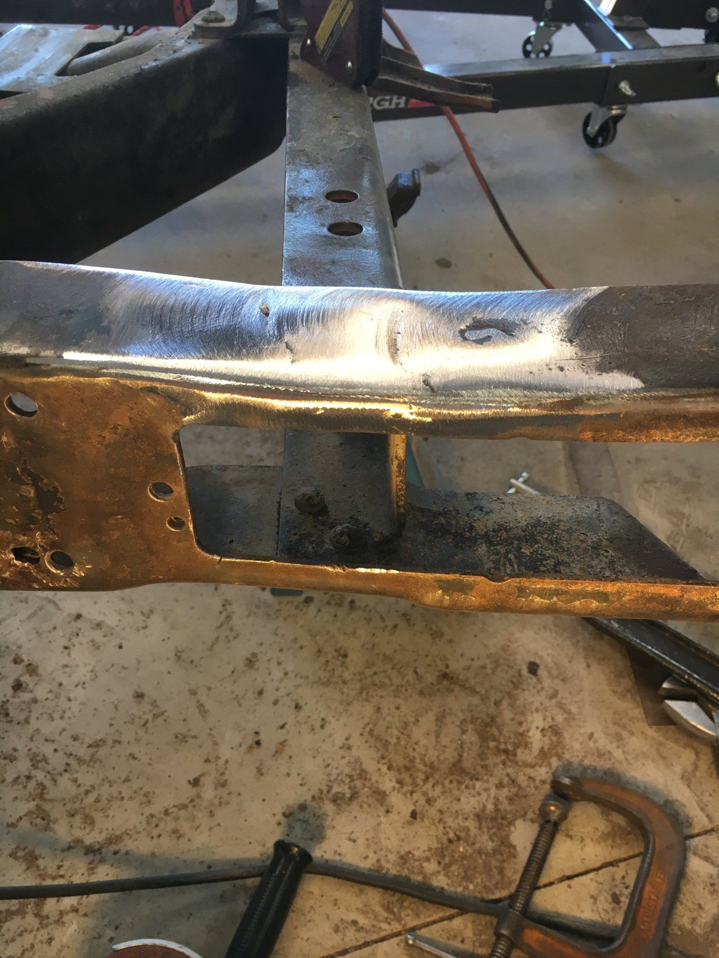

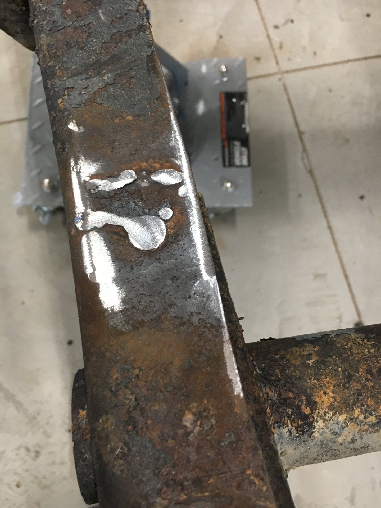

Time to do a little repair on the frame. No sense welding upside down if I don’t have to so I’m splicing in a little replacement patch on the rear crossmember. I welded a little in the pass but certainly have a long way to go to get proficient at it so I might as well start underneath where it’s more about function than
form after this just a bunch of random holes to fill and then I need to solve the front crossmember issue

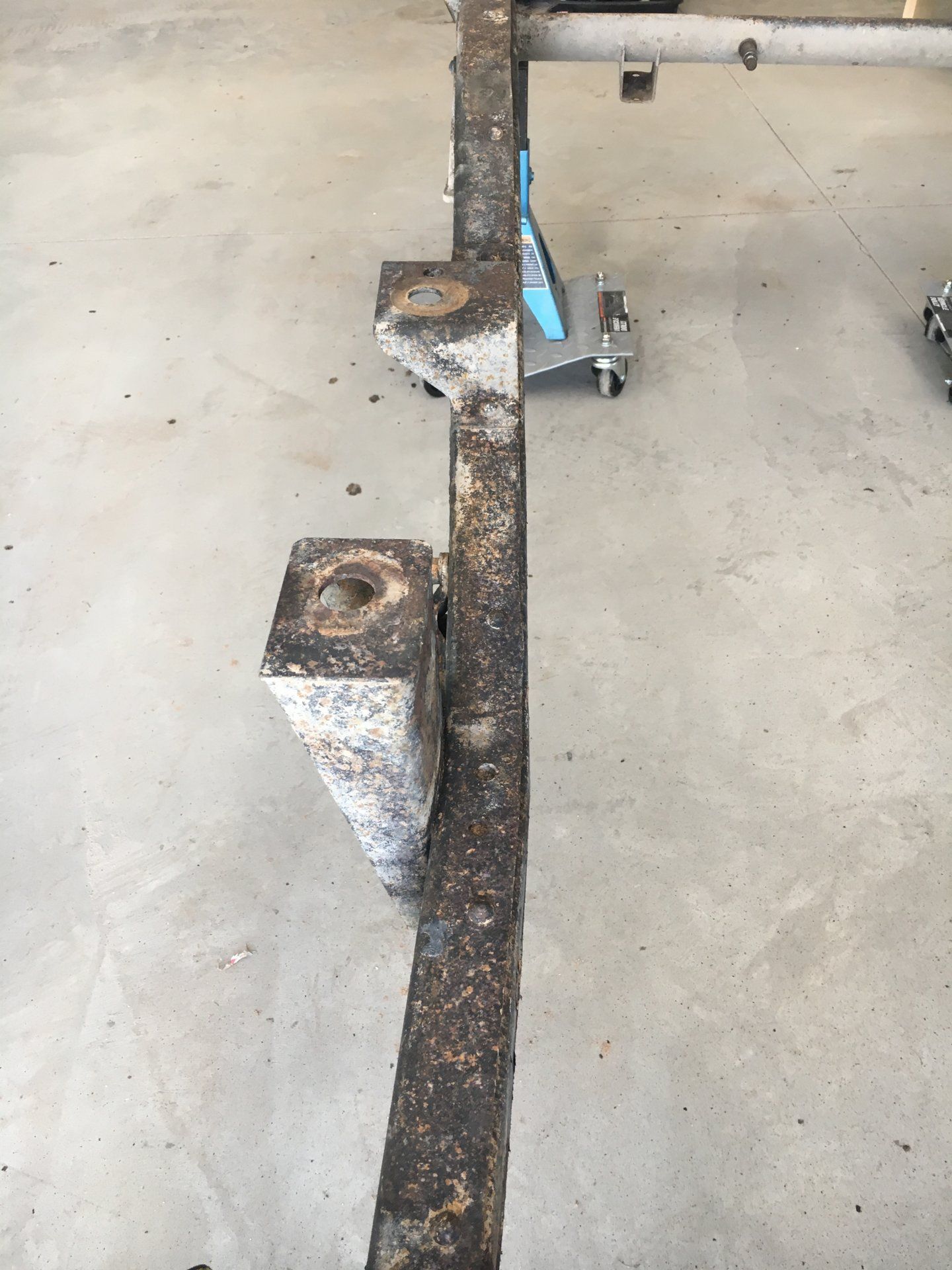

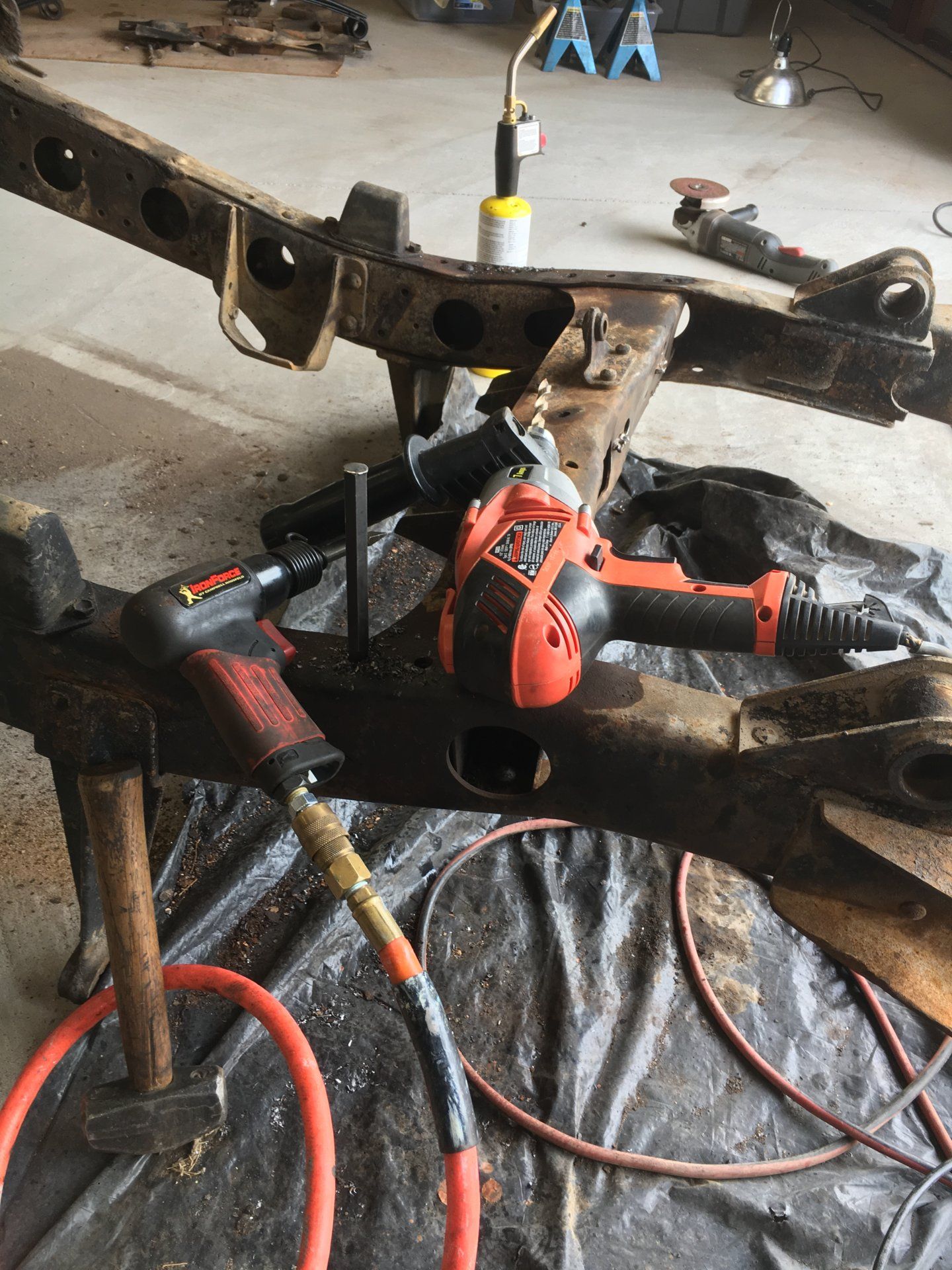

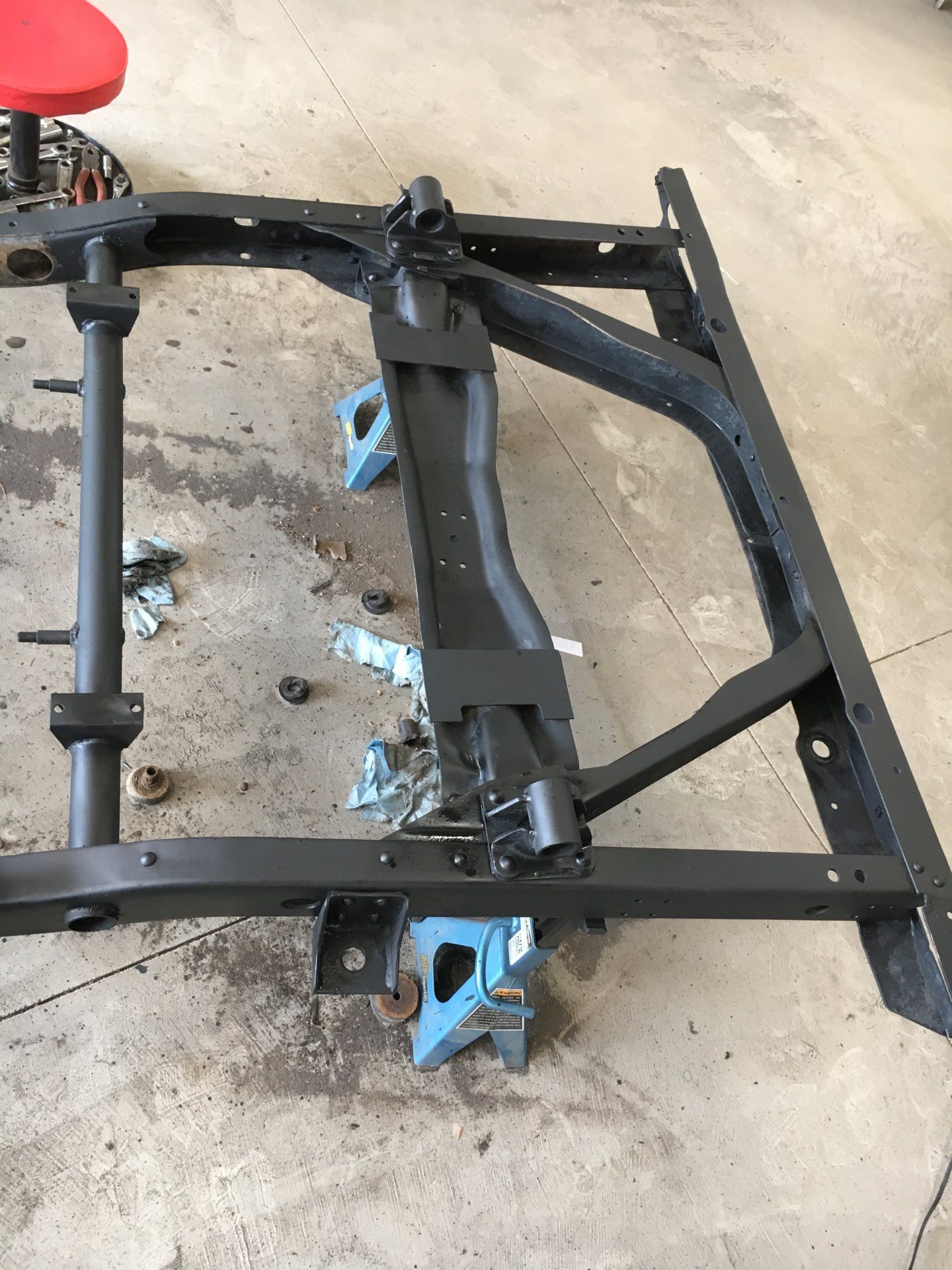

Normally around Thanksgiving time we think of planes trains and automobiles, I spent this morning with cut up wheels air chisels and drills to pull out some rivets. I need to replace the front crossmember it’s close to an inch and a half out a true thanks John for the replacement.

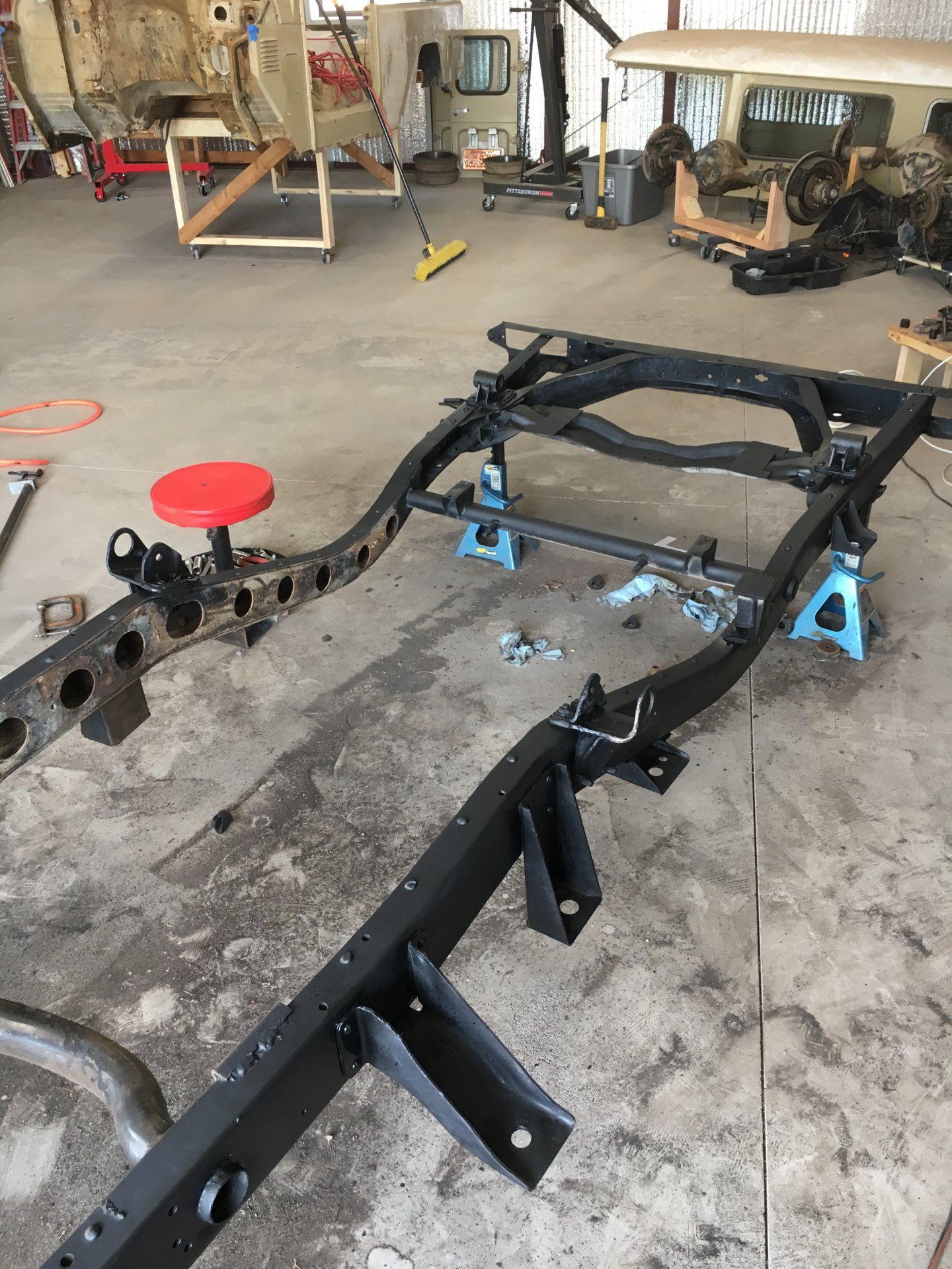

Then did some more grinding and scraping on the bottom of the frame. We have some rain coming in the next day or two and I didn’t wanna expose metal plus I needed to see something look pretty, so I sprayed one can of Eastwood rust encapsulator. Nice stuff I wish it came in a semi gloss though
Finished up most of the bottom of the frame and both sides can’t do anymore until I get that crossmember replaced then I’ll tackle the top really happy with the way this Eastwood product goes on but now that I’m looking at it I actually like the flat finish

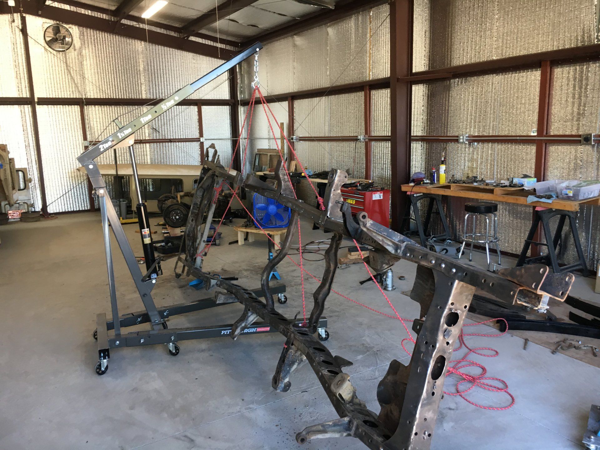

Finished up removing all the rivets and got the front crossmember out ready for The transplant. Wasn’t sure if it would swing out OK so I gave it a little bit of pry with the bottle jack to give it some more breathing room and took out the bolts on one side of the trans. X-member tight fit but came out just fine took a break on grinding and went to work on disassembling the brake lines

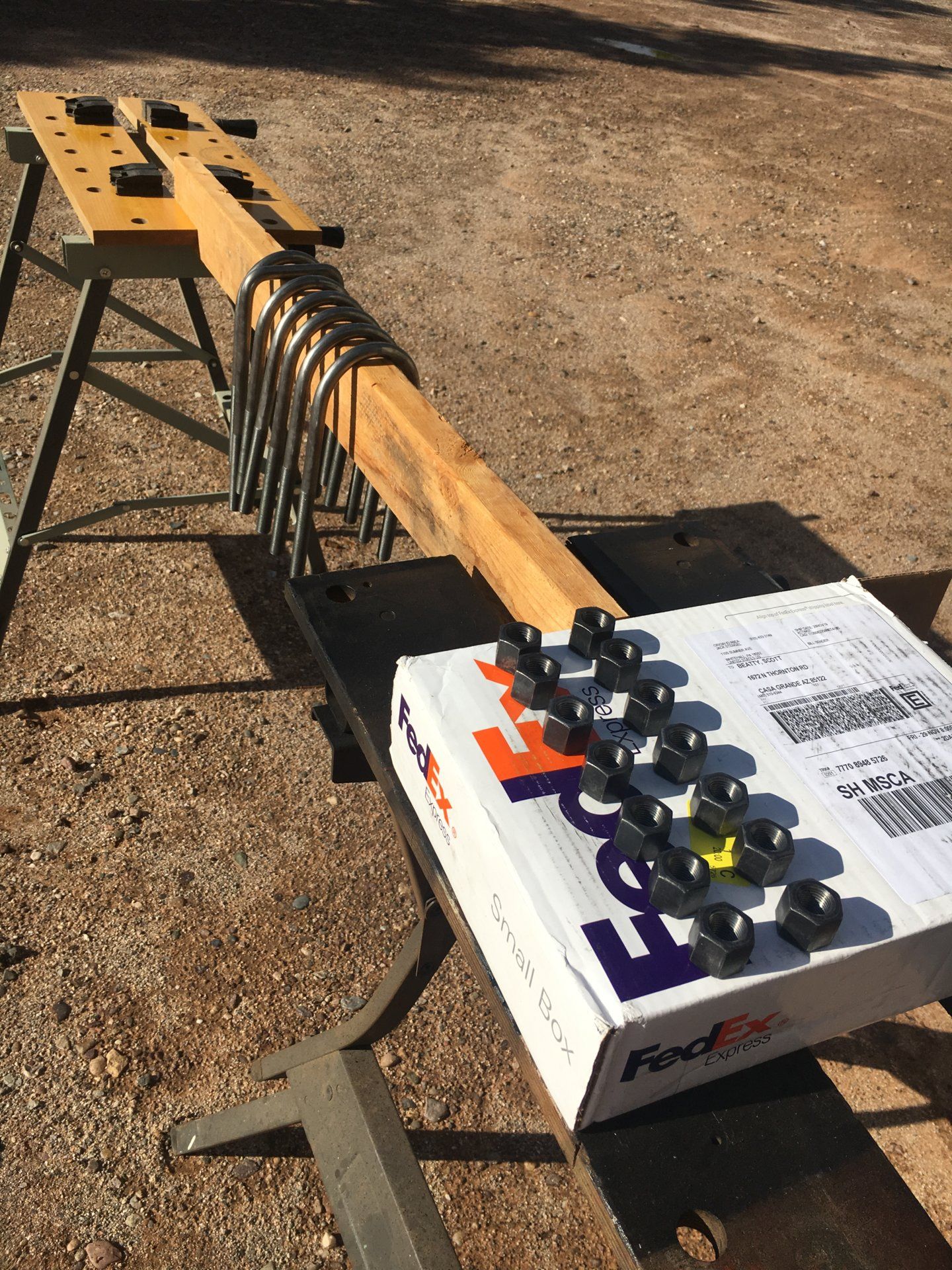

I found a good source for you bolts, Stangel brothers good selection quick order and good prices . The round tops come in pairs but you can order individual square tops including nuts and washer. couldn’t resist slapping a little satin black on them .
