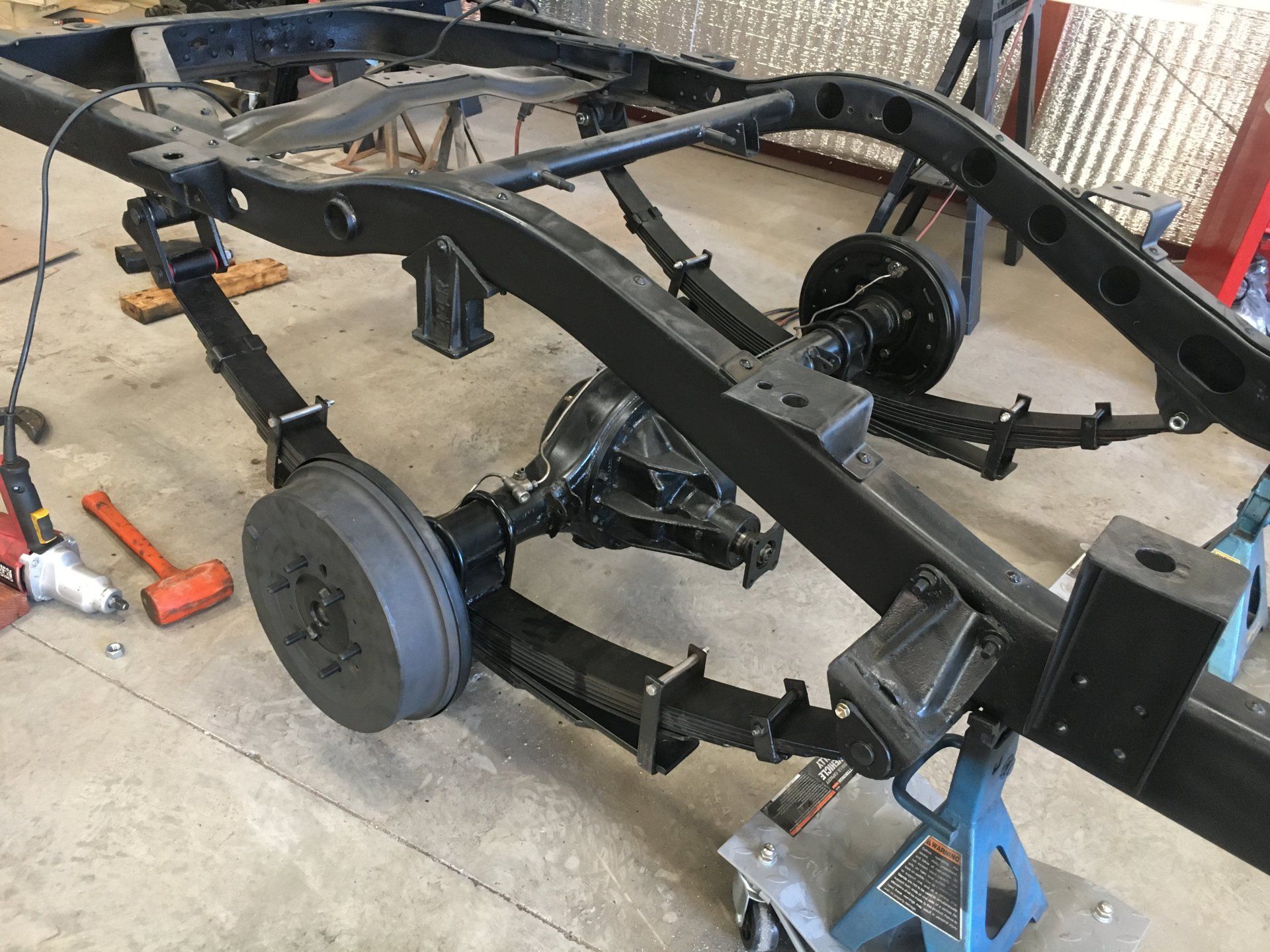

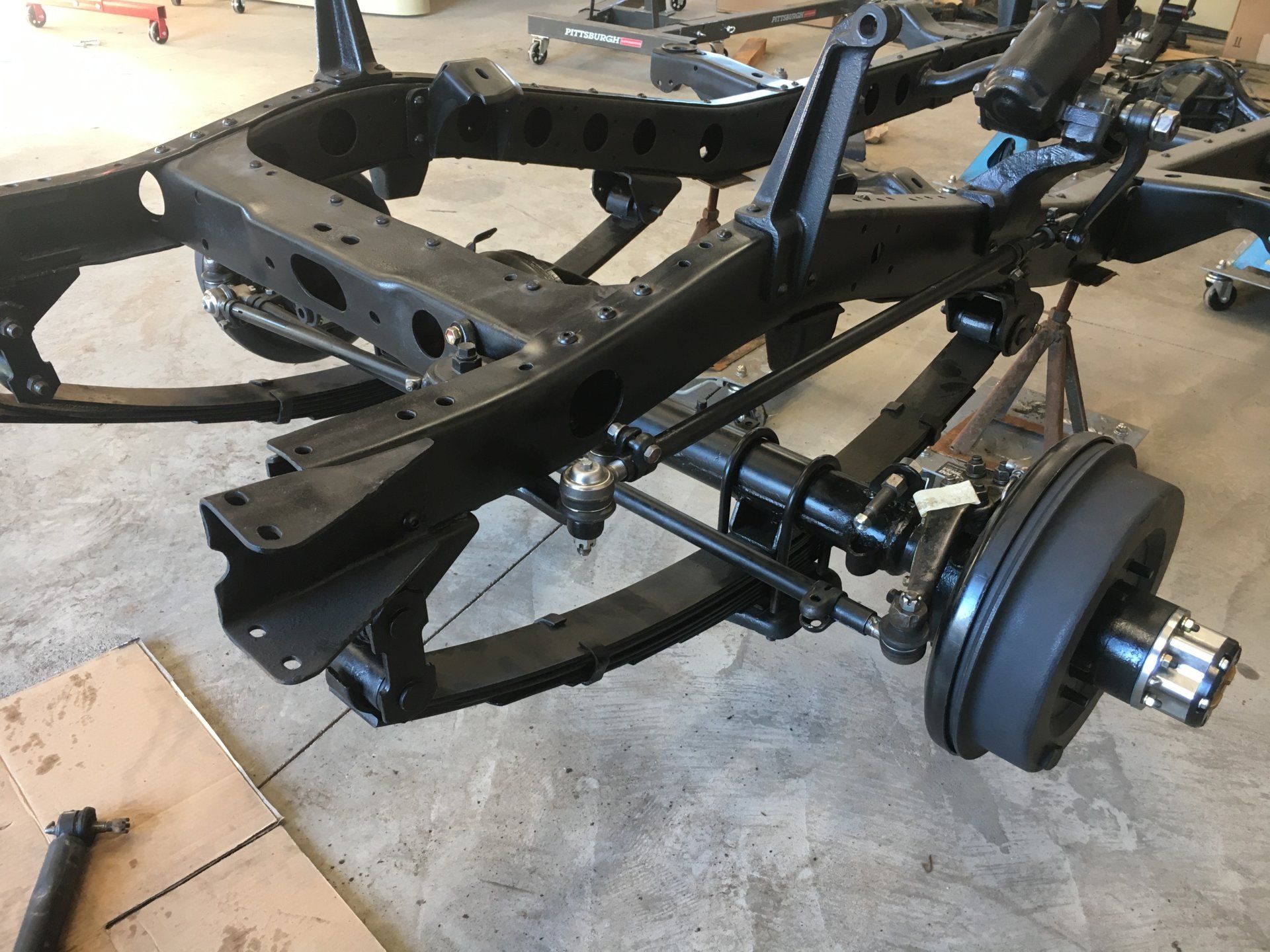

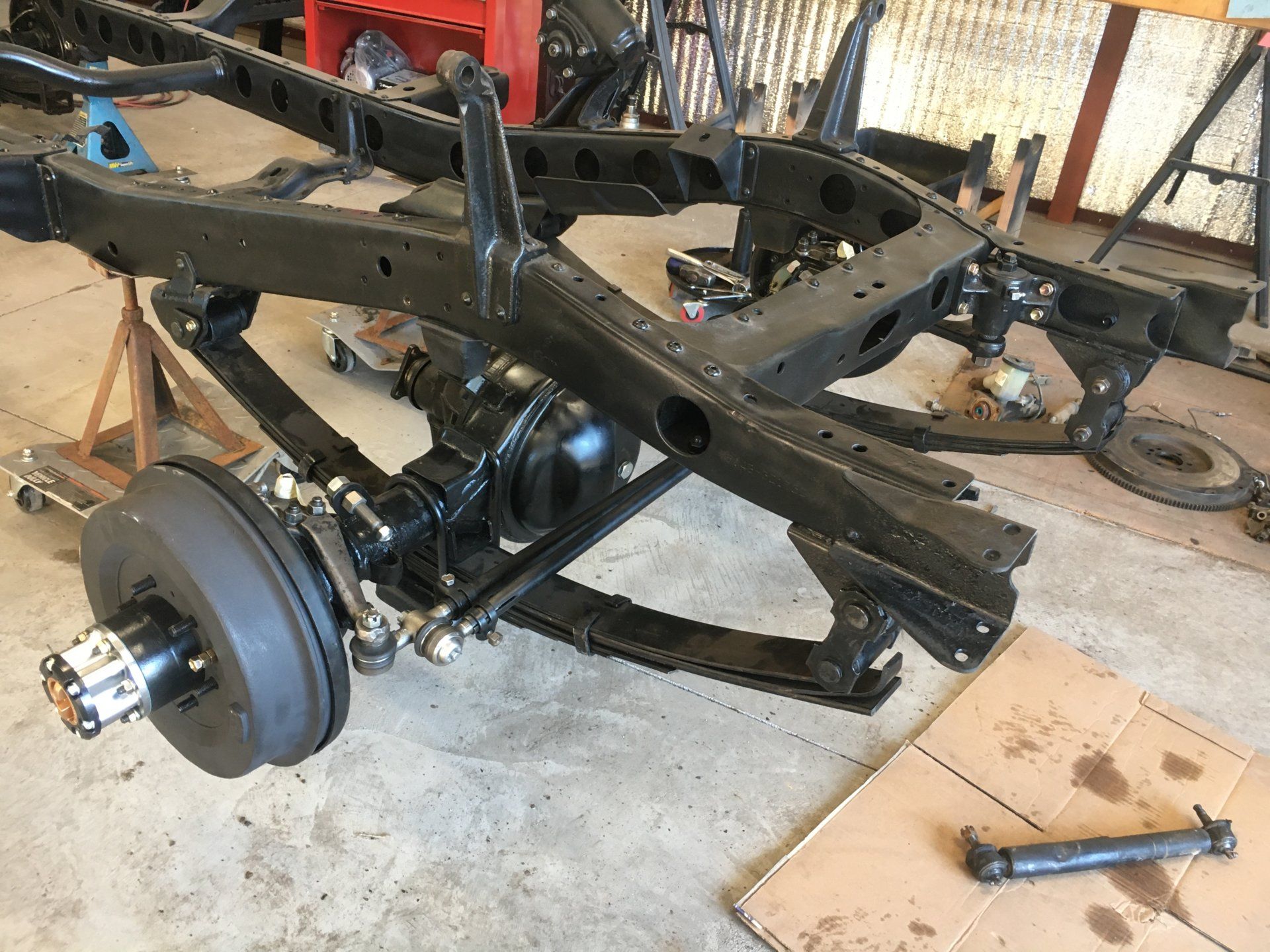

A short day but far more satisfying than scraping crud . Axels and springs in place, steering linkage as well.

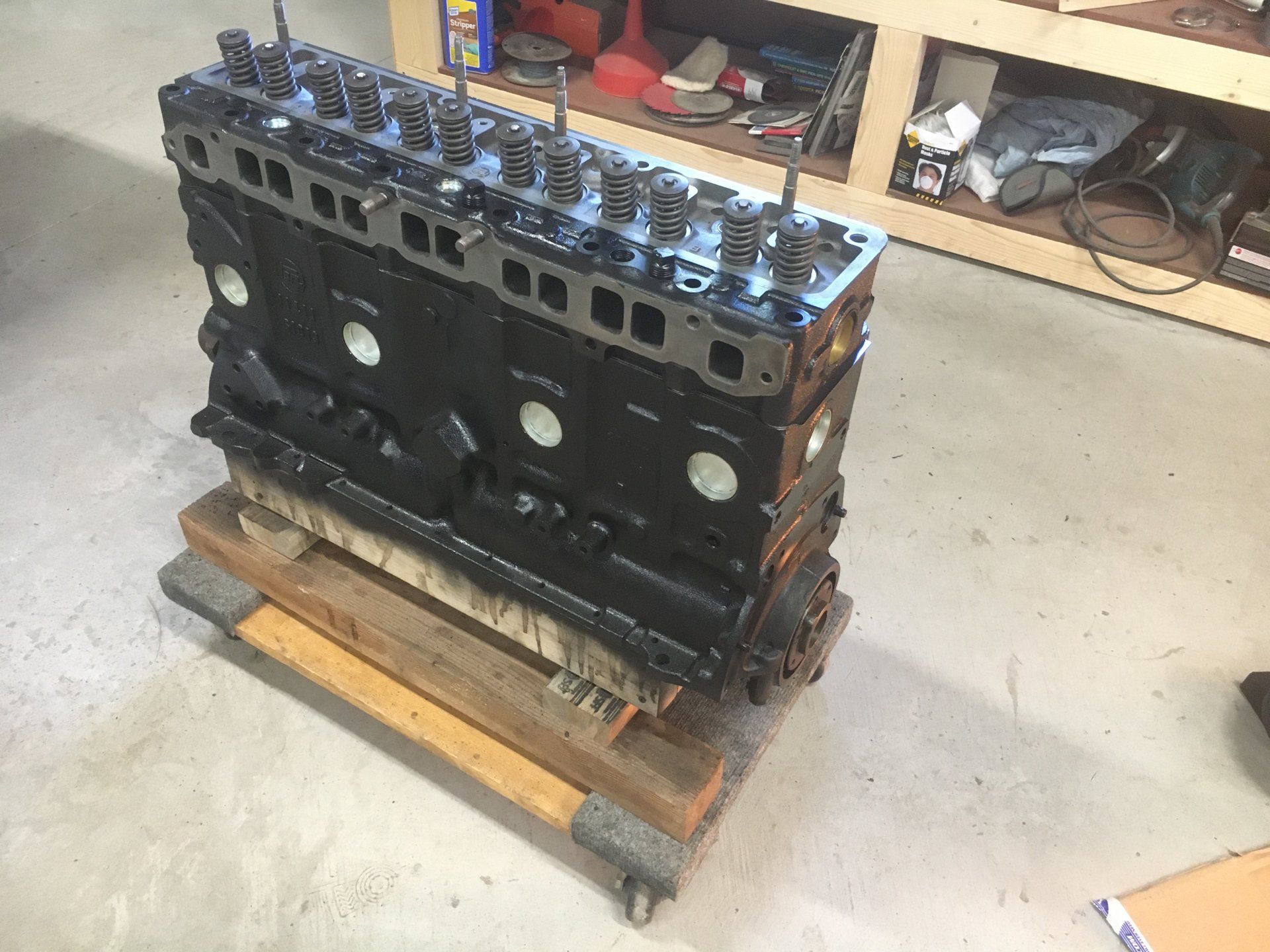

Should have it rolling early next week then can finish the motor refresh

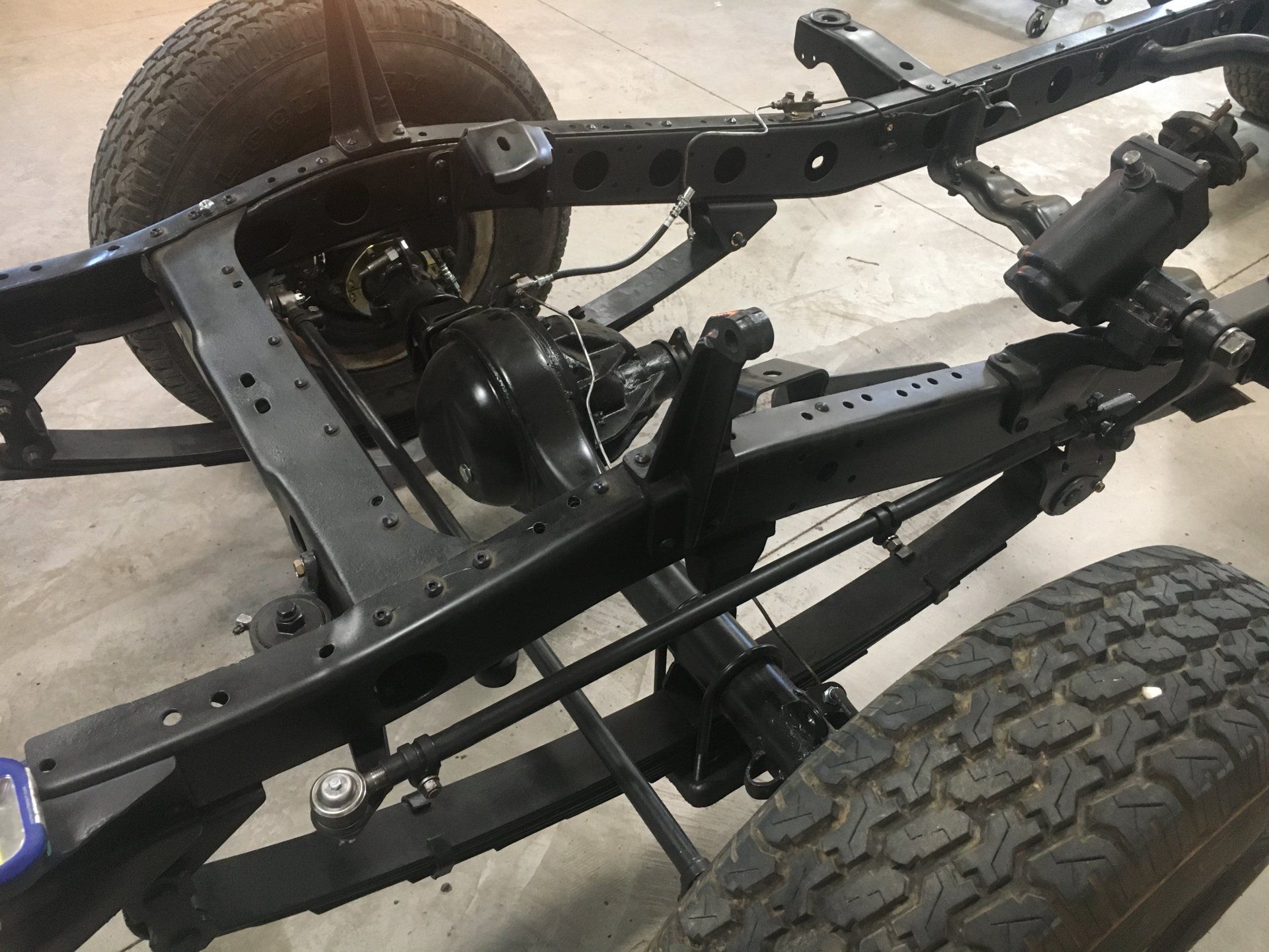

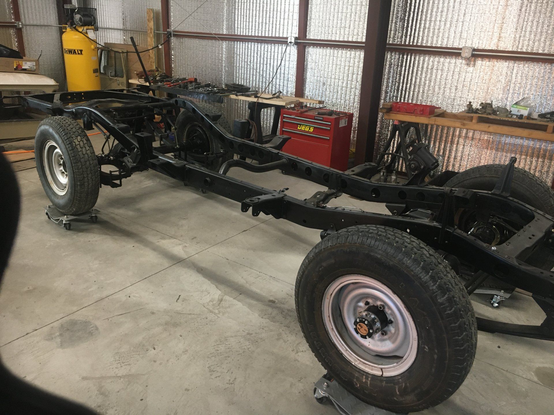

Very satisfying to see her with her feet on the ground, sway bar in , steering linkage in and all brake lines fit in place loos ( made sure I had all the right parts)

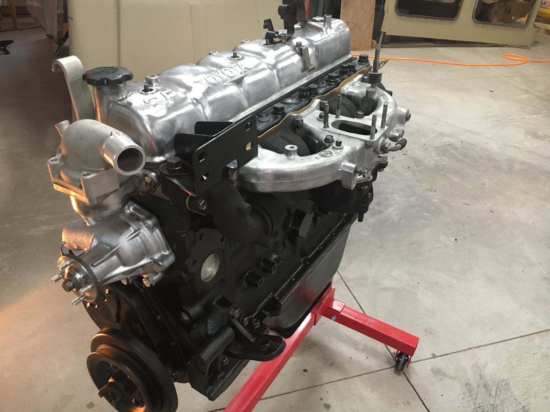

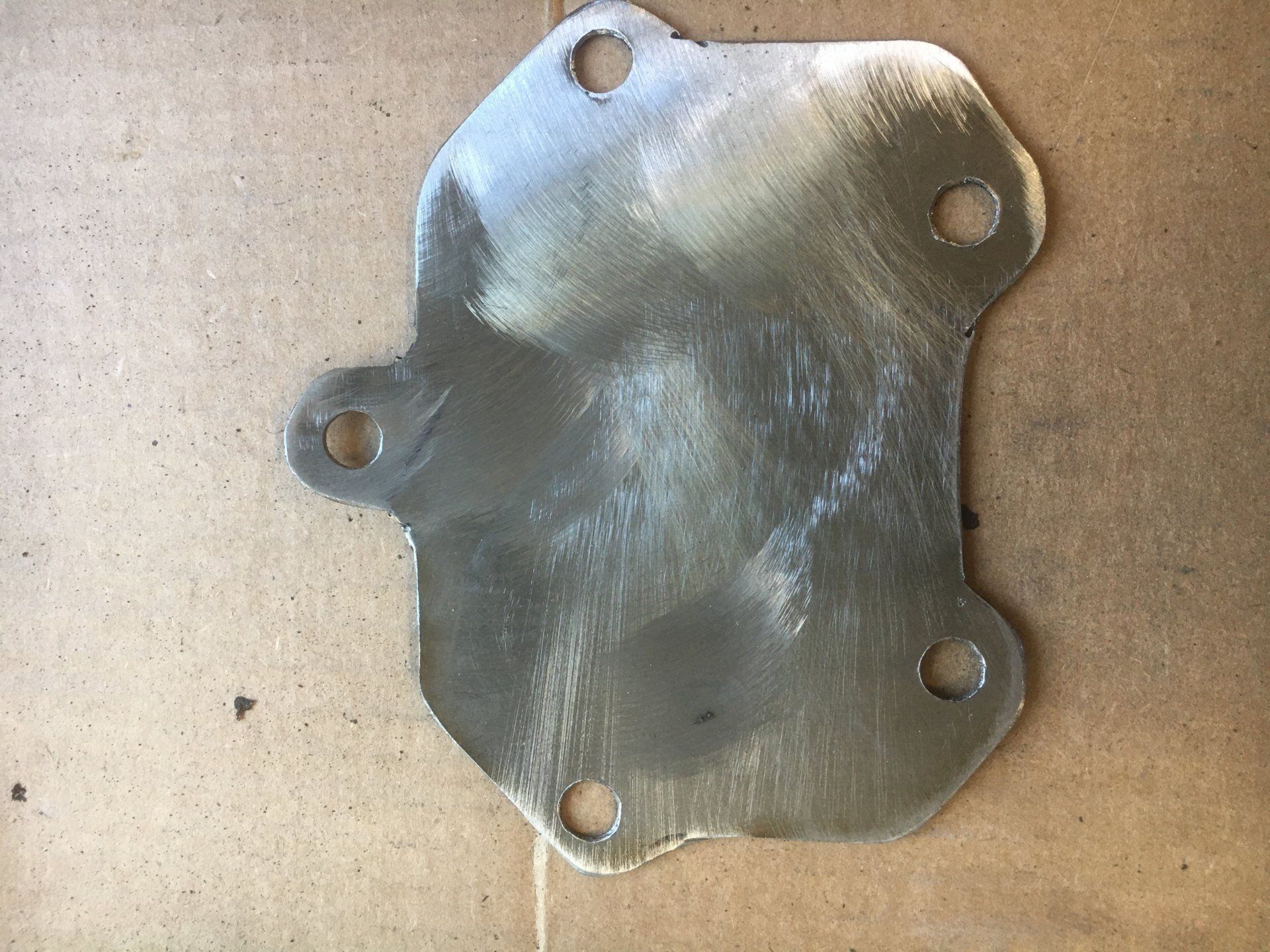

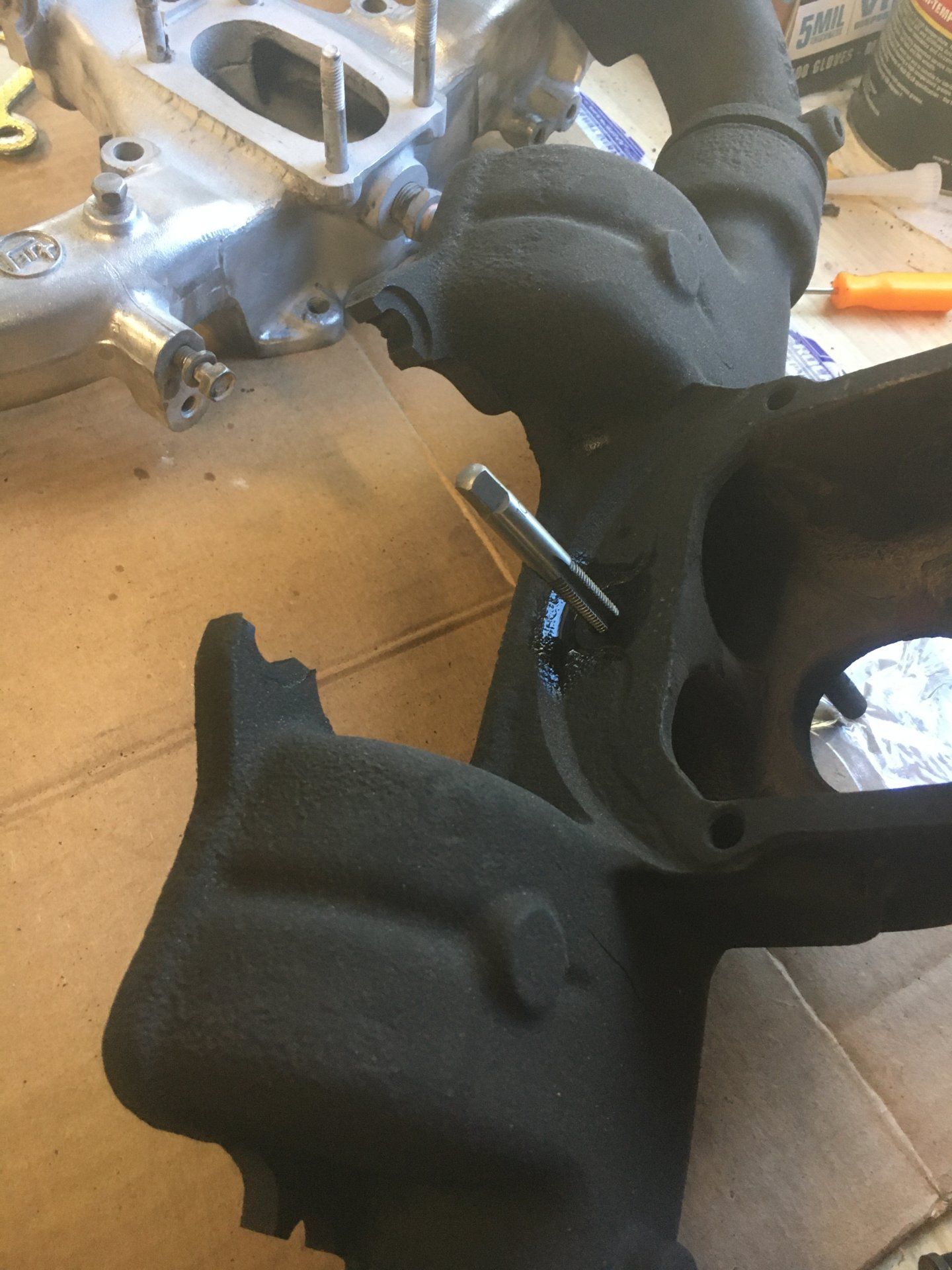

It’s a good thing I never throw anything out I had some scrap stainless steal from a skid plate I made for my son. Just the right size to make my manifold insulator. Chased a few threads and started the reassembly plus I got the head back on

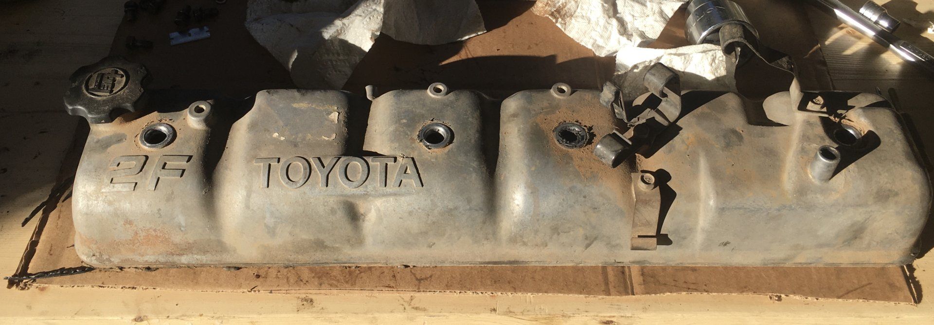

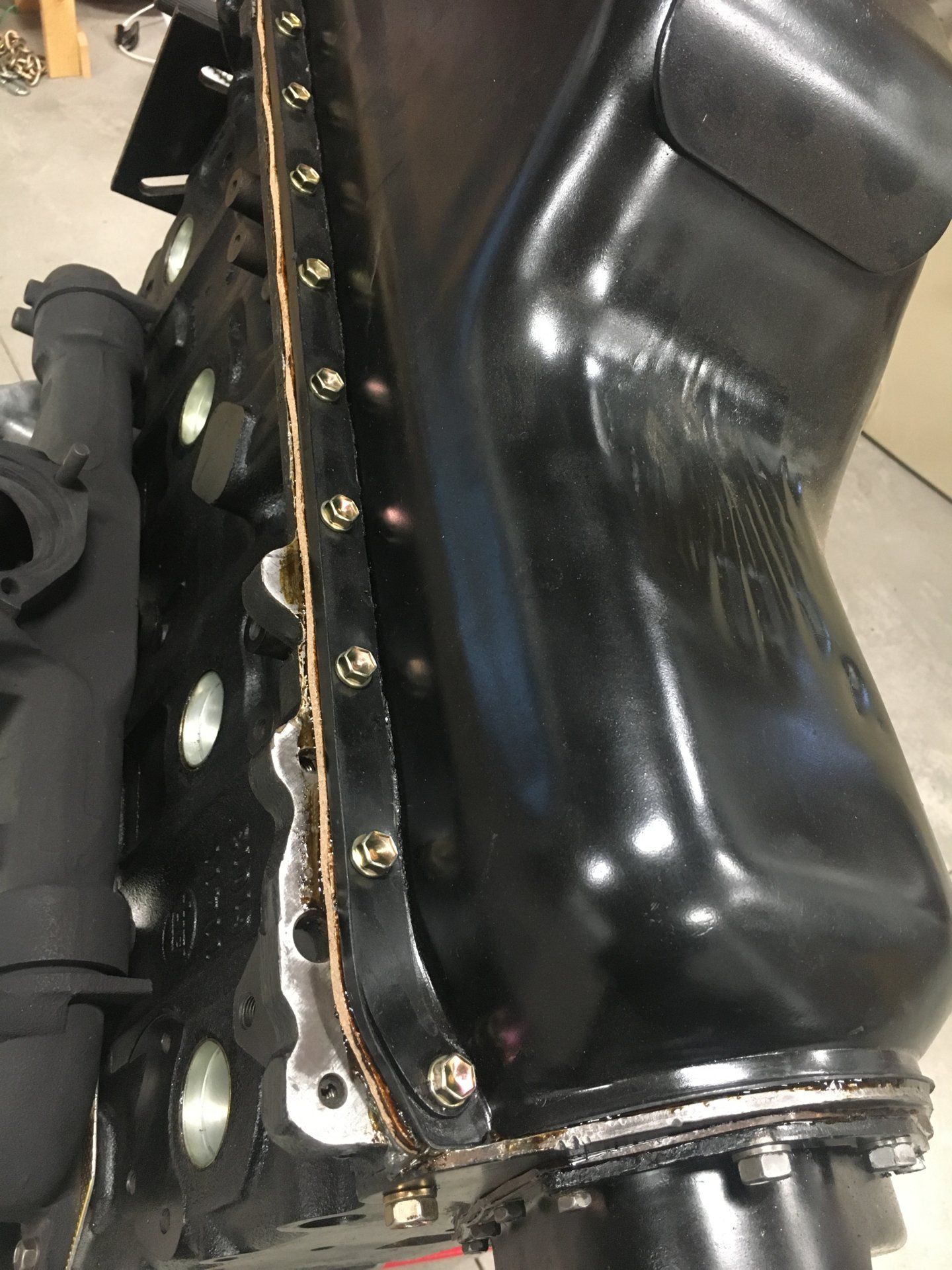

Finished cleaning and painting what I hope is the last greasy slimy crusty old part, the bell housing, for a moment I thought about leaving the inside alone and then realized I couldn’t do that with a clear conscience so scrubbed it clean got all the sprayed oil off but didn’t bother painting it.

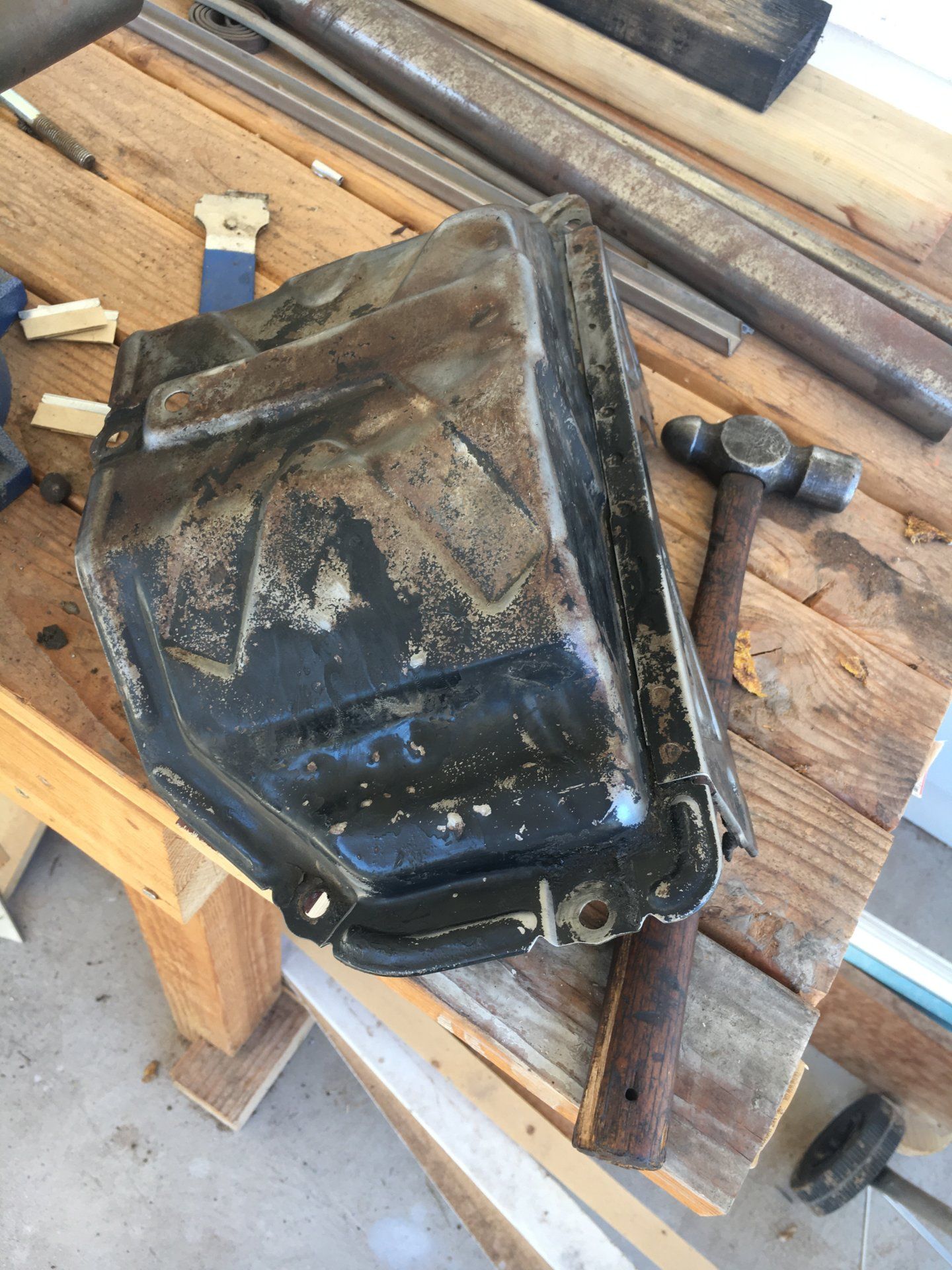

Did a little metal work - dent repair on the fly wheel shroud

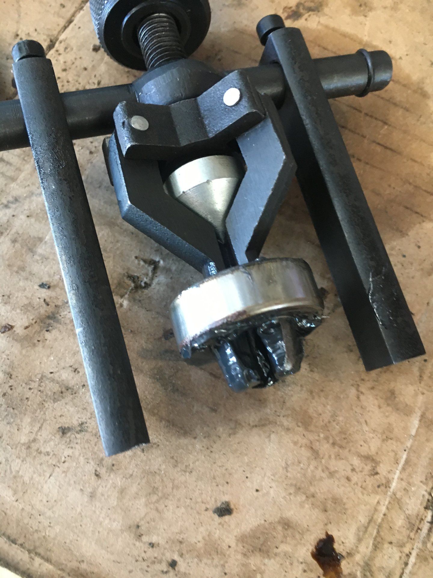

modified my removal tool so I could get the pilot bearing

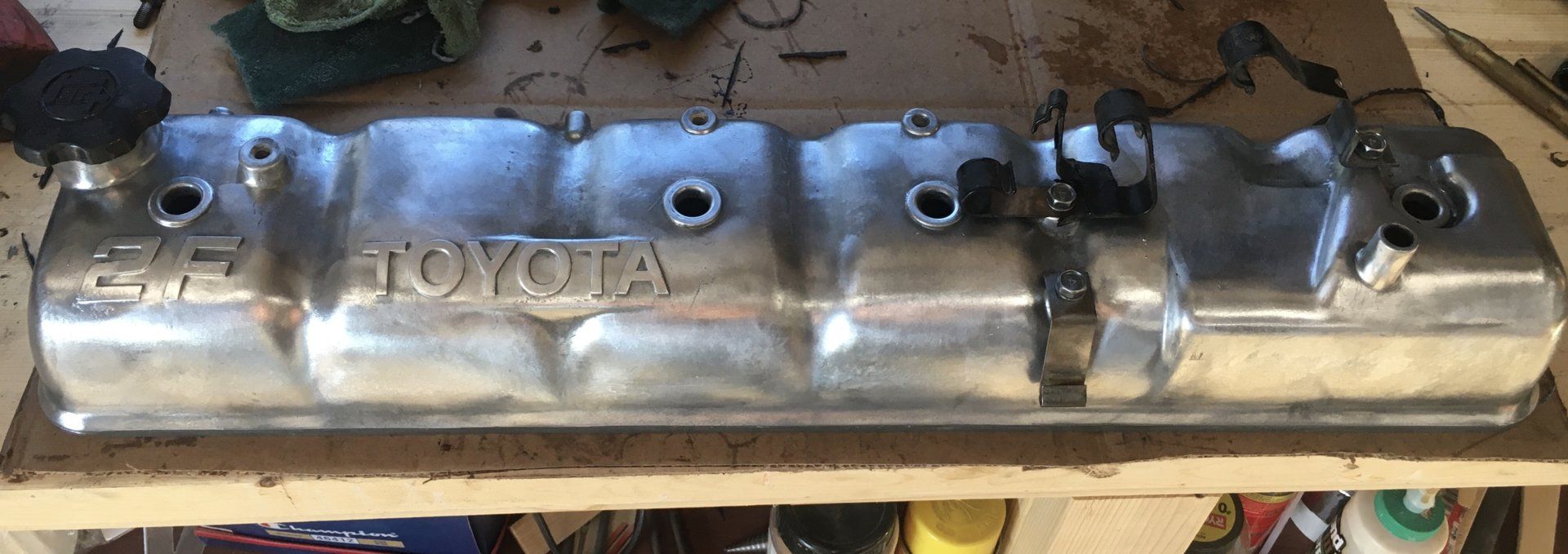

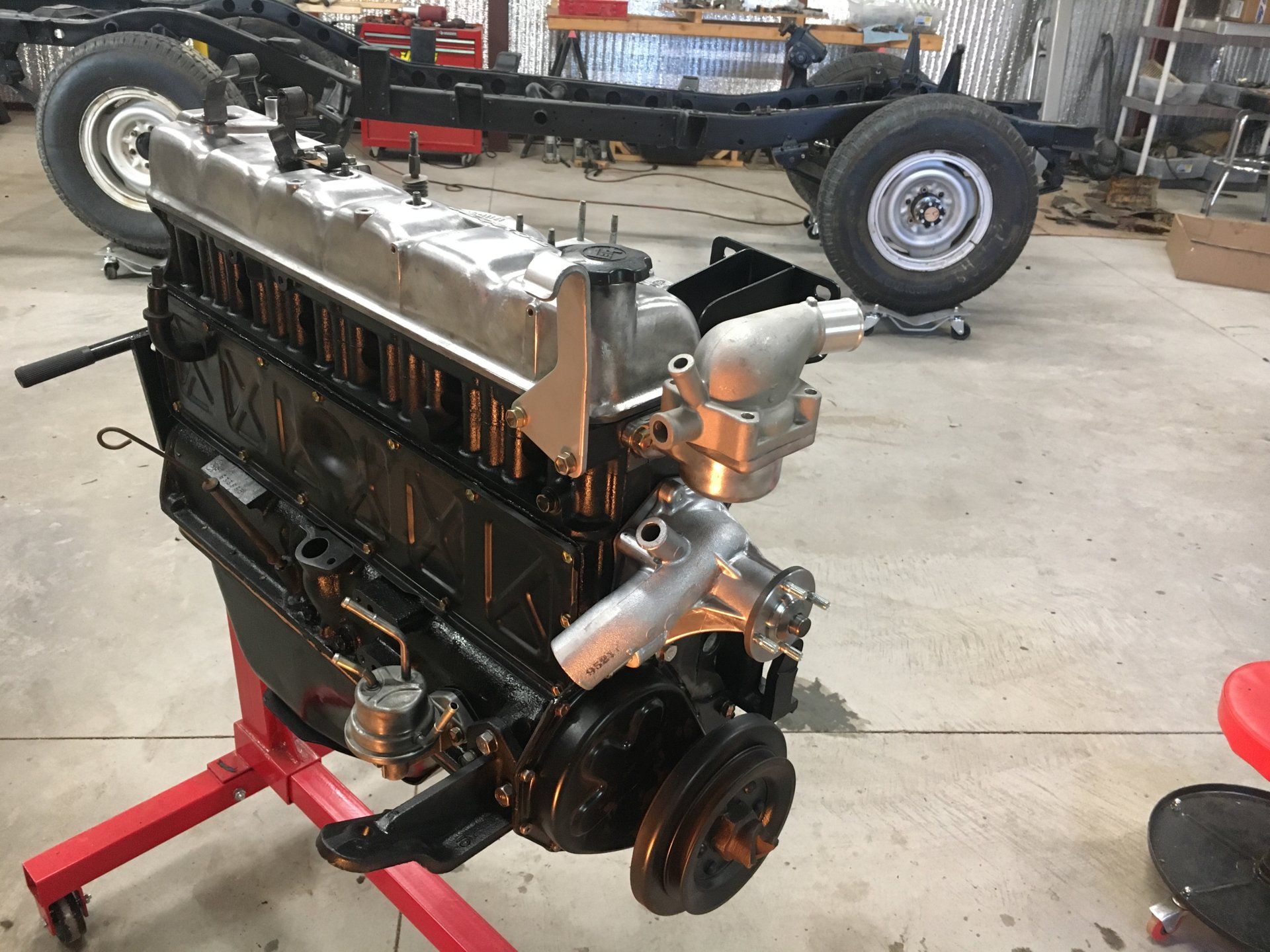

For the water pump I found local source for stainless bolt that doesn’t look too bad.
You should put some painters tape on that hole for the dizzy and the intake manifold.
