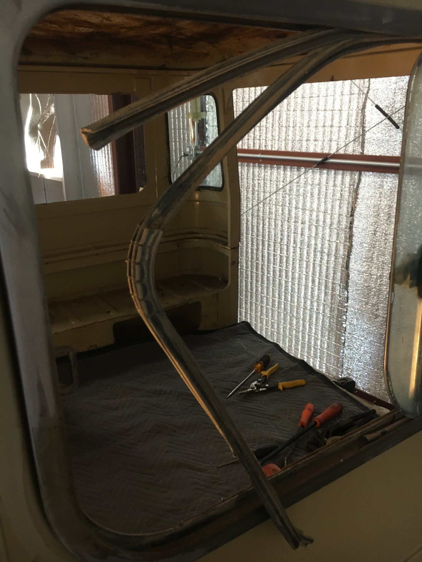

Rear slider removal 1982 FJ45- non US markrt

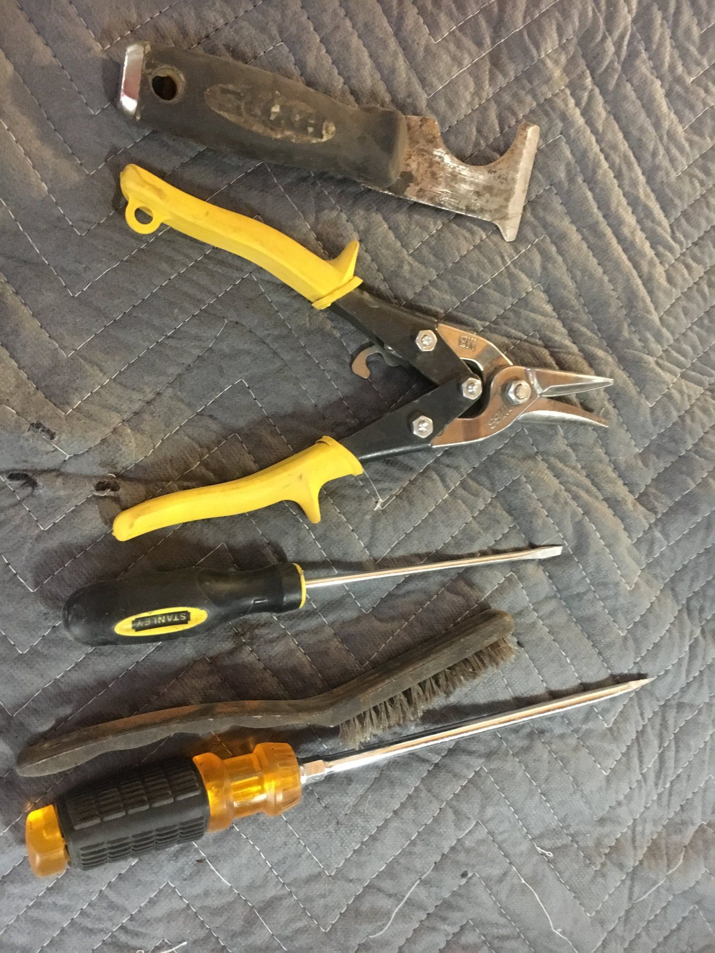

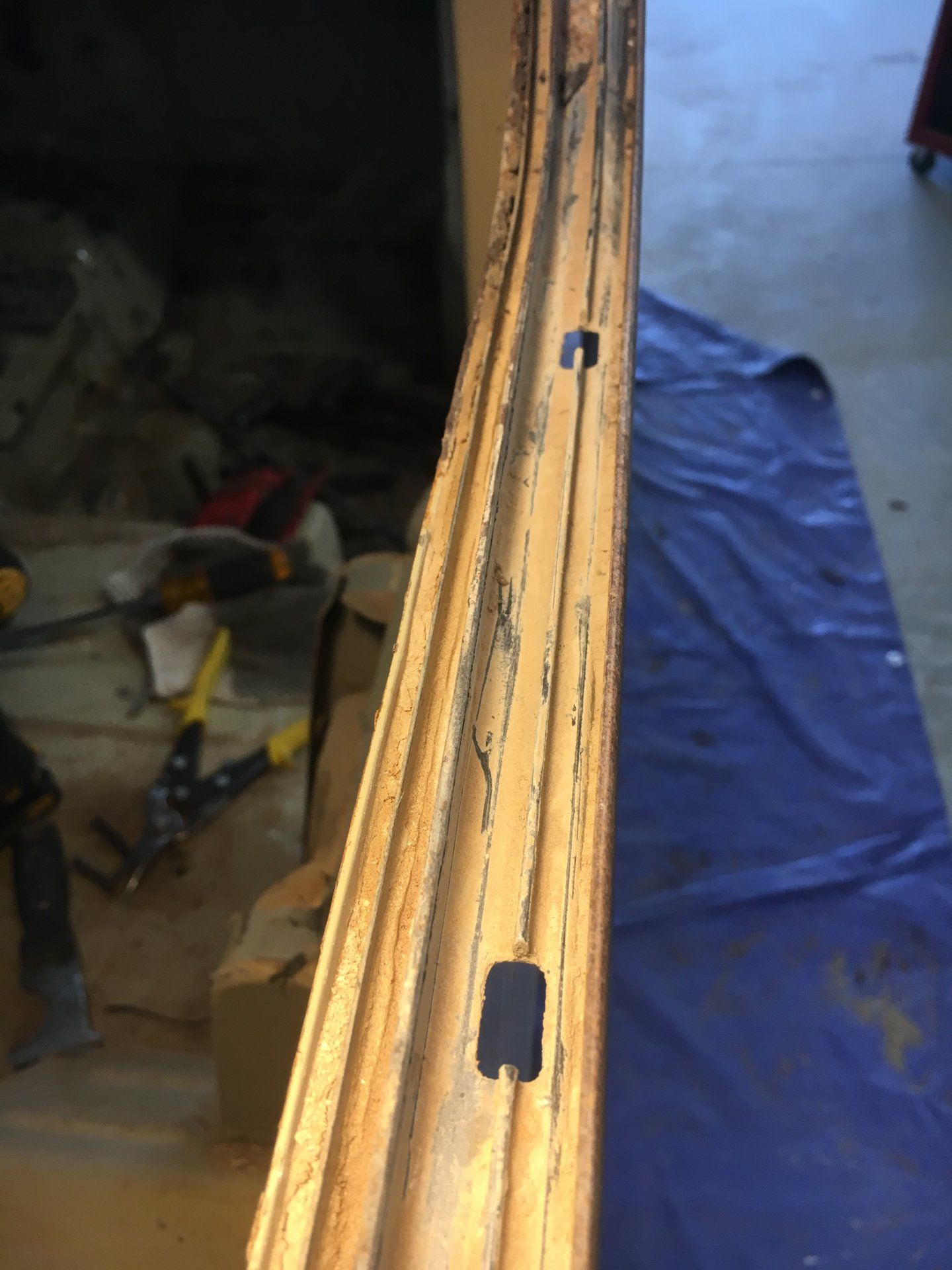

Here are the tools and techniques are used to remove the rear sliders. I love that painters tool to help it has many nice edges.

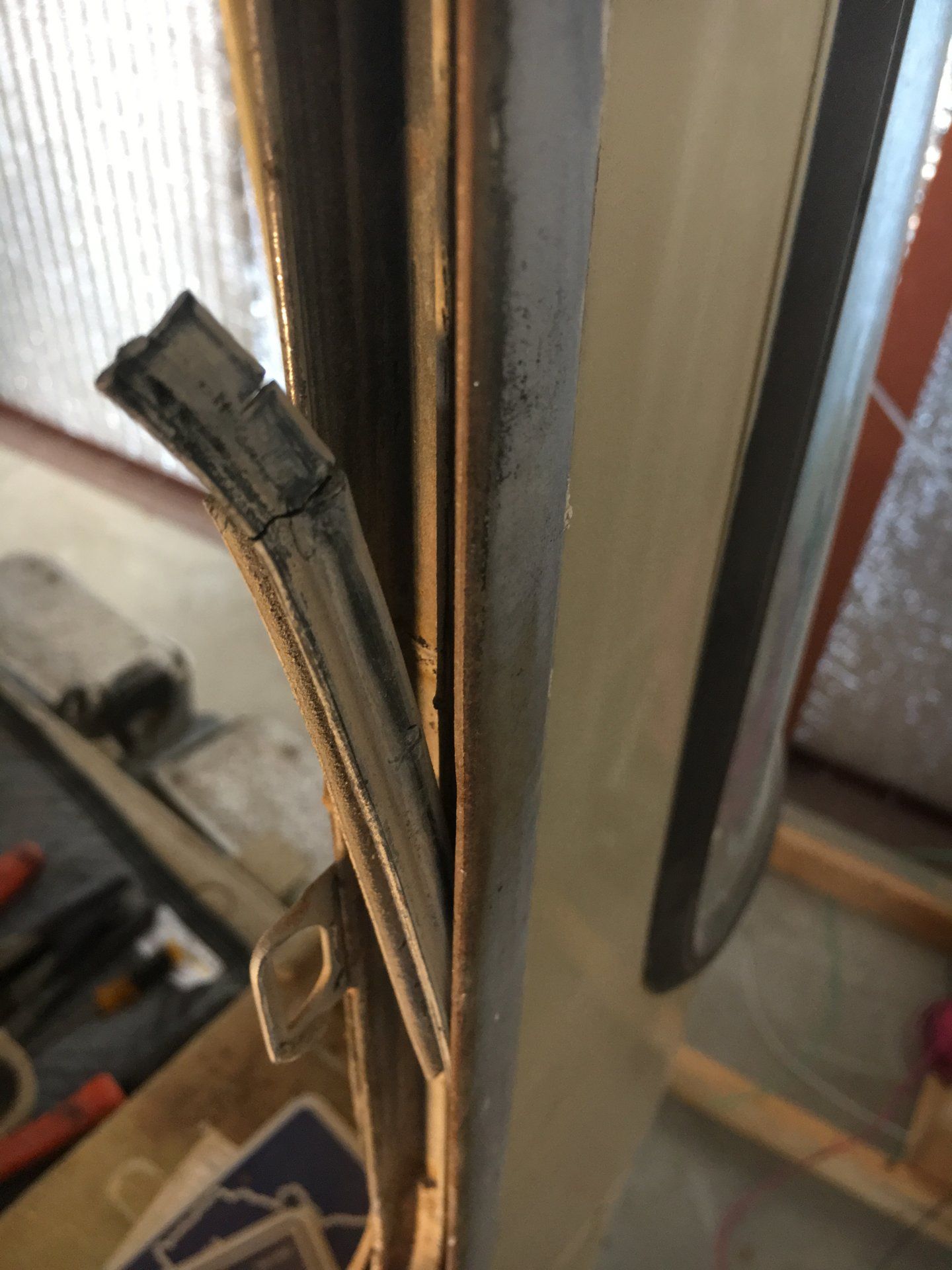

Slide both windows to one end and then start removing the weatherstripping. It is installed as one piece serving two channels but it’s pretty hard to get it out as one piece as it tends to split down the middle. The iner half comes out easy but the outer section tends to hook on the outside metal trim it’s tempting to pry hard to get it out but the metal frame is easily deformed so be careful.
Once you get the open side clear brush and vacuum all the debris away then slide both windows to the open section, don’t worry they won’t fall out by themselves. Continue removing the weatherstripping until it’s 100% removed and the track is cleared and vacuumed .
To remove the glass slide the outer pain to the center of the frame and you need to grab it in the upper corners and press down and gently push up on the metal frame it barely clears and he will have glass and metal scraping.
To remove the glass slide the outer pain to the center of the frame and you need to grab it in the upper corners and press down and gently push up on the metal frame it barely clears and he will have glass on metal scraping.
To remove the inner glass pane it helps to position it in the outer track then repeat the removal process.
Hope that makes sense if the previous owner didn’t gum it up with caulk it actually comes out pretty easy good luck

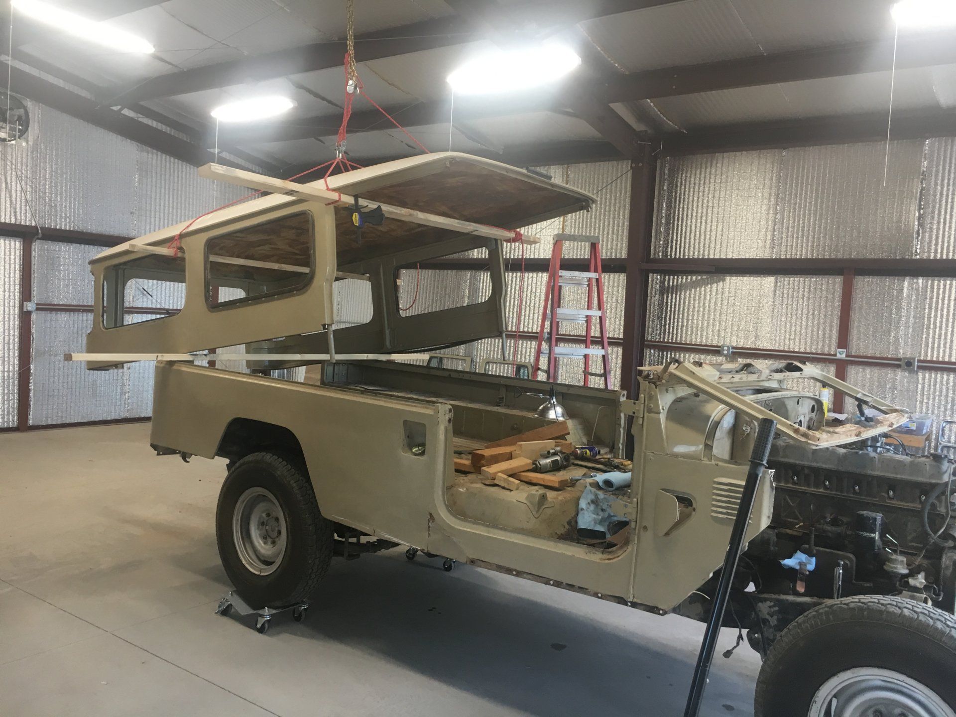

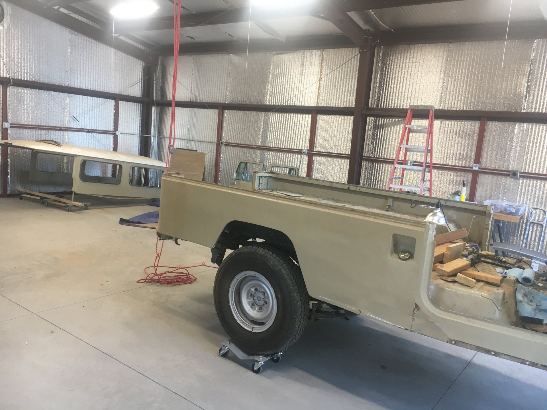

For the first time since 1982 the troopy is topless. By removal system work and easily handed the weight unfortunately I did not Tyanne the connection point and balance it well so as soon as I got it airborne it listed badly, a real white knuckle moment but got her safely down. Life was better when I had a high school age son at home at a moments notice I could get him and his friends to help me with the heavy stuff.
I also picked up four vehicle dollies rated at 1500 pounds each they do make it a little bit easier but the thing does not roll very well and need some mechanical help. I removed the weather stripping and confirmed the paint as 464. That will be her new coat.

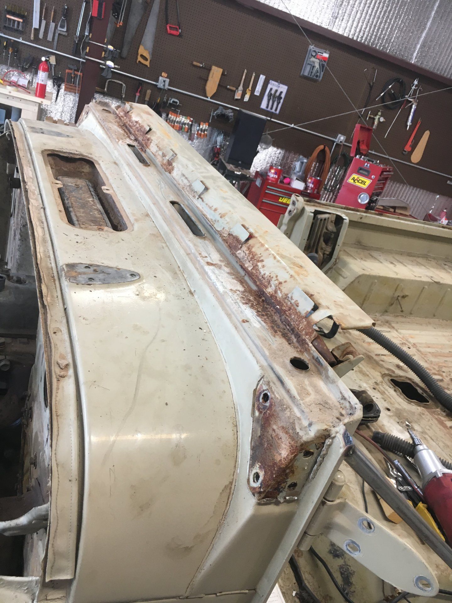

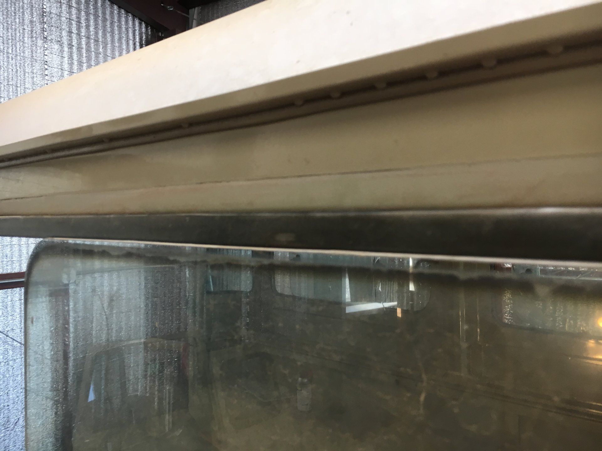

You removed the roof (fiberglass panel) and the side panels (window panels) together. You could’ve removed the fiberglass first then the two side panels individually.
seems like the roof gasket is not in place or partially missing. That is a 2” wide U shape rubber strap running under the fiberglass toof panel. Continue above the driver and passenger doors over the upper bolt on frames until the windscreen panel.
Maybe it is sticked to the roof panel or maybe its not there.. strange.

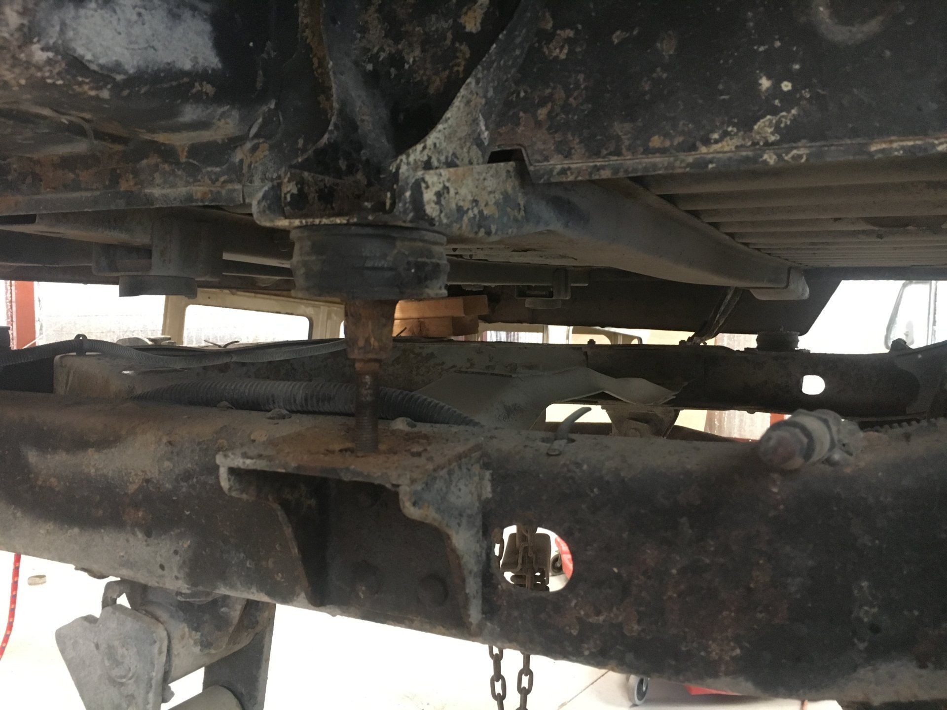

So today I drained the gas tank and started disconnecting all the remaining items for the final separation of tub from chassis. I did weld some temporary bracing in the door jams and I’m glad I did once everything was free there was quite a bit of movement between the dash/firewall and the rest of the tub. On my first attempt to lift I did find I missed the two mounts at the rear bumper got those disconnected and everything came free nice and clear.
I got it resting on blocks about 3 inches off the chassis and that’s it for today then I’ll figure out how I’m going to separate it fully support it while I start my work

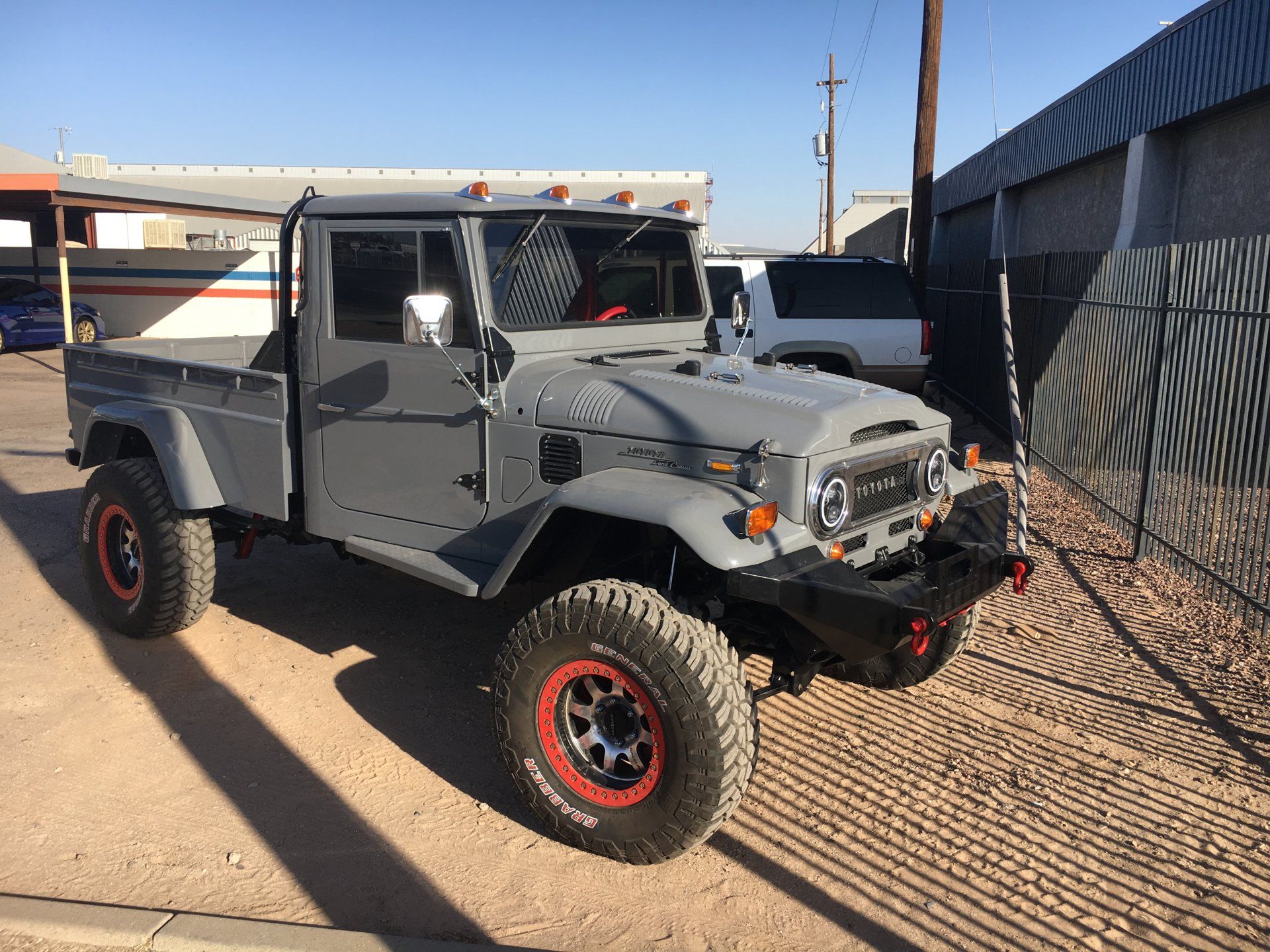

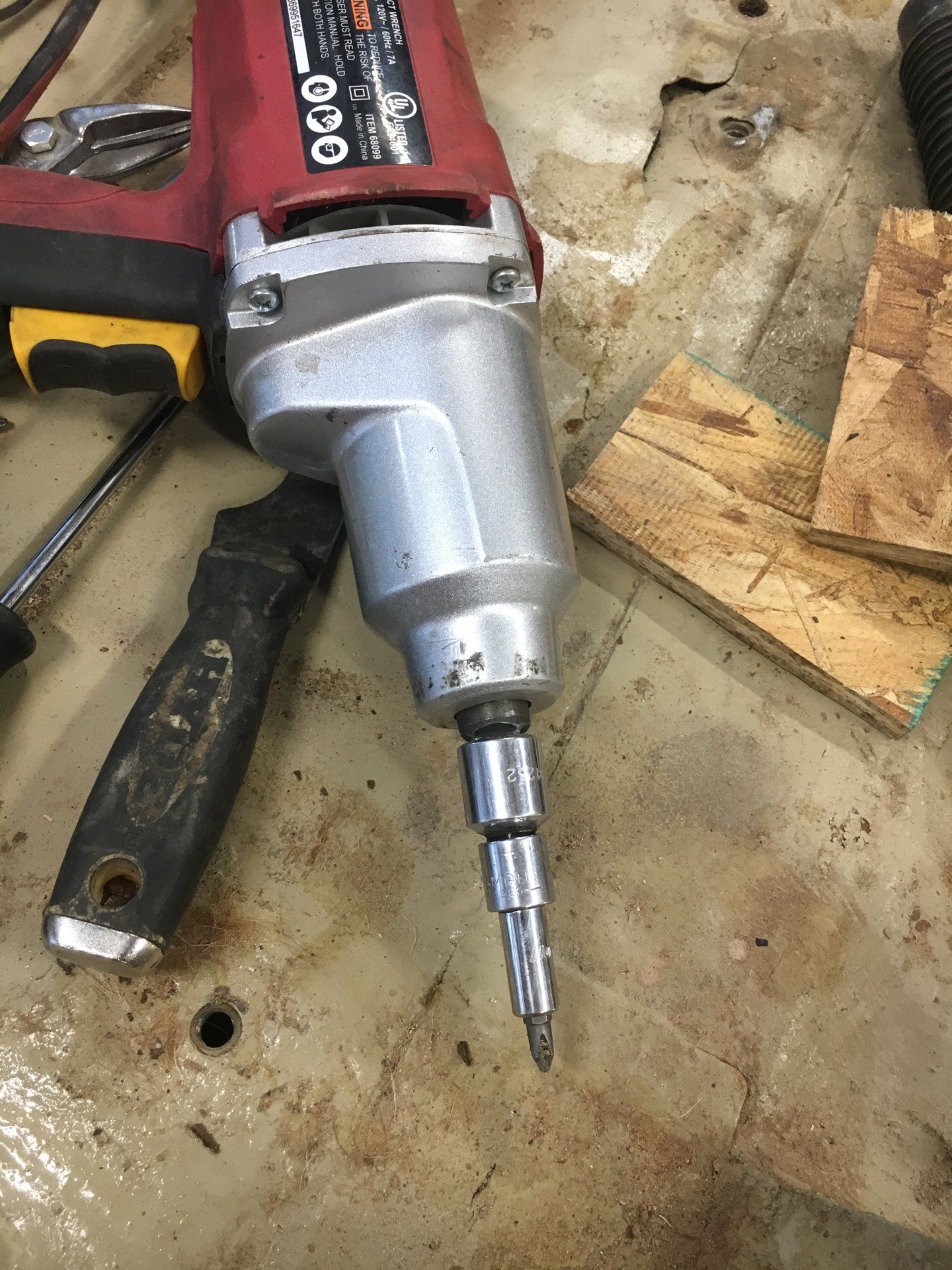

Good news, got the windshield screws out without breaking a single one. I was afraid to try it but the impact wrench actually work good with the right size Phillips head bit. Ran to the store to pick up an engine hoist and saw this sweet 69FJ 45 at a local hot rod shop

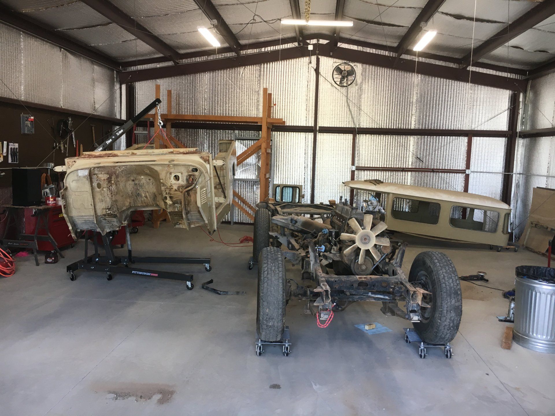

The pucker factor got kind a high on this one but I successfully got the tub off with no serious injury. When it was airborne I had removed everything except forgot about the transfer case shift lever. So I had to do a quick removal wildest thing was floating around other than that came up pretty safely. A quick look around the chassis and good news no sign of damage or rust all I have to replace is the front crossmember which was damaged in an accident and maybe the rear bumper just cause it’s kind of shady

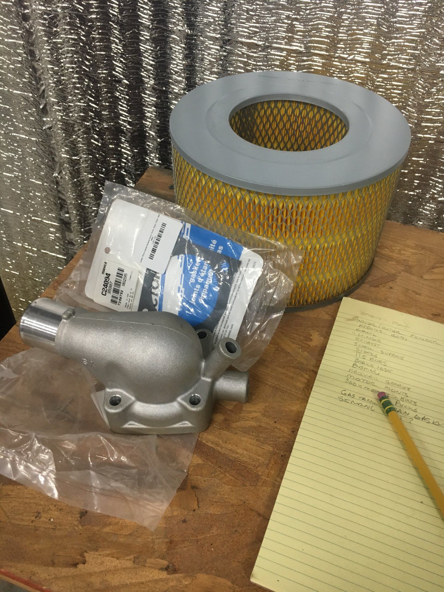

Got a nice package today. Love that new thermostat housing.

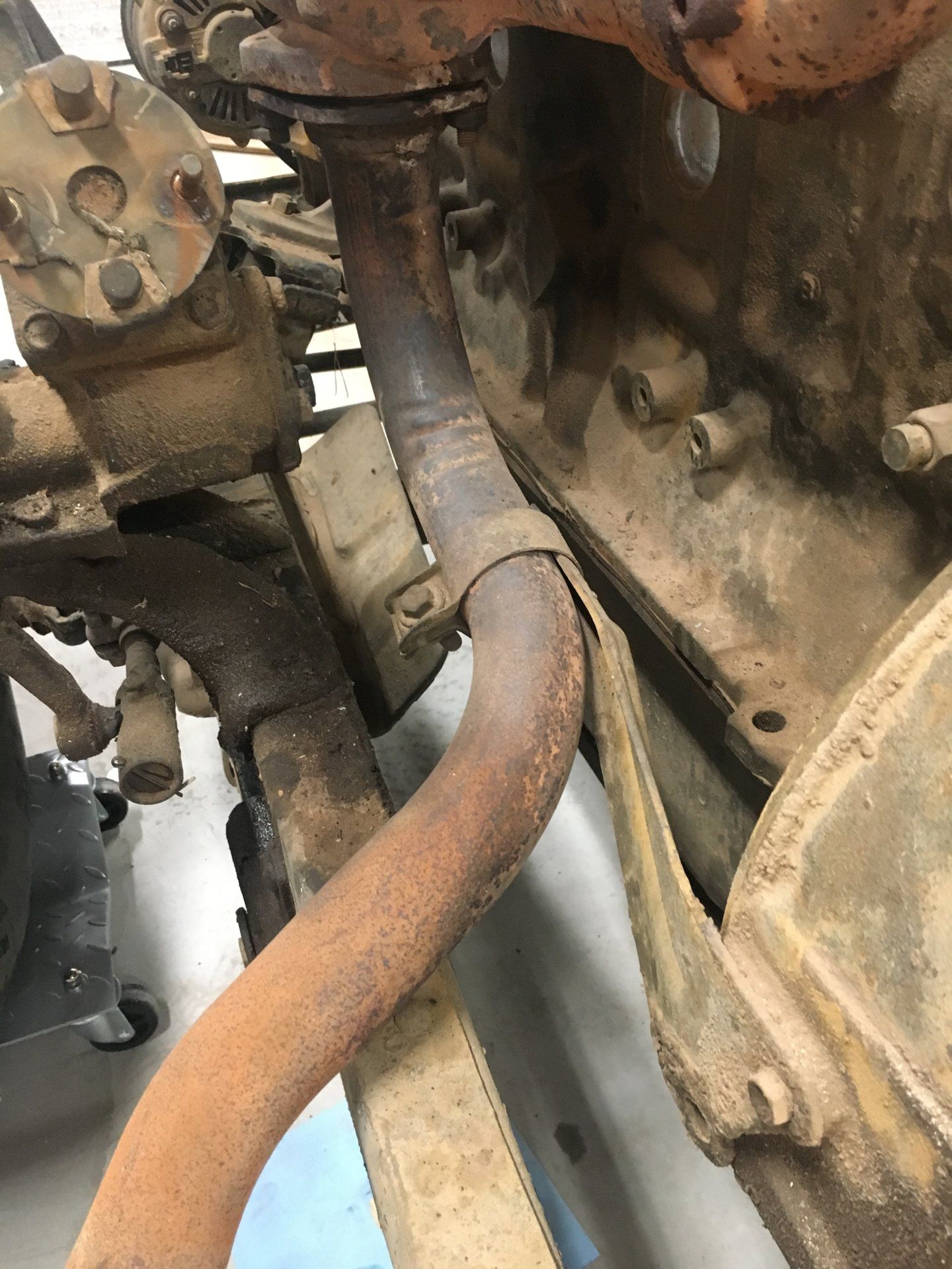

Does anyone know the proper routing for exhaust system?

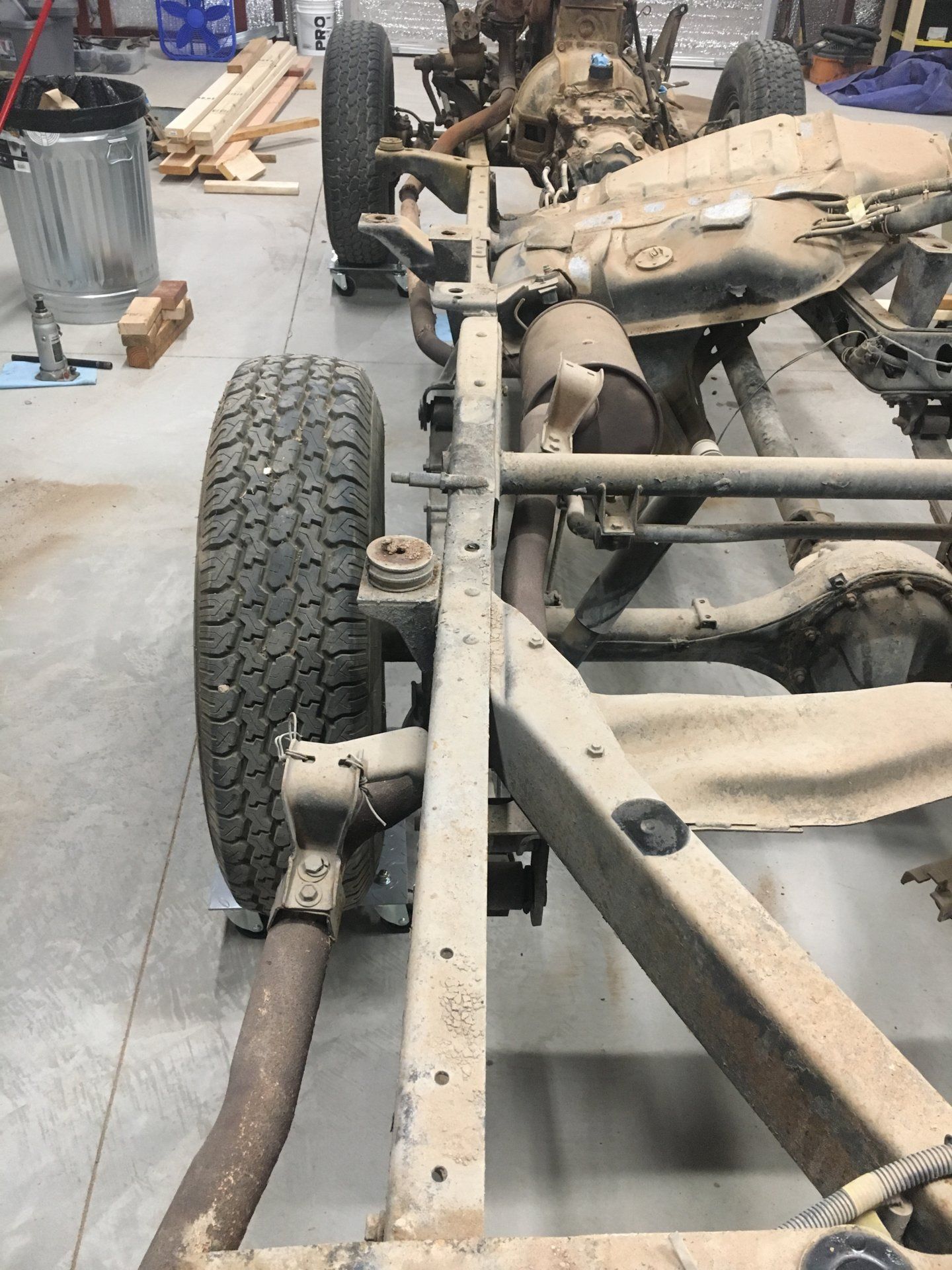

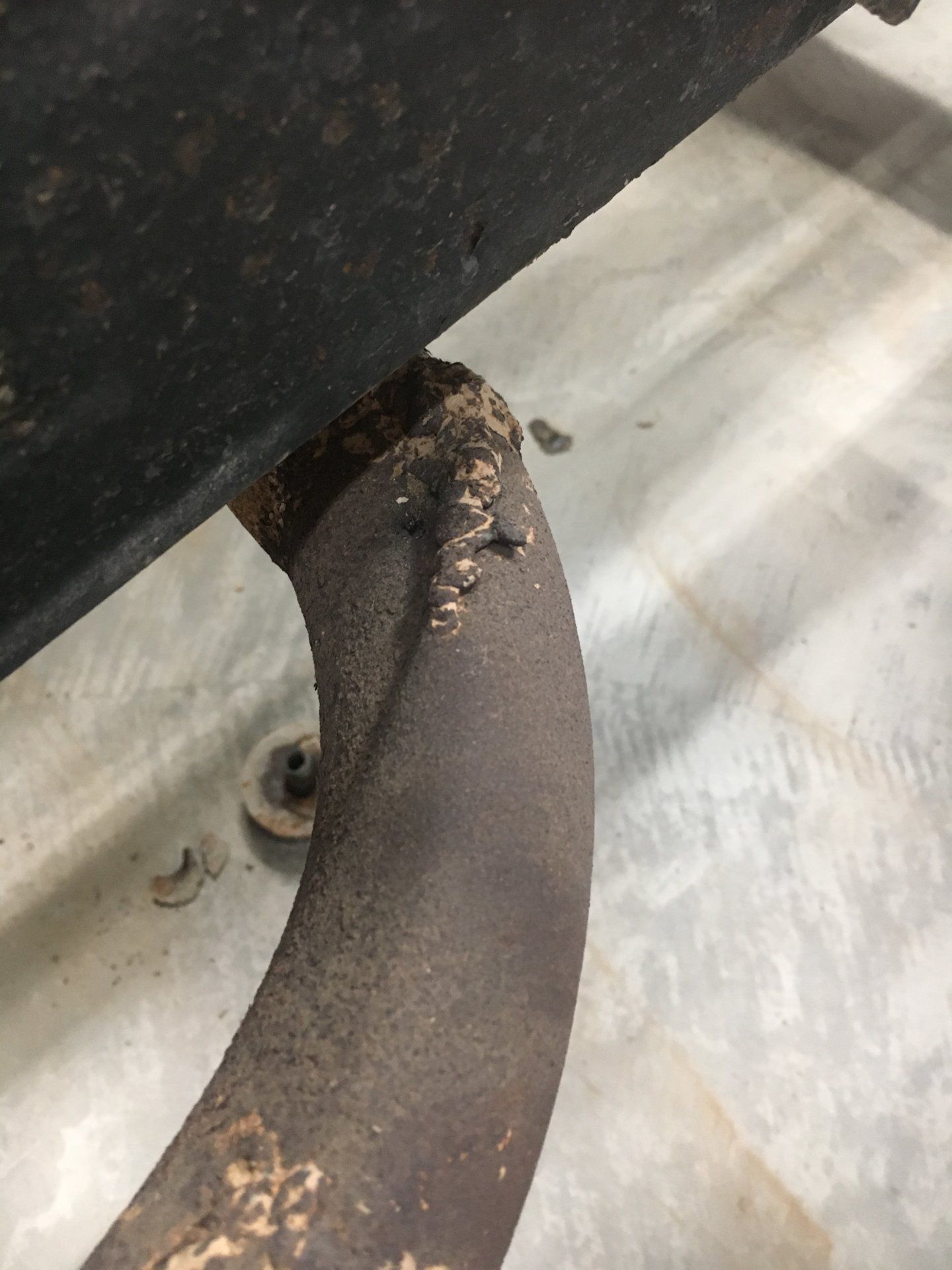

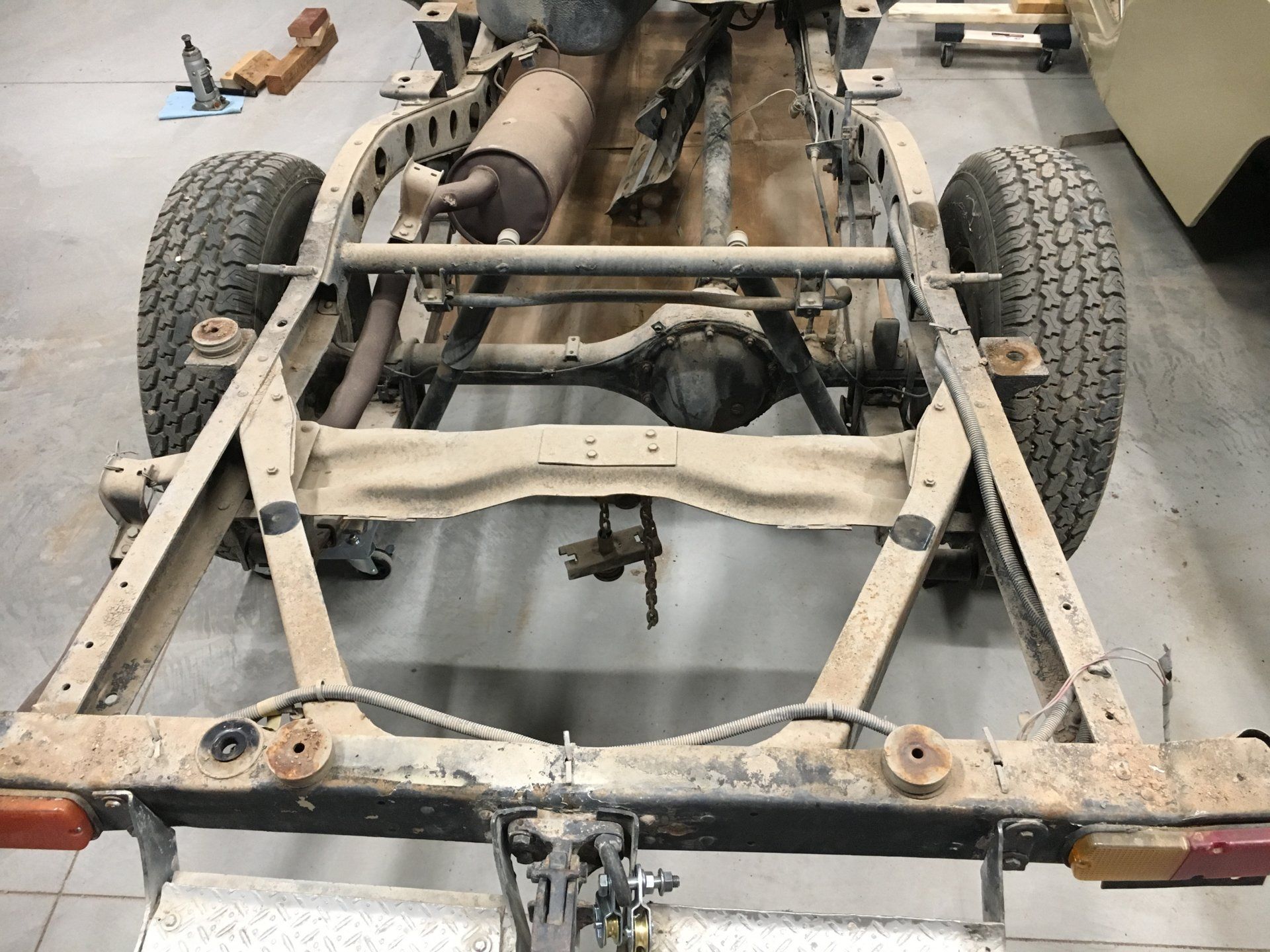

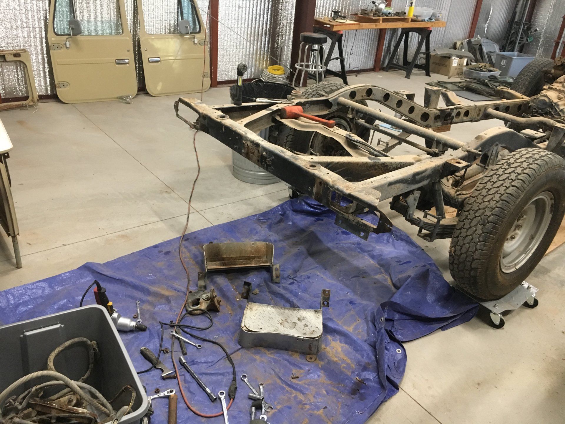

Not very glamorous, but necessary work today. Got everything south of the rear axle stripped off and the full exhaust system removed. Built a more permanent dolly for the body but I think I made it a bit too tall, did not account for blocking in bracing to level the load underneath it.

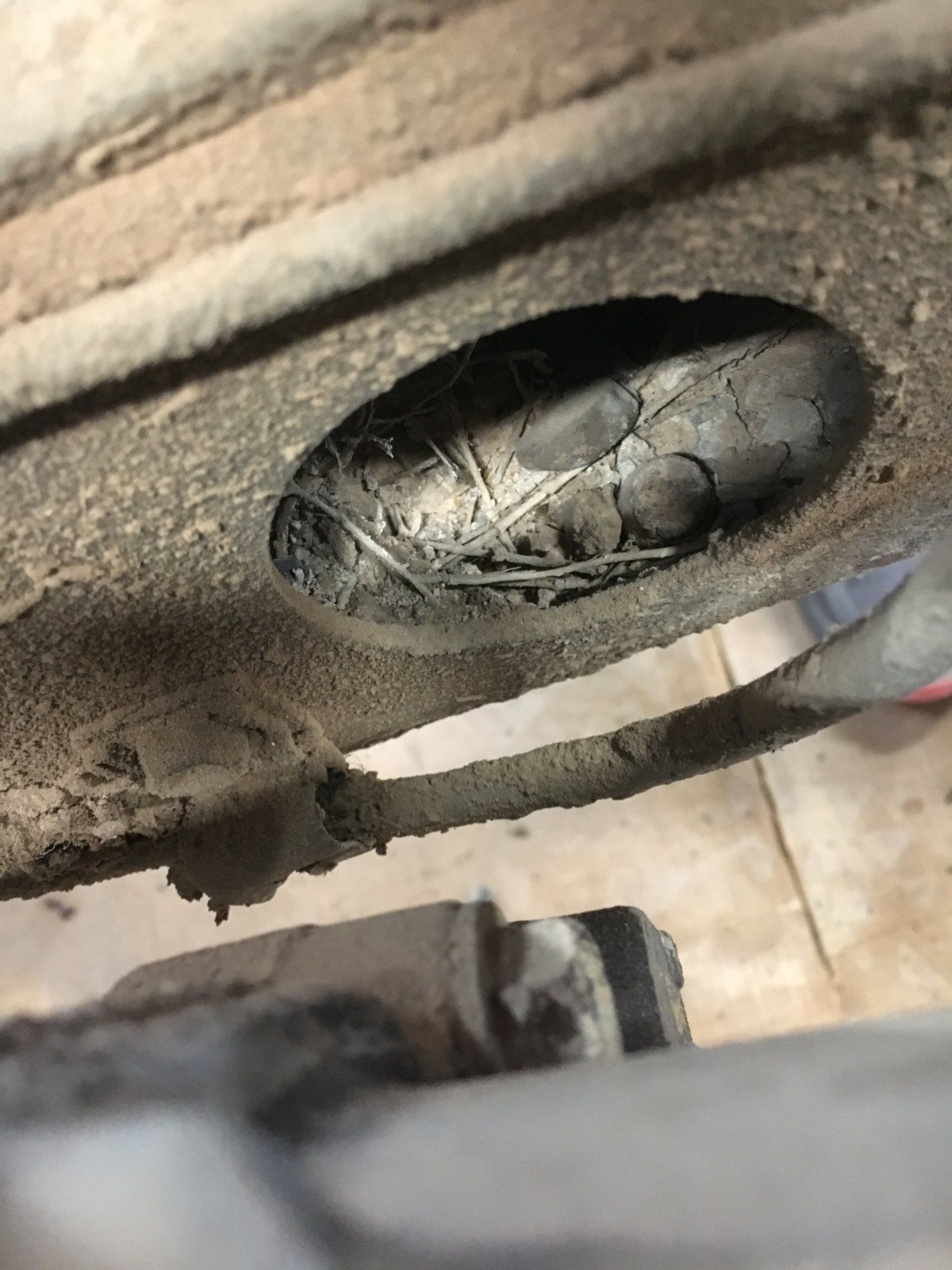

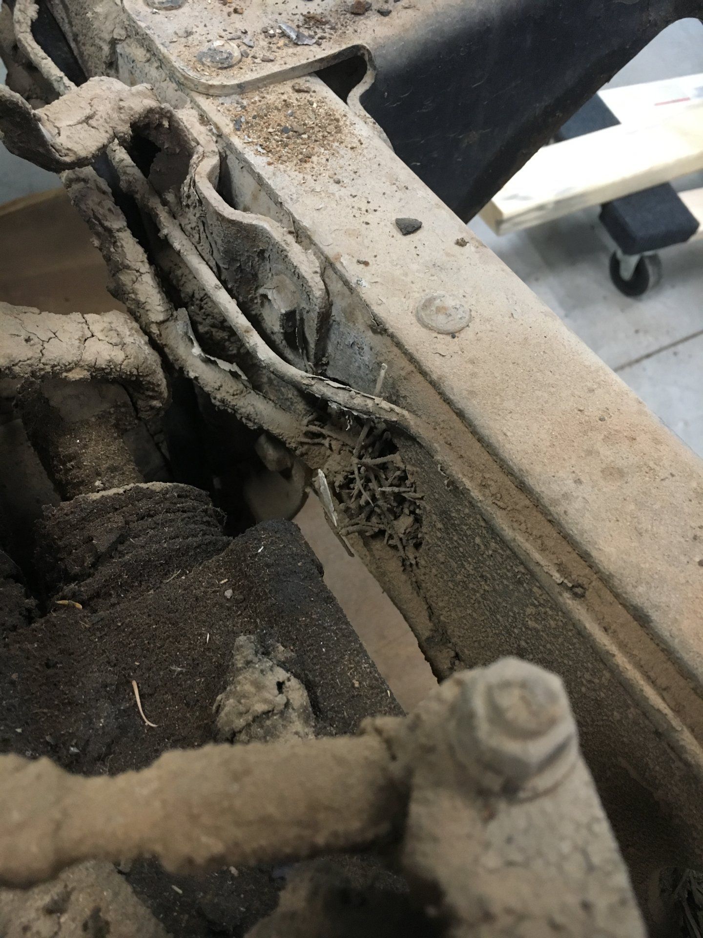

Found a funky little nest and nuts in the frame...
The more I see the more optimistic I am the frame will just need a clean up and paint
I have all of the steering components soaking and will tackle that and the engine removal next

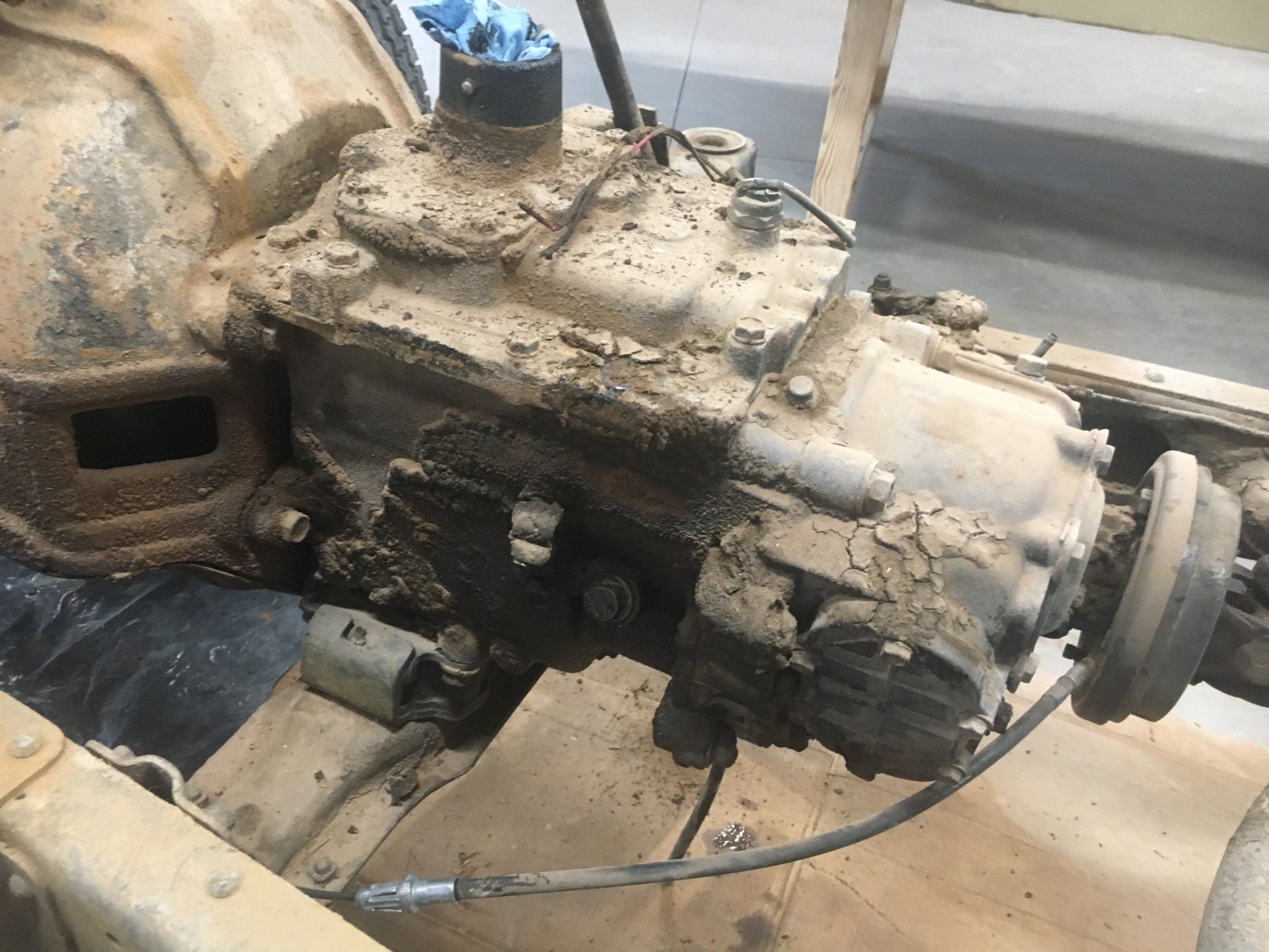

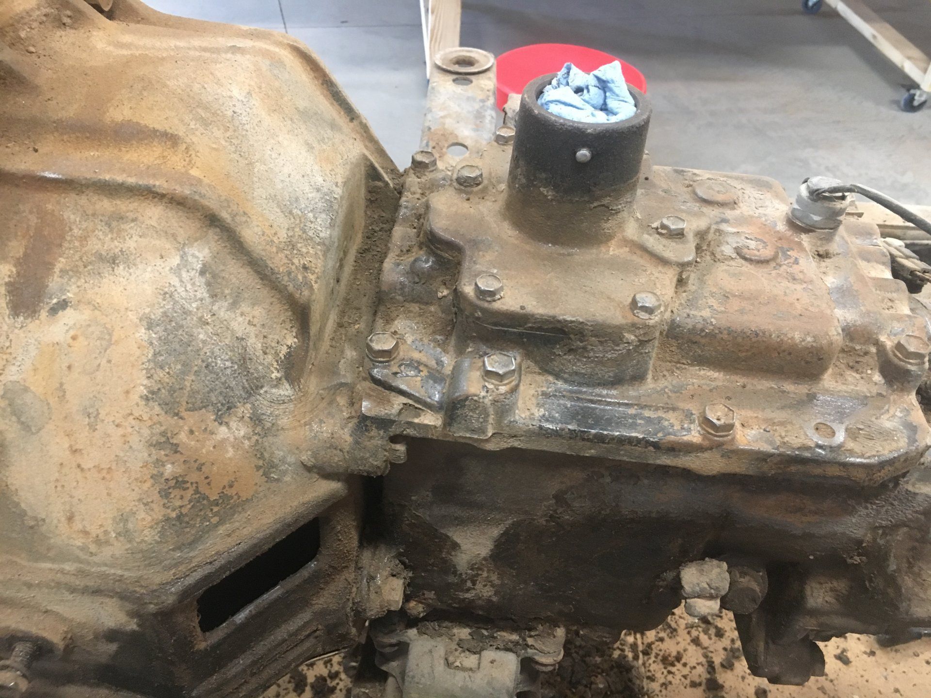

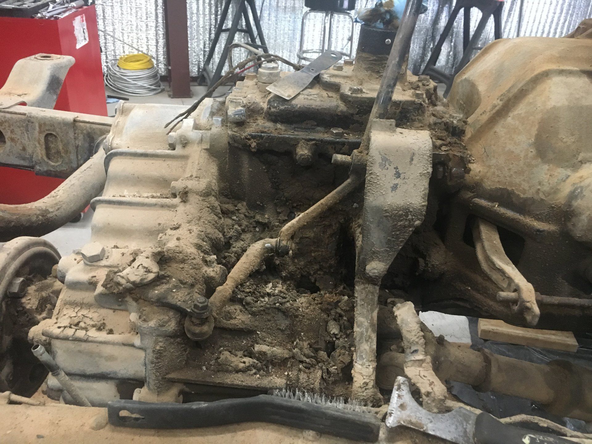

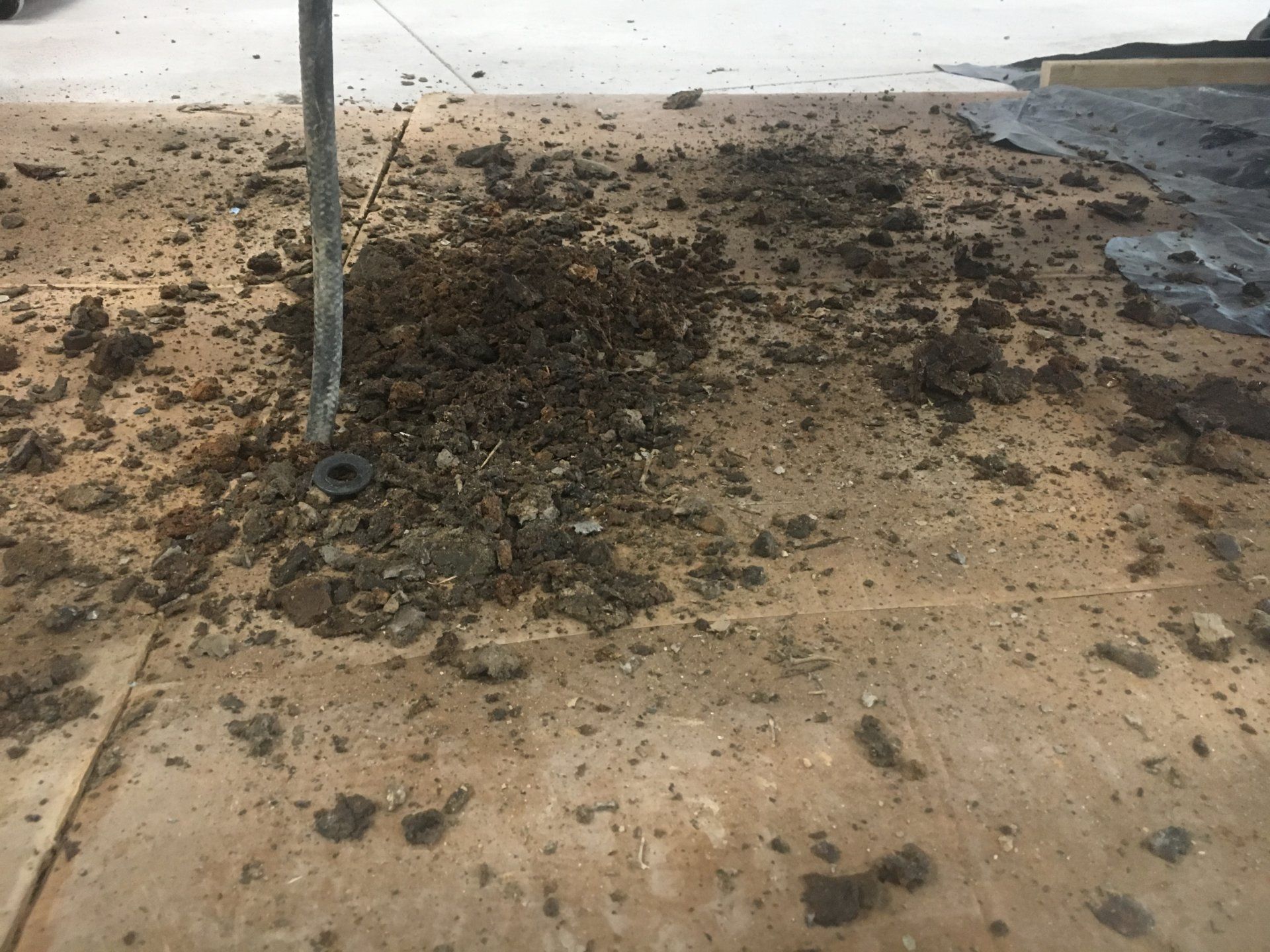

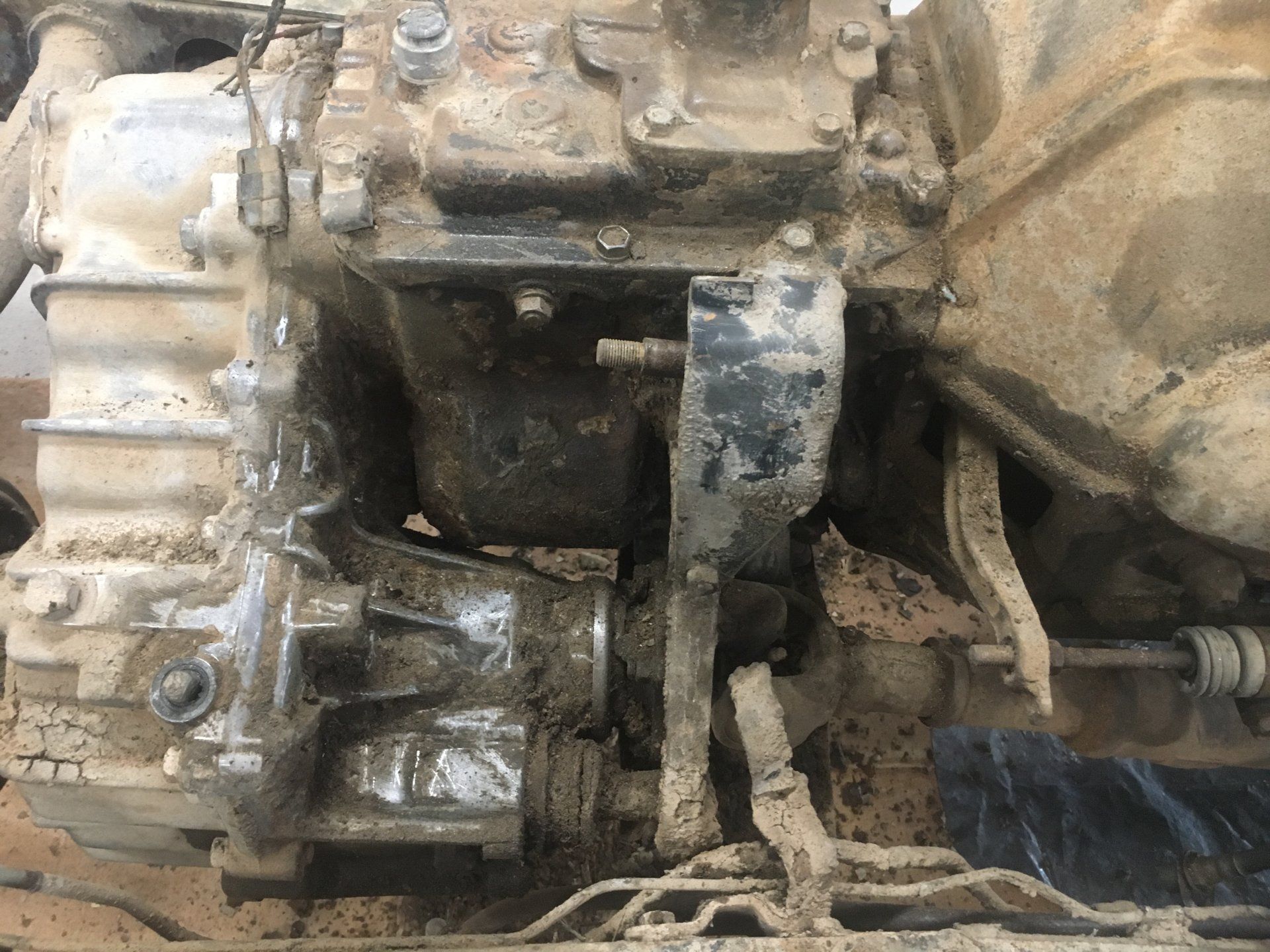

I gave my tired old back a little rest this morning and just started some cleanup. Overall it’s not too bad but there is a massive build up of oil and dirt over the transfer case and transmission. Did you know those are two separate units!!!!!!:p
At some points the crud was close to 3 inches thick down in the valley. I felt like an archaeologist I think it’s good enough now I can soak it in degreaser and pressure wash the whole thing when I move the chassis outside
