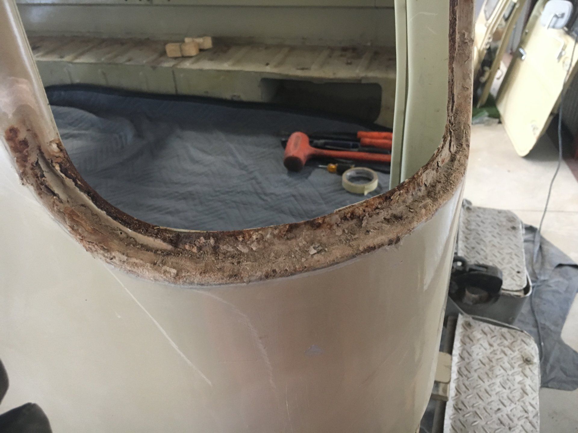

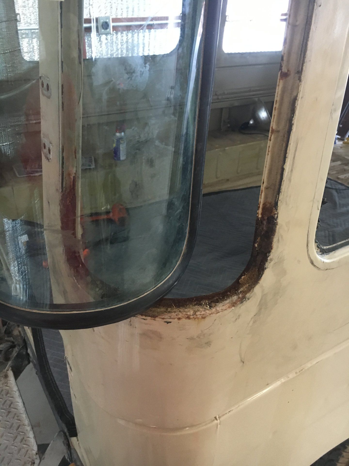

The morning got off to a great start removed all the glass the four sliders the two corners and the windshield with no breakage, that’s a good thing I could not find any write ups on how to get the sliders out so I’ll post that with some pictures later on. A little bit of rust on the corner cells but I think the metal can be saved will find out.

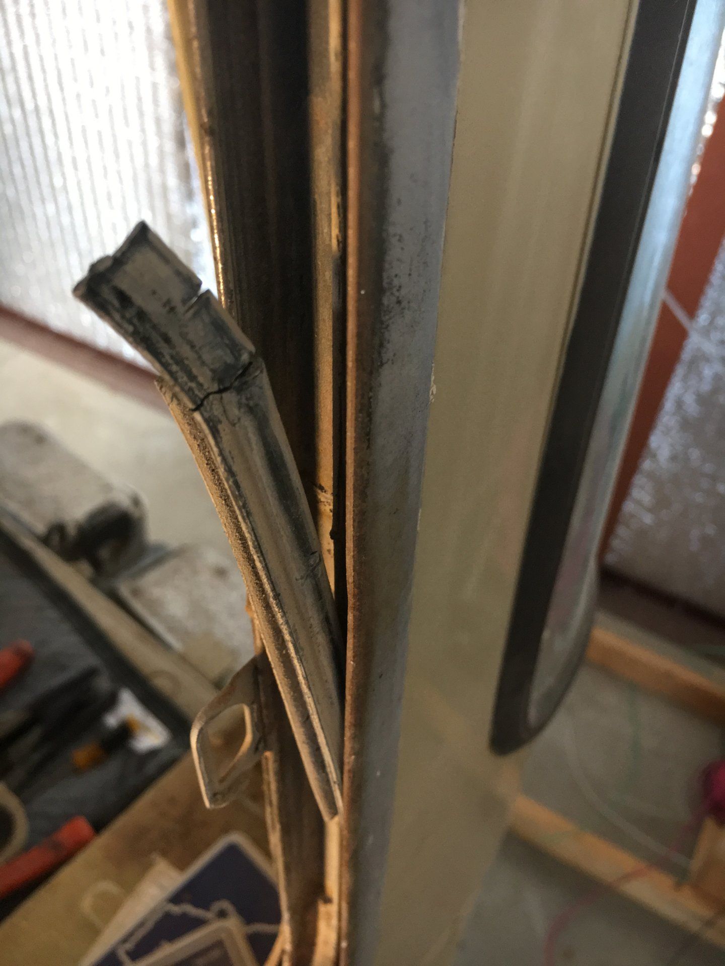

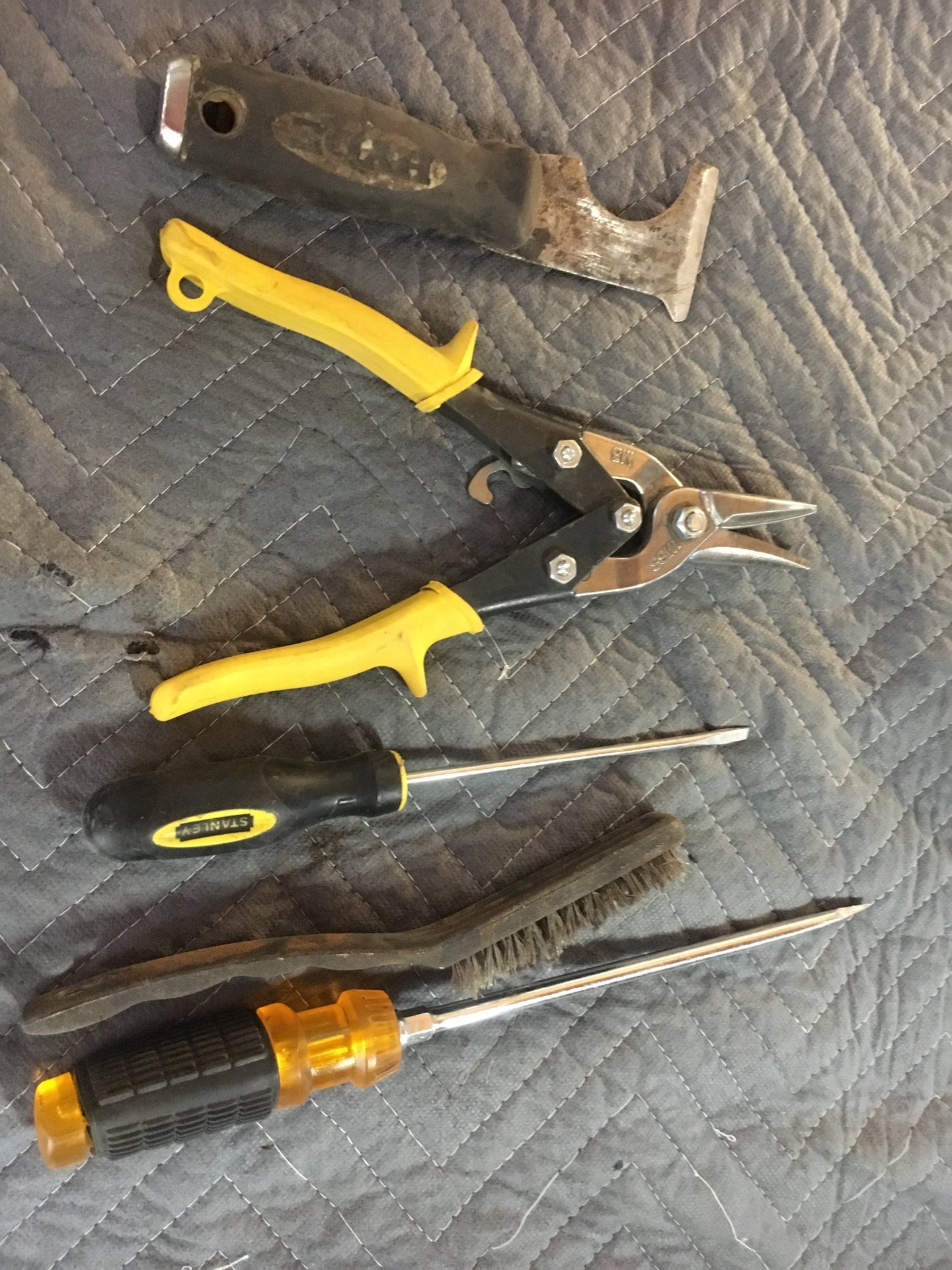

Here are the tools and techniques are used to remove the rear sliders. I love that painters tool to help it has many nice edges.

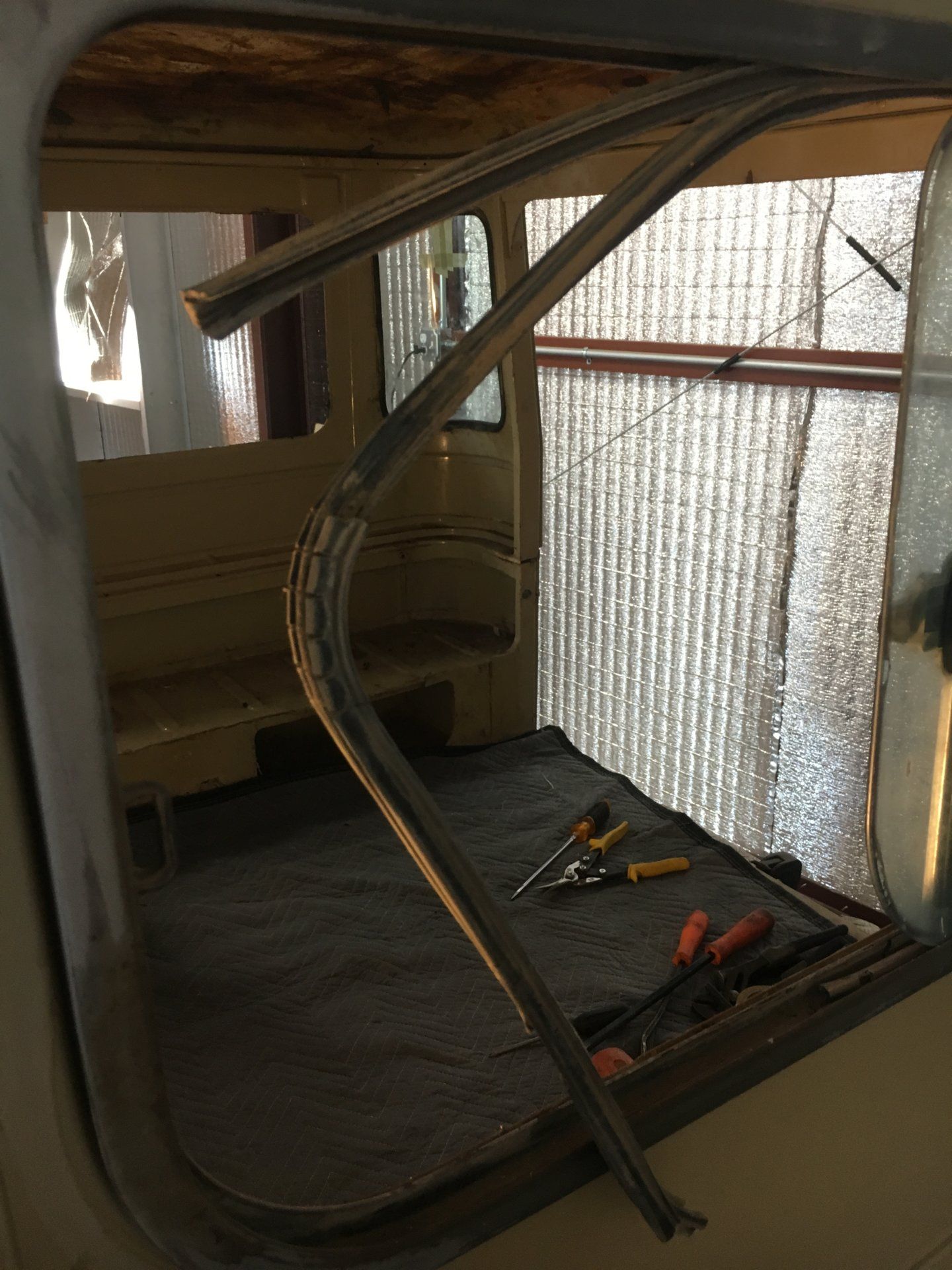

Slide both windows to one end and then start removing the weatherstripping. It is installed as one piece serving two channels but it’s pretty hard to get it out as one piece as it tends to split down the middle. The iner half comes out easy but the outer section tends to hook on the outside metal trim it’s tempting to pry hard to get it out but the metal frame is easily deformed so be careful.
Once you get the open side clear brush and vacuum all the debris away then slide both windows to the open section, don’t worry they won’t fall out by themselves. Continue removing the weatherstripping until it’s 100% removed and the track is cleared and vacuumed .
To remove the glass slide the outer pain to the center of the frame and you need to grab it in the upper corners and press down and gently push up on the metal frame it barely clears and he will have glass and metal scraping.
To remove the glass slide the outer pain to the center of the frame and you need to grab it in the upper corners and press down and gently push up on the metal frame it barely clears and he will have glass on metal scraping.
To remove the inner glass pane it helps to position it in the outer track then repeat the removal process.
Hope that makes sense if the previous owner didn’t gum it up with caulk it actually comes out pretty easy good luck
