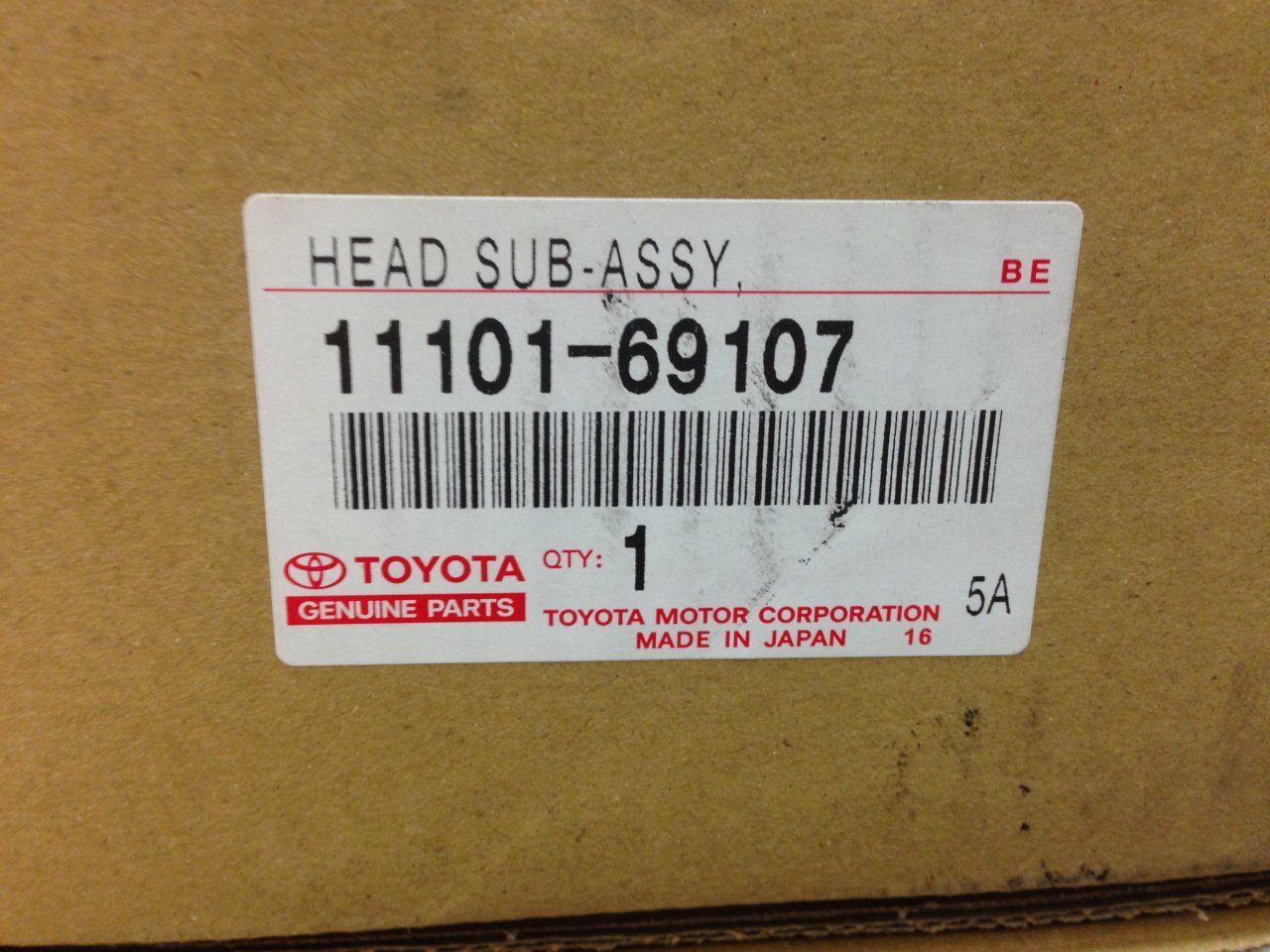

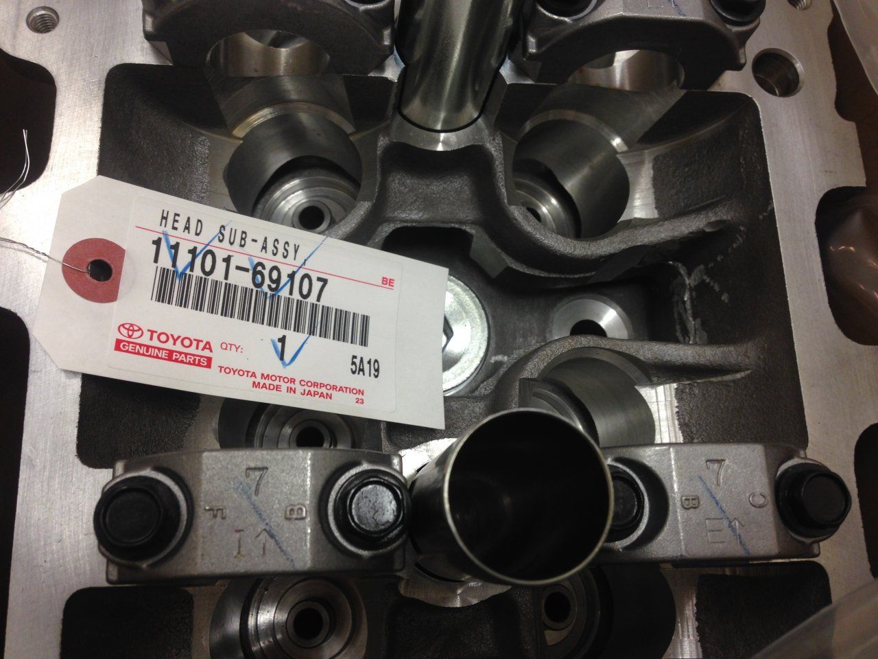

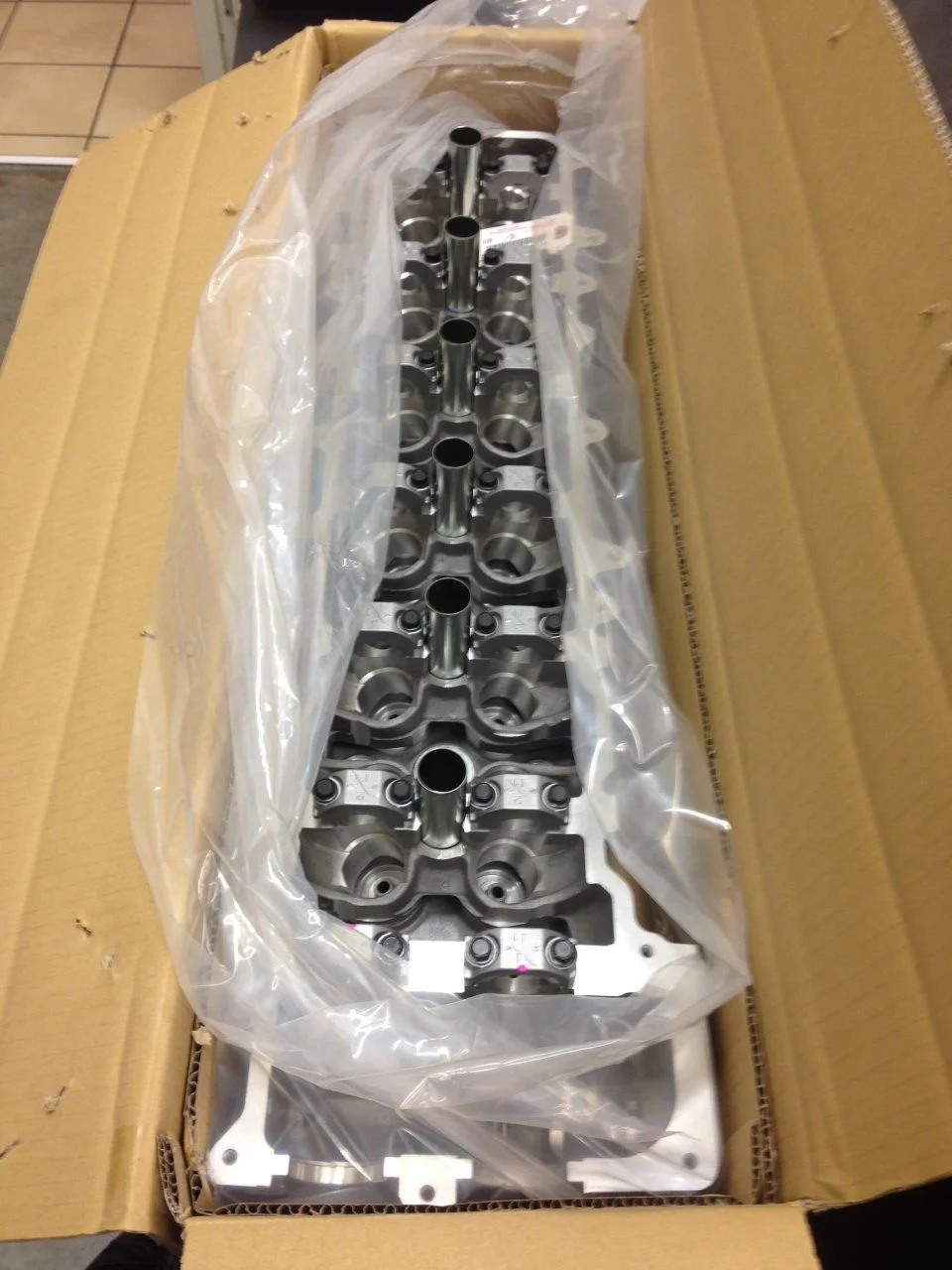

Well, look what showed up!!
A very nice hunk of Aichi aluminum....
Beautiful machine work....
If Beno can't do it because of work I will take some detailed pics before porting or polishing anything. Robbie's machinist wants to send it out for some crazy new kind of port and polish job. So we will see.
Show us the chamber side and the runners of the head! I want to see! I want to see!
I ported and polished a set of SBC iron heads many moons ago. The Toyota head is already cleaner than that was for sure.
