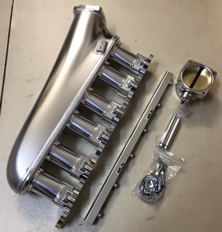

Whooo wheee that is nice!
Did you ever figure out the coil pack setup to get rid of the distributor and go crank trigger?
Yes in my opinion they are the very best option in the 2JZ world, so it just made sense to pressure them on the 1FZ...

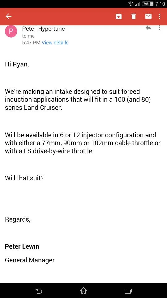

Plus like I said in my other thread when I started talking to Hypertune months ago, this will make it much easier to run an air to air intercooler since it puts the intake inlet on the opposite side from the turbo outlet.

That's great. Nice of you to pave the way for the rest of us!
Well that isn't my exact manifold, just an example of the quality they put out. I have asked for mine to have direct nitrous ports... ha.
Well it isn't really for the rest of you. You're just lucky it is what I want. :flipoff2: lol
