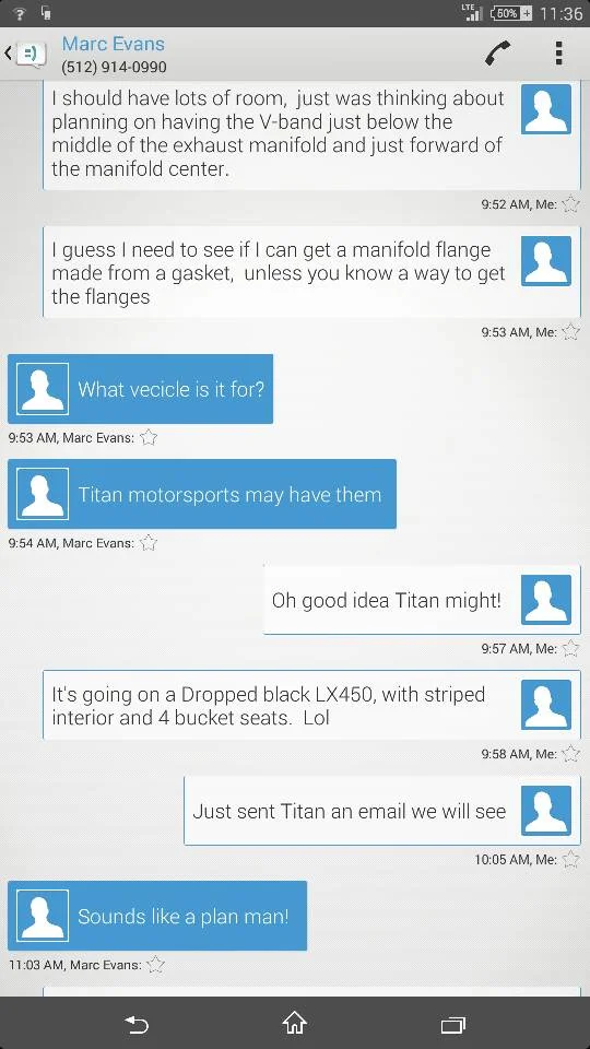

Was a little worried about trying to find someone semi local to do a real quality turbo manifold for me. But my good friend Marc is going to take a break from making Viper twin turbo manifolds and take a stab at this old crazy truck idea!! Very pumped to have what I think is one of the best fabricators I have ever seen on-board!

Between here and Denver. I will be using an engine builder that Slee recommended over in Denver. The transmission builder is in FL. The turbo manifold fabricator is in Dallas. So I guess it is kind of being built all over and bolted together locally. lol.
