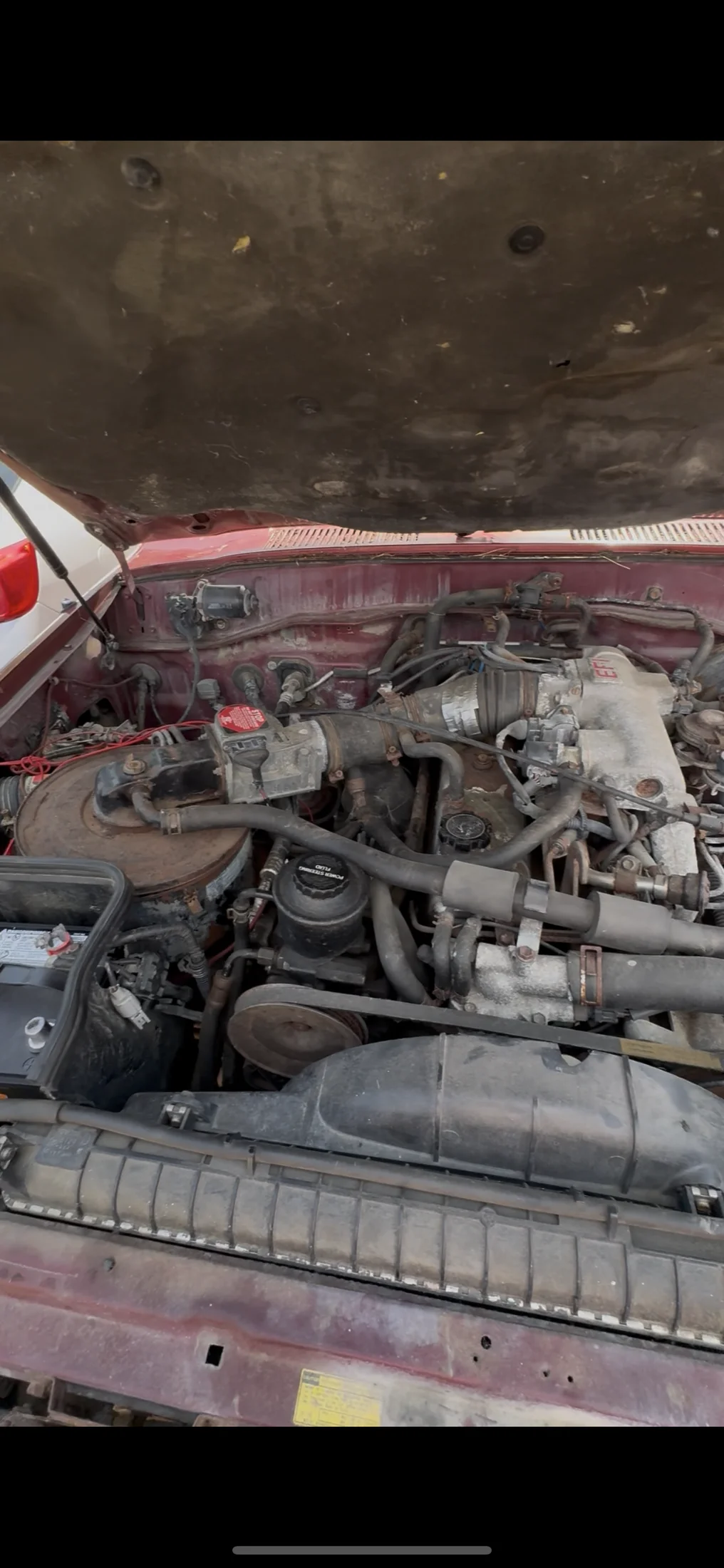

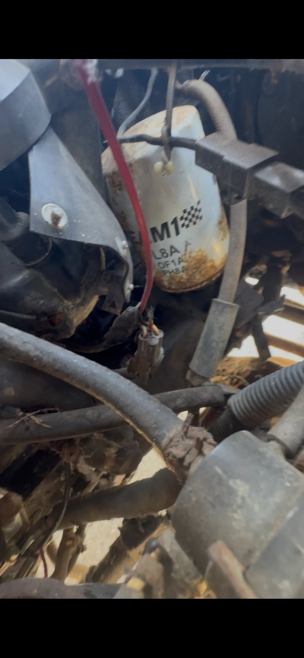

I recently picked up a 1992 LandCruiser 80 series (3FE) for $1,400. It has been sitting around outdoors for at least a decade. Guy I got it from got it from a buddy who’s late father owned it so nobody knows anything about it. Guy I got it from said it ran on starting fluid up until after this winter. I replaced the fuel pump and jumped the B+ -Fp and i can here fuel both at the tank and at the block but haven’t checked my injectors. It cranks with a jumper to the starter and has a bad starter solenoid.. bypassing that for now until I get it idling. Due to the crank/ no start I replaced spark plugs to no avail. I ordered a new distributor cap and rotor so we’ll see if that changes anything.. also replaced fuseable link. EFI relay seems okay, when key is in “on” I get CEL, voltage, headlights, horn, doors, ect… key switch doesn’t work so i was using a jumper from the solenoid to the battery while in run position to get it to crank. The wire that comes out of the bottom of the distributor and goes to the starter solenoid has also been spliced off and is hanging out of the hood. Again, I’m wanting to get it idling before replacing my solenoid and fixing the ignition. Big question.. Why am I not getting spark? Won’t run on starting fluid, don’t want to kill my starter.
I am new to working on cars and have never owned a Toyota before so I’ll take any help…
164k miles.

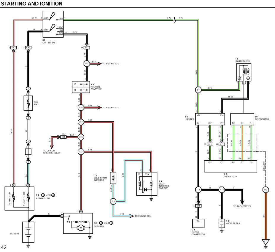

Nothing from the distributor runs to the starter. Download the Toyota FSM and EWD from the resources section.
If the distributor wiring has been modified/molested then that's likely your issue.
Spark is developed from the pick up coils inside the distributor which feed pulses to the ECU. The ECU then feeds pulses to the igniter which feeds the ignition coil.
I would verify that you're getting +12 to both the igniter (pin 3) and ignition coil (pin 1) since that +12 runs through the ignition switch.
The igniter/coil combination lives in a bracket that provides ground. If that bracket is not securely fastened to the body, then you won't get spark.

The red wire coming from the distributor connector had been spliced off so I reconnected that to where it should have been and adjusted my timing by rotating the dizzy a bit. She fired right up without fluid after years of sitting!! Idles at about 600 rpm..
