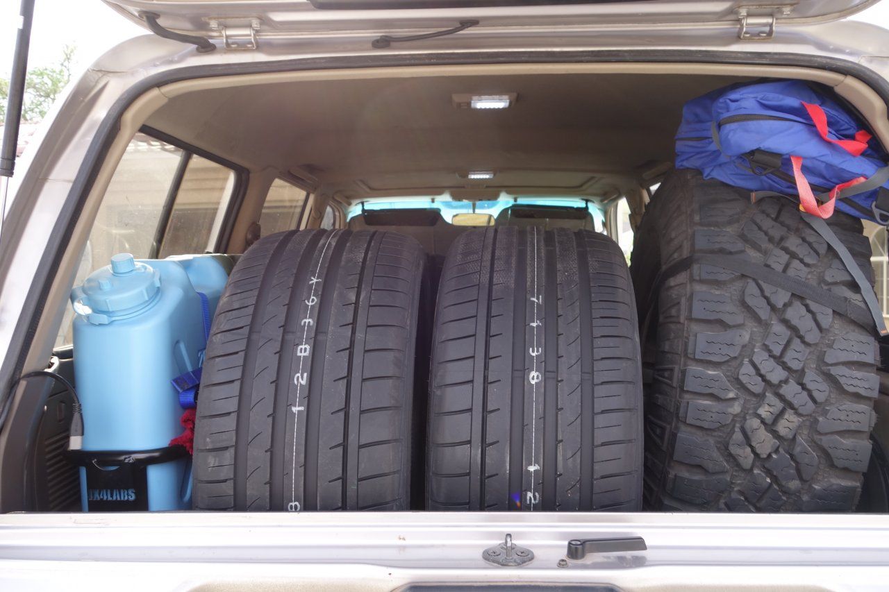

295/40 R20 so about 29.3" overall height, it is right at 1.1" shorter than the 295/40 R21's I planned on running, but I think having the Volk's will be cooler than having custom cut wheels and will make up for it.
But it is about 2" shorter than the stock OEM 80 series 275/75 R16.... might be too much. lol
Still no luck finding the right Black LX so I will pull one of my Duratracs off tomorrow and mock up where I think it will sit in the wheel well and see how it looks. It looks like a hell of a tire. And it is cheap enough I can pull the front driveshaft and do wicked smokey burnouts. haha.
Stock Mich' were 275/70r16 :flipoff2:
