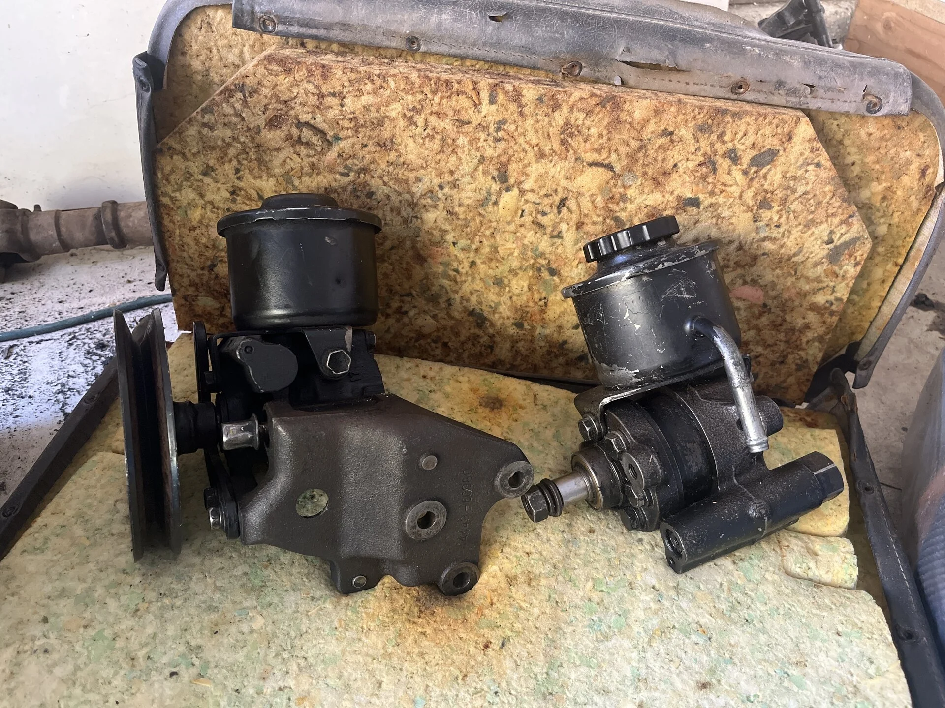

I’ve got a 60 series and an 80 series pump. I’m doing a PS conversion on my 40 w a 60 box. No, I won’t use a Saginaw pump- stop it.
Between the 80 and 60 pump which should I sell and which should I use?
The 80 has a pulley and mounting hardware and the 60 does not but I can buy/fab it.
From what I gather I may have a hard time mating the 80 pump to 60 box. Is that right? If so it’s a no brainer. I’ll go w the 60 pump.

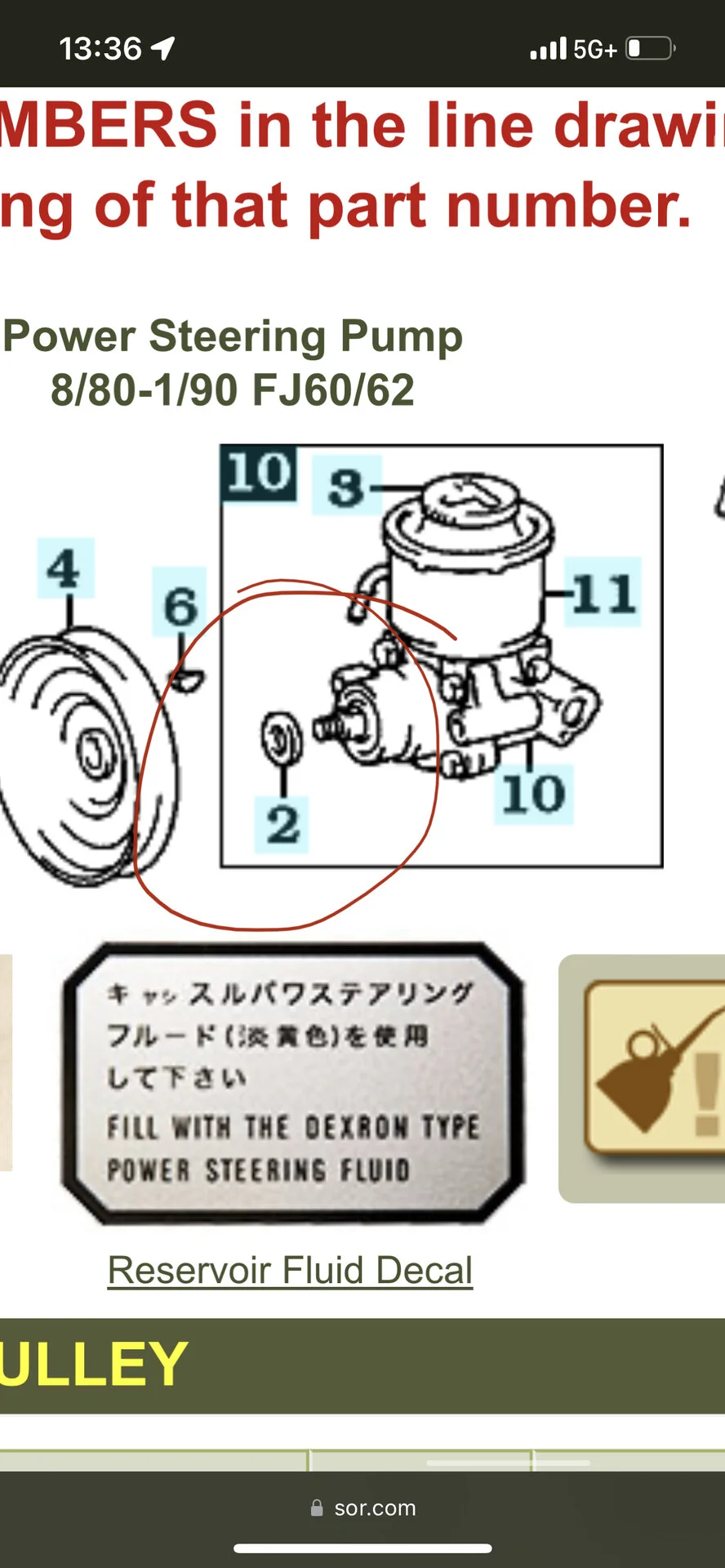

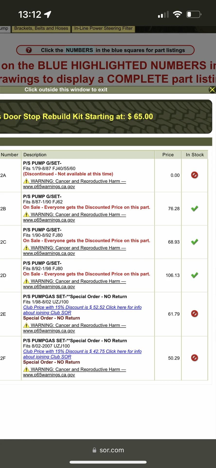

I’m seeing a rebuild kit on $OR, for the 60 pump. I’ve also seen a few forum posts were people reference rebuilding them. What makes you say it isn’t rebuildable?
There are rebuilt 60 pumps available- but they only last a year or so. There is a critical bushing that seals the shaft that Toyota never made available separately- and that’s where the failure and leaks start.
Maybe things have changed in the last 5-10 years, but I doubt it
Are you talking about this guy?
A '78 2F can only use a passenger side pump (3F/3FE) if the original head and not using fancy aftermarket brackets for driver side. Otherwise you have to adapt a 60 series pump to the driver side.
A 80 series pump would have to be a 3FE pump as it is the same orientation as a Fj62...which is then the same design as a Non-USA 3F.
My recommendation if not using 37s or larger would be 3F/3FE pump mixed with minitruck/fj40 steering box and custom hardlines across frame under radiator like factory. Then move the alternator to the lower driver side with F/3F bracket. If you use a late 3FE bracket you can upgrade your alternator to a nice Denso reman from Toyota as well.
A 60 series pump can be rebuilt with OEM parts but @OSS is correct as the internal bushing needs to be machined by a competent lathe operator....very doable, just requires extra work than a reseal and bearings.
