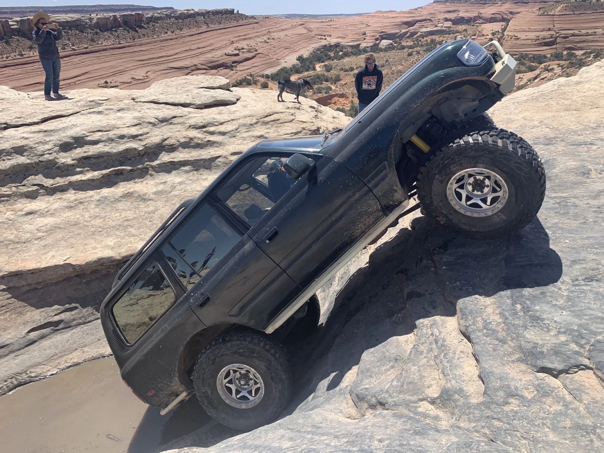

Personally I’m on 39s and a 2.5” lift with lots of cutting 😉View attachment 3163794

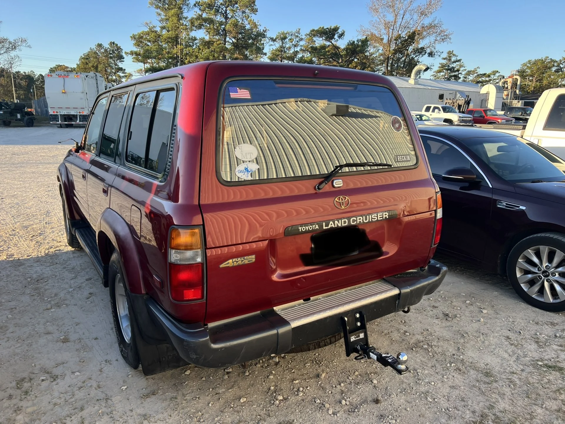

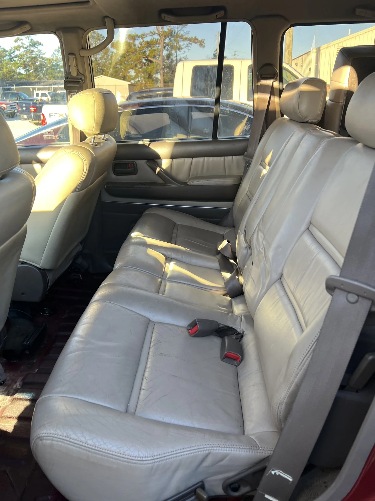

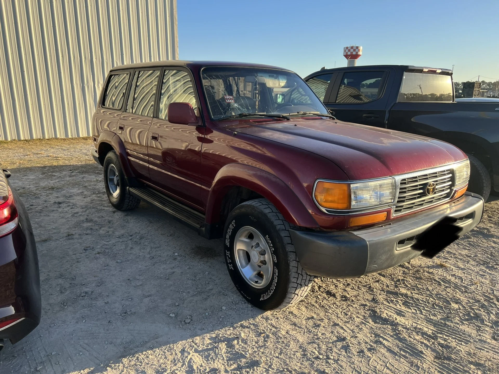

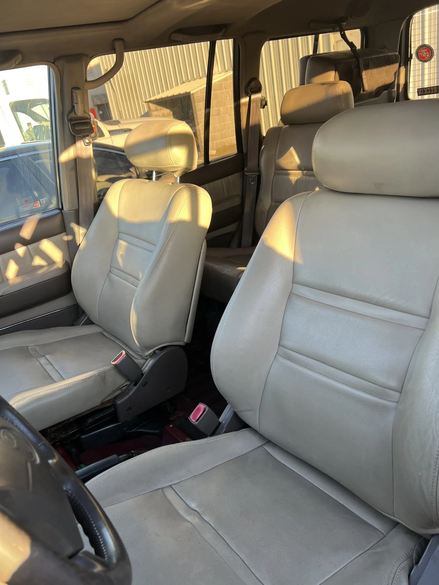

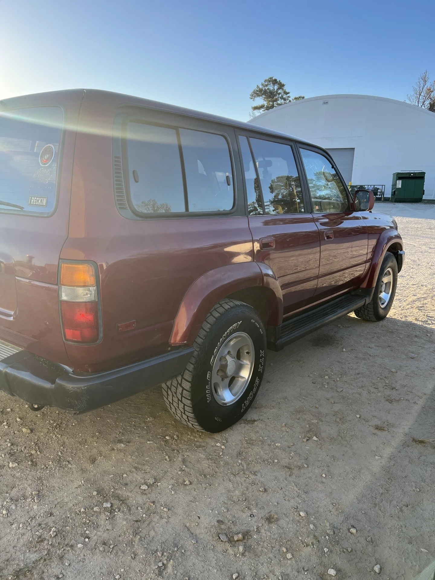

Also: some pictures of what I’m working with, picked it up for $1000 with 300k miles😊
