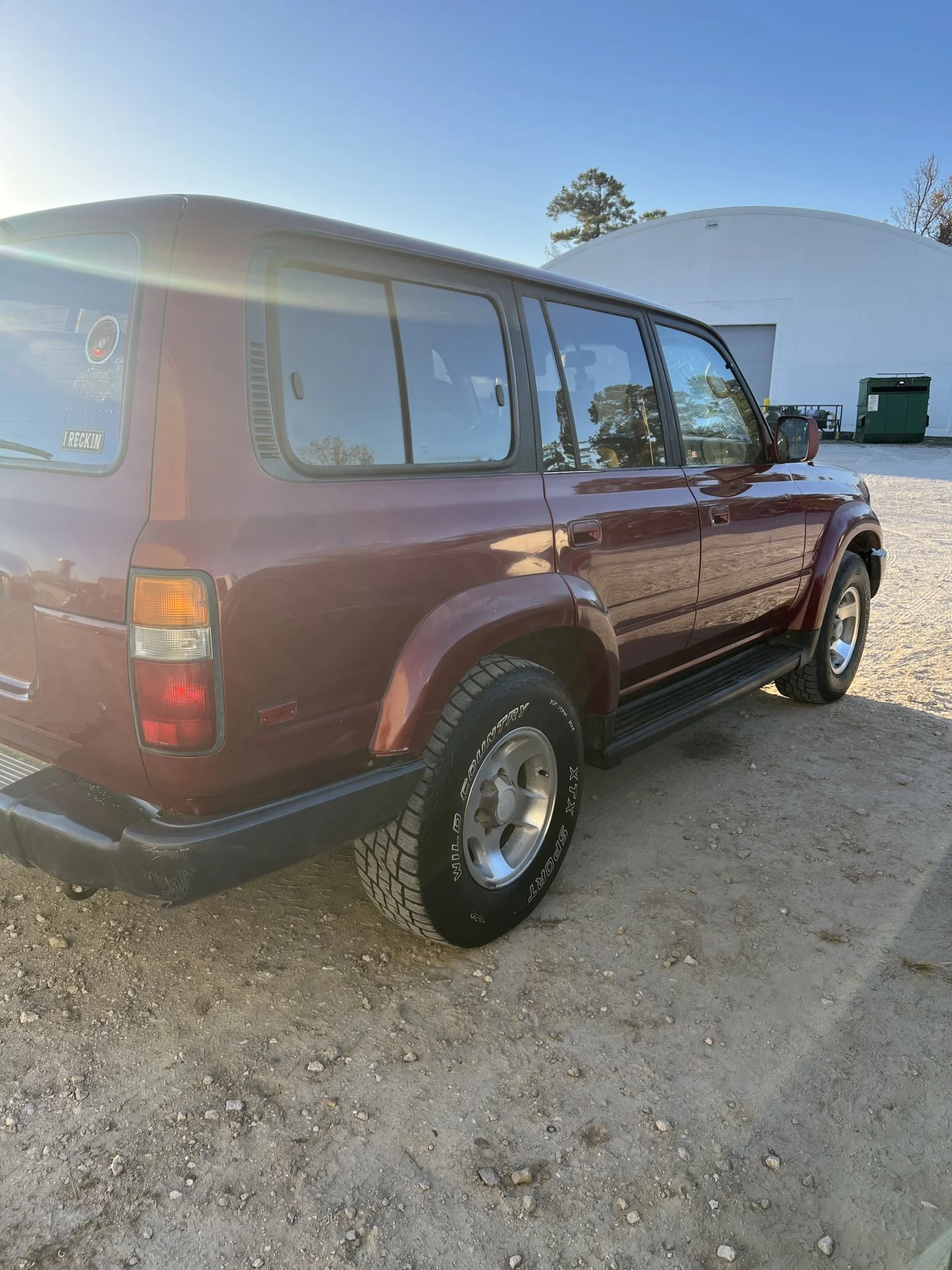

I hope to make it clear that I am not only new to the forum but to the 80 series community as well. Just to preface, I have a 1997 fzj80 and am looking to get either a 4” lift or a 6” lift with either 35” tires or 37”tires. Which configuration would be best for all around off roading with the potential for more as I become more experienced? And with a taller lift what supporting modifications or parts are necessary to make it work best. I’ve been researching some lift kits and they seem to bring nearly everything needed for a 4 or 6 inch lift however I have noticed the need for some additional parts such as an extended drive shaft and steering arms. What are the consequences of not having some of these parts ? And what else might I need ? I am well aware of how expensive this can get however as I said I am planning for the future once the LC is as mechanically sound as I can get it. ( sorry for the long explanation just wanted to provide all the info I could to better explain my question)
Also: some pictures of what I’m working with, picked it up for $1000 with 300k miles😊

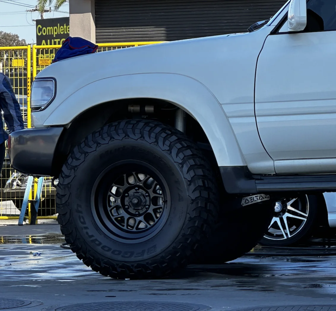

40s. No lift:
2" lift and 35"s.

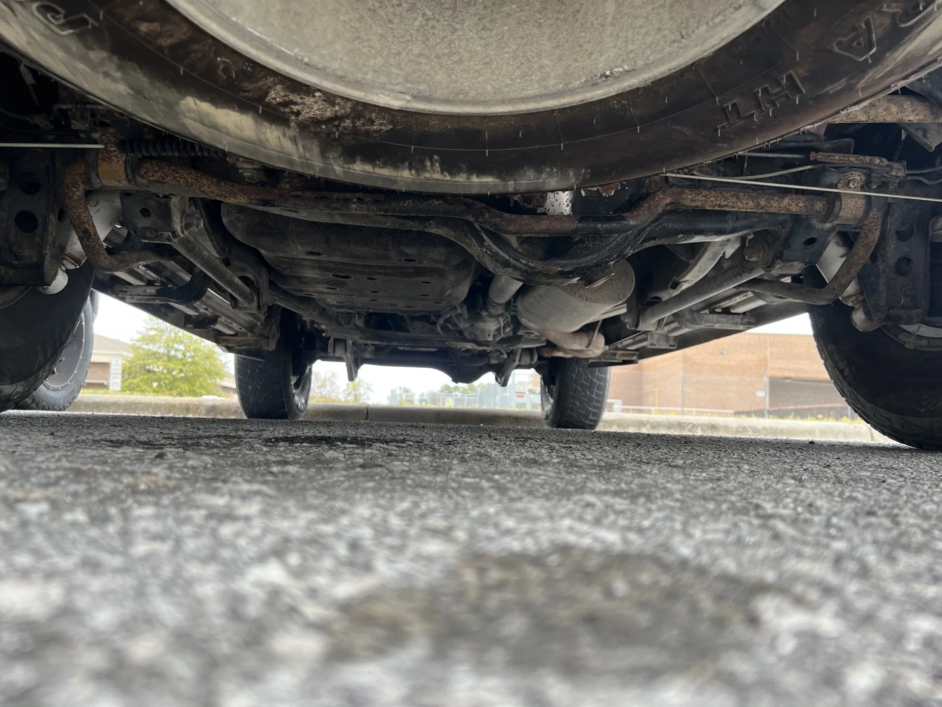

Nice fond for $1000! but for that much there is probably a reason and you forgot the important pics, under the 80 and the engine bay!

I don’t see anything Alarming under there.

I went from 33s to 35s to 37s while keeping the same OME medium springs at 2.25" of lift.

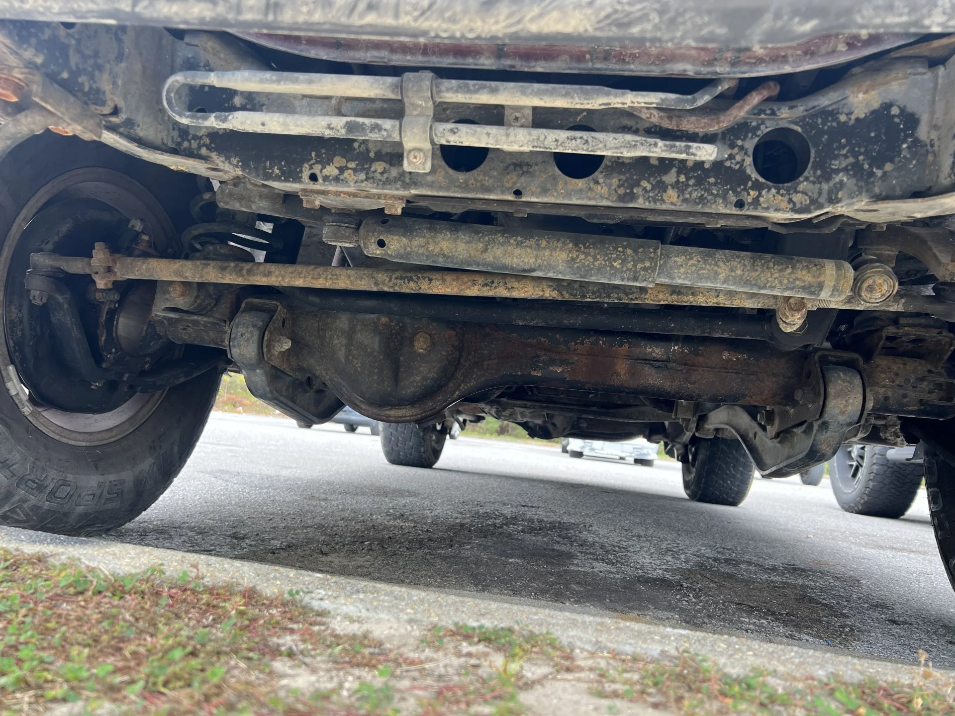

Can't really see the knuckles, are they dry? Check to see grease level inside. Search on knuckle rebuilds.
