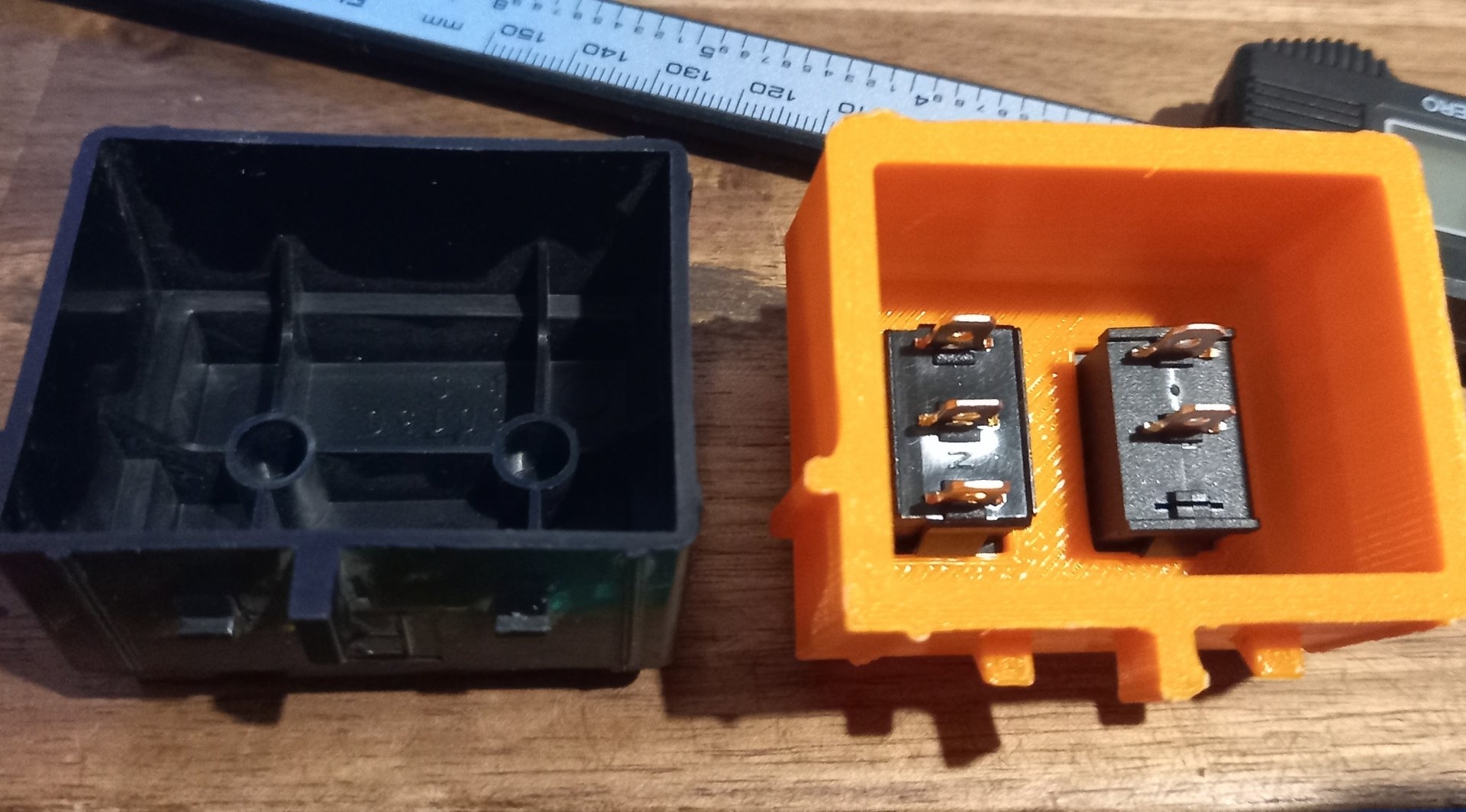

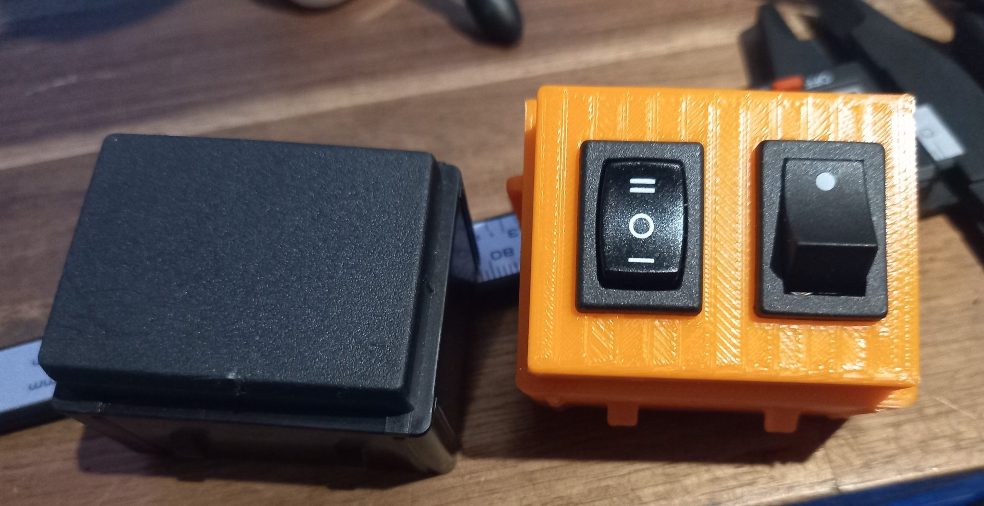

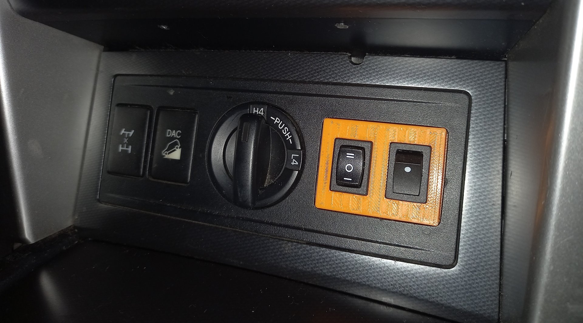

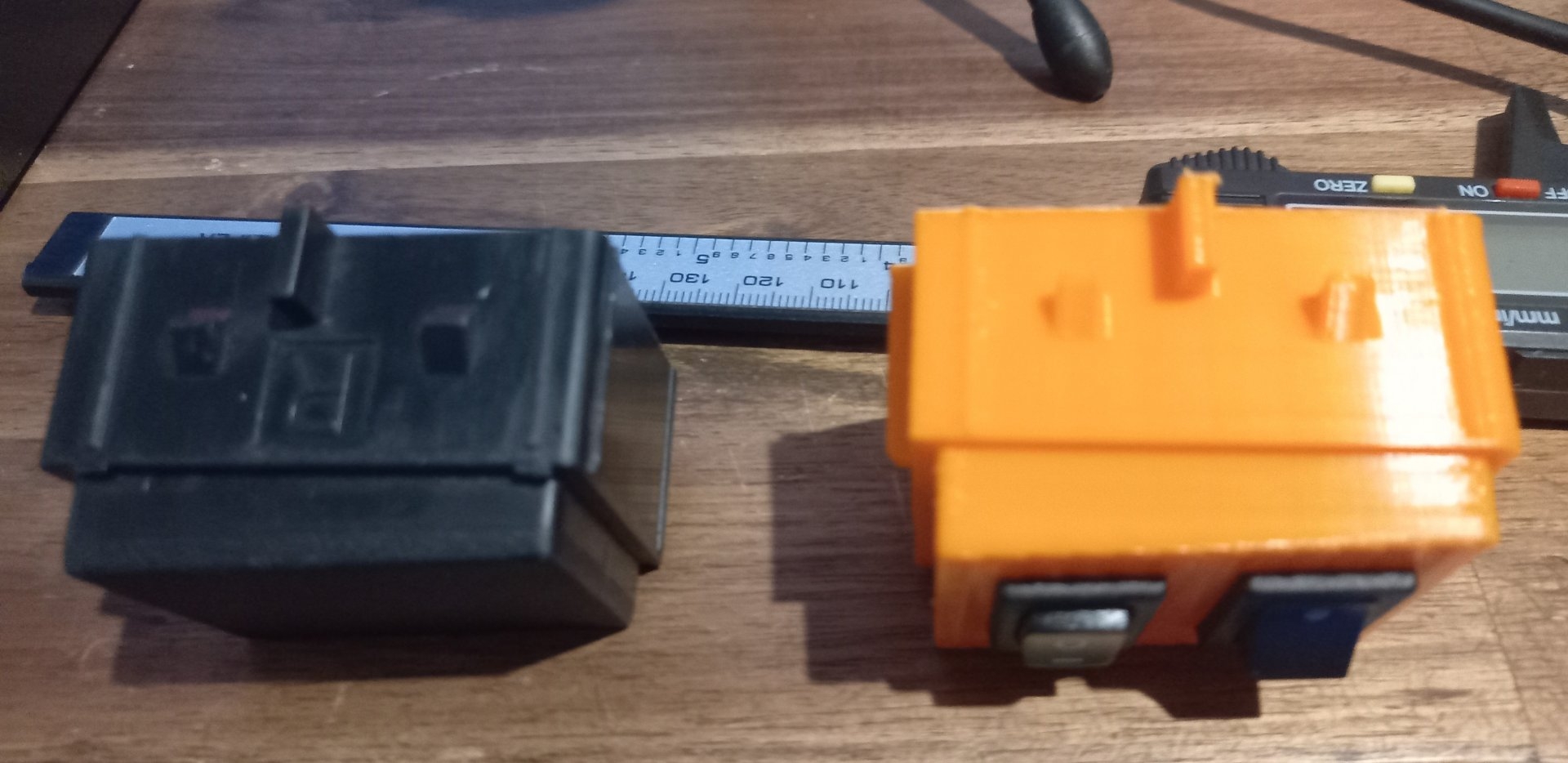

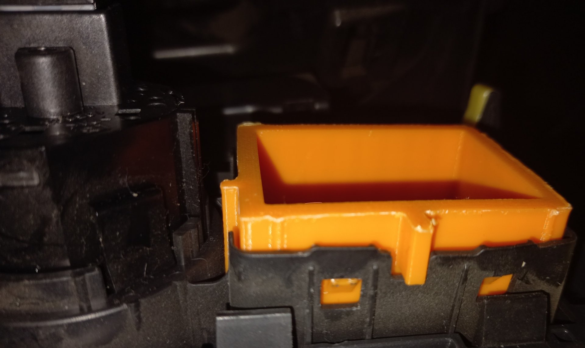

I've been wanting to do this mod for a while and finally got my hands on a Driving Support Switch Controller. MTS added and zero-point calibration all done with ease thanks to the great writeup and resources here. So now it's on the Crawl Control, but the right OEM switches are pretty scarce here so I've gone down the under $20 route.
A couple of goals for me are:
1. to take on a stock appearance wherever possible, a challenge without OEM switches and
2. not to drill any holes, which means using the existing switch holders.
After a trip to the local electronic supplies for a couple of rocker switches and an hour of 3d design and I've created a solution which meets my goals and perhaps others' too. It's a 3D printed switch holder that replaces the stock blanking panel next to the 4WD selector. It accommodates two rocker switches, in my case a momentary rocker for speed selection and a standard on-off for crawl activation.
I've yet wire with switches in up because I first wanted to get the switch holder design right. Besides I've run out of black material for the 3D printer and I'm not real keen on the orange colour of the prototype. The dry-fit worked out well, can't wait to print it in black.

That's came out great! But unfortunately for all us blokes on the other side of the equator, our switches for the Lexus version of Prados are on the center console down by the shift lever and configured differently. Albeit, this is an awesome mod for all your mates down under!

Mate if I could get my hands on a Lexus version of the switch blank I'd be more than happy to sketch up a mod and share the 3D file. It isn't hard to do when you've got the original part in hand to take measurements from.
Agree, 3D printers are great for car mods given the right material is used. Good for making custom brackets etc. I'll be sharing the link to my the 3D file here once I've made a few small tweaks. 👍

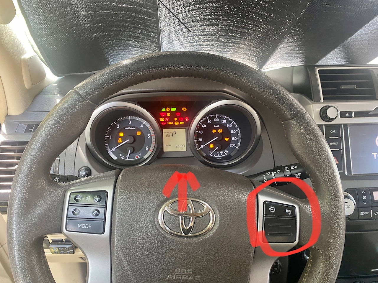

Hello everyone thank you all for all the info
Was thinking to add MTS and CC system to my 2015 prado 3.0D model code is KDJ150L-GKAEYW
it looks like a pretty simple process however, I found out my speedometer (cluster display)
is different also my steering wheel is missing an electronic switch that selects the drive mode.
My question is can it work on my trim line just like that ? or do I need to get more parts like this digital cluster and the switch?
how can I find out if it will work on my prado ?
thanks

Good question. I haven't seen anyone with your model/trim try it, so I don't think there's a good answer here. You may have to research how CC and MTS are controlled for the Prado 150 trim that has it? Maybe a different computer and different approach overall.
I don't have links at hand but when I researched this 460 mod 4 or so years ago I spent a lot of time translating Russian Prado pages which lead me to taking the leap this was plausible on the 460.
I'm a little tied up at moment to track down specific posts but might want to look through this CL thread.
OneTriple8 previous in this thread should be a good resource as well. I've learned that while a lot similar on 150 platform between Prado and 460... just as much very different....electrical being one of the major ones.
