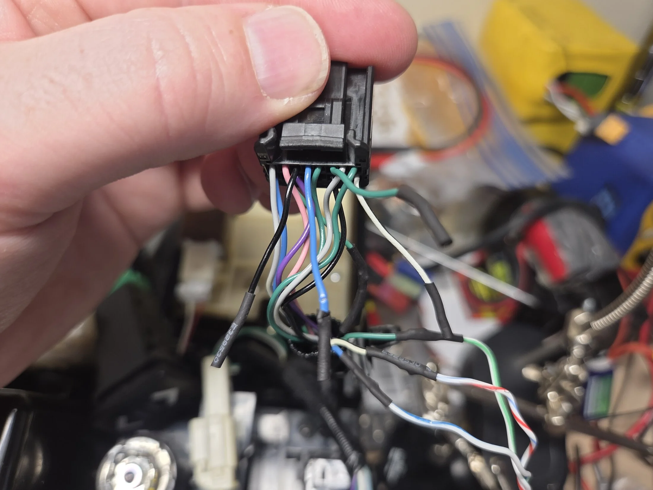

I did 2019 Crawl Control using a custom 4 button small dual switch from CH4X4 to adjust speeds and the downhill assist switch to enable/disable.
You need wires about 36 inches long to reach the spot above the center lock switch.
Photos following.

Mine is a 2019 and felt too nice to drill holes for normal round momentary button switches.
The switch was this one. CH4X4 Custom Laser-Etched Small Dual Push Switches for Toyota – CH4X4 Industries - https://ch4x4.com/product/ch4x4-custom-laser-etched-small-dual-push-switches-for-toyota/?
I was originally going to use a dual momentary rocker switch, but they were like $15 + shipping at digikey and didnt have labels. This was $30 more and seems worth it.
