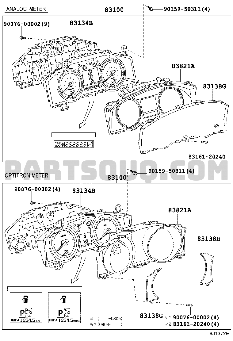

I see you replaced the combination meter assembly. Did you find a cross-ref of the various enabled features for each? For example, I'd love to find one that had the Rear Diff Lock light, was compatible with a factory sub-tank, read in MPH, and used the Lexus single connector. Any idea how best to approach this?
So far I've looked up the part numbers in catalogs such as Partsouq, but there are enough supercessions and global models that I never know exactly what features each CMA will have.

I’ve been cruising lx and tlc rear diff drawings for 30 min, just found a factory lsd, still looking for the locker. I think my quest won’t work, I didn’t find any lockers on the Lexus side, I’m looking at tlc now. I know these have different connections at the combination meter.
Here's a rear locker sub tank version of the TLC, it's a URJ202. One of these combination meters might work for the retrofit of the TLC. I haven't tried this part number on the LX side yet, but assume it'll fail do to the plugs being different. I could be wrong though.
Edit: Here's an even better one. This is GRJ200L-GPANKV, a TLC with AHC, Rear Locker, and Sub Tank.
Note all the variations on this TOC page for 8301: Meter
NumberNote
There are several options available for your car, pick the correct one.
8380060K00GRJ200..5FC
8380060K01GRJ200..5FC
8380060K02GRJ200..5FC
838006AD30GRJ200..5FC
838006AG80GRJ200..5FC
838006AG81GRJ200..ATM
