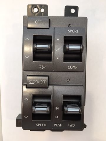

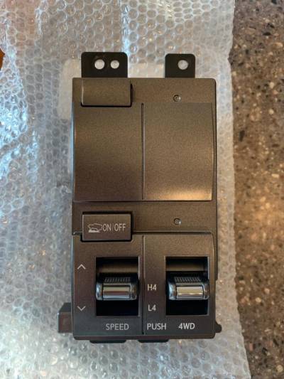

Anyone know the difference between 84970-60070 and 84970-60080? The former says "with precrash system" and is ~$12 cheaper, while the later is "without precrash system". Would it be an issue to install the '70 part in a vehicle without precrash? I wasn't able to find any mention of the '80 part in this thread.
Further, anyone know if there would be any issue installing either of those in a vehicle without AVS/RAHC? I'm thinking of using the extra switches for adding other functionality (and possibly removing the lettering and stenciling in new markings for those 2 switches).
hatfieldcb: Yeah just have scour the yards or eBay
hakmo:
Don't worry about the pre-crash requirement. It will install on "all" 10-19 460s. Just need to buy one 070 or 090 depending on whether you have stock bags or have eliminated them.
84970-60070
84970-60080
84970-60090
84970-60100
