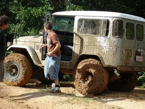

locks with mud
are you running spacers?
that doesnt sound right
