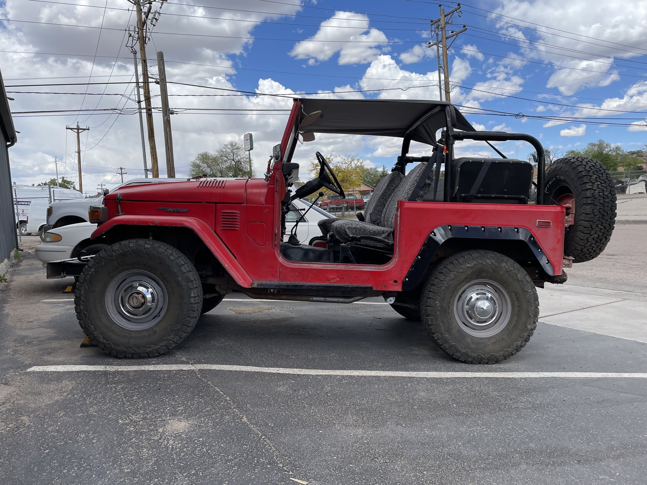

When I did my rear springs, I used FJ62 rear springs on Rough Stuff mounts welded to the back of the original front mount. I flipped the rear mounts 180* and rewelded. I also removed about 6 inches from behind the wheel opening and added it back in the middle of the arch. Put the rear 40 springs on the front and removed the bottom leaf from the pack after the picture to level things up. Gave me enough room for these 35's or for 37's.

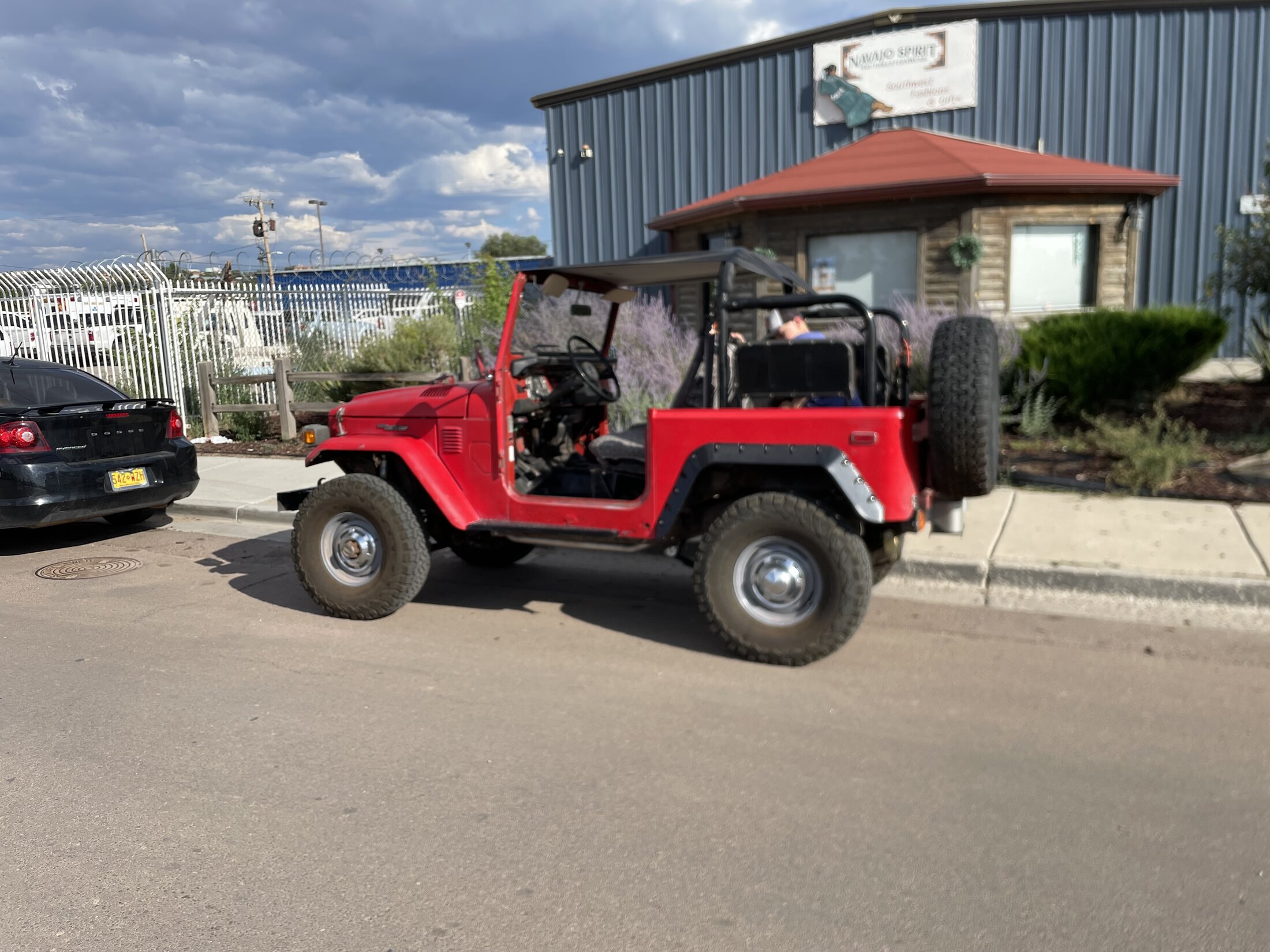

You can leave them. I ran 36” bias Iroks on my old 40 without flipping the springs. They measured out at almost 37” and I never had an issue and it got put through all the paces.
Very few photos of that truck because it was a long time ago and I didn’t have a cell phone back then.

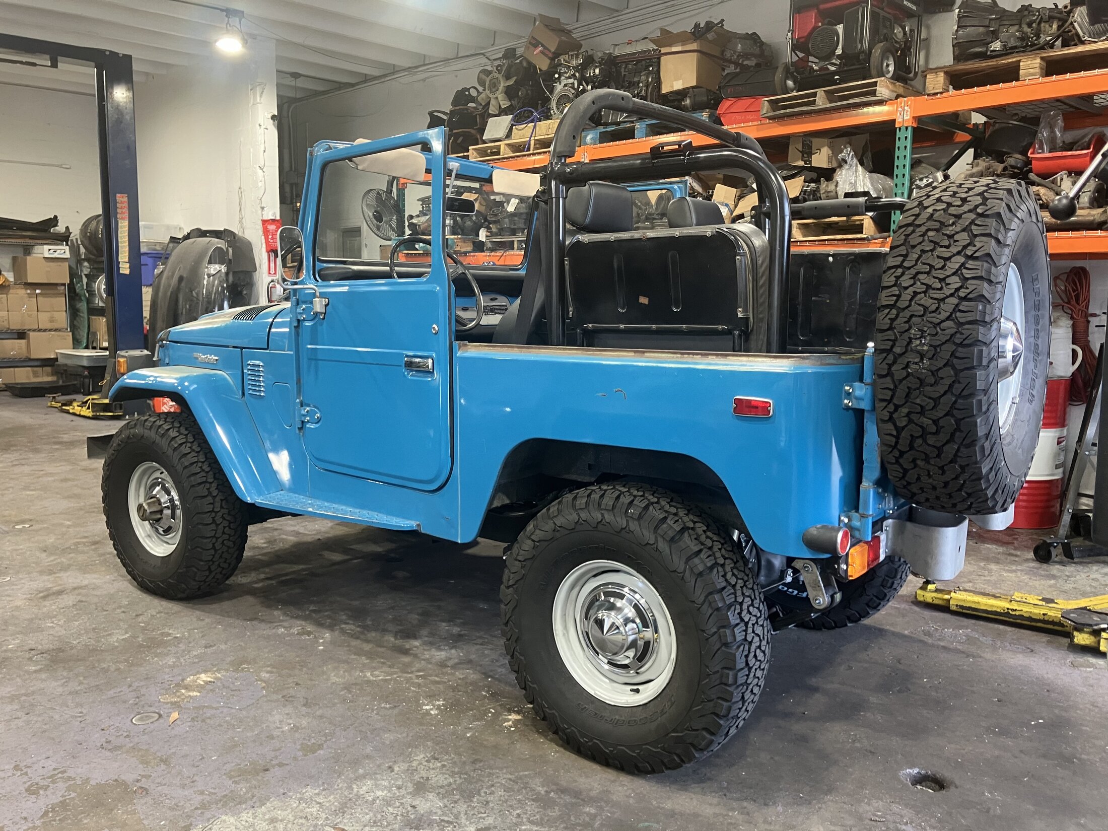

I just did a rear spring flip on my 40 with 37s. One of the best mods! I think I had the driveshaft lengthened 3.5 inches, flip shocks to other side of crossmember as stated.

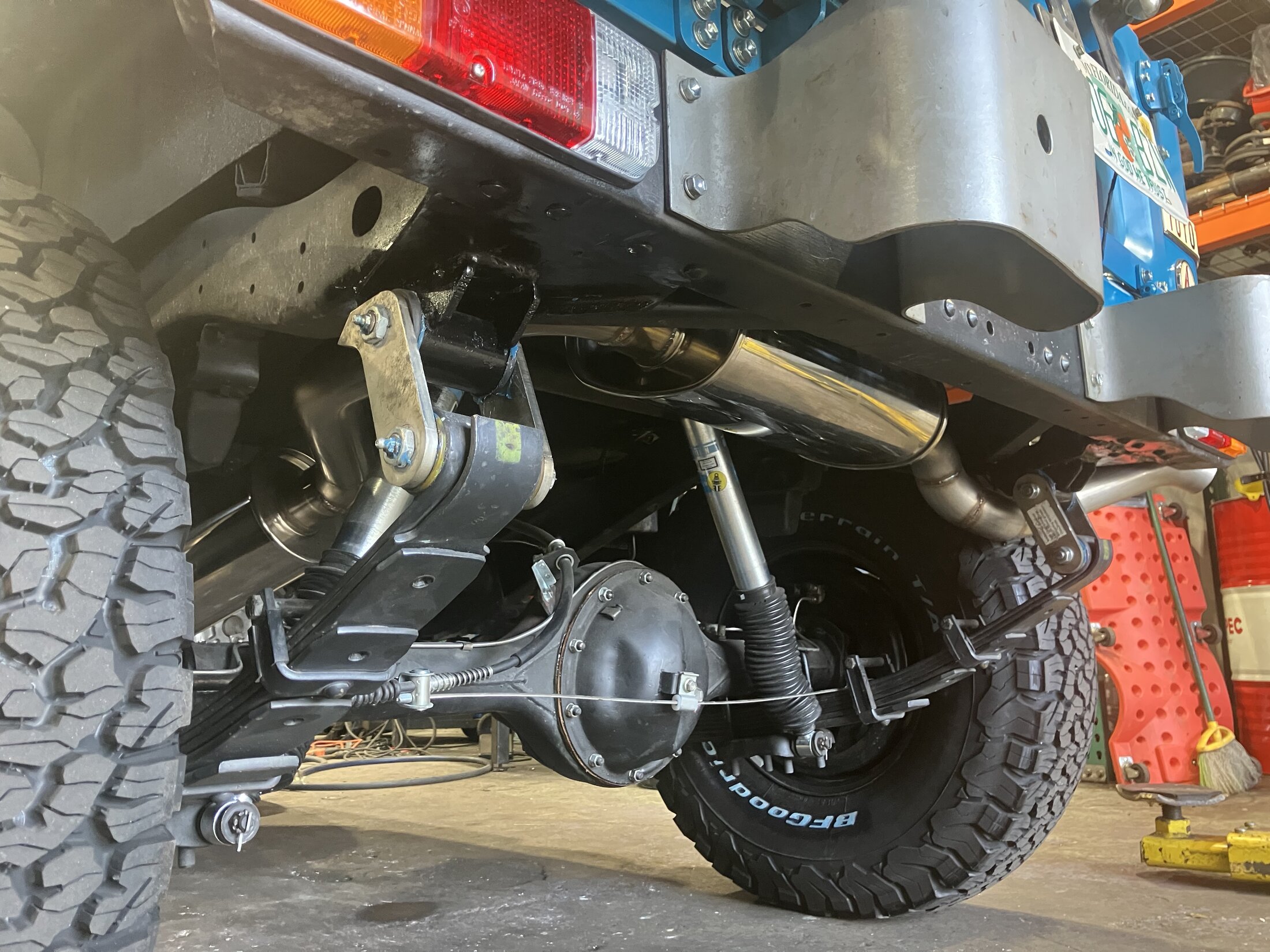

Not 37’s, but one we recently finished here. We also cut the rear shackle mount off and replaced them with FJ60 mounts about 1.5” forward for better shackle angle.

Did you use 40 springs flipped? What size tire did you run? This is the look I'm going for, nice job! I just got a pair of Budbuilt rear quarters with the factory size/style wheelwell opening only had them move it back 3 inches. Now I need to move the axel back to match.
Yes, it’s a regular OME 2.5” spring.
That’s just a 33x10.5 on stock wheel.
I would have to check my notes but I think we move the arch back 5.5” or 6”
Axle spring perch and u bolt plate are drilled to move axle 1.25” forwards from spring pin

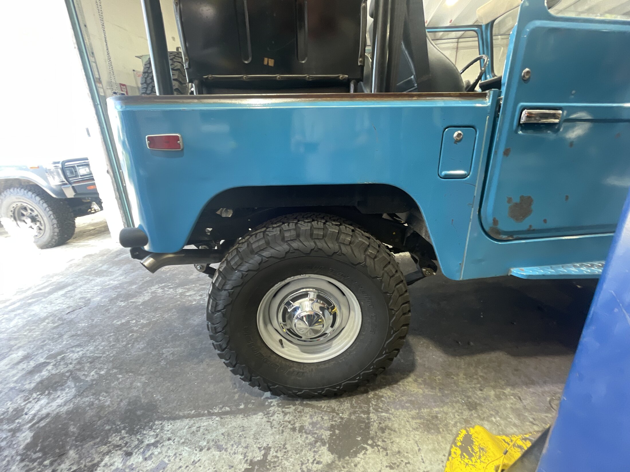

Here’s how ours turned out with 4Plus flares made for this sort of thing. OME springs flipped. Had to modify the driveshaft and shock mounts. 33x10.50 BFGs. Love the proportions. The bottom one is before the lift.
