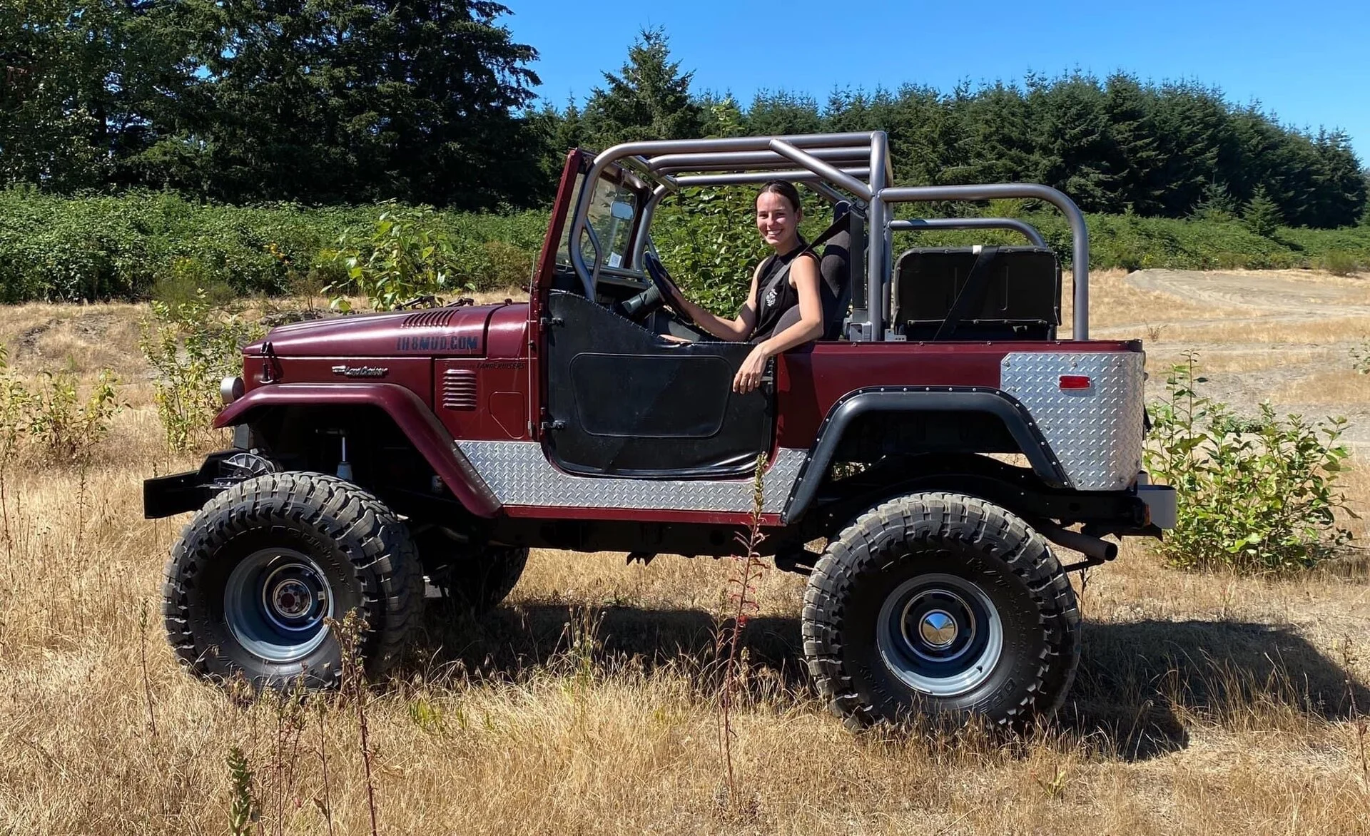

I did not flip mine but I did drill a new hole in the spring perch and moved the axle back to the new hole I drilled
My fronts are flipped and axle moved backwards closer to firewall. Drilled spring perch also. 37’s
