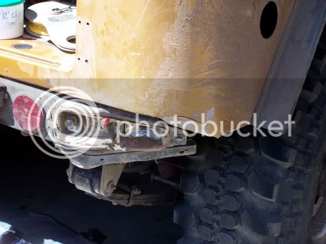

Also damaged the rear lights a little :eek: so time for an up grade :cool:
