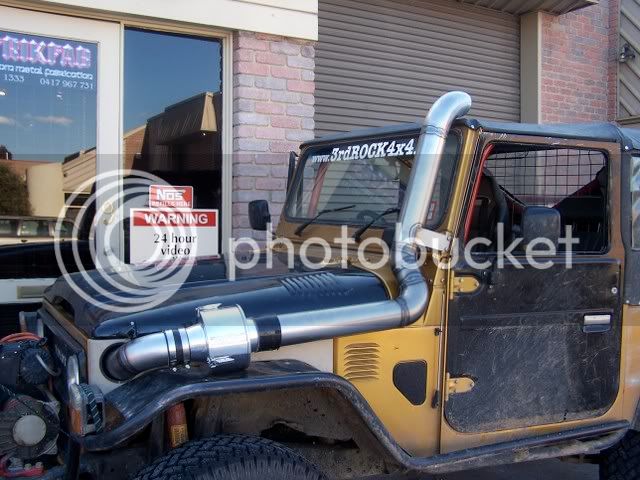

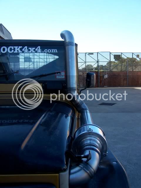

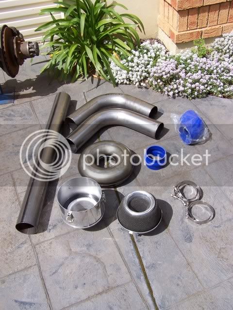

Snorkel first, hmmmmm Stainless would be nice but just too bling, steel I think painted black, maybe powder coated. The air filter is Stainless with 4" in and out and seals fully and foam washable.
To start all in 4" :D
This will only be used off road and at comp.

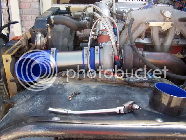

hey did you have the cut the brace/rib in the center of the bonnet to fit the intake piping ??
i cant get a 2.5" piece of pipe to fit over the oil cap without it touching the rib and yours looks like its sitting above the oil cap with a gap
I have just enough room to remove the oil cap and get a funnel in and close the bonnet and the rib is un-cut. Very close though it did originally rub on the plastic grommet that was still there in the rib from holding the old sound proofing up until removed.
I gave it a little more clearance with the mash hammer too just to be on the safe side :D The rib has a small depression in it now.
well i ended up having to chop it and i welded a piece of flattened 3" tube into it
i then remembered the early and late rocker covers are different in height so i must be running a early rocker cover hmmm
owell all clears now to get some 2.5" bends and do the piping

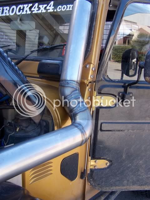

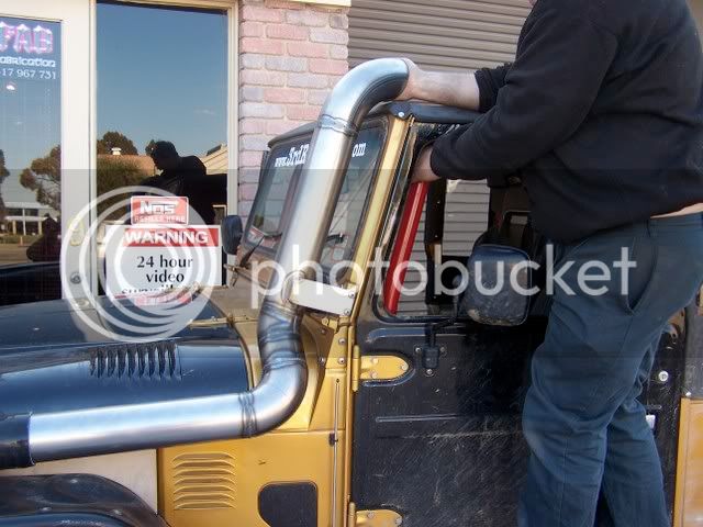

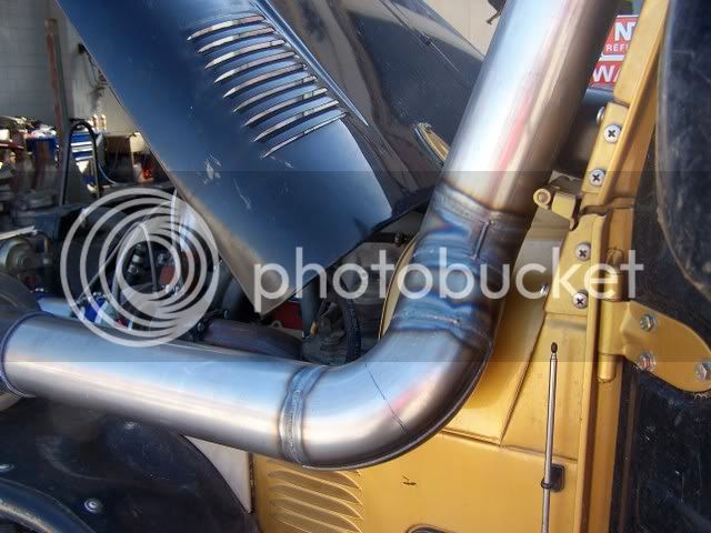

Well Awill4x4's magic with the welder is just that MAGIC and yours truly helping out BIG tks to TRIKFAB for the use of the work shop
4" Just a couple of brackets left to do.
So what about a kit for the air intake - amazing.
Matt, do you have any concerns with the low level exhaust outlet just thinking about the depth you get to at the effect of and stall when in deep.
Matt, not done much with thinwall but what do you call the spun donut thing and is it supplied already welded down the sides?
Nice welding, wish I could do that, like you I am lucky to know people with welding skills.
It's called a 4" donut :D
Awesome work Matt- and quick too!
Are you going to spraycan it black or powdercoat?
