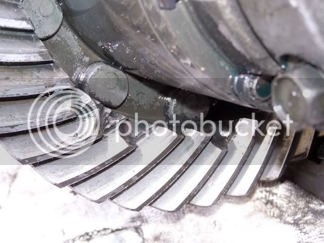

Something very wrong to break off that part of the teeth on the crownwheel??
Certainly looks that way, un even loading on the crown wheel, it has been in their for 4 years or 4 Vic Winch's an Alpine challenge and an ATECO plus a few other play days. So all in all 4 years no maintenance other than oil changes I can't complain too much.

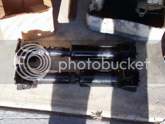

Well the new tail shaft is ready heavy duty slip yoke and thicker walled tube.
The old one we made for comp has also been repaired and re tubed and now becomes a comp spare.
All up one new custom tail shaft and the old repaired $540Aus

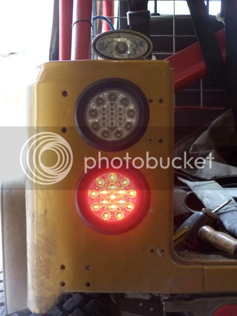

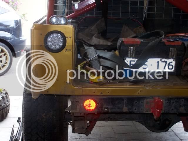

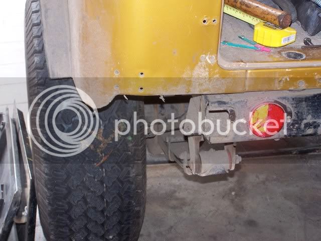

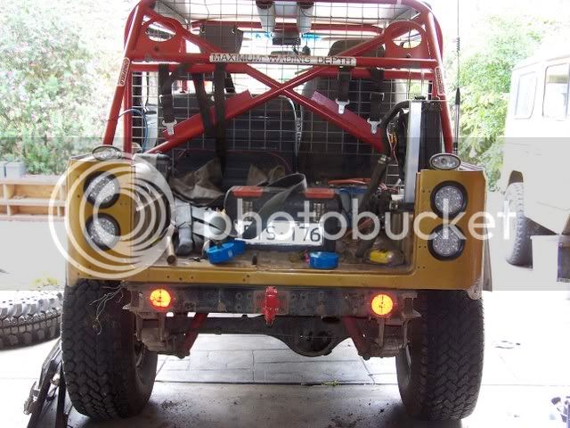

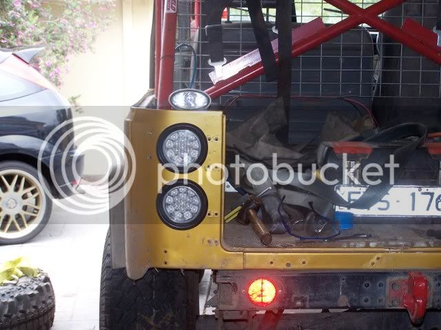

Made a start on the new rear lights today to replace the damaged ones.
After I bought them I was unsure if the 4" lights were going to be too big but I'm quite happy with the results.

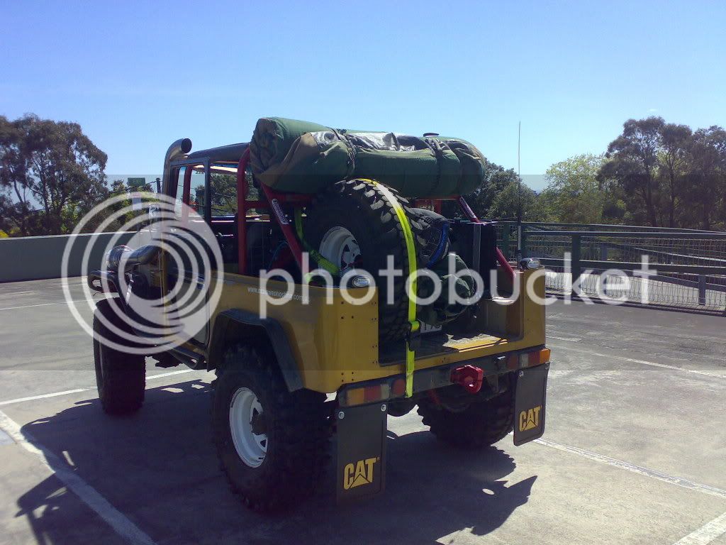

I would build some rear end protection there for the bottom of the fender metal. Incorporate some square tubing, or pins or something to make a quick disconnect mudflap. Would make it easier to strip them off when you want to, but stay legal on the road easily. Dual purpose so to speak.
Lights look good though. That was one of the worst thought out designs on a 40 ever. Two crappy tailights below the rear bumper. Early models are even worse. Guess they had few options with the tire and all.
At the top of my to do list, may also cut the panel straight and re fold the edge where it used to accommodate the old lights the the bar work will be easier too.
