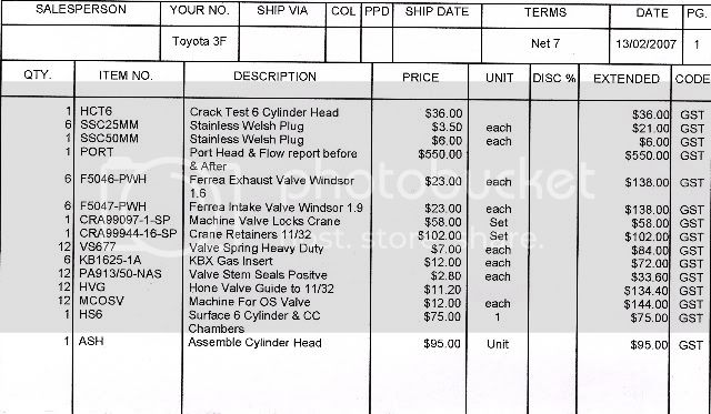

Well the quotes in :eek:
Oh yes it's in Aus $:grinpimp:
Work on the head has started:bounce2: :bounce: :bounce2:
The only part missing on the quote is porting the inlet manifold to match the head.
Grand total with tax $1855.70Aus

Youre running windsor valves in your 3f head? How much machining is necessary to accept those? Just the guide and the bowl?
-Matt
-Matt
Not 100% sure, if you have a read through the list from the engine builder it looks like $12Aus each valve. But remember this is part of all the work been done, as an indavidual job it may be more expencive.
The question is why the ford valves, instead of the SBC valves that fit right into the Toyota/Chevy head?
These valves are not standard size, been larger they give better flow in and out:cool: hence the part of the bill for, machine for over size valves (guess the ford valves suited it best)
There're Chevy valves that are similarly oversized. Not an uncommon swap in the US. May be that the Ford valves are more comon/less expensive in Oz.

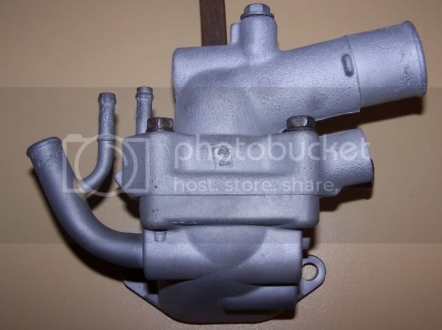

Took the thermostat housing apart to clean mmmmmm, lots of silicon sealent and once opened it looks like a fair bit of stop leak too that's dried hardened inside and around the thermostat. Also one of the 4 bolts was covered in stop leak where it looks as if it has been leaking up the thread untill it finaly sealed.
You just know this old 3F-E has had cooling issues in the past from the state of play.
What I was not expecting was this to have been an issue from new I guess, unless the thermostat housing has been replaced in the past, though unlikly.
After a good clean and re-assembling without a gasket I noticed one of the bolts would not thighten down (finger tight) anywhere near as much as the others. (2--3mm)
On close inspection I tested the depth of the two blind holes both the same. I messed around a little longer still a 2-3mm difference.
On even closer inspection I could actually see that the thread in one holes was shorter than the other, even though the holes were of the same depth. So even from new this thermostat housing would have always been a weak spot if not a complete pain in the a***, as it would have never tightened up to seal well.
Ran a 8mmx1.25 tap down it and now it's all good. Strange how the smallest of things can give so much trouble, you just wounder how many hours were spent with sealent and gaskets trying to get it right.
All good now though

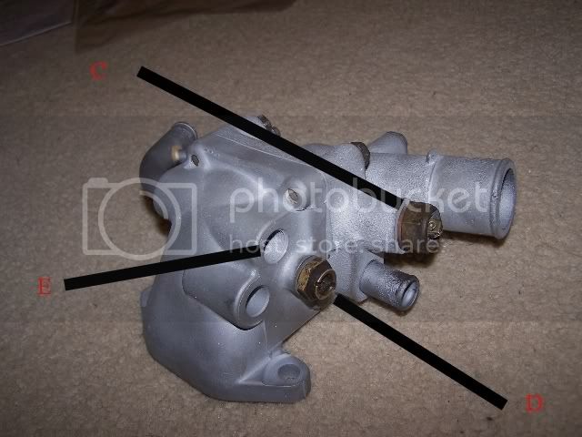

All three electrical conections were damaged when removed (Not By Me) A,C & D so does anyone know what they are and which is which.
A-I think is the Temp switch
C-I think is the cold start injector timer switch
D-I think is the Temp sensor
Please confirm the above
B- is a Vacume switch but to what?
E-I have no Idea what the hole is for, it's a threaded hole that goes through in to the thermostat like the others but had nothing in it that I recall though it looks more like a it would suit a compression fitting than a sensor of sorts.

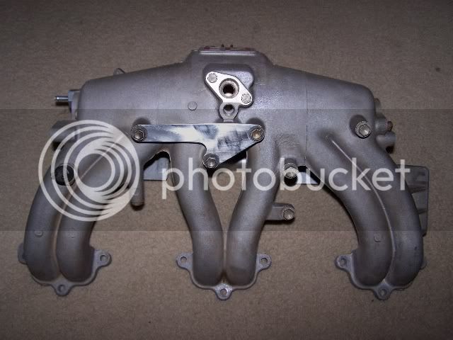

The old EGR gasket was used to make the new blanking plate from stainless as this part of the EFI system will not be used.
Fitted
