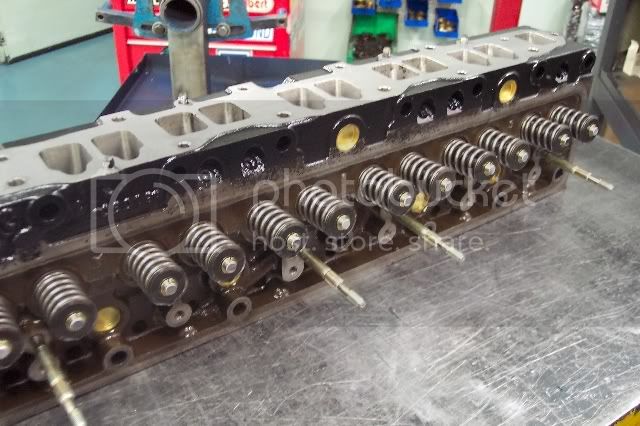

wow what kind of exaust paint did you go with to get that thick glossy look? what brand. looks great!
It's not paint. It's powder.

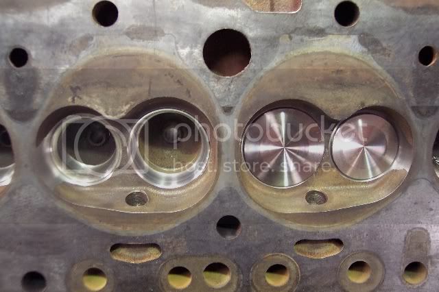

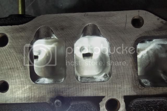

Called iin at the engine builder today, head should be finished early next week. He's also been good enough to take a few photos of the work, Will post them up as soon as I have them.
Head done picking it up Wednesday:cool:
Matt,

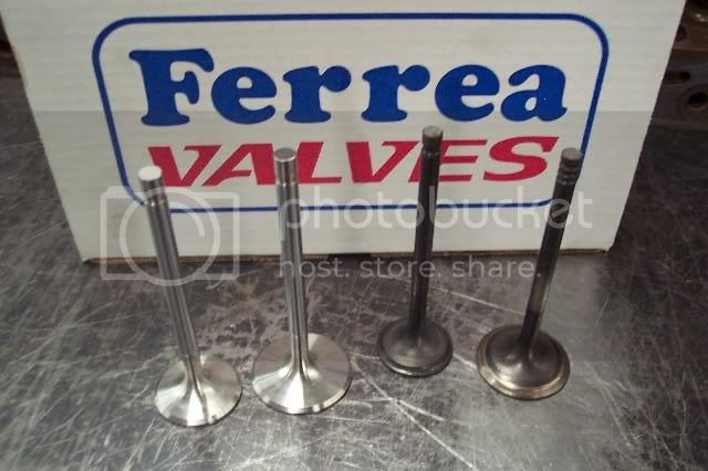

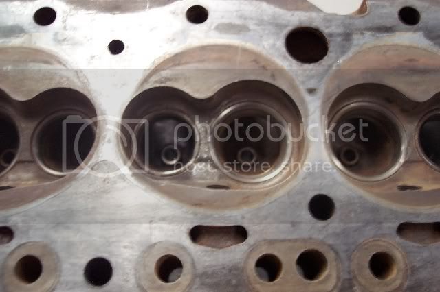

Would you post a pic of the combustion faces of the OE valves?
It would be good to show people the _large_ recess in the stock valves, particularly the 3FE intake.
Just by installing flat face valves, the CR will be raised quite a bit in the 3FE.

No Problem

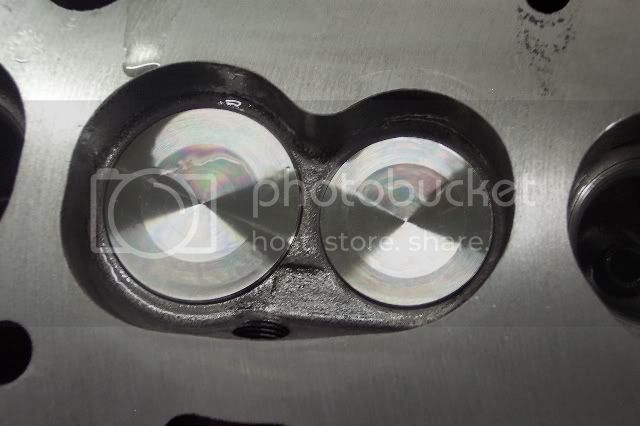

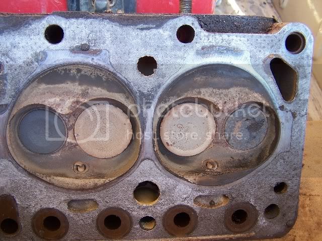

Before: The recessed stock 3F-E Valves, a little hard to see but you can make it out
After: Flat faced Ferrea Winsor Valves
mmmm.... my head looks almost identical! did you CC the chambers? i was going to but was told it wasnt worth the effort in a 3FE. i wonder just how far off they are....
The chambers were cc'd before the work started as I wanted the compression ration to be 8.0:1 once it pick it up on Wednesday I will have all the tecnical information including the flow rates as it was tested before and after the work done.
